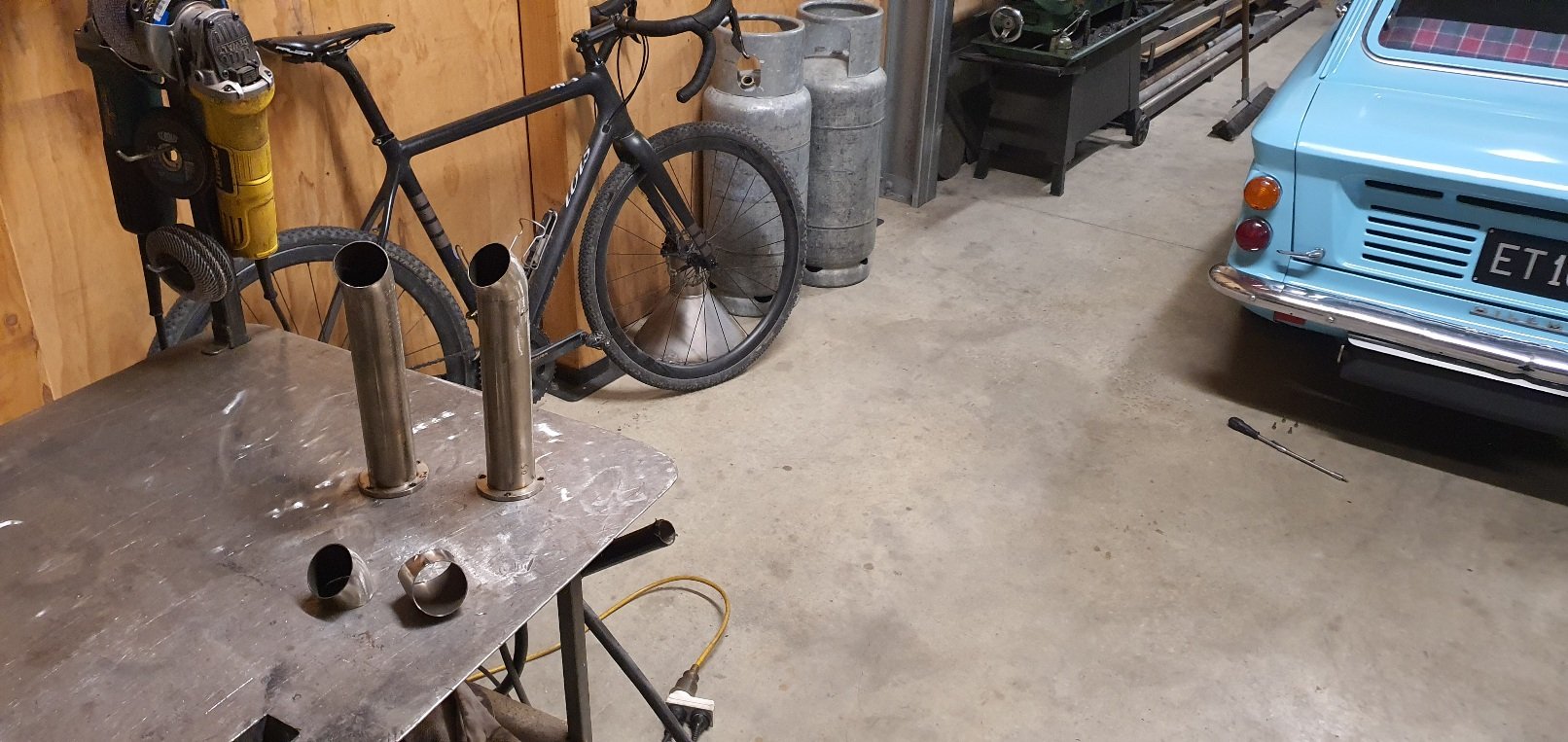

yoeddynz Posted May 18, 2025 Author Posted May 18, 2025 There's no room in front of the pipes to do that. But I'll certainly be aiming them more out to the sides. I'm glad they are bolt on. Quote

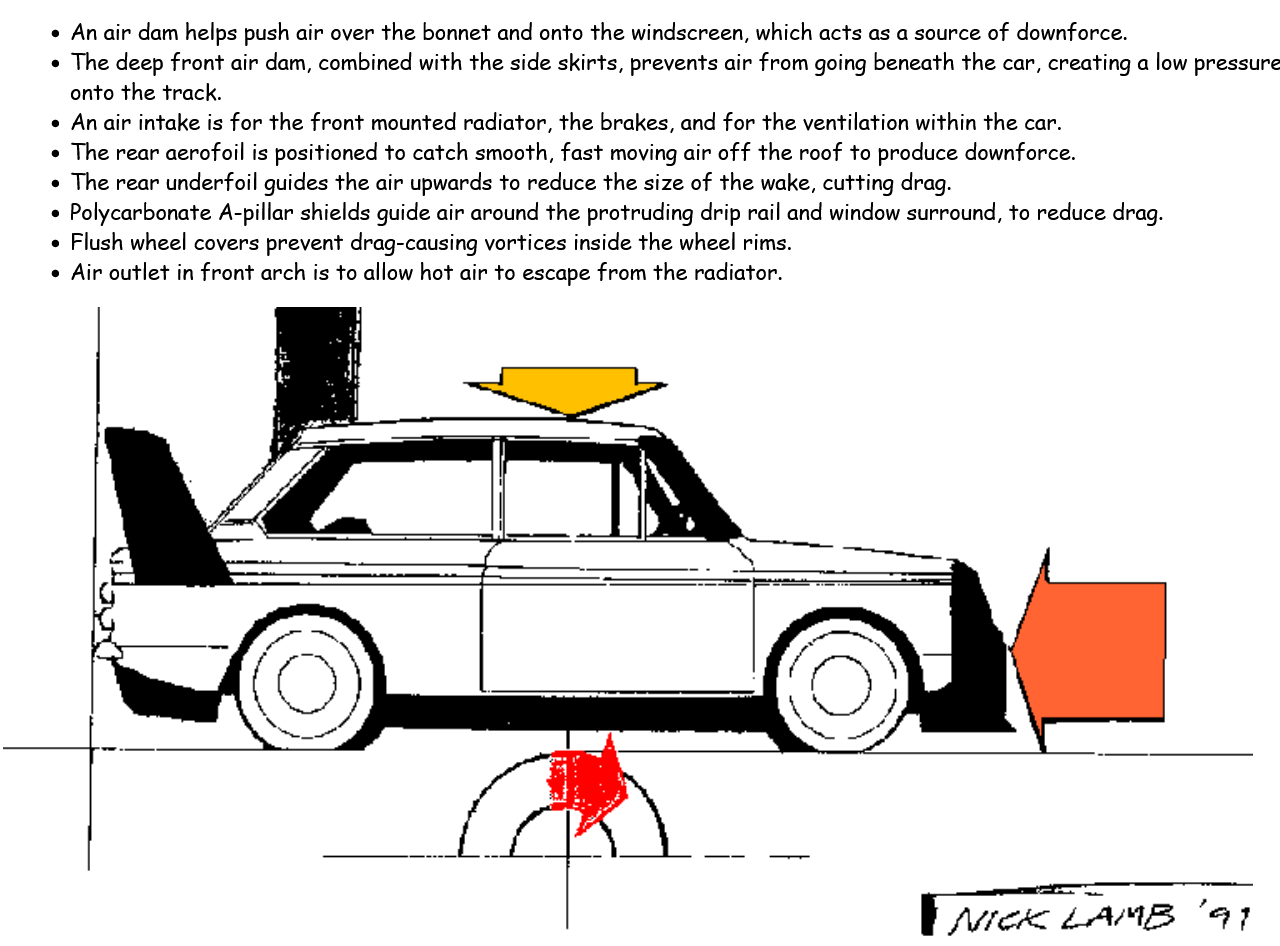

Nominal Posted May 18, 2025 Posted May 18, 2025 Maybe you need to modify the airflow at the back of the car? Couple of options I thought of. 2 1 3 Quote
yoeddynz Posted May 18, 2025 Author Posted May 18, 2025 I think I'll pass on both of those. What I should do is tape up my opening rear window and see if that's where the fumes are getting drawn through. Will test new tail pipe setup tomorrow. 1 Quote
