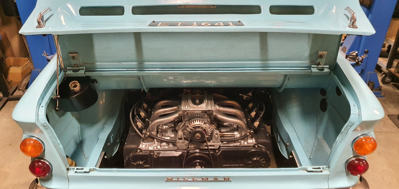

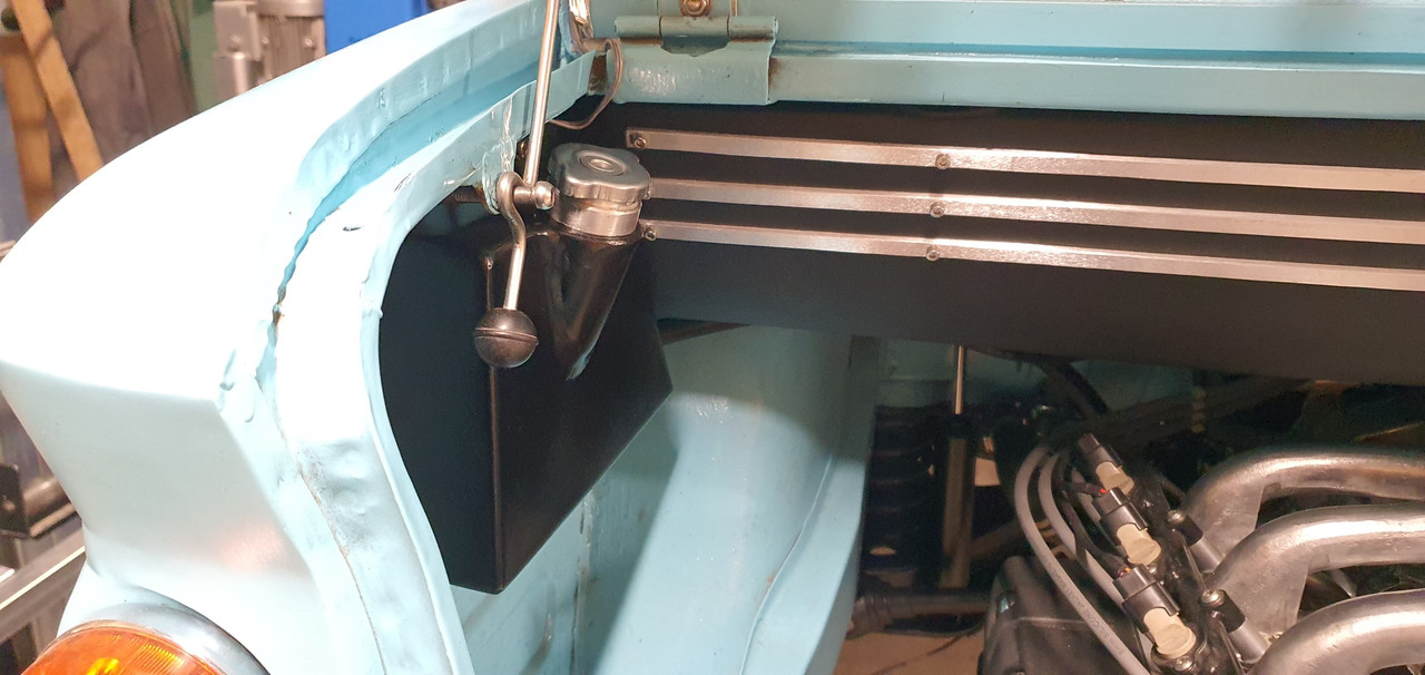

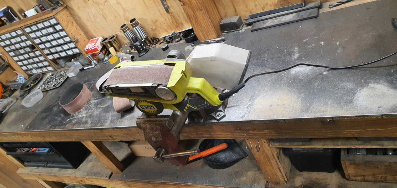

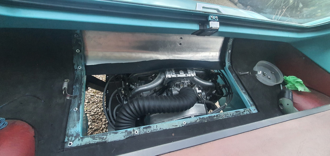

Popular Post yoeddynz Posted May 5, 2024 Author Popular Post Posted May 5, 2024 Flat six in Cut away under the seat base and the tunnel as per on the green imp. The air saw was so perfect for much of this job which means much less grinding dust everywhere. I've marked out where I'll cut away a little bit more. I'd rather give it extra clearance now than ending up with it potentially knocking against the steel on a bumpy road etc later. Cut off a couple of superfluous tabs sticking up on the transmission for the same reasons as above. Oh I also couldn't resist a photo of the two power plants next to each other. It's hard to gauge sizes from the pic though as the Datsuns wheely stand 2000 is much lower. 80 1 Quote

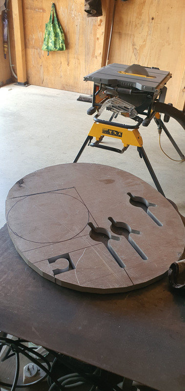

Popular Post yoeddynz Posted May 18, 2024 Author Popular Post Posted May 18, 2024 Sealing up the cut out tunnel top and under the rear seat was to be the next stage but first I decided to make some new beefed up engine mounts. The originals I had made from a mixture of 3 and 4mm steel were probably fine but i wanted to move the crossmember backwards away from the engine for a little bit more clearance. So while I was at it I thought it best to use thicker steel. To start with I made a jig based off the original mounts. Now there were datum points to build to, allowing for extra clearance while I was at it. I popped into G3 engineering where I get a lot of my steel offcuts from and grabbed some 4mm plate. I had 5mm at home for the main backing plates. Used the hefty steel bender.. Tigged the majority of the welds except the inside ones I couldn't reach which got mig welded. Plenty of heat. These wont fail. Added gussets just to be sure... The new mounts now set the crossmember further back by about 5mm. I could now drill the holes through the chassis rails. I made up a new pair of backing plates with extra holes and captive nuts. The plates extend further forwards to line up with the holes that Datsun crossmember bolts through. I can now easily bolt in either crossmember. I was super happy to discover that due to the flat six being only 3 cylinders long I have enough room to pull the engine back so its gearbox bobbins are clear of the gearbox crossmember. I can then raise the car up and away from the engine, all without having to remove the rear bumper and valance. Now the engine was in its final position I could replace the lid on the tunnel, now 50mm higher. I started with this bit and had to cut out a section to allow for access to the toyota spec gearbox speedo sensor plug... Making sure there was ample clearance all round so the box cant knock the tinwork on rough roads I proceeded to box the tunnel back in... Kneeling down on folded up bits of foam and towels was my home for the next few hours... Cardboard trials, then steel, cut, trim, tack, check, weld... Finally boxed in. Another access hole let in so I can get to the top universal joint and lube the gearbox selector shaft. It was a very good part of the build to finish. Seeing it all sealed up, strong again. I have yet to check the rear seat squab but I feel confident it'll fit with some modifications to the wire frame within. Underneath looked neat... Hannah has now painted the tunnel inside and out with Epoxy paint. After I have finished any other little fabrication bits or hole filling/drilling in the engine bay I'll give it a flick of blue paint (hopefully not making everything else in the workshop blue like the first time) Now it was onto the rear suspension arms. I am using the set that came on the green imp 2. Surface rust needed wire brushing off outside... Painted with KBS rust seal (Aussie por 15 clone).. Another bit I could have got away without doing but I thought best to make while I'm under the car was this brace... Pulling up tight to the floor via spreader plates under the seat base... I have added it to brace the floor halves inline to help keep the suspension mounts inline during hard corning. Like said, I'm not sure if its essential but it might just help avoid any weird effects like rear steering. I know its a bit ugly but hey, at least its hidden under the car. On the subject of bracing I also made this little brace... To help stiffen the top of the tunnel near the shifter so it doesn't flex. again, not really needed but I do want a really positive shift action without an excess movement. So now my next job is to run out the brake/clutch/fuel pipes back along the tunnel and then reassemble the rear suspension so I can setup the handbrake cables. I'll have to paint some bits too. The crossmember, mounts, fuel tank etc. The work area looks like this with bits everywhere... In other news we had these treats turn up in the mail, a surprise present from my brother in Wales... He had gone to a big collectables/toy and model show local to him where he then spent a good amount of time asking at the various collectors stalls for any Hillman Imp models and found what is quite a rare and sought after Dinky toy car... Plus a cool little Imp police car .. They turned up in the post yesterday as a surprise and made our evening. Very cool. Thanks bro! 64 3 Quote

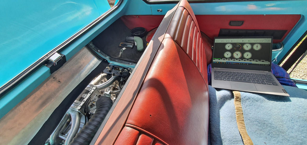

Popular Post yoeddynz Posted June 2, 2024 Author Popular Post Posted June 2, 2024 So many little jobs that add up to suck time. But its a fun time to be at and there's no point in rushing it. The rear seat base was next up because I needed to work out where I could run the engine loom through. I tried the base in place, got an idea of how its steel rod framework needed to be adjusted and set to it. As you might spot in the above pic I also gave myself a decent cut from something sharp in there. Seat base now fits in neatly although it wont be a luxurious softly sprung seat for a middle passenger when 5 up. Highly unlikely scenario that is an Imp though. Megasquirt and associated fuses/relays etc are tucked away under the seat. I made some mounts for the exhaust box.. Welded the mounts in place and I was then able to tack, then weld the secondaries to their flanges. I painted the crossmember after having added some handbrake cable guides. Then it and the rear suspension was all bolted up in place. The new driveshafts fitted and hubs pulled on, wheels bolted up and it was rolling again. So it got rolled out the back to join green imp so I could use the hoist to do a customers van job. As soon as the van was fixed and out of the shop I put Impy back up on the hoist. I then worked out the final section of pipework for the clutch's concentric slave cylinder (CSC). I wanted the bleed nipple to be easier to access and not have any spillage running down into the bellhousing. I made some pipework and fittings to suit. Bench was covered in brake fitting stuff and I pieced together a system. I made one setup, tested the clutch and while it worked fine I wasn't happy with the pipes sticking up in the way so I changed a it again leading to the final iteration.. The csc itself was a unit I'd scored from a Ford Mundano engine and gearbox I had well over 6 years ago. Intended to fit the duratec into my Viva wagon. Sold the engine and kept the release bearing just because I thought it might be handy. So six years I've had it laying about and before that it was residing in a wreckers yard. It must surely be a bit cruddy inside? They are not designed to be serviceable but they are also stupidly priced here in NZ - like triple what they cost in the UK. So I decided it was going to be serviceable and I took it apart. Sure enough it had some mild corrosion marks on luckily what is a stainless guide tube but otherwise actually pretty good. It cleaned up well in the lathe.. Its a very nicely made thing and quite simple but has to be mounted correctly. This guide tube seals on the mounting plate with a thin square section seal. I made a new bigger mount to support the base because the original machined support I'd made wasn't broad enough. I was then able to add two more bolts to sandwich the lot together so that square seal remains squished evenly at all times, as it would in a OEM situation. We trial fitted it all with the new base plate and pipework. I was not sure whether my stock Imp 5/8" bore master cylinder was going to move enough fluid to get the release bearing travel I needed and I was prepared that I might have had to fit a 3/4" M/C. However it all seems fine with a light pedal and the bite point is about midway. Very smooth motion too! While this lot was being done Hannah finished prepping the rear valance for paint. On a nice warm morning I set up the paint frame outside and sprayed some blue about.. I did my best not to paint the cat blue.. It turned out fine.. Another little fun job was cleaning up the gearstick shaft in the lathe.. ...and discovering that universal steering rack boots make for neat gearstick boots... I'd bought some muffler packing sheet and then played with scissors... I then painted it with stove paint and sat it on the burner to help it harden. It looks much better in black. I've used silicone to seal the lid. Ran some beads, let them set for a couple of hours till at the point where it squishes flat without smearing. Stainless bolts carefully pulled up evenly. Seems all good but only time will tell on how the seal lasts. Like a few things on this build its a bit experimental. Gaskets for the inlets and tailpipes are copper. I have quite a bit of decent thick walled copper pipe from the Imp racecar cooling system. Chopped some bits, flattened out, heated and quenched with the oxycet and now nice and soft. Exhaust all mounted and engine now ready to go in for the final time (he says..) I just had to get a few more pics of this stage because its a point I've been looking forward to Positioning the power plant under the car.jpg Yep. Getting very close now!!! 90 8 Quote

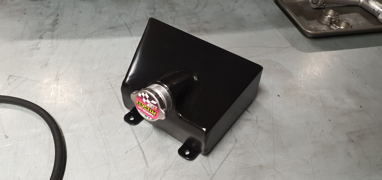

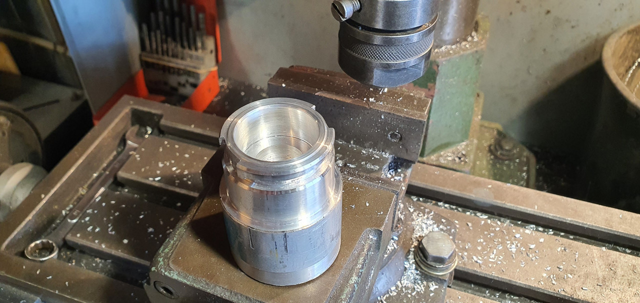

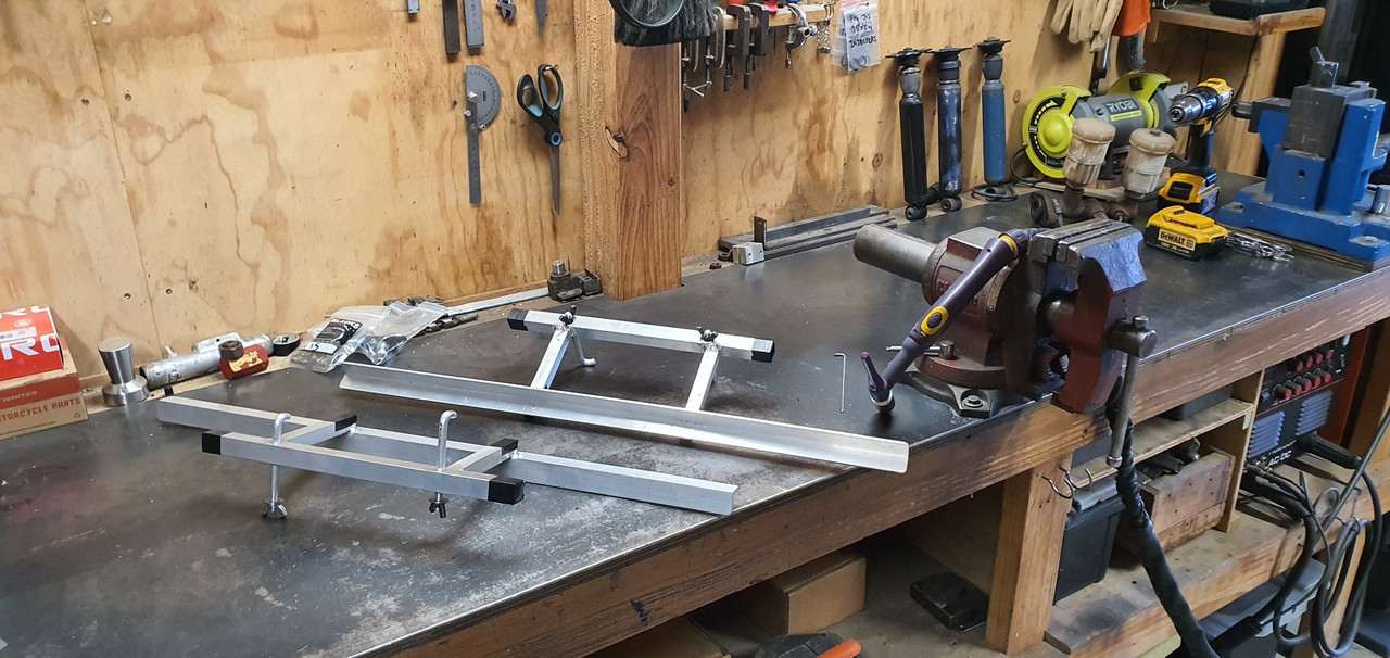

Popular Post yoeddynz Posted June 11, 2024 Author Popular Post Posted June 11, 2024 I will try to keep updates coming along a bit closer now as I tick off many of those little jobs. The useful alloy scooter handle bar thing I'd picked up at the dump ages ago is getting shorter and shorter. It happens to be 32mm OD and ideal for many jobs such as extending the sensor housing so I could add a 16mm tee for my header tank.. Another bunch of little bits to do was the air filter mount and associated points to feed the IACV, the catch can and a place for the air temp sensor. I made an alloy mount which bolts to the firewall in about the only place left that would fit it. It connects to the throttle body by flexible ducting. The Goldwing engine just has a simple breather system. The crankcase is under a constant light vacuum and any blowby fumes are drawn straight into the air box before the carbs. I decided ages ago I would just replicate it. I machined up a Ventura... Oh. Hang on. That's not right. I mean Venturi... with some other bits.. Looks like this inside... I made a little stainless catch can with shelves and stainless scrubbers - for scrubbing out any oil mist. It has a drain plug which is easy to get to. Painted it black so it hides better (not exactly a pretty thing) It, along with the filter and filter mount plus associated tubing all resides at the back of the engine bay, luckily out of sight because its all a bit messy. I tried my best without getting too carried away. Its tight in there!.. The two main plugs plus the wideband plug are tucked up nearby.. Also nicked the oil pressure sensor from the Datsun engine and fitted it in place... Lifted the big folder into place and bent some steel sheet ... ...to cover the hole that normally has a Datsun cylinder head poking through it... Used rivnuts so now it simply bolts down in place. I'll glue foam on top so it'll match the rest of the parcel shelf. I'll eventually cover that with an easily removable carpet mat. Its super handy having this access hatch. As for the underside - that will get painted blue for now and I'll be looking into some sort of cover that simply screws in place, possibly with a covering like vinyl or something. Maybe use pop studs to hold it in place. Just something neat and uniform that will hide the hole.I'm still thinking on this one. While I had the folder out I cut out a bit of 0.7mm stainless sheet, curved the edges and hey presto - a heat shield for the exhaust silencer... That's about where I'm at as of today. I've just started looking into fitting the fuel tank but I need to get some more hose. We also wheeled the green imp into the shed and this evening started making it smaller. Eventually it'll be so small it'll fit into the van and can go to the scrap steel man, less the roof and some tricky shaped sections I'm keeping just in case of whoopsies in the future. It's also handy to have another spare set of suspension arm, hubs and axles etc. This shell really is too rotten to rescue considering the sensible values imps still seem to be at so I didn't cry too much at first cut. Bye bye little green Imp. You served me well and will not be forgotten... 67 3 Quote

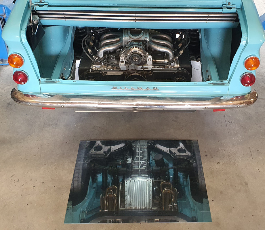

Popular Post yoeddynz Posted June 22, 2024 Author Popular Post Posted June 22, 2024 Chopping up the Imp shell took longer than expected. I'm pleasantly surprised at how solid they are for what is just a budget small car. It was also even rustier than expected and I'm glad I was not tempted to try and make something of it. I had to get this shot... ...and this shot. All chopped up... I rescued these bits. I have no idea where I'll stash them. Maybe hang the nose cone from high up on the workshop wall, led lights fitted into the headlamps. I've now got a full spare set of suspension arms too. These could come in handy as bench top jigs if I look into mounting disc brakes on the back etc. We took the remains to the scrap man the following day and he gave us $78 in return. I had paid $200 for the complete Imp so it now owes me only $122. Or I prefer to look back at the pies, cakes and coffee we both had in town after seeing Mr scrappy. Back to the Impy project. I now really only had a bit of wiring to do plus some other little jobs. Wiring first. A bit of work in the 'frunk' to clean up the fuel pump wire routing.. Drained the last of the coolant out while I was there.. glad for the handy drain plug I had added when building the radiator in. Work where the car needed to be on the hoist was over with but before I lowered the car onto its wheels I grabbed these shots which I really like.. Onto its wheels and rolled away for the first time since fitting the flat six. Wow. Pretty neat occasion in itself. Happy to see it still sat at the same height. Looking forward to weighing it in the future and seeing how much lard/muscle/festive season insulation its put on. I was now able to climb in and out of the doors easily and sort out the final wiring. Stuff to be done was running the power and ignition wires to the ecu, water pump wires and some sensor wires forward then make it look all serviceable and neat enough. I had to extend the water pump temp sensor wire so the controller could be mounted in a sensible place. Take note of this last bit as I'll be coming back to it... With the wiring now sorted I could move onto finishing of some other loose ends so to speak. But first I had to start the engine up in the car and check it worked. Which it did after I swapped the two fuel lines in the frunk about so the feed did actually feed the correct line etc - only discovered when I was under the car with a container to clear the lines out of any debris and it came out the other pipe. Whoops. So yeah. The engine just started up with no fuss on first turn of the key. Simples. Sounded great. The was no water in the system so I just ran it for 30 seconds, gave it a rev and let out a little giggle. I then painted the parcel shelf cover thing that I'd made in the last update... While that was drying I made a little lever for the exhaust valves. I started with an old pulley that I'd originally made for my V6 Viva.. Ran a long length of bicycle brake cable through from the engine bay into the interior via the routing that one of the original Imp heater hoses took. Connected the dots with a tandem brake cable inner.. Out with the rivnut tool and put a couple into the inner sill. Lever mounted... Sound levels turned up to 11, small kids scarper, nuns faint and dogs howl in the distance* when lever is turned as such. *Hopefully. Next up was filling the cooling system with water. Not coolant. I've learned from that mistake and I'm sure I'll be having to remedy some sort of issue which might involve emptying it out again. Turned the electric pump controller on and noticed it telling me the water was a balmy 54 degrees. It definitely wasn't. Its winter here (apparently) and the water was 15 degrees according to my volt meter temp probe. That bloody sensor wire! When I lengthened it by about 800mm I used 12/0.15mm gauge wire. The original sensor wires were 17/0.15. I didn't think 5 strands @ 0.15mm were going to make enough difference to change the reading but how I was wrong. So this was where I was working early evening yesterday... I rummaged through my extensive supply of cables, picked out a few that might be ideal and started with some beefier speaker cable that had many more strands. I didn't count them as tiny. I just connected it up and tried it out. Bang on! Both meters read exactly the same. I tidied it all up and we started the engine. Ran it up to temp which took ages because by now it was only about 11 degrees. No leaks and the pump seemed to bleed of air easily. Hannah took a vid of me giving it a cheeky rev. Such fun. You'll see that in the next vid. Interestingly and annoying is that the exhaust valves don't seem to do anything to the engine note at idle. Maybe they will make a difference when asking more of the exhaust? It was by then too late to go out for a hoon. I still had to fit the belts, all of the seats, the nice blue parcel shelf engine hole cover and also the actual engine bay lid. So I spent the evening finishing these tasks off. I'd love to have driven it because it was a clear, albeit cool, day. Lots of heavy rain expected the following few days. Oh well. It was great to see the interior back in. Although the recaros don't match the interior colours I just love seeing them. I like this pic. Old and new. 'West German' seats, old imp interior, sneaky megasquirt and usb cable. So this morning it was finally time for the big occasion. There were so many things to go wrong, not work, be noisy etc. We just popped a tool box in the front, plugged the laptop in and went for a drive... Wow. It works! The clutch pickup point was spot on, gear change seems fine in a mechanical way. The gearbox was quiet. No whines. The engine was completely out of tune and we couldn't really tune it properly on this short drive. We did about 12km but a combination of the very cold morning and a very efficient cooling system meant the engine wouldn't get above about 80 when on the move so for much of the drive it was still on warmup enrichment. I now realise that I should have upped the temp setting on the pump controller. I think the default is 85 degrees so it pretty much had the pump running full time. I want this engine to be running at 95 degrees C. But hey - great to know the cooling system works well at cooling. The exhaust is more than loud enough. There's no insulation above the engine cover so that will refine the interior when cruising and how cool it is to pop into a 5th gear!!! Again, due to lack of tune I couldn't really note what the gearing is like. I never really gave it the full welly because my dash rev counter wasn't working (I have a sneaky suspicion I plugged in the wrong signal wire that currently goes no where) I just drove the car and enjoyed the fact that this moment was finally happening. Hell - it was March 4 years ago that this engine first arrived on a pallet. The things that were not so good.. The clutch bite point got lower and lower until it was tricky to get into gear. Either failing slave or master cylinder. I suspect (and hope) its the MC. Its a bit fumy. Granted it was running pretty rich and the rear cover I've made is not sealed properly. The gear lever knob moves back and forth with the engine/transmission movement. Not annoying and only noticeable if you keep your hand on the knob (chuckle) while accelerating. I had figured it would because its a very slop free mechanical connection. Maybe stiffer engine/box mounts might help but then I could expect to have more noise in the cabin. The weather was a bit shit so we went home, had coffee and cake and I looked over the car. It leaks oil. Typical. It was weeping/dripping from the point between the heads and case sides where the oil drains back into the sump then running back with the airstream and spitting onto the muffler. So there's some of the fumes then. Only happens when the engine is running but its enough to be an issue I want to sort out asap. The leaks are here. This side where it leaks straight onto the cooling pipe and runs back... The other side.. Nothing to leak onto but its still getting flicked back by the airstream onto the muffler... Here's a head gasket. You can spot the drain hole. Its only pinched up at the bottom by one 6mm bolt. If I knew then what I know now I'd have added a thin smear of threebond sealant on each side of the loop to be sure. Oh well. The mess it made on the muffler. So that's where I'm at. We checked the clutch. It works fine on the hoist. Bite point still at halfway?. No obvious leaks or traces of fluid from a leaking slave cylinder. Fluid level was fine. I'll check the m/c tomorrow. We bled the system again just to be sure. Only other thing I could suspect would be a dragging spigot bearing but I cant imagine that being the case. Its a new sealed bearing. As for the oil leaks. I'm going to try removing the lower water pipe in situ and get enough room to apply marine sikaflex 291 or similar. Its under no pressure so hopefully should seal ok so long as I get it super clean beforehand. We will test it all again, leaks or no leaks, when the rain stops (rain warning for our district this weekend) but for now I am simply chillin' and relaxin' and celebrating the first drive in a flat six powered imp that sounds pretty glorious. 73 29 Quote

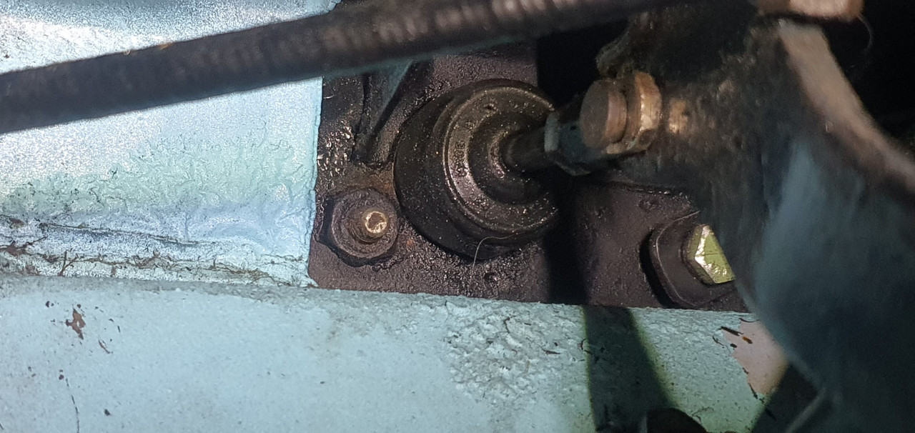

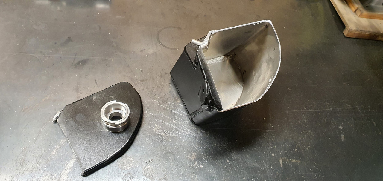

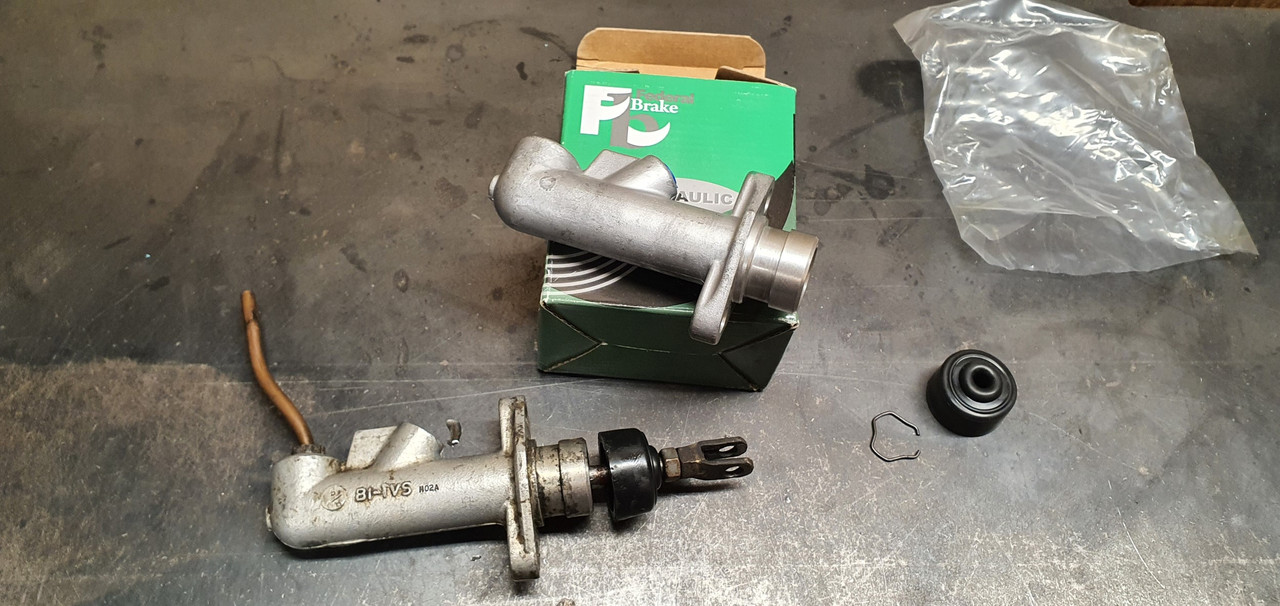

Popular Post yoeddynz Posted June 30, 2024 Author Popular Post Posted June 30, 2024 Picked up the clutch MC seal kit from town while there for the weekly shop. Got home, removed the fuel tank to gain access to the pedal box, removed the cylinder and stripped it. Like I said , its been 5 years since I last had it apart. I'd like to blame this time span for forgetting what the main seal looks like. Or I could just blame my own stupidity for not looking up Imp seal kits before ordering what I thought was the right kit in because what I'd bought doesn't look much like what I needed. Oh well. The seal doesn't look too bad, nor the bore too worn. The seal could have sharper edges for sure but it would just have to do because I wanted to go out for a good drive the following day. I'll sort out replacements for the future. I reassembled it all and Hannah helped me bleed the system, again. Seems ok so we got all the blankets that used to be in the car and covered the rear parcel shelf in a bid to quieten down the engine thrum. This morning dawned a bit chilly with high cloud. Since it was about 6 degrees I used that as a chance to further tune the cold start. Once warmed up I tried sorting out the hot start. It would always start but then die unless I held the throttle open and let it settle to idle. If I didn't hold the revs up it would stumble into in the low revs/high load area on the main fuel map and I thought that was too rich. So I leaned those bins out. Got sick of mucking about and we went for a drive. By the time we got near our morning coffee destination the sun was out and it was lovely! We had a date to meet up with another oldschooler and there he was, waiting with his small rear engined noisy toy by the beach. I took some pics. Its one of the few cars that makes the imp look large... Dylan went for a hoon in my imp and then I in his x19. The various folk about the carpark with their dogs and kids must have had a giggle. We both must have looked clown like emerging from these tiny low cars. I'm 6'2" and Dylan is even taller. It was great to try out a x19 with a proper amount of power and it sounds great. I'm looking forward to when my Imp is properly sorted so we can do some spirited cross country drives. My throttle tip in from idle was a bit sensitive and inclined to bog down making it tricky to get used to. After a good coffee we parted ways and Hannah and I went home. On the motorway (Tasman 'motorway' that is.. there's like 3 areas with decent passing lanes) I was able to see how it was at higher speeds. It cruises along effortlessly at 100kph pulling around 2900rpm. Luckily the 'its getting boring now' exhaust boom is not around that zone. I'm going to have to do some work to the exhaust and try to tune out some of the drone. I have ideas already on how. Before getting home Hannah took some driveby vids. Once home I threw them together and popped them up on the tube. It sounds great. This is the first time I have heard it properly as such. Please do it justice and listen to the vid on a decent sound system because phones won't do the low notes any favours. Once home I had a play with the off idle area of the tune. I started by adding fuel back to the area I'd removed it this morning and this improved it muchly. I tweaked it, tested it, tweaked it until it was now much easier to open the throttle from idle without going lean and lurching. Then the hot start issue. Turns out I just needed to add more seconds to the 'crank to run taper time' in idle control. 5 seconds wasn't enough. Just kept adding time until its started and settled gently down to idle. Those who have tuned their own efi projects will understand just how satisfying this shit is and also how frustrating it can be until you learn what needs to be done. So I ended the days tuning on a little high and decided to tinker no further so left it at that. I put the imp on the hoist, up in the air and checked for leaks. But for a tiny weep from one bolt area there's nothing. In fact, touch wood, this is now the least leaky of all our vehicles! 57 12 Quote

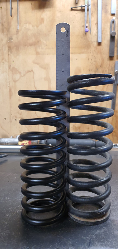

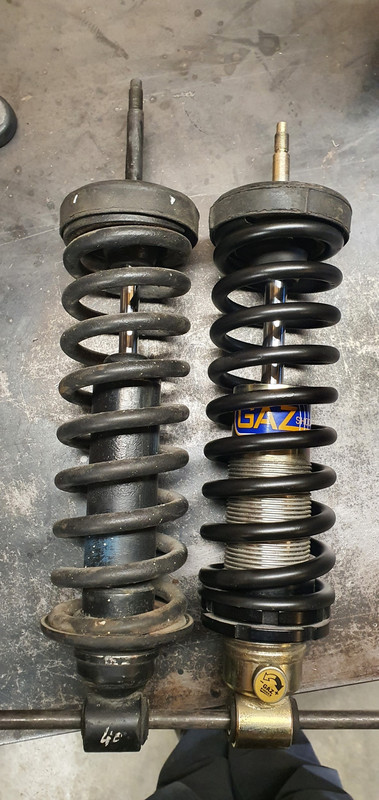

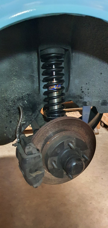

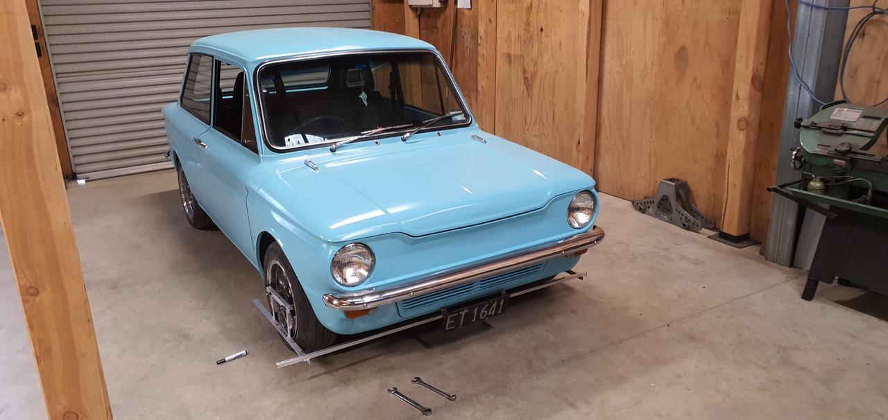

Popular Post yoeddynz Posted September 7, 2024 Author Popular Post Posted September 7, 2024 I have a confession to make. I feel dirty for what I have done and must come clean. I have raised my car Hear me out though. I know its a terrible thing but my hand was forced and it had to be done. So after my birthday cakes had been all eaten, mainly by me (little fatty), I decided I needed to look at the suspension. My front springs are essentially Rootes 'Monte Carlo' spec which means 195lb" and 9.5 inches long, or about an inch shorter, with one less coil than standard imp springs... But because I'd modified the spring perch on my stock dampers to make the car even lower it meant the Monte springs were not captive at full droop without the aid of retaining straps. These are fine in use in the UK and quite a common fitment on lowered Imps but they wont pass the muster here in NZ for certification when that time comes. I also had a total lack of any height adjustment without resorting to various spacers beneath the springs etc. So I started looking at various coilover kits made specifically for the Imp. There's at least three brands out there that do kits, all made in the UK and all quite expensive once freight is added into the equation. Luckily I ended up chatting to a fella called Frank in Australia who I've bought stuff from before. He imports and sells Gaz coilovers as well as loads of other Hillman based items. He had a near new front pair he was removing from one of his Imps and offered me a good deal on them. They are the 'short' dampers to suit lowered imps and he was including the appropriate 'super low Monte Carlo' springs. These are 8.6 inchs long and needed if I wanted to keep my Imp sitting nice and low. So while they were on the slow boat from Australia I started looking into the rear shocks. The stock Imp items were working ok but I knew that one was low on oil and not ideal in action. I was informed that Nissan Navara D21 front shocks were an almost straight swap so I got a shiny almost new pair from a ute at the local wreckers to try out. To my surprise they were actually considerably softer in damping than the Imp items, both in bump and rebound. Still, I had them to try so I machined up some suitable spacers to suit and the smaller Imp bolts and the top bushes.. Bolted them in place and went for a drive. Nup. I don't like. Too soft and a bit too wallowy. Passable for normal driving on smooth roads but start driving with a bit of enthusiasm and the back end starts getting a little bit flighty, especially in sharp compressions. I would have to sort something else out and started looking into ideas. Then the Gaz coilovers and super low springs turned up. Here are my standard Montes next to the super lows. The same coil count and rating but just set shorter. I wanted to test them just to be sure so things got a bit scientific.. They were rated exactly as they said on the tin. The Gaz dampers and superlow springs showed the overall length from bottom eye to the top of the spring to be very similar to my modified dampers and standard Monte springs. Things were looking promising for me to keep my Imp at the same height. So I fitted them.. I then removed my retaining straps and the arms dropped further, so releasing my springs from captivity I had to wind the collars up 15mm to hold the springs from rattling about. Oh well. I suspected I might end up in this situation. On the bright side it does mean the excessive negative camber has been removed and I also wont be smashing so many hedgehogs/other roadkill with my license plate. I went to sleep and had nightmares about my new lofty height. This morning I revisited it and replaced the absurdly thick, what look to be just generic damper top mount rubbers with my old stock Imp items. This moved the shaft fixing up 5mm so allowing the collars to be lowered the same amount. So I now have a 10mm extra ride height with room for adjustment and completely captive springs. The camber is about bang on for what is recommended on a road imp. I took it for a good drive to try them out but I'll talk more about that soon. Moving back to the rear dampers. I removed the soft Navara items and looked at my leaky unit. The shaft has a small amount of light corrosion just below the bumpstop. Although it was fine when I'd fitted the shocks, 13,000kms thereabouts of driving since has seen it lose fluid. I had a plan. They are pretty common designed double walled units. There is a gap between the outer tube and the inner tube that the piston slides up and down. As the shaft enters the damper the oil height increases from displacement. This cavity was down on fluid. I drilled a tiny hole near the top, through the outer skin and whilst extending the shaft out I added oil with a small syringe. I then tapped the hole and fitted a small machine screw and O-ring. The shock works perfectly enough now, at least until I get some replacements. Now it was time to look at the rear ride height. The new engine and gearbox is at a guess something like 20kg heavier than the Datsun setup. I'll have a better idea next time I weigh the car. Its enough that the car has sunk maybe 5 or 10mm. Not a lot but combined with the higher front it now had a distinctly nose up, bum down look that I'm not keen on. Plus I'd like the driveshafts to be a little straighter. They were heading slightly uphill to the hubs with the angle getting steeper as the rear squats under acceleration. The rear springs are standard 1" lower, slightly stiffer Monte spec. So I made some 15mm spacers. Probably only needed 10 but I can machine them down. It now sits as such. Bum slightly up. Half a tank of gas. Exactly no bags of cement thanks Barry. Hannah measured both front and rear arch heights as I sat down into the car and shut the door. Interestingly, and I think quite a good thing, is that the car drops 10mm equally front and rear. I'm going to try this new setup out before deciding if I skim my spacers down. Another important issue I really wanted to sort out was the exhaust drone. Every time we would take the car for a drive the drone was overpowering. I wanted to believe that we'd get used to it or learn to drive around the drone zone of roughly 2300rpm but it was futile. It had to be addressed. Mention of J pipes, resonator pipes or 1/4 wave resonator pipes or whatever name they might have was mooted by several people. Not just on for this car but also on other peoples threads and on the oldschool exhaust discussion thread. I read up about them and they sounded like an ideal potential solution but I really just didn't have any room to fit them between the exhaust box and the headers. But how about inside the box? Extend the inlet within, tee off from that to the outside and use an elbow to send pipes forwards. I looked through my collection of random stainless tube fittings.. Something like this?.. Hmmmm... it could work and was worth an investigation. Car on the hoist and within 5 minutes the entire exhaust box was removed. V clamps are fantastic. I removed the gazillion 6mm bolts, broke the silicone seal and removed the lid. Some measurements were made and a holes were cut as neatly as I could with the plasma cutter. I hole sawed some stainless tube that matched the inlet diameter.. Welded a slightly smaller 32mm pipe and fitted the tees into each end of the box. Pulled out the heavy length of 50mm 304 stainless bar and cut off some discs Those I machined up into stepped flanges. 4 holes drilled and tapped in them to suit and then welded onto the outlets on the box. The J pipes had the other flanges welded on via the inside.. Above the new Tee pipes within the box end expansion chambers I added a shelf of stainless perforated sheet that bolts in place and then filled the void above with more packing. This was just another way I could absorb some sound.. Lid was siliconed back in place and bolted down. Now the J pipes. I fabricated those up with the bends and made them as long as I could. There are multiple websites with ample information on how to calculate the required length depending on engine rpm, frequency, cylinder count etc etc. But they are usually dealing with exhausts that have just one main exhaust pipe to J pipe off from. My setup is like two 3 cylinder engines really with their own separate exhausts. I wasn't sure which calcs to use. But pretend I have just one exhaust feeding off both banks I was looking at a J pipe length of circa 800mm. I figured I would halve that and my finished J pipes came out at just on 405mm with the ends almost meeting the rear arch inners. I figured I can always chop them down in length so better to start as long as I can. I found some ideal stainless penny washers for the end caps.. J pipes installed... They are a bit ugly though. Although I can't see them from within the engine bay they are easily visible outside and I don't like seeing them. I have also never really liked the way the box ends don't tie in with the back corners so I had an idea to try. I carefully made these stainless guards.. There were already some useful holes I had added to the valance lip for the Datsun exhaust.. Guards/ugly pipe hiders in place... Time to try it out. I was pretty confident that there was going to be some amount of noise suppression but how much ? Upon start up we could both tell it was quieter. Took it for a drive to go pick up yet another customers rusty Hiace for work and yes - it was quieter!!! The drone was knocked right down. Its still there at certain loads but no where near as horrid. Now as per the earlier mention of a drive to try out the new front shocks. Well it was also a good chance to try out the exhaust. This time I was sans Hannah. It meant I could thrash the car to my hearts content without Hannah having to cling on for dear life. There are no grab handles in the car and the Recaros only hold you so much. I took the laptop though and used it as a chance to let the autotune see some of the more extreme areas of the fuel map. 30kms of twisty hillclimbs local to us and a good solid use of the throttle travel. Damn its fun. The exhaust is much better drone wise but I almost want a little more sound. From inside the car its still more straight six than flat six. I'd like more of the guttural, raspy Porsche flat six sound. My exhaust/engine sounds smoother. A bit of this could be because its water cooled and the Porsche 911s I like most are aircooled (and usually twice the capacity...) They are almost clattery at idle, slightly hollow. I do some have other ideas floating in my head about future exhaust designs. I know these engines can sound more 'Porschey' but I don't have as much room to play with as the bikes I have been viewing. But wow- this engine is a little gem. I'm tending to keep it in gear for much longer between corners because its so smooth at high revs whether I'm on or off the throttle. It'll be much better when I build my new dash and have a rev counter right in front, that's for sure. The gear change is getting better and better with use as the shaft bushs loosen up a bit. I have ideas for improvements too but no rush. Its a delight to drop from 3rd to 2nd, a gear change that can make or break the fun to be had in a car driven hard on hills I feel. The program managed a good amount of changes to the fuel table and its pretty good now. Start up hot or cold is great. Just a few bits to smooth out. I'm going to tweak the throttle plate stop screw and idle bleed appropriately. I think the throttle disc is a bit sticky when closed which doesn't help for light throttle action when trying to move off slowly. The rear navara shocks, as noted previously were not helping. Looking forward to the next drive now I have originals back in, complete with all their oil. The front shocks are actually about the same as what I had originally. I have set the damping to what I feel is about the same as the originals. It really doesn't require much damping in the front (unless some internet Barry has finally managed to persuade me that 3 sacks of concrete in the front really is the way to set up rear engined cars) I am going to dig out the go pro, hope the batteries are not dead and try to get some better camera angles along with better exhaust sound representation. I really want to hear what its like from outside with the new exhaust and better tune. 59 Quote

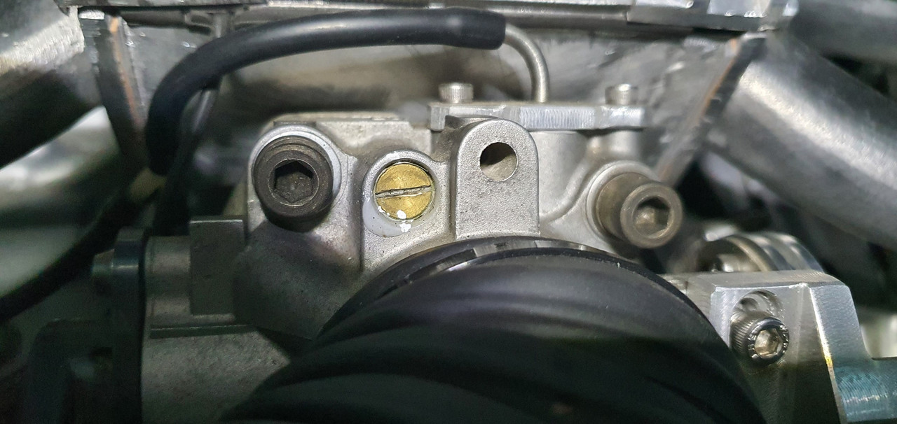

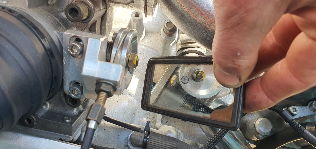

Popular Post yoeddynz Posted September 15, 2024 Author Popular Post Posted September 15, 2024 After my last long wall of text I'll try to keep my updates more frequent and smaller. The throttle was a bit sticky and made gentle opening awkward. Parked the imp outside in the sunshine.. Removed the access cover.. Adjusted the throttle stop screw about a half turn in. Just enough to stop the throttle plate from sticking. You can see it here with a mirror... Then wound the idle bleed screw in and touched up the tune around the idle area on laptop from the comfort of the rear seat.. It's now much better in action and way easier to drive off. Although I'm happily getting the last bit of wear out of the old tyres and they always feel super stable and grippy when getting low, like a semi slick, they most likely wont pass another wof test. They have always worn on the outside which I found odd considering the amount of negative camber. I have always swapped them back to front regularly but they still wore as such. I thought I best check the toe angle. I'd previously done it with string. Not the best way and quite a faff. So I made these measuring jigs up.. They bolt in place like so... Making it much easier to check the toe angle very accurately.. Turns out I had set it pretty close. It was a little bit too much toe in so I adjusted it out to suit the specs and I'm happy enough now to get some new tyres soon. Another small job I should have done years ago was to make some form of face level ventilation. My imp gets quite fumy if I open a window. I had asked on the facebook Imp owners group and it looks like its an imp thing that most folks cars suffer with. You have to hermetically seal the back end up of every little hole and gap to try avoid it but its tricky and my imp is possibly worse now with the centre exit exhaust outlets. I just had to do something about it. I got this lot.. Cut a hole here in the plastic ventilation pipe the comes from the fan/pickup and heads to the heaterbox.. Pushed some alloy tube wrapped in gator tape into hole... and popped the flexi alloy ducting in place... I'll look into teeing the ducting off and run some to the passenger side as well. I need some neat little eyeball vents which I'll then fit into my new dash layout I have planned. But even this alone is a game changer. Even just driving up our driveway I could feel the flow of fresh air. Sooooooooooooooo much better. Wish I did this years ago! Final bit for this blurb. From the very first time I started the engine on the bench there has been a little random whistle. It didn't bother me at the time because I was just so happy the engine ran tbh. But now its annoying me. Its not there at idle. Only when you open the throttle a bit from idle will you get a little squeak or if driving and it goes under a moderate load it can be quite loud. Off with the access hatch again and with Hannah driving the car I tried to pin point where it was coming from... Once home I continued the search, checked all the bolts, used bluetack to seal any suspicious gaps but no luck. I've not nailed the spot but I think its around the plenum chamber or possibly something funny in the throttle body. I got annoyed, gave up and we just went for another hoon to the beach for walk. 36 Quote

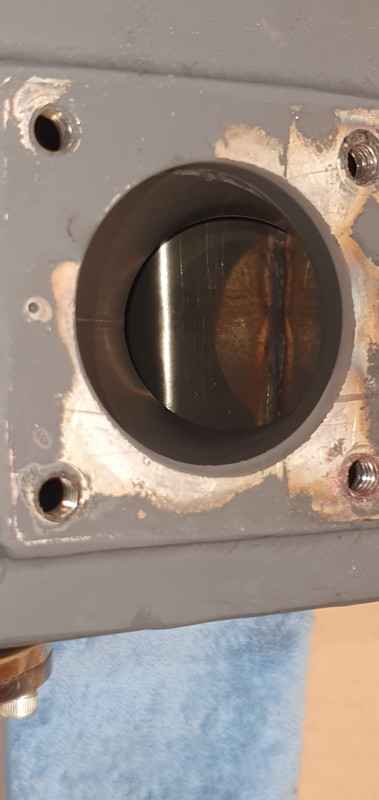

Popular Post yoeddynz Posted November 3, 2024 Author Popular Post Posted November 3, 2024 Bloody hell time flies. I'd better do an update. That noise. I took the throttle body off again and taped up the various superfluous holes.. Went for a drive and the sound was almost completely gone. Just a hint at certain load points under very light throttle openings. So it was indeed created by air passing over the holes - much like blowing across the top of a beer bottle. Took it off again and filled the holes with JB weld epoxy.. I was now left with one remaining outlet that feeds air from the IACV into the throttle body. This one is the cause of the occasional 'hoot' sound at low throttle openings, higher load. Possibly the sharp edges could be transitioned out to curves which might help. Its not enough to bother me though, especially as I now know what's making the sound. Just happy I don't have a vacuum leak. Onto more fun jobs. The custom dash instrument cluster I want to make. Ages ago I'd got these instruments from a V6 engined Mitsi Pajero. Electronic speedo head, with analogue odometer. Very similar to the Toyota items of the mid to late 90s that I had used in my Viva V6. I took them out... Carefully popped the needles off using the two teaspoon method... Knocked the internals down in size including removal of trip meter part.. Machined up some barrels from alloy to suit ... ..as well as some rings for spacing the gauge faces away from the acrylic fronts I'd cut out. The needles were cut shoorter and the gauge faces cut down in diameter. Once tested and calibrated I'll make now faces with a more suitable looking classic font and style. I assembled them and stuck them onto a makeshift shelf on the dash for testing... I then machined up an adaptor with the required m20 thread to suit the Subaru transmission... Screws in here... So a Toyota electronic (hall) speedo sensor can screw on top.. Went for a drive. The Rev counter works fine straight off and matches the rev counter readout on the tuning program. The speedo reading is much closer than I was expecting considering I don't know what the gearing is on the transmission speedo output. The speedo reads about 10 percent out but does progressively go further awry as it gets closer to 100kph. When we next have a chance on a long smooth road my intentions will be to mark the speedo face using a GPS speedo as a guide for accurate speed (the Imps original strip speedo is terrible, wobbly and not accurate at all) But none of this will happen for a little while because the clutch slave cylinder I thought I'd repaired decided to give up and make a puddle at the local fruit stall yard. We had been in town shopping and I could feel the bite point getting lower until the gears started getting very hard to select. Luckily where it finally gave up was only a few kms from home. I started the car in gear and managed to get home. This then happened that evening... So it was time to swap back in the Datsun engine for a short while. I have clocked up 680kms on the flat six so its probably a good time to pop the sump off, check the oil pump chains have settled in nicely etc. There's a couple of spots between seams that weep oil so I'll clean them up and re-seal. It actually barely leaves a drip though and the transmission is completely leak free. So the Honda is now out and sitting on the engine wheely stand 2000 TM. I made notes of all the various stages of removal, accounting for time spent and detailing anything that could be improved or tidied up. I'll re-write the notes in order so avoiding needless hoist ups and downs just to undo one bolt etc etc. As it was it took just 2 hours to remove the whole Honda engine/transmission/exhaust/gearstick/cooling bits. I then had to adapt a few bits for easier swaps such as wiring up the Datsun loom (all 5 wires..) to suit the plug that also serves the Hondas temp/oilsensor and alternator etc. The wiring is now plug and play. The axles also have to be swapped which is easy. Before I plonked the Datsun back in place I really wanted to weigh it. I popped over to the farm across the road and nabbed our engine hoist back from their shed. Removed the Imp transmission and then carefully lowered the engine onto the scales... 105kg. You chunky little monkey. Granted that is with everything in place inc clutch and exhaust headers. Google reckons a bare A12 engine is circa 80kgs but I was never sure. Now I know exactly what it weighs. I weighed the Datsun cross member, starter motor, exhaust box and even the stock gear shifter arrangement. Anything that was different to the Honda setup. I also weighed the stock Imp transmission. I noted all the weights down in my Imp notebook and consulted the weights I'd put down for the Honda engine and scooby box. The Datsun engine and imp box setup inc its specific driveshafts, exhaust system and gearshift setup comes in at 156kg The Honda and scooby box with its modified CV driveshafts, exhaust and modified gearshift tips the scales at 170kg I was quite pleasantly surprised at this and it does tie in well with the weight I'd got when I recently had weighed the car at the local weigh station where it was about 40kg more than when I first got the imp on the road over 5 years ago. Allowing for errors/weighbridge accuracy and the heavier Recaro seats I have added it looks pretty legit. Happy with that I plonked the Datsun back in place, a process that went smoothly. I ran the low pressure carb fuel pump up front into the efi return line to the carb. My original Datsun coolant hoses still worked perfectly with the stainless pipes exiting the rear bulkhead that I'd modified to suit the Hondas EWP setup. Swap a couple of wires on the fuse box, remove the efi fuses and turned the key. The Datsun started first turn of the key and settled down to a smooth idle. It actually sounded really neat. I checked for leaks, refitted the engine cover on the rear parcel shelf and took it for a hoon. God it feels slow and its so quiet. But its bloody lovely though. The gearshift is so sweet. Lighter than the Scooby box (although I have some ideas on how to improve its action) So that's that. Back into its little garage for now. I need to get some new tyres and then get a fresh warrant of fitness sticker. I'd forgotten to mention earlier that I had taken it out to show the local retired certifier who is leaving his day job and will be getting back in certifications. He loves it and thinks its a very neat transplant. I've run through a few bits that I know I have to add or change to pass the cert and hopefully some time next year it'll be first on his list. Fingers crossed. Good little Dastun... Back into its home.. 56 1 Quote

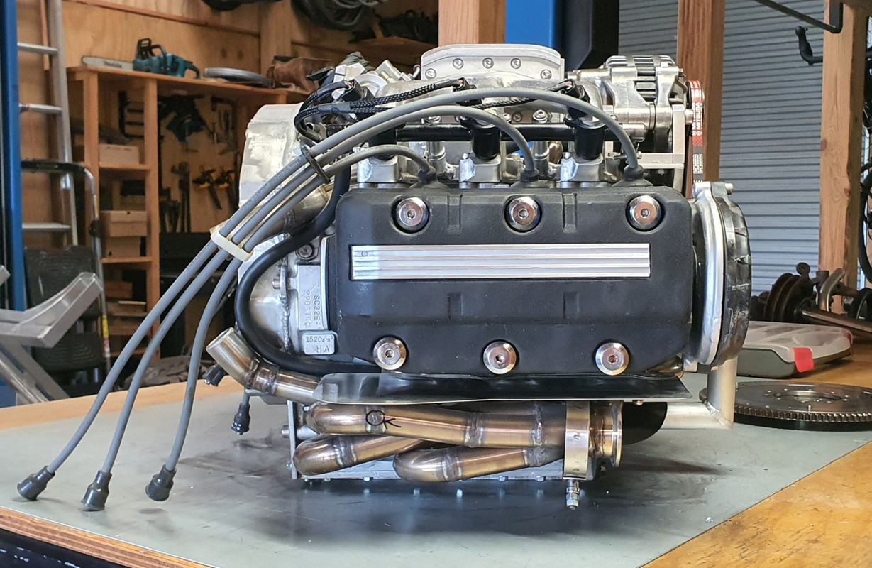

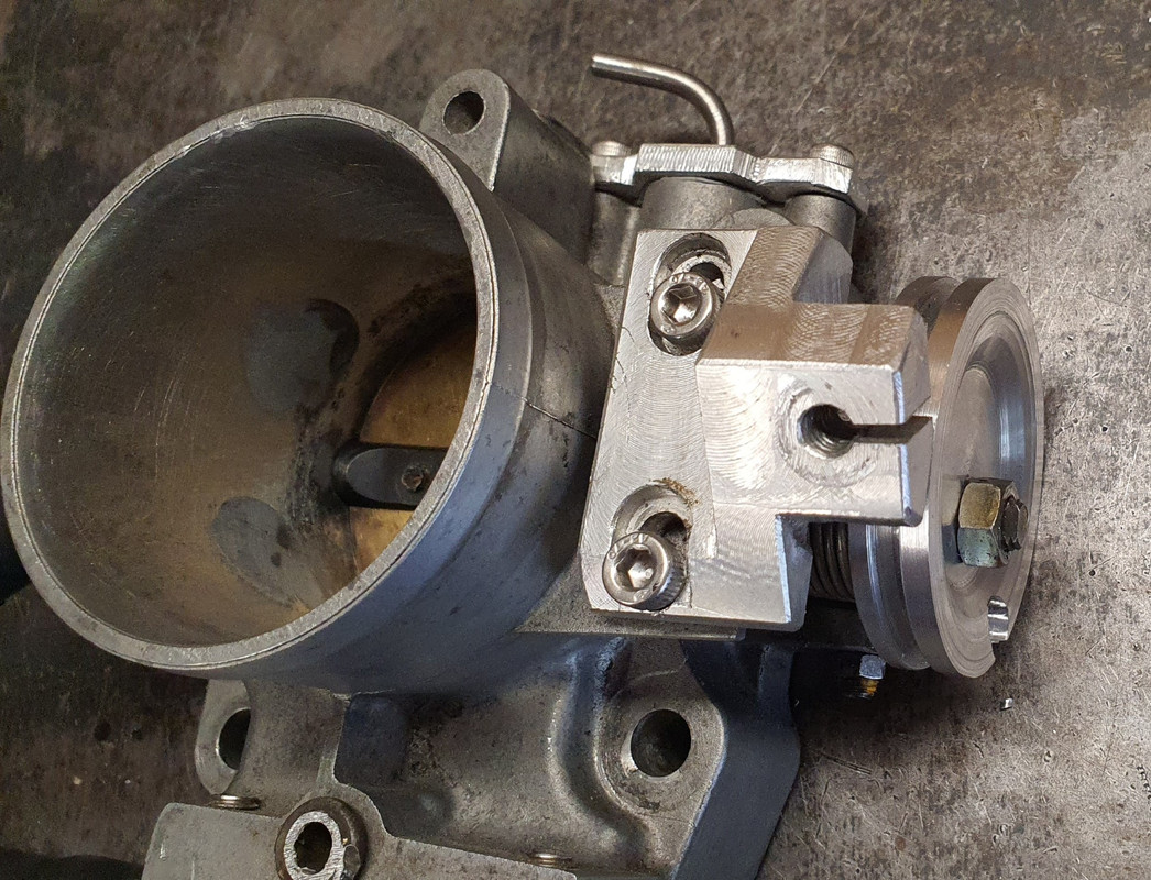

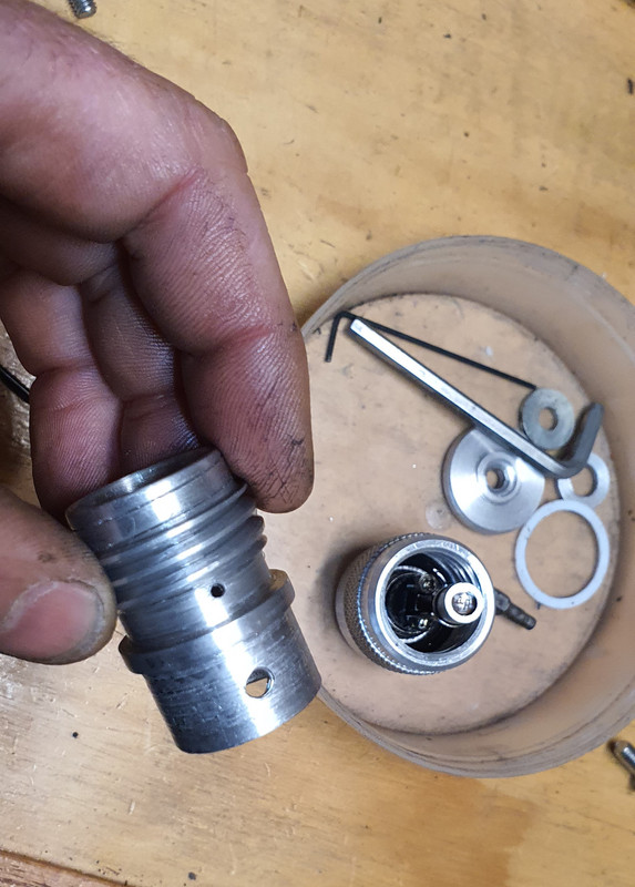

Popular Post yoeddynz Posted December 24, 2024 Author Popular Post Posted December 24, 2024 I've been whittling away on various things I wanted to repair or upgrade on the Honda engine before re-fitting it. First thing was the throttle body pulley. Even thought its an off centre progressive design its not progressive enough. So I made another and offset the centre hole a further 5mm. I had to slot the cable outer barrel adjuster bracket further to align the cable entry. I then popped the engine onto the big wheely table. Easy as because I made the engine stand the same height as the table and work benches.. Remember the nice alloy garnishes Id machined to fit on the cam covers where there used to be plastic badges. They looked lovely. For a while. Because on about the 2nd drive the double sided tape decided it didn't like heat and they both fell off onto the road not far from us. I did manage to locate one of them but it had been driven over a few times and looked a bit sad... So I had to machine up some new ones... This time round I painted them alloy silver and then sanded off the tops. They just looked nicer for it. I then glued them in place using some Sikaflex. I don't think they'll fall off now. In place.. Next job was the one I deemed most important. I discovered upon stripping the engine 4 years ago that they don't have very large crankshaft thrust bearings. They don't really need to because there's no clutch forces exerted upon the crank,with the Goldwing clutch unit being on a separate layshaft. It was something I had never thought about before getting the engine and its played on my mind the whole time. I consider it the weakest link. I may well totally be a non-issue but I'd rather see if there was a way I could help it last. There's about .006" of thrust movement stock - measured as such... I had thought it out and came up with a simple solution involving some expensive, hard, slippery engineering plastic designed for high heat. This was sandwiched between the rear engine plate and the back of the flywheel and had just a few thou clearance so being a backup thrust bearing when the clutch is pressed. Help share the load I thought. The plastic thought different. I knew it had decided to leave the party early because I could see its melted edges through the bellhousing drain hole. But how bad it was I wouldn't know until I removed the flywheel.. lol... Ha. So that didn't work as expected then. Version 2 time I've been thinking about this a while. I looked into very large, thin section thrust bearings. Found an ideal item in the UK but it was 1300 quid. Back to my drawing board. I came up with an idea that uses $10 bearings. I needed a big chunk of alloy to machine up. Local alloy stockist no longer sells 16mm alloy sheet cut to size. They want to sell me a square metre. I went to a Nelson based fabrication outfit that has a water jet and the nice fella gave me a bloody large section of 20mm alloy. I only barely fit into the frunk of my imp (so improving the handling no doubt..) Cut it to size in the trusty table saw that has amazed me.. Into the lathe where I created a massive amount of swarf. Milled out some slots.. Drilled some holes. Very critical this one! They had to be bang on. Machined up some tiny pointy domed sleeves for the bearings.. Assembled it (notice I'd even got out my surface table for marking duties) I shimmed it out, testing and measuring until I had about .005" thrust. Just enough so it'll only touch when the clutch is pressed in. Finally in place... The other main job to do was sort out the reason why I had ended up removing the flat six in the first place. That leaking clutch slave cylinder. Even though I had made an alloy plate to support the mounting face it was not burly enough. This coupled with the fact that I had already burst the slave cylinder previous and its was never squished back together as neatly as it could be. So I reluctantly shook the moths out of my wallet and bought a brand new slave cylinder. I than machined down the mounting points I'd added to the Subaru transmission to allow for a steel clamping plate. I don't expect to have any issues with it now ! I then flipped the engine on its end and gave it a clean around the head gasket seam on the oil return galleries. Its always weeped a tiny amount of oil on both sides at these points... Not enough to drip but enough to slowly make a mess and run down the sides. Not very easy to clean and seal with the engine in the car. Now's my chance. I masked the areas.. Then another Sikaflex product was used.. Sealed up.. I'll see how it goes. Another job that I decided to leave was cleaning up the window on the Mandolorian spaceship. Now that's not something you'll hear many mechanics say But its getting a bit oily inside from general fumes, as I expected it might. I undid the machine screws holding it down but it wasn't going to lift off easily. The foam seal has stuck it in place. I knew if I forced it would crack. Maybe a job for another day. ot important now. At least they are still visible and the leds still light it up nicely. Exhaust box had one baffle that was vibrating at idle. Very annoying. So took it apart and fixed it. Gearbox mounts were knocking the subframe so I gave them a tickle with the cutoff wheel and welded them back up. The gear linkage rod linear plastic bush is something I want to improve in the future with a proper linear bearing and some seals. But for now it got a clean and some grease. I also installed a hotter thermostat. Up from 82c to 88c. So with these jobs done and the weather forecast of two days of rain I set about removing the Datsun engine. I timed myself and it took about an hour because the rear valance has to be removed. swapped the driveshafts across. About 45 minutes because bearings need to be swapped too. I might get some new bearings so both axle sets have their own. Then bolted the Honda in place. This took 15 minutes. Smug faced me then realised I'd forgotten to attach the first part of the gear shift shaft. Whoops. Back out, fit shaft, back in. Plugged everything up and went for a starter turn to build up oil pressure. But starter kept blowing the 10amp solenoid fuse (I'm so glad I actually made a circuit just for the solenoid now!) I'm not sure what was happening but I took the starter out stripped it, cleaned it, pondered it, reassembled it and it then worked fine. Now a engine turn over. Whir whiiiiiir whiiiiir whiiiiir. Something wasn't right. It should turn over quicker than that! Took the engine out again. Removed the box. Engine was hard to turn over. Removed clutch and flywheel to discover that the clutch bolts were just protruding through enough to rub the alloy thrust bearing 2000 plate. Whoops. So I clearanced the plate, flap disked the protruding bolts down. Reassembled and all good. Bolted the lot back in, tested the starter and this time its turned over fine. With the clutch bled, the fuel lines etc attached I started the engine. It started up mint just like it was running yesterday. Tested the clutch. The thrust bearing 2000 rollers made a sound not unlike a noisy clutch release bearing and initially I was thinking 'well that won't do!' but they soon settled in. Still a noise but I know what it is and why its there. Better then potentially wearing away the crank thrust bearing So with the engine all back together and in place... So we went for a drive. Coolant still doesn't get as hot as I'd like to see but it could be that the pump controller had reset to the default so I'll have a play there. Otherwise get an even hotter thermostat. The engine runs fine. The new throttle body pulley makes for much easier driving off from standstill and smoother when crawling through our local village with the many speed humps. But the fumes from the exhaust getting sucked into the cabin when we lower a window is terrible. Its the number one fault now. I have tried blocking off the through flow vents sited just above the rear window but its not fixed it. The gearstick base plate has a gap - could it be possible there's a low pressure zone under the car and the gas can creep forwards along the tunnel and enter there? I'm going to design and make a new exhaust muffler setup. I'm still not happy with the exhaust sound and low rpm, it still drones and only really sounds like a flat six when above 3500rpm. I know these Goldwing engines can sound much better. More Porsche. Less Cifero. Possible benefit will be less fumes if I go side exit exhaust. The Datsun has a side exit and its much better with regards to fumage. I'm also not entirely happy with the look of my current exhaust box either. So I have taken some measurements and will start doing some design sketches along with more research. 49 Quote

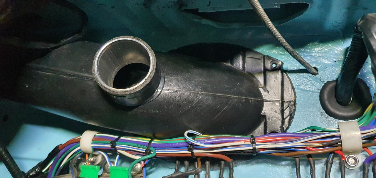

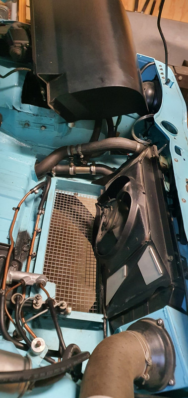

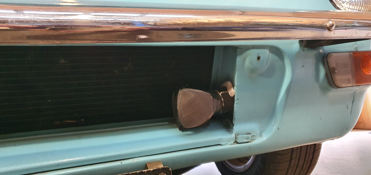

Popular Post yoeddynz Posted December 31, 2024 Author Popular Post Posted December 31, 2024 Because I'm such a hardcore party animal on new years eve here I am doing an update. The imp needs more fresh air via face vents. See this grill here.. Removed there's this... Air inlet for main ventilation system is here in the left.. I wanted more air. So on this side here... I cut a hole.. Filed it smooth, painted the edges and moved on up to the passenger side bulkhead where another hole appeared.. From the inside, once cleaned up, matching hole in bulkhead cover and fire extinguisher moved below the shelf.. I'll connect these holes with more 2" alloy flexy tube and create some sort of scoop/nasa style duct to help channel air at entry point. Moving to the back. I have never really fully clicked with the look of the all black leather covered rear bulkhead garnish that I'd made to hide the access cover above the engine. Its a bit too much black which makes the bay feel smaller and darker.. So I removed the lower half of the leather right below the bottom alloy strip... It was stuck on harder than I expected. Then spent ages cleaning off the contact adhesive residue left.. Prepped it for paint, masked it up and set up the paint shop.. Sprayed lots of blue about with most of it hitting the target and leaving my characteristically custom 'leather pattern paint finish.tm' ..... Once set hard enough enthusiastic me could remove the masking tape and fit it in place. It looks much better me thinks! ... There's a side panel I want to make next to tidy up the drivers side inner bay and I'll be pretty happy with the bay then. 38 Quote

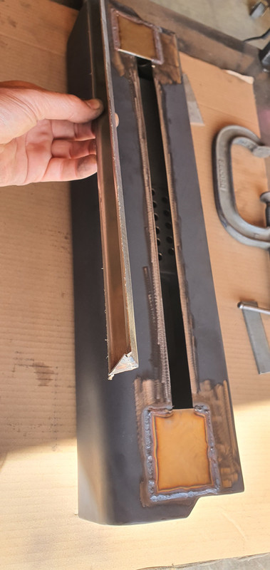

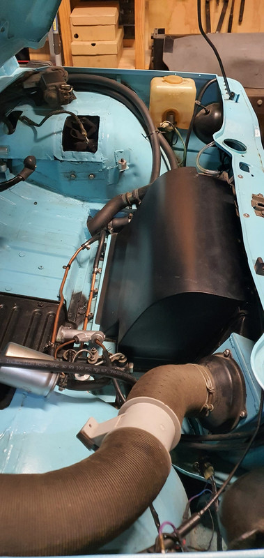

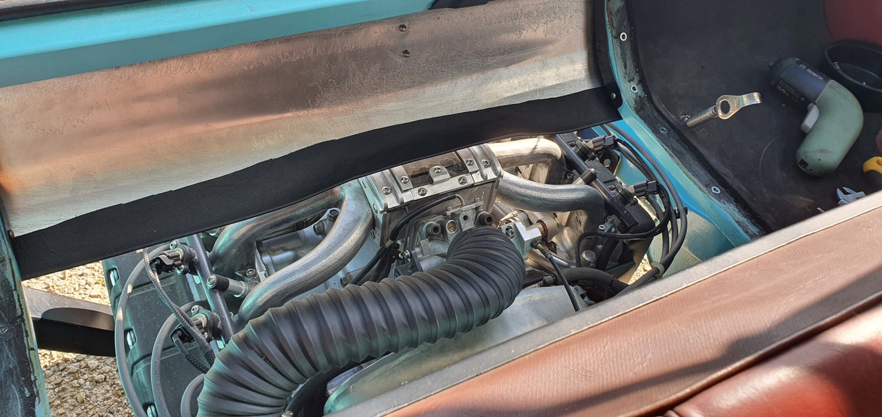

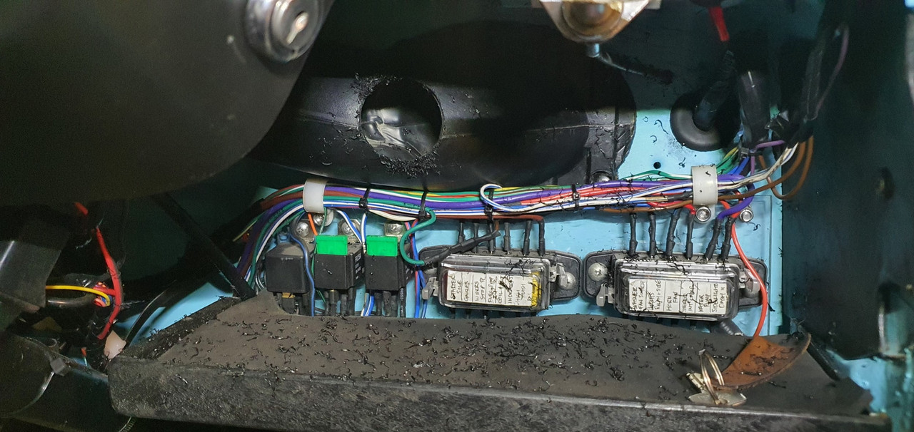

Popular Post yoeddynz Posted February 18 Author Popular Post Posted February 18 Still been clocking up the miles on this and its been great fun. almost 2 months since last update. been doing summery things and Hannahs mum has been here the last month so holiday mode all round. As I'd mentioned in the last post there was a cover for the right hand side of engine bay to make. It covers the messy internal panel that has grommit covered holes left over from heater pipes plus a functional, but not very pretty repair section. I made this.. that goes here.. Next up was the sound proofing and fit some carpet. I removed the seats and gave the floors a clean. I'd bought a large roll of self adhesive bitumastic type sound deadening stuff from @Bling ... Quite a fun job cutting out and applying this where ever I felt the panels could 'thrum' or 'ping' from vibrations. I also added it to some other areas where it worked to smooth out factory seams or welds so making the leather covering job to follow easier and neater. I used a mixture of leather and fake leather to cover the inner sills and wheel arches.. The wheel arches are a kind of complex compound curve and couldn't be done with single pieces so I dusted off my 1979 Pafaff sewing machine. With some folded over edges then sewed I was able to make a neater job of anywhere that the coverings overlapped. With a bit of masking tape I carefully applied contact adhesive.. Then started the covering job... I'd bought a roll of automotive carpet quite a few years ago and its been waiting for this moment for a couple of reasons - when I knew there would be no more changes to the floor layout and when I felt confident in my British car to not let any water in. I covered the tunnel first and then made floor mats to suit. The passenger side floor sits higher by about 50mm due to the false floor over the coolant pipe channels. I made the mats over lap and the drivers side was shorter so not to get squished by the pedals. I'd put some vinyl on the floor behind the pedals to neaten that area up. Under the carpets is a firm foam underlay cut to shape. All easily removable for cleaning or work. Sewing time again. I'd bought some heavy cotton in the colour I wanted and cut strips from it. Folded over and double backed then sewed I carefully edged the new mats. Not perfect as it was pretty tricky and I went through a few needles until I honed the method. Happy with the result though! I also made rear mats and a mat for the rear parcel shelf which also got edged. I ended up having just enough carpet to do the lot. Phew! Finished result.. I had a car show to go to. The Moutere Hop. I decided to have another go at removing the Mandalorian windscreen.. Success this time. The foam was squished into more like a double sided tape but a thin butter knife was ideal to slice it through. The windscreen was pretty oily brown from the airborne residue that sneaks through the breather catch can. But it cleaned up great and the screen looked much better. It was super clean inside.. I'll see how long the lid stays clear. I think after the next show I may well remove the Mandos from their role and make a permanent alloy lid. Maybe... I'll see. It is really quite fun seeing peoples reactions upon them spotting the lights and figures. We went to the show. I gave the engine a quick clean.. The car also seemed to have people around the back checking it out whenever we looked. Lots of interest and really nice comments from those I spoke to. I'd scribbled down a basic list of the details and info on some A4 paper that morning at the show and stuck it to the bumper because no one could work out what the engine was from. I think I'll do a better info board before the next show in a few weeks. It was a stinking hot day so we left the show early and went went for a decent swim at the Motueka river. Good way to round off a nice day out.. 52 Quote

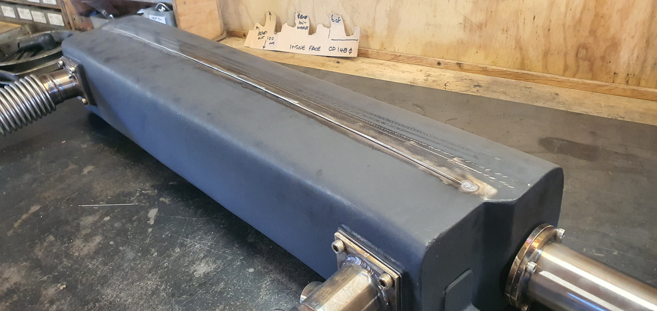

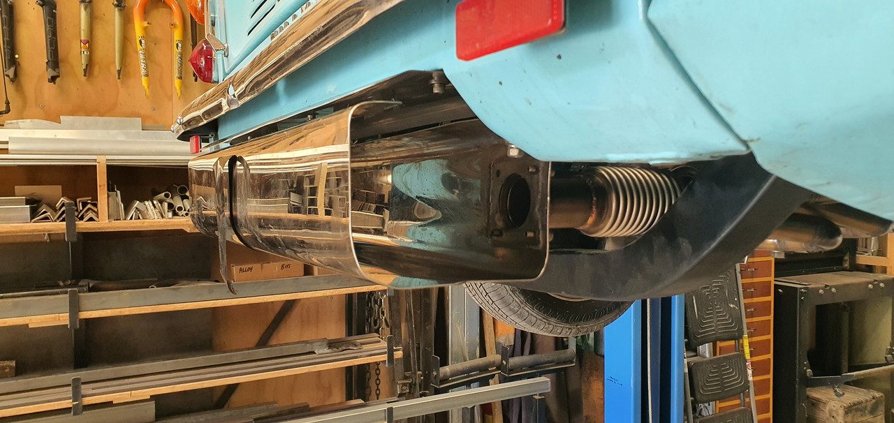

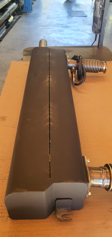

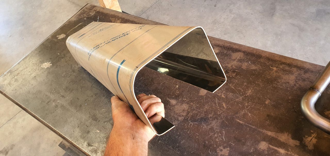

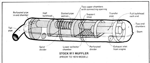

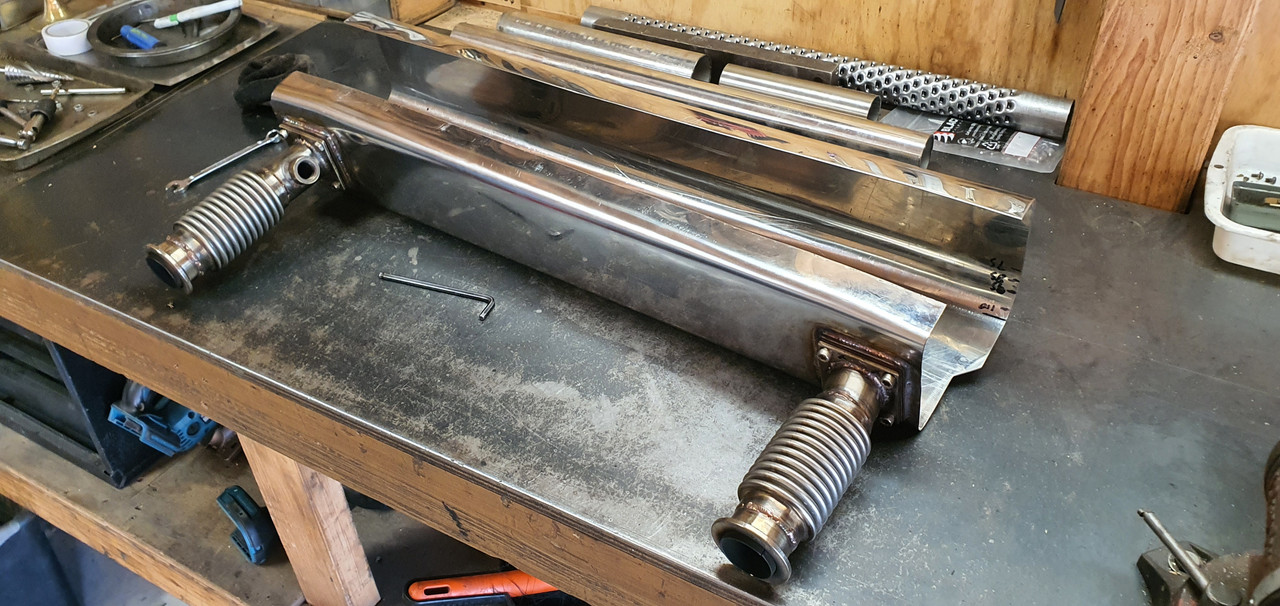

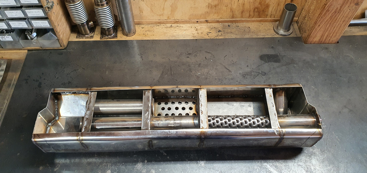

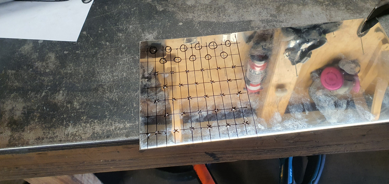

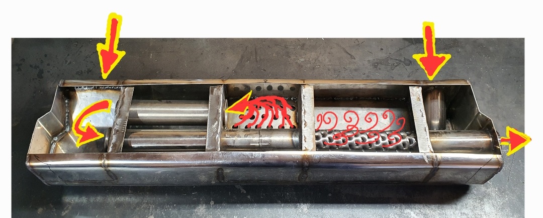

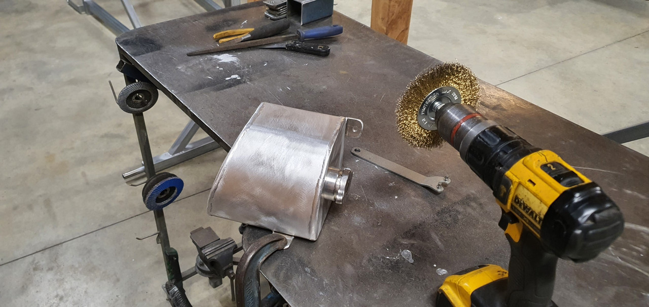

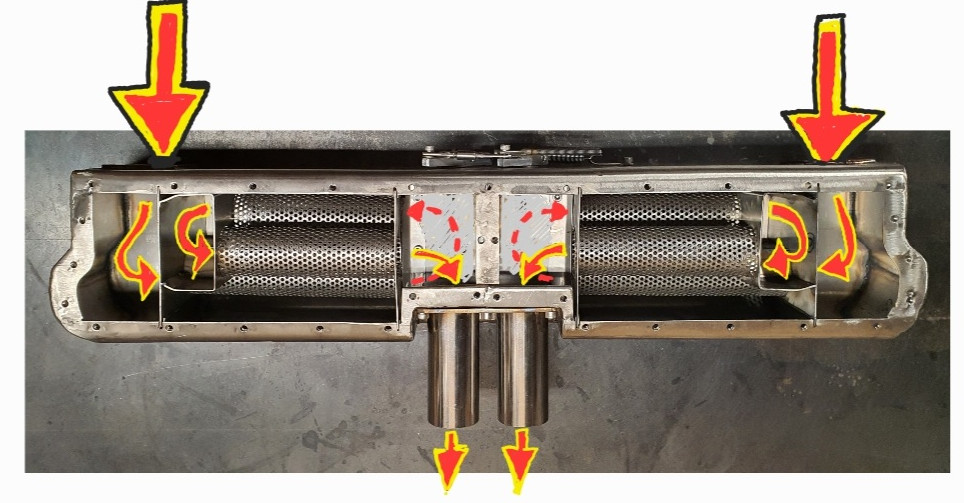

Popular Post yoeddynz Posted March 11 Author Popular Post Posted March 11 Exhaust box part two, take one. Chasing a more Porschey sound and also move the outlet to the side for less potential fumes being drawn into the cabin when a window is down. I have been studying various classic and modern 911 silencer boxes and decided I'd do my best at replicating the original design which looks like this... I flipped the design so my outlet would be on the drivers side of the car. Ordered some perforated tube online and bought some 1.2mm stainless sheet. The sheet was polished stuff so I had to get this photo before I cut it up... With my old box removed I cut and folded the stainless, extending it back and down a bit for more volume. Machined up some new flanges to suit the existing inlet pipes.. With those welded in place and the inlets bolted up.. ..I checked the box lined straight with the relief on the rear valance.. At this point I stopped taking photos and just built the thing. I had originally wanted to weld it completely using the Tig but access meant I ended up mig welding the interior panels. I figured that as long as the lowest welds were Tigged in stainless I can hope for a bit more longevity than the rusting out mild steel unit that goes behind the Datsun. One photo I did take was of the partition I had fun drilling out many holes in.. So the finished interior ended up like this... I used all of my graphic skills to make these diagrams to 'show the flow' Old straight through box... New baffle box.. I made some more flanges for the tailpipe. Welded one onto the box, where you can also see one of the exhaust hangers.. 2" stainless tailpipe with flange welded on. I can now easily change the tailpipe in size or shape. Box then got a flick of paint, knowing that I'll no doubt be opening it up to change things.. Started it up. Completely different sound as expected. Much more characterful and classic porsche 911 but a bit hollow. Sounds cool when revved up. Took it for a drive and its much quieter with no load on. At just before 3000 there's a resonance. Then again at 5000. Hard to describe but its like the exhaust pulses are matching and it creates a new timbre, like when two voices harmonise. Its almost comical but not what I want. Hannah took some driveby videos that sort of display the sound... Exhaust box part two, take two... We got home and I pulled the box off and cut a slit along the bottom and added a vertical strengthening plate with a folded over edge to hold its shape. This would stiffen up the base which I think was the cause of some of the tinny thrumming... Took it for a hoon and it sounded odd? Got home , removed the box and realised I had almost covered the inlets. Silly boy! Exhaust box part two, take three. I cut some squares out so I could remove the centre strip obscuring the inlets.. I then I realised was also obstructing flow around the 'holey' partition plate. This time I folded up some stainless into a V shape.. It took ages to tig weld in, starting with many tacks. Its not pretty but I figure it cant be seen easily Splashed some more paint on and took it for a hoon. Its much better but still not what I want. I have more ideas but ran out of time. It was now time to pack up the car and head to Blenheim for the big Hospice classic car car. Some alloy flexy tube had a arrived from Chinaexpress so I finished off the passenger side fresh air vent. It works a treat! Inlet here behind the grill.. We took Kevin along for the weekend. I seemed fine with the new exhaust.. Spent the evening at my mums place giving the imp and engine a good clean. Very shiny.. Car show the following morning. I'd made an information board up because there's just too much to explain to folks looking over the conversion.. The conversion was very popular. Always a crowd looking over it. Really positive response and many people I spoke to really appreciated the info board. I caught up with a lot of old hometown friends, many I had not seen in years. Fantastic weather and good coffee carts! The trip each way went perfectly. Cruised with the flow of traffic, had lots of fun on the twisty hills. Filled the tank for each trip and we were really pleasantly surprised that the flat six returned around 7.5L/100km each way!!! (38mpg in old money) I was expecting maybe getting into the 9s. Its such a good cruiser though - that 5th gear really helps and the torque allows the car to stay in it most of the time when cruising. One of my favourite cars at the show was this little thing... More car photos from the show can be seen here... 42 4 Quote

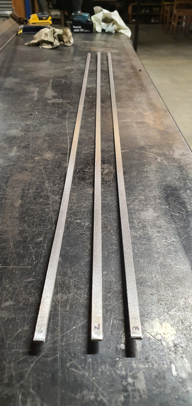

Popular Post yoeddynz Posted April 2 Author Popular Post Posted April 2 More exhaust tinkering. But first I decided to make some new front caliper brackets. The race car I first bought came with a set of 80's CRX sliding calipers and vented rotors. 231mm/17mm thick. They work really well. However the brackets they bolt to are only held on to the uprights with two of the original drum brake mounting holes. This is actually the way many of the disc brake conversions sold for imps over the years are done but I've never been super happy with it. The holes they mount through are spot faced and quite close to the edge. My fear (yes possibly a bit paranoid but) is that the casting could break and the caliper bracket get pulled away under heavy braking, jamming the caliper in the rim and locking the wheel. You can see the setup in this pick I took not long after getting the race imp... There is better, more fail safe way to do it using all three mounting bolts, which is also stiffer and also modular. I bought some 10mm steel flat and got to work. Drilled and bored the centre hole to exactly match the axle size.. This way the brackets will always sit perfectly central and even if all three bolts let go (is a very super paranoid way) the bracket would still stay in place concentrically. I didn't take many photos of the build, a process that ended up taking way longer then I expected but hey, that's car projects. Here's the bits on the bench as I'm measuring out and marking etc etc.. The finished parts before paint... Only down side is the extra 380 grams of unsprung weight per side However, on the plus side I do get to inform the various Hillman Imp doomsayer Barries out there that I have added more weight to the front of my car so I wont end up in a hedge next time I attempt to corner it I shimmed them up to suit ( for the final install the bolts are reversed and lock washers install btw) Test drove and its all good. I really need some new pads though because old pads are worn to suit the old brackets which I had noted were slightly bent. The new setup is far stiffer. The original pads are rock hard anyway and have always really only start to bite once there's some heat in them. Keen on suggestions of pad brands to try within NZ. The basic TWR ones from Repco always seem to work fine though so I'll go that way first. Luckily these discs, calipers and pads are all still readily available new and cheaply. I think they are used on many different earlier Civics and CRXs which helps. Stuff from Rock auto is insanely cheap for example. Next up was my ongoing exhaust sound experiments. Upon suggestion from one of the fellas on a 911 forum I cut the box open and added a deflector to help flow. Here's another exceptionally well drawn image showing the science behind my modification... The red arrows show the exhaust gas flow. Now please humour me and lets just pretend its flowing like a lovely consistent river of lava. As it flows out from the exit it will follow the curve around and into the bellmouth of the next pipe which shoots in a straight line through the silencer and out via the tailpipe. There will of course could be pressure pulses created by the tail pipe exit so if they come back they, as depicted in yellow, should create a vortex, do a perfect swirly thing and get pulled back into the pipe. In theory. I welded a lid over my master piece of fluid dynamics and then cut open another bit of the box. This time I filled the cavity around the perforated tube. I'm hoping it might quell some of the 'hollow cackle reverberation' sounds. It didn't. After welding a lid back on, splashing some paint around I took the car for a hoon. Its certainly quieter and from my seat of pants o'meter I think my gas flow mastery has added at least 1 small pony into the mix. But there is still an annoying reverb sound at around 2700rpm (which happens to be around the 100kph area in 5th) I think I know the cause. Its the exhaust pulses in the lower chamber matching each other. In fact Wikipedia has a section with more detail on this... https://en.wikipedia.org/wiki/Humming So with that result my exhaust experimentation will continue. 29 2 10 Quote

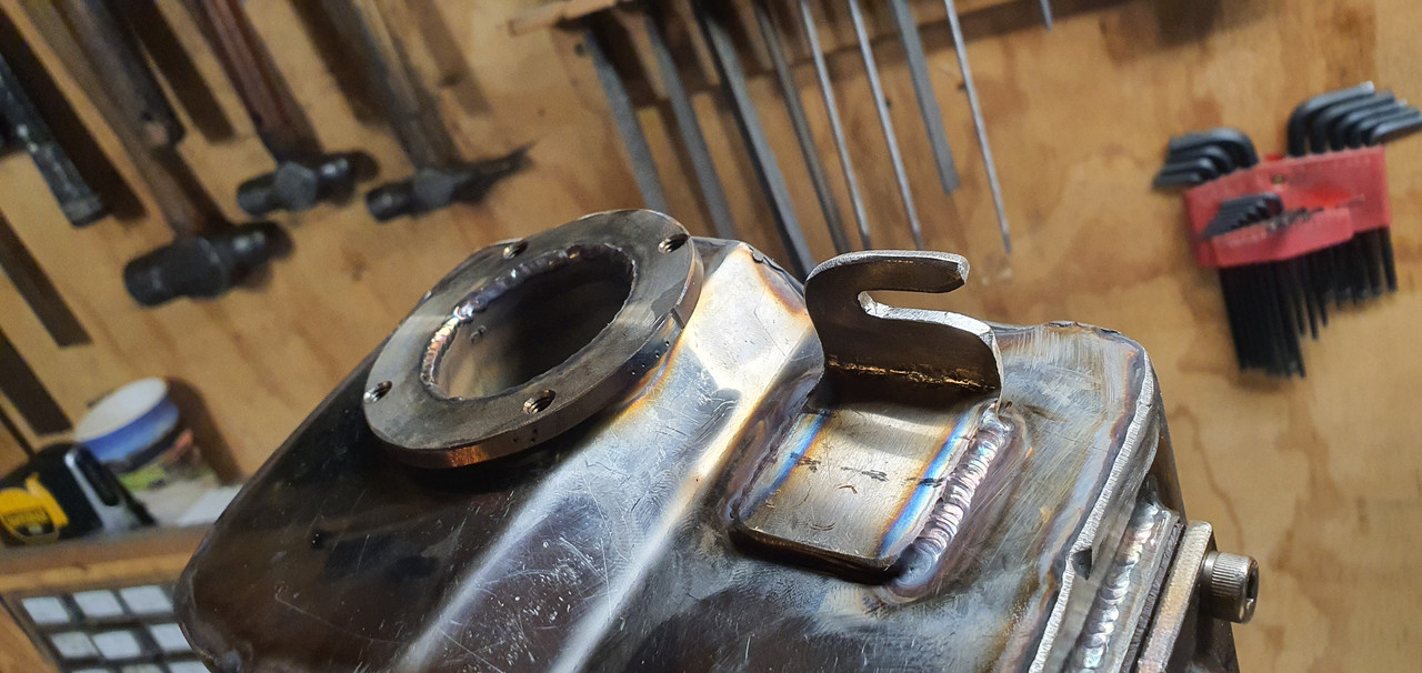

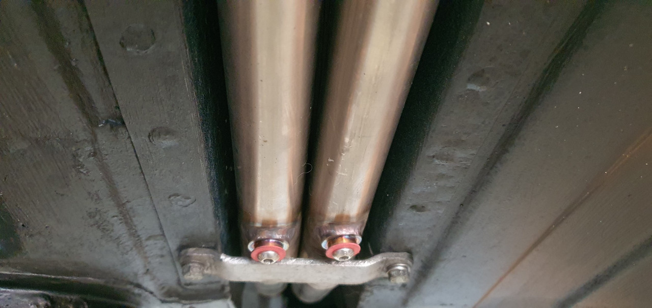

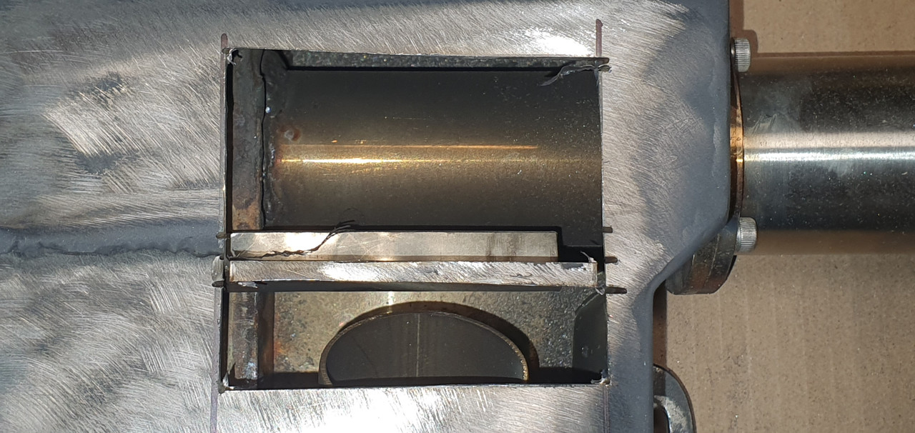

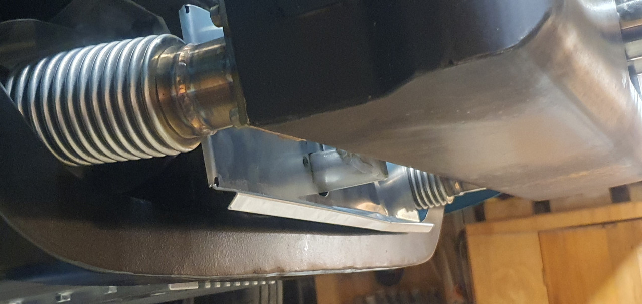

Popular Post yoeddynz Posted April 17 Author Popular Post Posted April 17 I've now clocked up 3200km since fitting the flat six. 1200 of those are from the weekend just past but I'll get to that in a later. First off - more exhaust box modifications. Adding that sound deadening mat around the pipe had made it too quiet and the exhaust note had lost some of its character. So I cut the box open again and removed the stuffing. This time I riveted a lid in place in case change my mind..again.. I also cut a hole in the bottom of the box and made a bolt in panel that has a folded over, wedge shaped partition splitting the main lower chamber in two. The idea is to stop the exhaust pulses from each side hitting each other and creating that hum. I don't really think it will work as such because they are pressure induced sound waves and the partition isn't a perfect seal. But it does help guide the exhaust flow up through the plate of many holes above. I didn't take pics so you'll have to picture it. So the box is sort of back to what it was like when first made but in theory better flowing. It sounds nice enough though, not droney at all, no fumes and sporty when extended. It'll have to do until I start exhaust box number 3. With that bit of exhaust fettling finished I double checked my tool box for anything extra we might need, packed the car up and cut some thick foam up to make a cradle for the UE Boom bluetooth speaker so it doesn't slide about on the parcel shelf. We headed to my mums place in Blenheim, Hannah driving convoy in the van which was filled with the last of our K11 micra bits that were getting picked up from mums by the new k11 owner the following week. She had Kevin the cat for company as mum would be baby sitting him. Pic from a stop at Pelorus bridge on the way over.. Kevin.. The drive over was great fun. I was lucky enough to almost get a clear run up the Whangamoa hill climb until I caught up to a Suzuki swift sport that was not living up to its name. For those that don't know the Whangamoa hills its a decent climb out of Nelson that's got loads of great corners where you can see well ahead. The whole road up to the saddle was resurfaced a few years ago and its a sporty drivers delight. The following day we headed south to Christchurch. Hannah had a weekend long fire fighters conference to go to. I would be free to catch up with family and friends down there. Lovely drive south with perfect weather. We've not been down the east coast for a few years and this was the first time in a very very long time we'd driven anything interesting on this road. Pics.. View from cafe stop.. Had a very nice posh hotel to stay at in Chch. Car was now plastered in fly road kill.. The next couple of days I hooned about chch city, caught up with friends. First thing Sat morning I popped in to mag and turbo and got my front wheels rebalanced as I could feel they were out slightly on smoother roads. Big thanks to @CUL8R for sorting me out there, getting the right fella (a mini loving barry) on the job. Was nice to catch up for a good old chat. The cars front end was much improved. Sunday was especially good as I managed to get some really good driving in on the Port hills and Lyttleton habour area. Good coffee, great roads, clear sunny day. I have not driven a lot of these hill roads for years and the last time at speed was in the 90s in my supercharged Mr2, brothers TVR or a bit more recently a mates WRX he lent us for a week. Great roads and luckily actually really quiet on the Sunday morning. I discovered whilst hooning through the Lyttleton tunnel that if I hit the red line in second then button right off so fuel cut activates the car does a wicked backfire. Second time back through the tunnel was hampered by someone who insisted on sitting at 40kph. Late morning whilst parked up looking at the maps on my phone six Triumph TR6 sports cars raced by. I dropped my phone and took off after them. For the next hour the convoy raced about making the most of really good hillclimbs and twisty roads. Damn it was fun. What glorious sounds! The Imp was in its element and by now I was really getting the hang of making the most of the rear engine configuration. I was bloody loving it. I just kept following them until we ended up out over in Charteris bay and they pulled into a cafe car park. They all came over to check out the Imp, wondering how I managed to keep up Lovely cars TR6's - my brother almost bought one that we'd test driven before getting his TVR. The Triumph 6 connection for me is having owned 5 TC2500s over the years. Turns out I had met one of them a coouple of years previously when they were doing a nationals meet up our way. I was invited in for lunch with them and had some good banter. Late Sunday afternoon after Hannahs conference was over we drove to Hanmer springs. Another nice Hotel and this time the Imp had company more its age.. That evening we spent several hours in the thermal springs right over the road from the hotel. Cool clear night. Tickets now include the water slides so we made the most of those too. On Monday morning we left Hanmer.. and headed back to Blenheim via Waiau.. and the inland Kaikoura road. It used to be gravel for quite a big section and I've not driven it since it's been sealed. Looking forward to the twisties but it was quite a let down. Actually very rough, lumpy and bumpy. It was not really suited to a lowered imp. Would be far more fun in a peppy Citreon or something with really supple suspension. In fact I had more fun when it was gravel. Kaikoura for lunch.. Back to Blenheim for the evening. Got to play with mums border collie puppy .. Following day it was back home. This time I was even more lucky on the Whangamoas because there was a traffic stop due to tree felling. I was at the head of the line just behind a large truck. Passed him after the lights went green and had the whole hill to myself. Fantastic. Gentle 4 wheel slides balancing that rear weight overhang on the smooth tarmac. So fun. Once home I did a final check over of the car. Needed a tiny bit of oil, 200mls, due to a small drip from the sump I have now fixed. We clocked up 1280 kms (having accounted for 3% speedo error) and across all that driving averaged 6.6L/100km or 42 MPG in old money. Of the fill ups the best was 5.9L/100km when just cruising with the traffic down the east coast, worst was 7.4 after a lot of fast driving. I'm bloody amazed. We kept re-checking the figures etc and its legit. Its just so cool that such a smooth, nippy little six can also be so thrifty. The Imp is also really comfortable (the Recaros help) on long trips too. Its the only car I have owned to date where I don't get a sore right ankle from the throttle on long runs. So I'm pretty bloody rapt with the outcome and look forwards to more road trips. Also looking forwards to cracking on some more modifications I have planned. 44 3 Quote

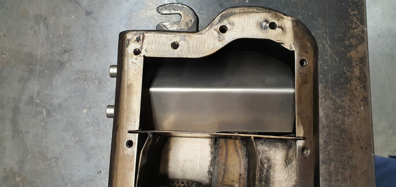

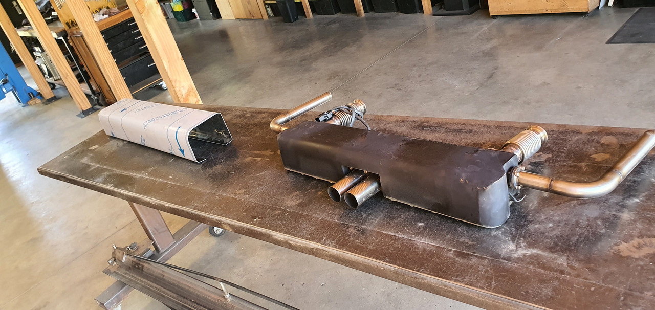

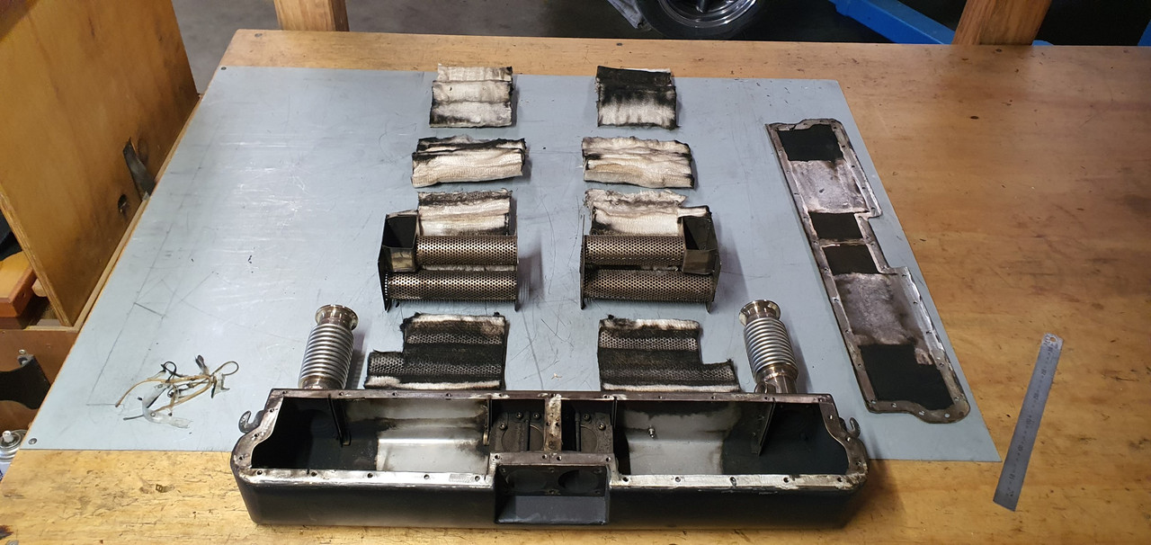

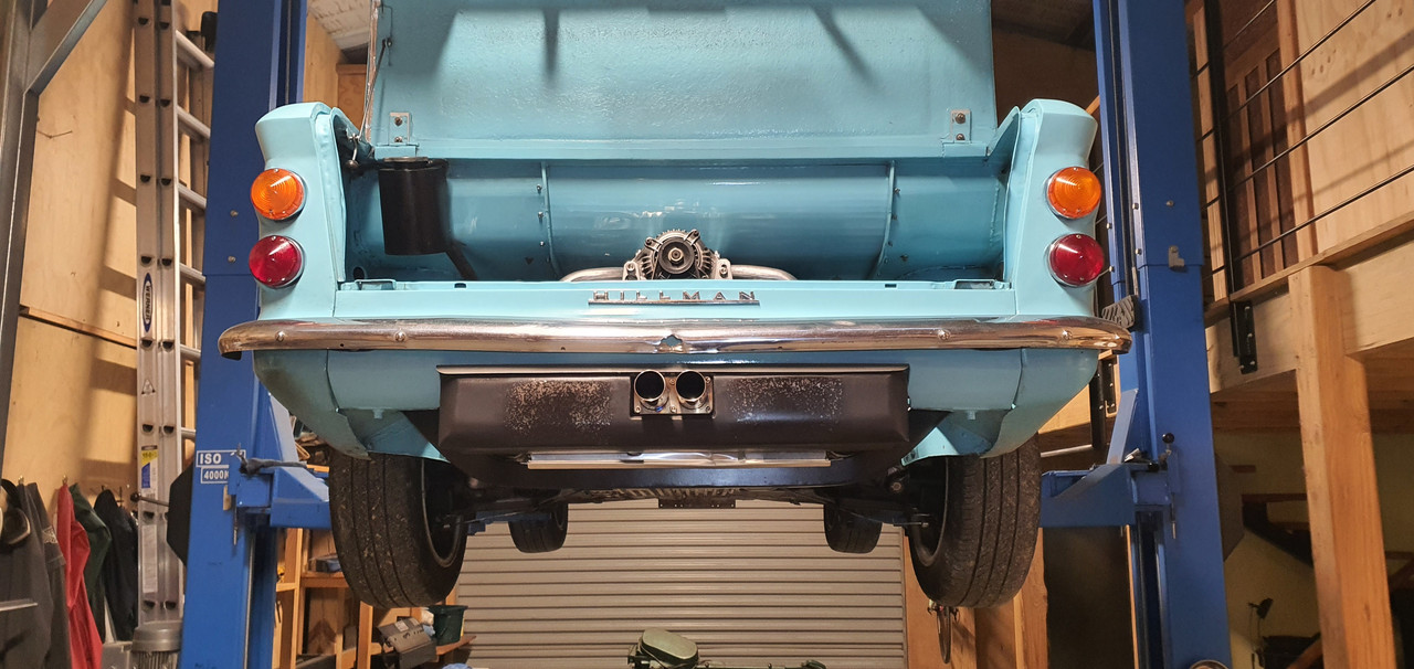

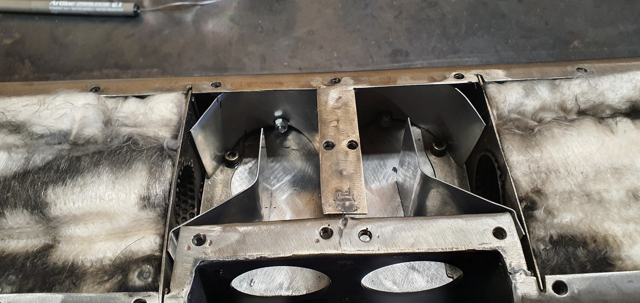

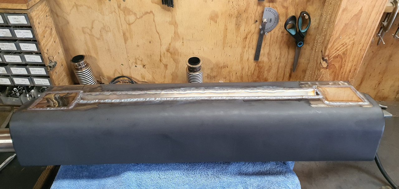

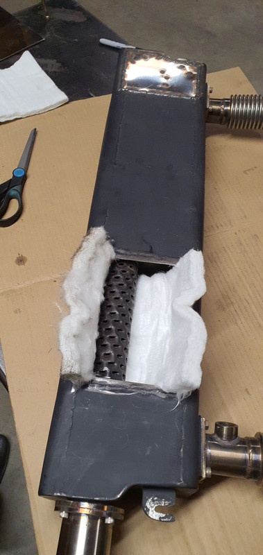

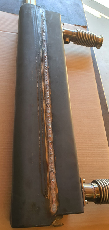

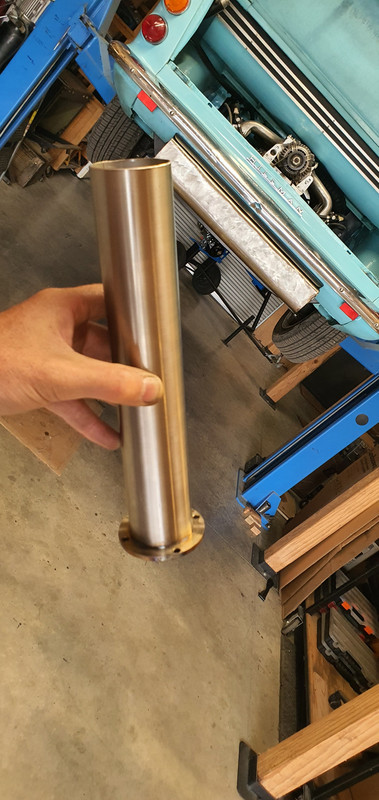

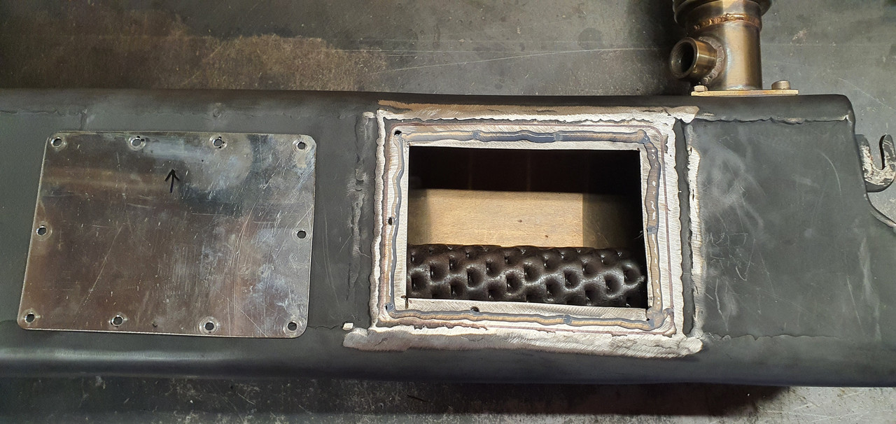

Popular Post yoeddynz Posted May 17 Author Popular Post Posted May 17 Christ, would you look at the time. Its about time I build another exhaust box. Here comes version 3.0 First I brought version 1.3 in from the garage. This box took me ages to make. Quite involved. By the time I'd got to 1.3 it was pretty good for sound but too fumy with the centre exit exhaust and not flat sixy enough. I took the lid off and looked inside. Then this happened. No going back now. I welded in some stainless to cover the hole created when removing the centre exits. It was now a simple box again and ready for filling. These arrived in the post all the way from China. I'm constantly impressed with the quality of these. I got eight of them landed for not much more than the price of one at 'trade' from my stainless supplier. Before playing with elbows I machined up some more flanges for the new tailpipes. These were later welded onto the outlet stubs at each end. I welded two pairs of elbows together, cut the outside of the curves off and then fired up the yellowhammer workshop Ryobi precision material removal machine centre.. I was so impressed with the quality of finish this machine creates even after checking on the surface table.. Wow. Amazing. I'd made sure to check all other possible measurements.. I then welded the halves together. I was very happy with how the welding was going.. But got a bit slack and a hole appeared. Whoops. You can spot my exceptional filling job here.. So this X pipe was connected up to some leftover spiral punch silencer tube and some of the perforated tube I made, pinched from box 1.3. Its a very simple layout .. The glass fibre silencer packing pulled from box 1.3 was still in excellent condition... A game of 'Itchy Jigsaw' was played with the pieces until the box was full. Sealed and bolted down the lid.. I deliberated for a fairly short amount of time on what form the tail pipes would take. Ended up with an elbow on each end and gave the pipe surfaces an 'easy care' wire brushed finish. Before the big exciting start up this morning a nice coffee was had. Then we took some vids.. Much better!!! In fact I'm really happy with this one. Its got a lovely flat six burble at idle, which could be improved if I lower the idle rpm - currently sits at about 800-825. Its smooth and quite subtle. Could be louder with a bit less packing crammed in. At cruise its nice and burbly, although again, it could be louder. However I've only heard it from inside at cruise so far. There is absolutely no droning at any point Once its opened up its lovely. Has a nice wail. Its so fun to drive fast with the revs up. Very smooth. Only issue is the fumes. Exhaust gases from rear facing exits are still getting sucked into the low pressure zone behind the car and drawn into the cabin when our windows are down. So my next modification (Version 3.1) will be new exits angled off at 45 degrees - sort of like this.. I still love the look of the twin centre exit exhaust on version 1.3 but I think the exits separated like it is now helps accentuate the flat six sound. The actual box design and general look could be improved further, possibly with a neat perforated heat shield ? But yeah. Very happy with this setup. It might be a keeper. 56 1 Quote
