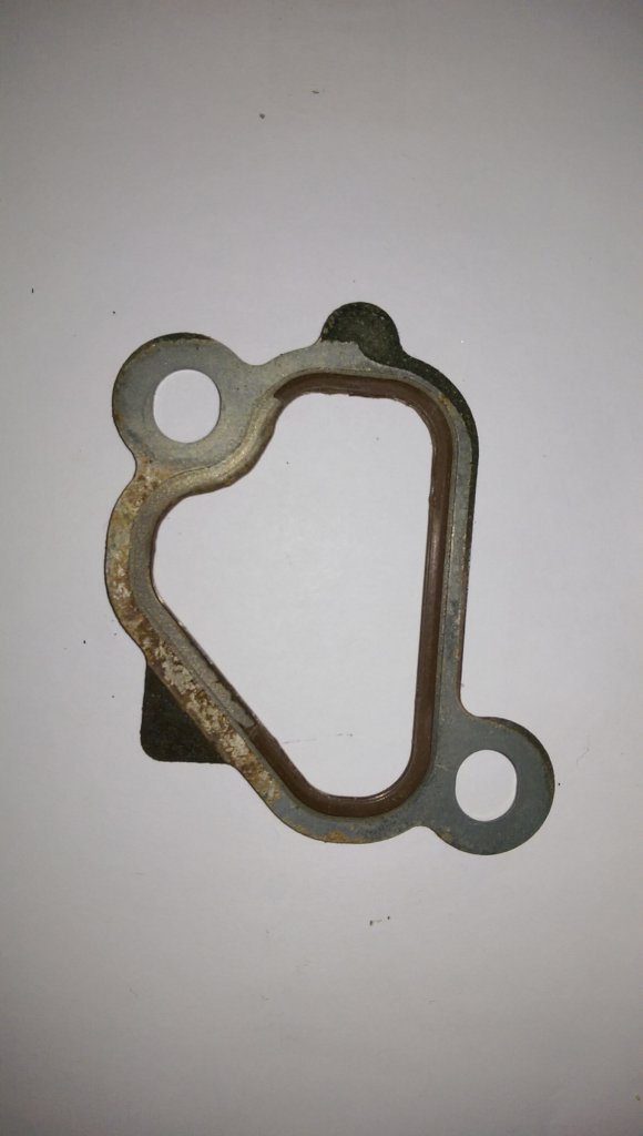

3 minutes ago, igor said:
Are the water bridge gaskets just normal paper ones? If so weetbix box to the rescue.
It's a 3 wafer metal gasket with a thin 'rubber' seal on the top and bottom of the inside edge. The seal part has pulled off and the metal is a bit crusty.
If I cannot get new ones, I will try clean them up and put a little gasket goo on them.
