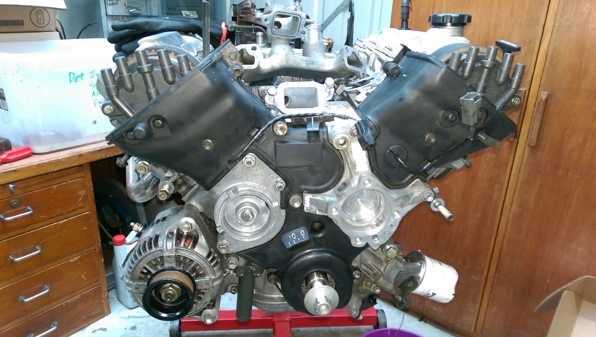

The RockAuto timing belt/water pump for the 1UZ finally arrived after a month or so. via Belgium?! 1/3 - 1/2 the price of buying it locally, including the freight! And it's all brand name stuff.
I started changing that tonight. The engine has been in bits waiting for the timing belt for some time. So I just had to turn the crank to the right place and pull the belt off.
Well, good thing I did change the water pump, cause the old one had seized.
Timing belt and water pump installed. New not-cracked distributor rotors installed. Cleaned covers and stuff installed, everything was covered in waxy oily stuff.
I've hacked up the tensioner and hydraulic fan pump cause I only need the alternator.
But to remove the water pump, you need to remove the thermostat housing from the 'water bridge'. It's only held in with two bolts and a big o-ring. Easy, right?
WRONG! Mine was held in with two bolts, an o-ring..... and a bunch of aluminium oxide, so I was unable to remove it. I had to remove the water bridge too.

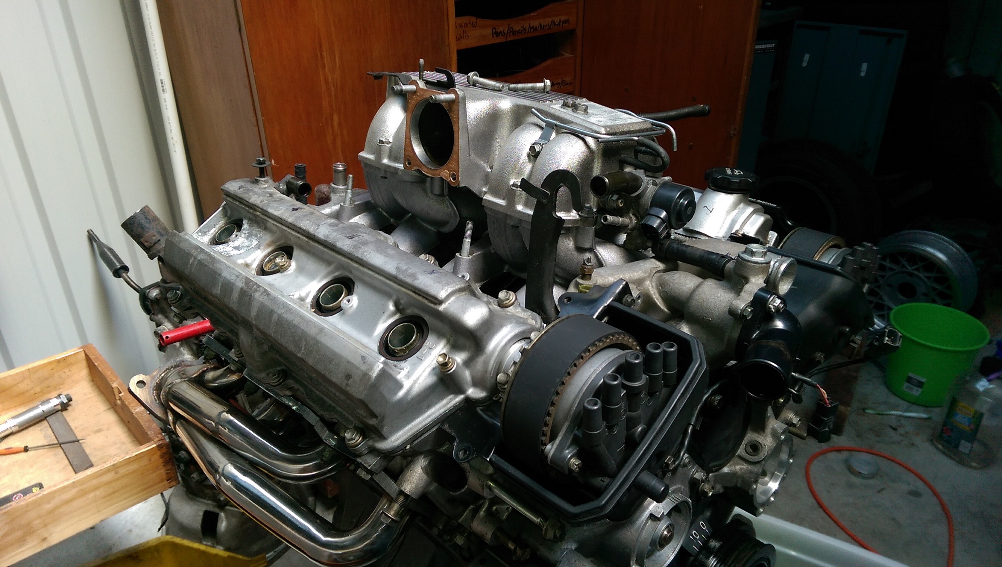

And I put the inlet manifold on the other day.
I've ordered some new platinum NGK plugs and cams cover gaskets and injector seals(mine have gone hard) from Rock Auto because it's ridiculously cheaper than buying them here.

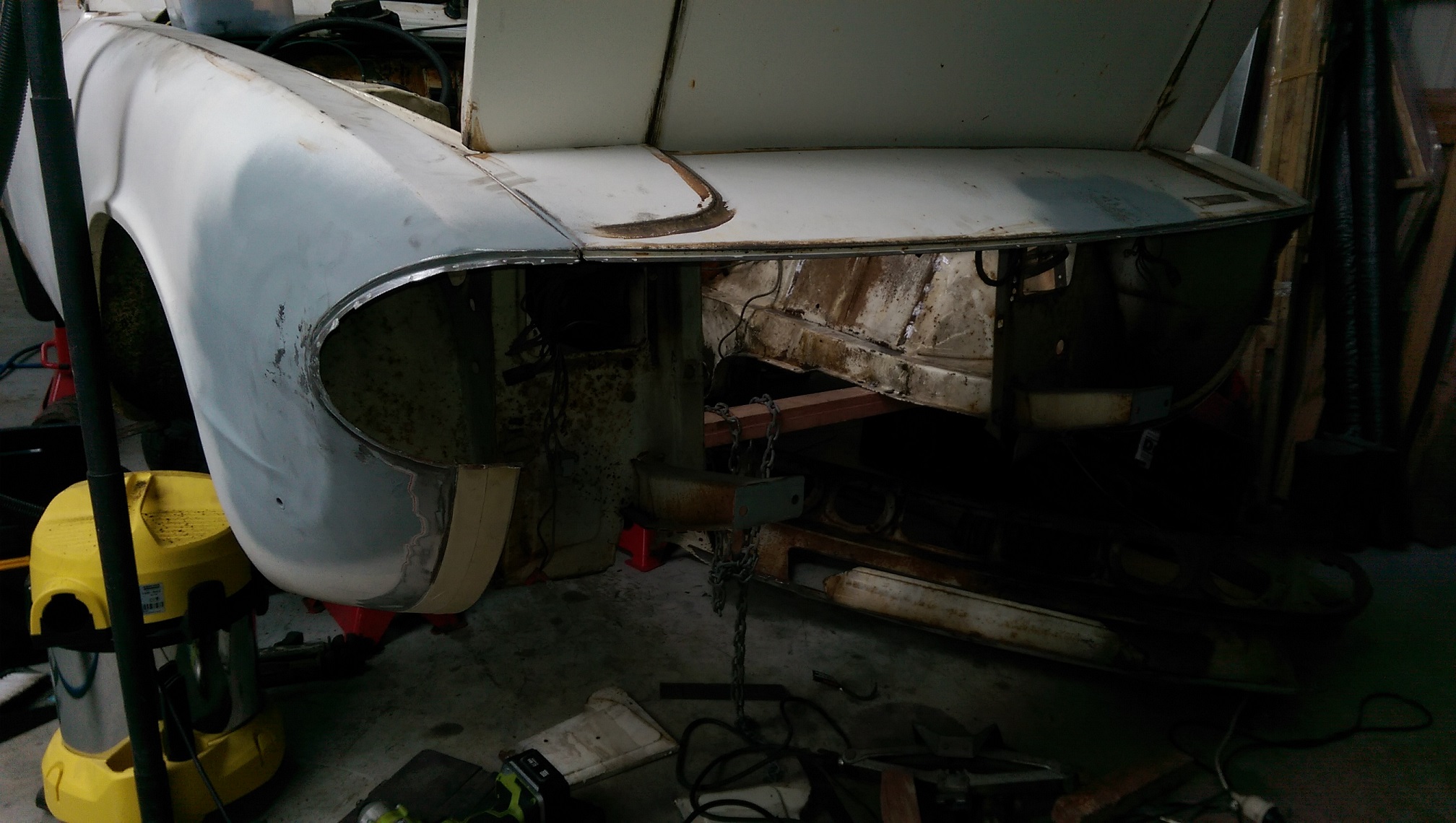

So I did some more die grinding to remove the front of the white one. I left a wide strip of metal beside the seam because the donor panel is rusty there.
The lighting is not the best for these photos...
It took five minutes to fix the dent that was here, now that I can access the back of it.
I have greatly improved the dent in the wing. Still needs work though.

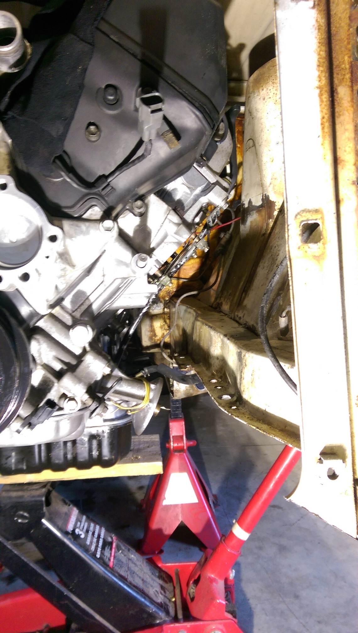

So I offered the engine up. And it's tight.
I have since removed the heat shield thing from the alternator and got myself a little more space. I might grind down the lug the shield bolts to too. The alternator mounts are not adjustable, it can't get closer to the block anyway.
I'm going to have to make 'log' exhaust manifolds. The engine came with some shiny stainless extractors, but there's no way they will fit.
I'll have to remote mount the oil filter and remove that filter housing, it's in the way of the steering rack.
The major problem I have yet to solve is the front alloy part of the sump is entirely in the way of the rack.

The engine is now as far back and as high as is practical, so...
Hack hack hack. Don't worry, I have another.
Now the cross member bolts on again and clears the sump. But the steering rack needs to be, much, lower to fit.

Everything is now positioned where it needs to live .
Still more cutting required at the back to make room for the diff mount. The way I thought of to do it is cut a big round hole, centred on the stud, and weld a bit of thick wall tubing in there to put the strength back in.
IMAG0730.thumb.jpg.5fd63af573aa4d3dc391e14c61967690.jpgIMAG0731.thumb.jpg.ea8abf7befdeb7058c3cca0a0dde979f.jpgIMAG0733.thumb.jpg.0cbbbc64bb5815d670fbc502d6eacf21.jpg
I will fabricate a completely new cross member here for the front diff mounts. Modifying the original will end up so hacked about it will look shit.IMAG0734.thumb.jpg.962382f10222e108dd7089e67eecae8d.jpgIMAG0735.thumb.jpg.966a1d4f605285346c020087f95c9239.jpg
