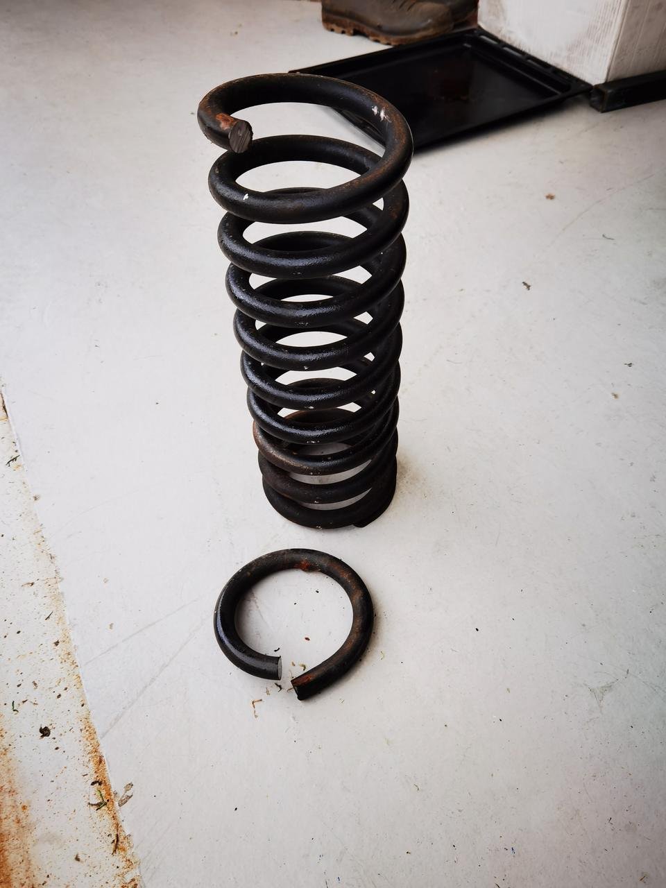

Popular Post piazzanoob Posted September 1, 2021 Author Popular Post Share Posted September 1, 2021 so because i told you i would fill you in with the progress i will. This would have to be the highlight of doing this old girl up and being able to use it. from getting this car back home i was never really happy with how the car sit or how the wheels didn't fill the guards but the priority was to get it legal and drive it. but liked the style of the car and wheel combo. hummed and ahhed for abit and a work friend had a contact that did mag wheels so contacted him and told him what i wanted. wanted to keep the same wheel centre caps i had but after doing some measurements i was shit out of luck. did a quick measure on the car to what wheels were available. and paid and waited two months for them to turn up. Ended up with specialty wheel smoothie in a 15x8 all round in primer. I got these through BG Marketing and got this brand over a cragar because the centre cap quality is better and i could get them in primer. special order from the US with a 7.5 inch baby moon cap now to pick a colour right. black or chrome is fine. Nah go away barry im here to not be like you. this was the hard part of the wheels i had a few colours in mind but the car being orange made it abit more difficult. so after i cleaned up a old wheel and primed it i went to the paint shop for a colour sample. asked for a colour chart to look from. couldn't find something that stood out. old indian joker says he will mix something up so calls me outside to take a look at the colour and gets it bang on first time. buy that and give it a spray. Note Don't put too much filler primer on a wheel because it cracks how about cream right this photo also shows where i had previously painted and blended it in. Unfortunately i liked the colour but just didn't suit the orange of the car. seemed too light for me so i went back to the paint shop and had the colour changed after going to bunnings and mitre 10 and going through the colour charts on a sunday. sprayed the modified colour on Found this colour was more like salmon not what i was after. so found something lying around in the shed in a different colour i liked. slept on it and went back to the paint shop with another colour to be matched. so they made me a small sample and i gave that a test spray and fitted to the car. Hmm brown you say.. so had some more mixed to paint the wheels and figured if i didn't like it ill just paint them black and be done with it. so figured ive got some nice new wheels how will i paint them nicely. figured its not easy on the ground and had an old hub lying around in funny enough the same stud pattern. so welded the hub to a steel stand And i happen to have two hubs so meant i could weld two at a time choice so a splash of this colour over all 4 wheels then gave them a shot of clear coat. couple of ugly bits but nothing much noticeable and wheels can be tricky to get all the paint into spots test fitted the wheels revealed the enviable. cut cut the front was never level with the rest of the car so this had to be done. plus it wasn't low enough painted the cut bit and put them back in for a level test. level looked good would be nice if it was much lower but the car has to be able to be driveable or get in the driveway which involved a 45 degree entry on the old wheels for tyres i purchased some vitour galaxy 245/60/15s from sta parts. i was lucky enough a good mate had a tyre machine and fitted them for me on a sunday. will balance them if they need them but currently they are good. so after the wheels were fitted i washed it and left it outside for the night where i got it towed to go back to the trans shop the next day. unfortunately i got it back 3 months later. upon me driving away he did say the wheel did scrape oops haha lets find out for myself. And if you wanted to know the colour lion brown mate makes for good beer battered fish 25 1 Quote Link to comment Share on other sites More sharing options...
Popular Post piazzanoob Posted September 1, 2021 Author Popular Post Share Posted September 1, 2021 so after a road test revealed a few things. ive lost alot of steering lock due to the wheel touching the inner lip on the gaurd. i will be getting a metal expert to roll the lip on the front gaurds. the rear only rubs on extreme angles but hasn't on a bumpy highway drive. in terms of steering lock it means i can only go around big roundabouts but it scrapes haha so now that it means i go round the block than around the roundabout i may do down to a 235 width tyre but will wait until the gaurd is rolled. a couple of days after picking up from the trans shop i did a bolt check and a wash and went for a drive. went to whakatane for some mainies and back the next day you will notice the car is still a tad higher in the front than rear. its not so noticable in person unless looking so will keep it this way. quite stoked with the colour and fitment combo. first trip in this involved someone at the gas station coming for a perv at the wheels and asked a few questions about them. also vehicle handles a huge amount better now less of a boat feel. gave me a huge amount more confidence in driving it around corners too. but should really upgrade the rear shocks to something stiffer and a good wheel alignment too yes you can tell me now how ive ruined my barry car 34 Quote Link to comment Share on other sites More sharing options...
