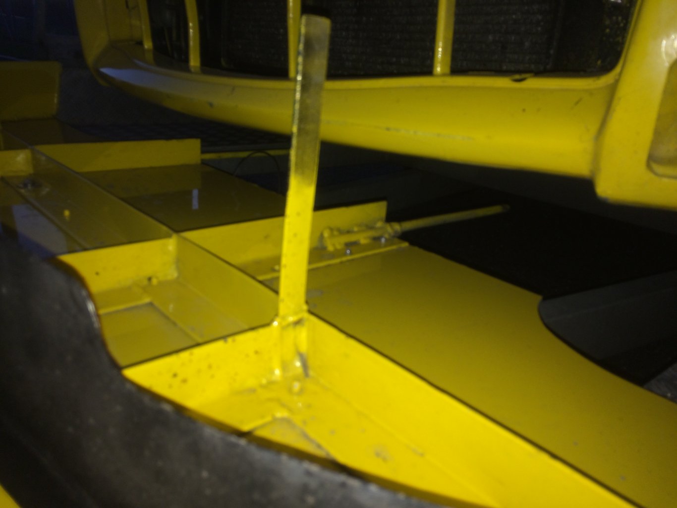

I think the glass over ply idea is a really good one and I also think it's a good idea to run aluminium angle along the length of the splitter to give it extra rigidity + mounting points. The ideal outcome is a splitter you can stand on.
I'll dig out some pics of a quick release splitter I saw recently - it gave me a couple of ideas for attaching the rear of the tray.
This one’s made from ACM panel and uses steel angle for strength (probably a bit heavy). I like the way it uses pins to attach at the rear.

59 minutes ago, Truenotch said:
There you go again with doing things that I've been planning to do on my car :P
Where are you getting your aero design info?
I've been holding off doing the aero until I got the engine sorted as I knew it should be making more power and I wanted a consistent car to experiment on.
Plus I now have another honda I have to catch which is running 3-5s in front with a 2L engine, i noticed through the corners he dominated me, but down the straight it was similar pace, I don't think I'll ever be as quick as him, but I can hopefully get a little bit closer to at least make it harder for him!
The other advantage of glass over ply is it protects the plywood, i'm still waiting on feedback from the guy who's going to do it, to see if it's going to be strong enough. Yep I think running aluminium angle makes a lot of sense for both those points you make.
I've read that about standing on it, but it really depends on the use, for us we aren't really doing 250kph+ so the forces are a less, so you have to be really careful not to overbuild it.
Thanks for those pictures, it's really hard to find good pictures of decent mounting systems!  I like the pin idea (have also seen a slotted version), the only thing I also want is to be able to adjust the height maybe I can use the vertical member to do that.

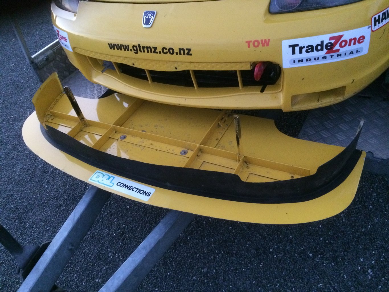

I'm impressed that you've dropped a second off your lap time from the front splitter and ducting mods! I wouldn't have thought it would be worth the effort at 12kg...
Nice work on all of your developments by the way. You're doing everything I've been thinking about for the last couple of years :D .
Are you going to add side plates to the rear diffuser?
Thanks!
The ducting mods made a big difference.
I normally struggled to keep up with a competitor down the straight and instead could overtake him.
I did take a bit of weight out of the car (alternator, doors etc) so i'm probably about even at the moment for adding it..
The splitter has had a big negative affect in the braking zones as the balance isn't right so i'm having to brake sooner then I normally would to keep the rear on the ground, but through the corners it is adding noticeable downforce and allowing me to turn in better.
I'm hoping the diffuser balances it all out. Yep end plates and strakes added, just forgot to take a photo.

5 minutes ago, Truenotch said:
Do you have adjustable brake bias? If so, you might be able to dial out some of the unsettled braking in the rear.
Pretty curious to see the effect of the diffuser though! Keep the updates coming.
Yep, i lowered the pressure to the rear during the racing and got it driveable but it wasn't stopping as well after that. Just the act of stomping on the brakes forced the front to dive a lot and so the rear to go up, so required me to be a bit less aggressive on them to keep the car flatter (probably also need some harder springs at the front).
Will be trying it on Friday, so fingers crossed it's dry.
Hard to know if it will help as the interaction of the live axle makes things a bit more tricky for us to get the air leading into the diffuser right.
Yeah, that live axle life is tricky! I've been trying to come up with a nice solution for a while. I'm always worried that the air will catch the top of the diffuser panel and cause more harm than it's worth.
Stiffer springs makes sense too. The more aero grip you generate, the less spring compliance you need (in theory). What rates are you running at the moment?
