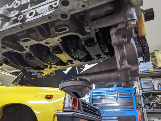

Next up was the oiling.
The K20a from the Accord Euro R runs balance shafts off the oil pump in the sump.
These are to reduce vibration at lower revs, the Integra and Civic versions don't have these so it's safe to remove them (or just buy an Integra/Civic engine to begin with...).
The downside is they take up a huge amount of space in the sump, they sap power(supposedly about 9whp) and they weigh 5.3kg alone!
So it's a win to remove them all round.
Luckily you can raid the Honda parts bin, so the standard thing to do is to buy an Civic FD2 kit to replace them, it comes with a new oil pump, oil chain, oil chain guide and windage plate.
So many stores sell these kits as the K24 engines also have them, so it's a pretty easy change.
One thing is that the K20a oil pumps are known to not be great over 9000rpm, so a lot of stores are now porting the oil pumps which frees up a little bit of power and makes them safe to 10,000 rpm.
I ended up going with one of these kits as it ended up cheaper than a stock kit, one thing to note is the K24 engines and the Euro R version of the K20a need the housing of the oil pump modified for clearancing, it's nothing major and the kit i brought already had it done.
I brought the kit from kmodperformance with it being the K24a2 version which bolted straight up.
https://www.kmodperformance.com/collections/bottom-end-engine-parts/products/kmod-oil-pump-kit?variant=9987006988324
Now that frees up a lot of space!

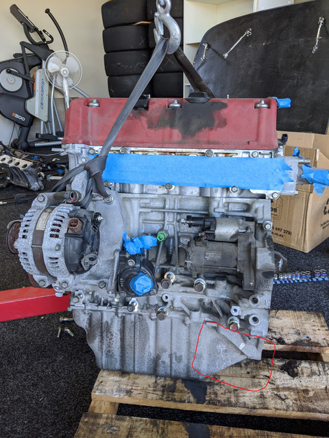

Now a few might be wondering how i'm going to fit it in the car even with that sump.
The plan is to put the steering rack on the front of the engine cross member (escort like) narrow the cross member and position the engine entirely behind the cross member or as far back as we can get it.
There are a few challenges with this as I have a roll cage bar going through the dash, so would like to not have to alter that and it may put the gear lever quite a wee way back, but will deal with that later. It has some big advantages however, obviously the position is great from a weight balance point of view, but it also allows me to run escort style anti dive bars (tied from bottom arms BACK to chassis), which make a huge difference in braking.
Yes there is going to be a lot of chopping.
Now that's what I'm doing, however if you wanted to run it over the cross member you might consider the following kit from K Miata.

However be very careful as the standard cast aluminium oil pan has the bottom 2 bolts for the gearbox.
And also this massive brace back to the bottom of the very solid pan.
Replacing the pan with one of the above means you can't bolt the gearbox at one of it's highest stress points, i.e it want's to separate right at that point.
Basically your going to fuck your main bearings with the forces on it.
So that's out for me, if I need to I will cut up the existing pan.

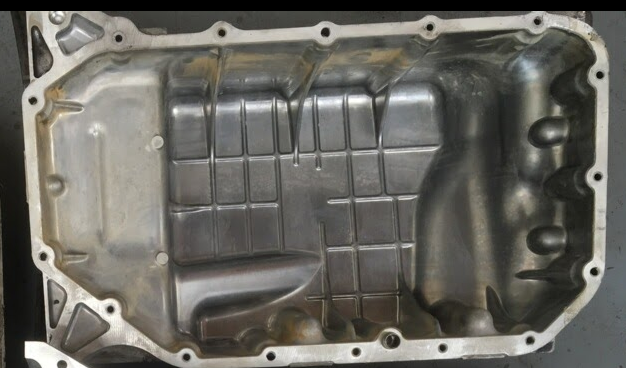

In terms of baffling, I have some pics of a Spoon K20 sump baffle, and @Roman  did a great write up on improving the BEAMS sump to match the TRD version which I saved, so a combination of both should work out well.
Main thing is stopping the oil freely going up the oil chain under braking.
Here's a standard sump, which is just a dumb design:
