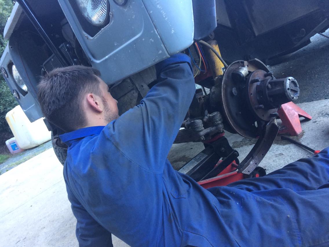

footey 218 Report post Posted January 24, 2018 decided to replace all the wheel cylinders the shoes where allgoods for the time being also have found that my radiator is buggerd so a new one will be on its way shortly. after the brake are a go i will start working on the electrics and the custom dash. Quote Share this post Link to post Share on other sites
footey 218 Report post Posted January 24, 2018 1 Quote Share this post Link to post Share on other sites
footey 218 Report post Posted January 24, 2018 my face after i found one wheel cylinder was different gahhh put the drum back together missing half the bits now waiting on one cylinder to finish the job 1 Quote Share this post Link to post Share on other sites
