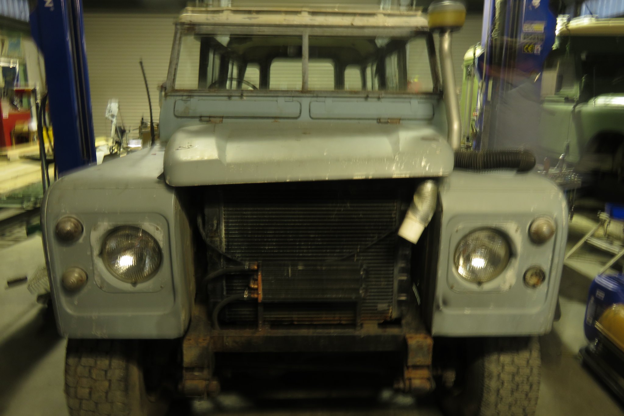

footey 218 Report post Posted September 2, 2017 So Recently brought a land rover thought I would upload a few progress photos 2 Quote Share this post Link to post Share on other sites

footey 218 Report post Posted September 2, 2017 so a run down I need to tidy up the wiring , fix a minor bit of rust get new tyres and rims, trying to find a set of steel rims 5 rims be good, the ones on the landy are borrowed , need to get to a stage to see how the motor runs, have a turbo to be fitted to the ld, not much to be done but still a lot of work ahead will keep the photos coming Quote Share this post Link to post Share on other sites

footey 218 Report post Posted September 6, 2017 so tonight I droped the 13 year old diesel out of the tank, which was nice and clean no sludge, I also started to put some doors on the things, the gf also grabed some nicer photos The front of the rover is an early defender front this was to allow for the straight 6 ld28 and the moving forward of the radiator, need a winch bar for this thing 1 Quote Share this post Link to post Share on other sites
