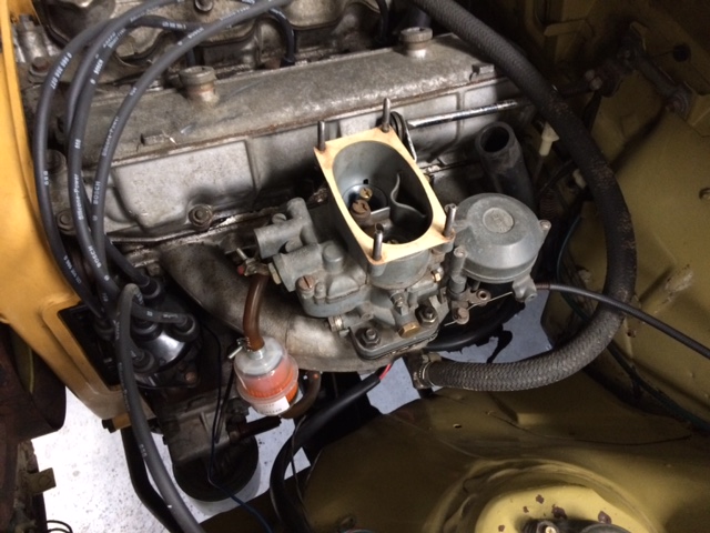

I have fitted the carb kit. This is the easy bit. It did fire right up but doesn't actually run any better. Now, according to my manual it seems my particular Solex carb C34 PAIA/9 is an "exhaust emissions control" model. These words strike fear into my heart as this is usually a euphemism for "this is a shit carb and you will never get it to run properly". I must admit I am a bit of a noob when it comes to carbs (except for dirtbike carbs). I have a few questions for those more knowledgeable on the subject.
Firstly, the screw outlined in red. None of the diagrams in the workshop manual show it. This was nipped up tight when I disassembled it and so I did it up the same. Twisting it with the engine running even 1/8th of a turn has a profound effect on the sucking noise the carb makes. I have no idea what it does. The blue circled screw is the idle mixture adjustment.
Secondly, none of the diagrams show this spigot either. There was nothing hooked up to it, but it is sucking air. Blocking it with my finger with the engine idling makes it die.
Thirdly, fuel is weeping from the red lined area despite the fact it is a new gasket, the surfaces are clean and look flat, and the fuel level in the float chamber is 12mm below this line. Actually I don't know if this is right as I can't find a correct float level anywhere in my books or on the google, just reference to special tool xyzabc to bend the float arm correctly...
The Fiat is running well on the road, but there are some starting and idling issues and transition issues to deal with. The first thing I have done is block off a vacuum take off that had nothing on it. This is clearly a source of un metered air and I had to tweak the throttle stop/ idle adjustment about 4 turns to compensate.
I've just been for a drive to get the engine fully warmed up , re adjust the idle speed and have another twiddle with the mixture screw. I think the tip of the screw or the seat may be buggered because only when the screw goes tight does the idle even begin to pick up. I think the engine would prefer to idle a touch leaner even. I'm still baffled by the 3rd screw on the carb. I cannot find what it is in any literature I have or indeed the googlebox.
I have had a fiddle with it, but I don't know what it's doing. I can see the results though... As received, this screw was snugged into its housing. backing it out half a turn increases the idle by about 1200rpm, but does nothing for the hesitation in pickup. I suspect the hesitation may be related to insufficient fuel from the accelerator pump circuit, although the pump diaphragm and seals are brand new. I need to find out what the mystery screw is anyway, it will drive me mad otherwise. Also takes a lot of cranking to get going when cold. These poxy carbs don't have a traditional choke either, it's some sort of magical enrichment circuit...

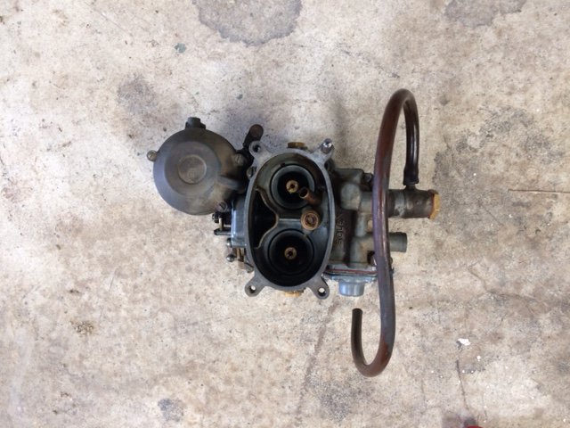

I have been mucking around with the carb. It still leaks fuel along the gasket line. I think I figured out some of what the mystery screw is for. I think it's some sort of air correction device. I have decided to leave it closed, because if you open it up some, you get a wicked backfire in the primary throat when you blip the throttle... It has also been sucking at cold starts. I have had a play with a 34 DMS Weber that NickJ lent me which is real good at cold starts. Unfortunately the DMS requires substantial linkage mods to be able to work, and I don't want to go down that road just yet. I think some of the issue has been with the Solex carb's lack of accelerator pump output. So I have pulled it to bits again and double checked the jets and passages which are all clean.
The jet sizes are all factory or very close to factory. It's hard to say for sure though, because there are so many versions of these carbs. I did find a problem however...Item 43 in the diagram below has a crack running right through the threaded hole on one side. I'm not sure how this will affect the operation of the accelerator pump if at all.
Upon reassembly it seems it's pumping quite well, and the car started easily and did not bog down when blipping the throttle, so I went for a drive to get her warm. The idle drops significantly when the engine is at operating temp, and also the accelerator pump output drops, and the hesitation/bogging down starts again.
Interestingly, reaching in with a hand to crack the secondary (while the engine is idling) reveals good, crisp pickup despite the secondary not having an accelerator pump jet. I am confused!
I need to find a parts carb to swap out the cracked plate in the accelerator pump I think.

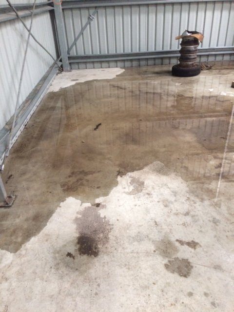

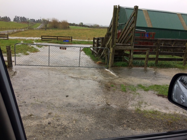

We have had a few dramas of late at the property with the recent heavy rains.  The road culvert is not big enough, and more importantly, the shed leaks. A lot.

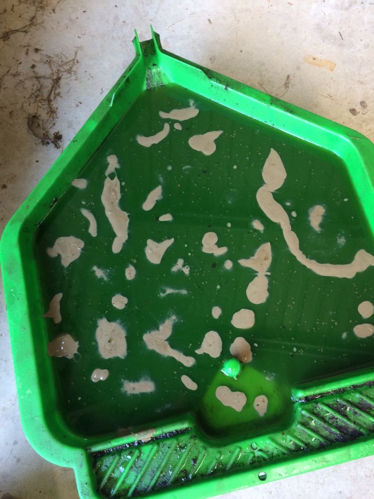

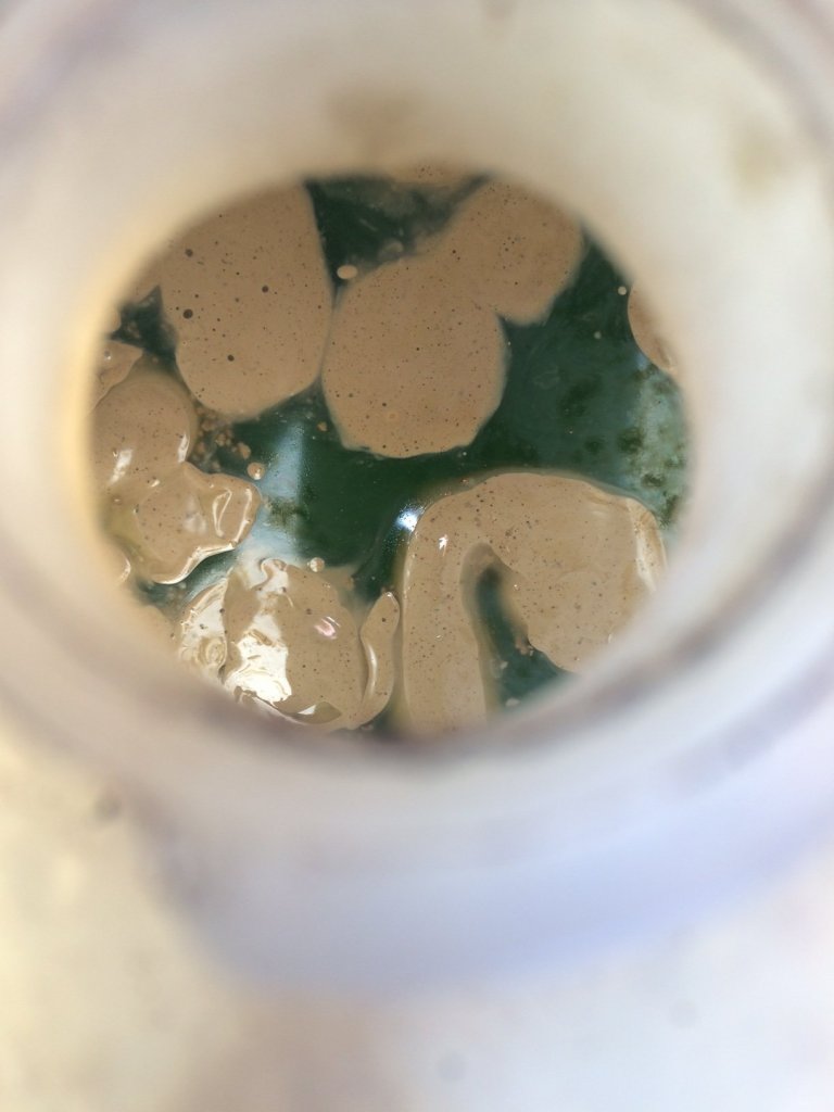

Fired up nearly straight away. Pretty good since it hasn’t moved since January. Then I got all fired up and thought I’d flush the cooling system. It has gunge floating in the expansion tank and I want to clean out the whole system and see if it comes back.
Looks a bit suspect but it doesn’t overheat or pressurise the cooling system, or milk up the oil so I’m not super worried at this stage. Anyways, I thought while I have the hoses etc off, I should do the cambelt too, so I started getting the tools out, making a plan of attack, and then.....meh. Jet lagged. Maybe later.
I had a half hour spare yesterday morning so I started to dismantle the front end with a view to draining the cooling system and gaining access to the timing belt. The drain cock on the radiator opened easily (phew) as did the engine block drain tap. The coolant looks very clean and green, like a NZ river....

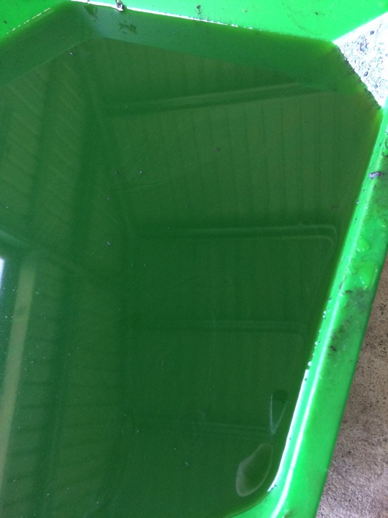

I am quite encouraged by this. Now look as I add the contents of the expansion tank...
The stuff is a greasy sludge. The seal on the radiator cap is also greasy to touch, but I’m not sure there is actually anything wrong. I did have one thought, I have heard the odd Barry go on about putting diesel in the cooling system for pickling purposes when parking a car up for ages. This car was parked up for ages. The coolant looks fresh, so maybe the residual oily crap has made its way and become trapped  in the expansion tank in the 100 or so miles it’s travelled since being liberated from the museum it came from.?

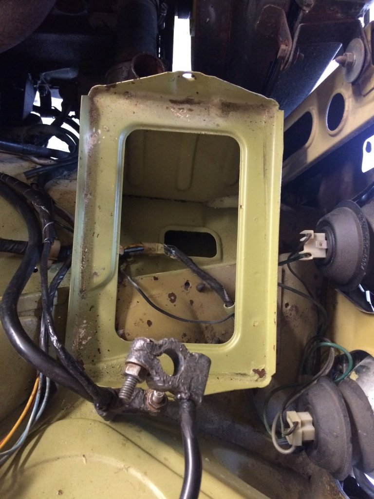

So, the radiator is a bit of a prick to remove compared to the Vogue I was working on a couple of years ago. I can’t get my ham hands onto the bottom hose for starters. The top hoses came off easy and happily there is very little corrosion on the alloy fittings. You then have to split the fan shroud and wrangle the top half out which only just fits. Then its just 2 nuts, tilt toward the engine and pull up and out. There’s not much clearance though, and not helped by the thermostat still being attached by the bottom hose due to my inability to undo it in situ. The radiator looks new. Next I popped the grille and headlights out (easy peasy, thanks Fiat). Now I can have a good look around. First impressions were the battery area looks good for a 45 year old car.

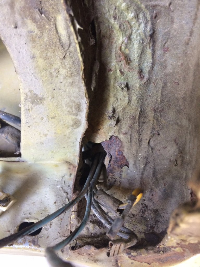

I can also see a lot more rust. Some expected, and some not! This is the left park light/indicator. You can see its rusted out around the wiring grommet.

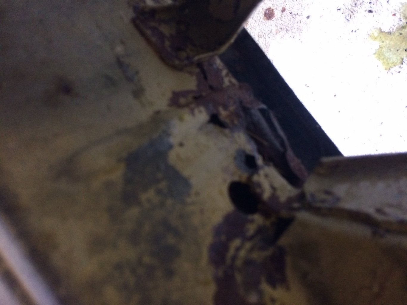

And the reverse of this...

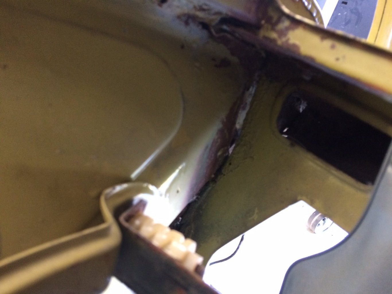

So there’s A fair bit of rust where the inner guard meets the nosecone. And then there’s the stuff I knew about. This pic is the radiator support area.
That’s Taken slightly upside down, the white area is my shed floor. Next I took the fan off and rattled the securing nut off the fan clutch/hub but now I’m stuck. I need a puller and I don’t have one. I’d also like to remove the crank pulley but my biggest socket is 36mm and the nut is bigger! Also no room for a rattle gun. Also interesting to note, the crank pulley is not a damper type. I think this is the first motor I’ve worked on that doesn’t have a damper pulley.
