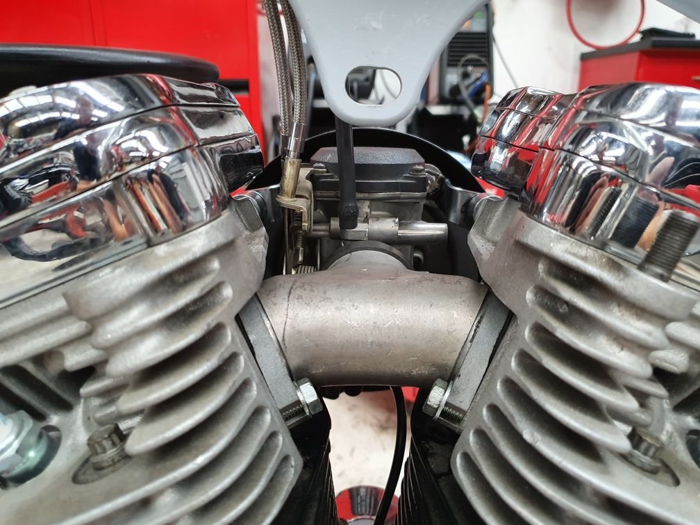

Found some bolts, cut them down to fit and this allowed me to properly install the manifold for the first time ever.
Then the carburetor
Fucken stoked with this! Theoretically I could fire this up now. But nothing is really bolted down properly as I've always known that the bike needs to fully come apart again for paint. But yeah...fuck yeah!

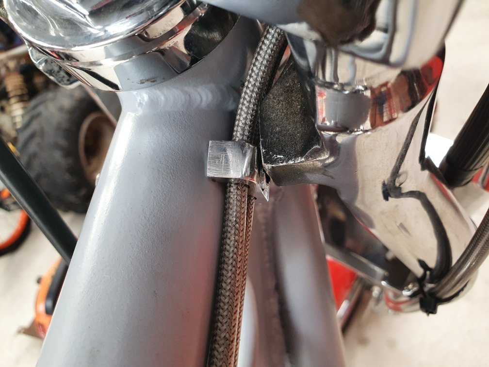

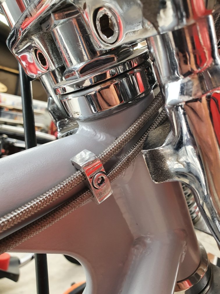

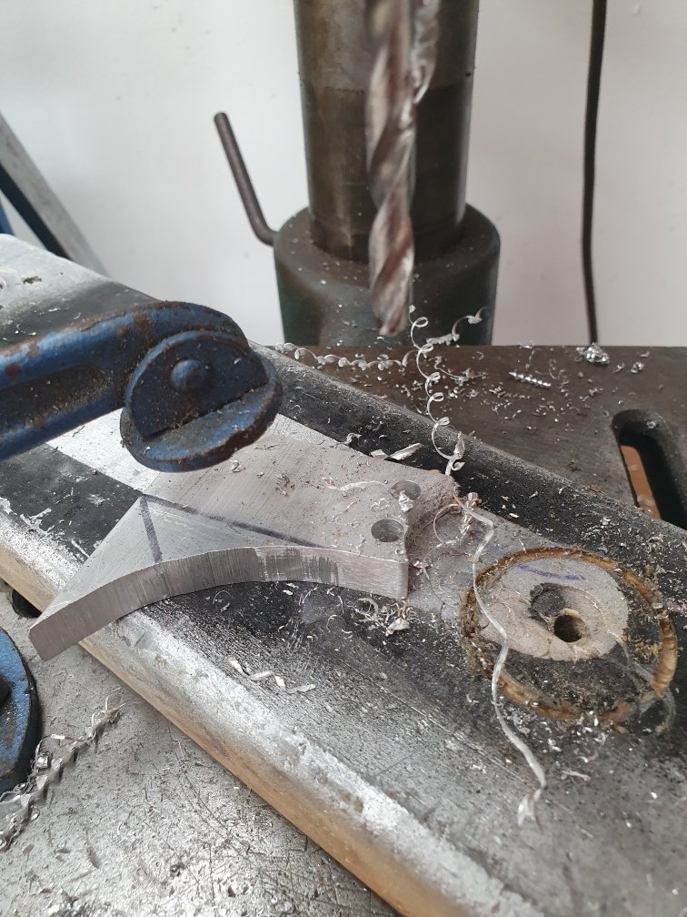

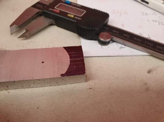

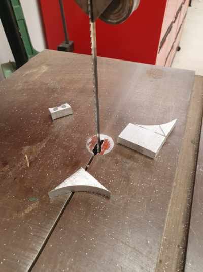

Cable holder for dual throttle cables. Stops them getting pinched by the forks against the frame when it's parked up on the jiffystand.
Marking out
Putting the radius into it, using holesaw same diameter as backbone of frame.
Cutting. Then sanded on linisher and polished it up on buffing wheel. Finger burning stuff...
Sexy!
Serves a couple purposes. Yeah, I'm happy with that, another win.

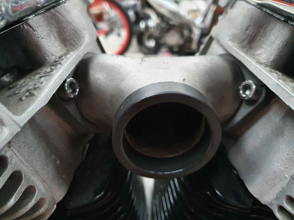

So, my model of motor was an earlier version of the Evolution 1340cc. The main difference between these two is the later evo's have a head vent for removing crankcase pressure and the early models have a crankcase breather.
So mine has the crankcase breather, not the head vents. However my carburetor is off a later model, so is setup to suck crankcase gases from the heads.
Banjos for head breathers. These are about 16mm diameter, quite big eh.
Huge holes for oversized banjos to go in, but behind this is only a 5/16 unc (about 8mm) threaded hole in the head. So a 16mm banjo isn't going to go in an 8mm hole.
So, my first idea was to eliminate the pcv system altogether. But then I'd have shifted the problem;
○ I'd have to make spacers for the carburetor steady.
And
○ I would still have 2 hoese to block off coming from the air intake.
So, my cunning plan, make a stepping washer to centre everything, then bolt it up with the required 5/16" bolts that will effectively blank off the pcv valves.
So, time to get to work with shit lying around...covid19 lockdown prevents zipping into town to buy some materials, so I'll have to make do.
This will work, just needs some love to shape it into something useful. Luckily I have a small box of these pneumatic fittings.
Starting to look the part.
Better.
Fuck yeah! That'll do it...

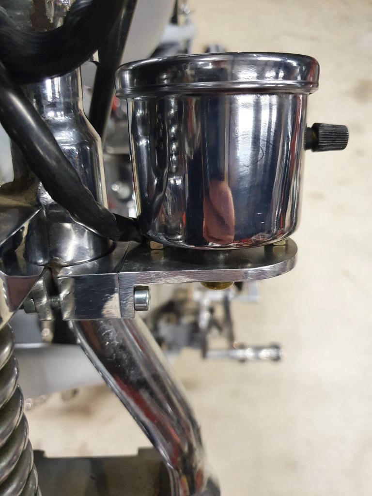

Today's efforts, take a chunk of scrap:
Add some more scrap metal to it...
Mill the bejesus out of it...
Add a speedometer...and fuck yeah!
Just in case you were wondering if I can actually see it when on the bike, the last pic was taken sitting on the bike.
The cable has a straight line down to the speedo drive, so will look tidy and minimize the ugliness of needing a cable. And it keeps the handlebars looking clean, plus the springs are where a normal speedo goes, so all up I'm stoked with this.
Here's a photo standing back a little bit, you hardly notice the little speedo hiding there.
Sure, I'd rather not have it at all. But for what it is, it's not too offensive.
Mmmm, shiny. Buffed it up on the rag wheel. Bracket looks like it belongs there now.
I learnt that aluminum is a very good conductor of heat, far out it gets very hot, very quickly... hot fingers! No pain, no gain or something like that all the tough kids used to say?

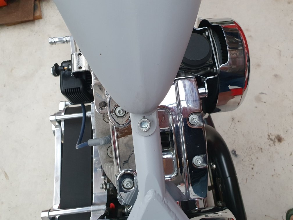

Anyway, while this enthralling conference was going on I noticed something for the first time, a potential health and safety problem of my own, but not a bullshit hypothetical one, an actual real world problem.
Yip, my belt could contact this gearbox mount. Fuck!!!
(Warning 1:41 of your life you'll never get back if you watch this)
So using what limited materials I have, I made this up. Hopefully its thick enough to space the pulley off the hub a sufficient amount? My entire bike is offset by 1/2", so I'm thinking a 1/4" spacer may not add up. It looks like it's going to work...but after that teleconference and an hour on the lathe all I can think about us getting fucked up so I don't have to think about today. Beer o'clock is well and truly calling. Fitting this can wait until tomorrow.
Balls!!!!
Okay, looks like to be safe the 1/4" isn't the best idea, so better to go with a full 1/2" offset spacer for clearance.
This is with the 1/4" spacer in. It clears the gearbox mount...but only just! If the belt slops around, as they do when you go WOT then suddenly back off...there is a chance of the belt whipping and hitting that mount. It may never happen, but may as well do it right.
I could cut the mount, but I'd rather not fuck with that, as the motor and gearbox are sitting perfect right now, all fully aligned and flat on the same plain.
But, as you all know. The moment you shift something, it creates flow ons. I now need to remake this fender strut. Double balls, as it cost me $50 to get this one chromed and it looked fucking good too!
And
This entire mounting system of holding the rear fender, oil tank and remote oil filter has to be remade too. It would work with 1/4", but not with the 1/2" offset.
So this minor oversight is a bit of a cunt, as its created a lot of work.
