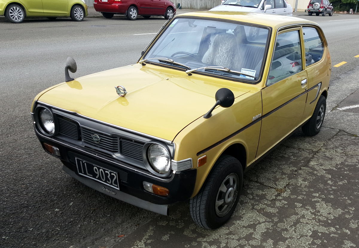

Brucehc Posted February 21, 2017 Posted February 21, 2017 My 1972 Daihatsu Max 360X has now been some 4 years in restoration. Starting with full brake rebuild then on to fuel tank restoration (sealing the old rust!). I got it running though very poorly, so decided to leave the engine until last. I took it to a local mechanic to get it roadworthy - so plenty of small jobs were needed for that. Biggest obstacle seemed to be the windscreen. They wanted it replaced but eventually accepted it was OK with a re-polish. The engine needed a total rebuild and took some 18 months of tedious work. Sourcing parts is such a headache from Japan! Finally little Max is registered (Club) and running on the road. He just may be the only one is captivity still? Next job is stripping the surface rust and doing a repaint. I am having a go at that myself. Here is a pix of Max as he is today... Quote

Brucehc Posted January 7, 2018 Author Posted January 7, 2018 After almost 5 years my Max is now fully restored. The mechanical work was finished a while back but this year I got stuck in to the paintwork/bodywork. After some poor attempts at doing it myself a mate helped me do it right. Several months later all dints and surface rust etc removed - the body was repainted in the original Daihatsu yellow. Also, we re-painted/finished the bumpers and grill, and even the air cleaner (back to original blue under the bonnet!). The finish looks great and it is now really like a new car. I have put in new grey carpets and a new set of seatbelts in maroon red, as the old ones were well past it. A final big clean of the insides and it has come up a treat with all those who say Max as the sad and broken little car 5 years back transformed now simply amazed at the difference. Here he is... Quote
