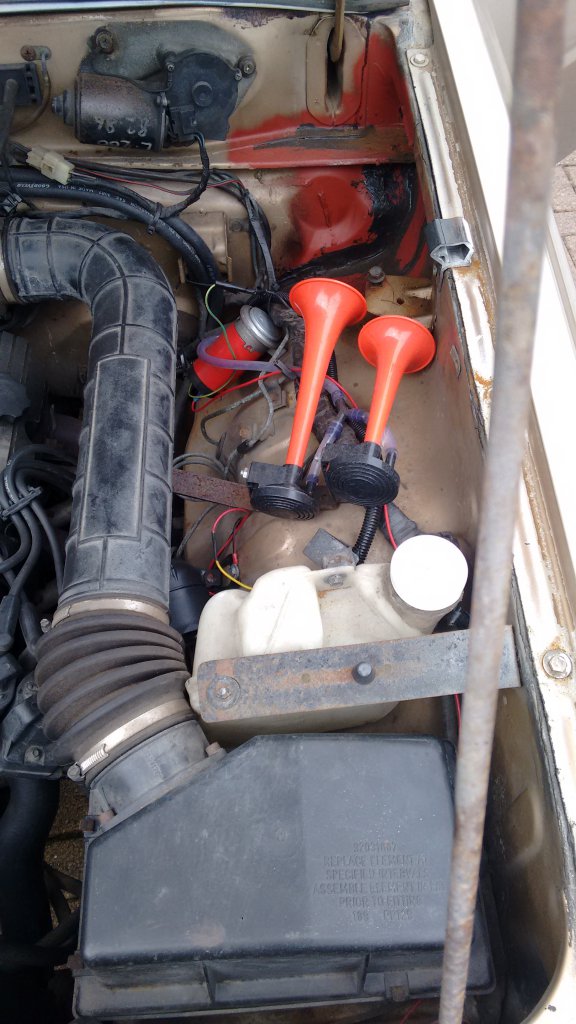

tortron Posted October 7, 2017 Author Posted October 7, 2017 I hate the mess under my bonnet, it causes me anxiety and electrical nightmares. Have gathered the nervous systems from a couple of dead commodores and am thinking of the best way to redo it. Anyway, that brings me to the air horn, I don't care for these smaller air horns, the red is grating, it's pointing the wrong way, there's a million miles of wire wrapping around both sides of the truck to reach it, they hacked a bracket to install it, and Im kind of keen on getting the bay looking factory with minimal loom showing Quote
tortron Posted October 7, 2017 Author Posted October 7, 2017 So I installed a pair of dual tone mitsuba horns behind the grill 1 Quote
tortron Posted October 7, 2017 Author Posted October 7, 2017 Il remove that hacked bracket, welding up all the unused holes and I might shift the engine loom to the LHD position as seen in red 2 Quote

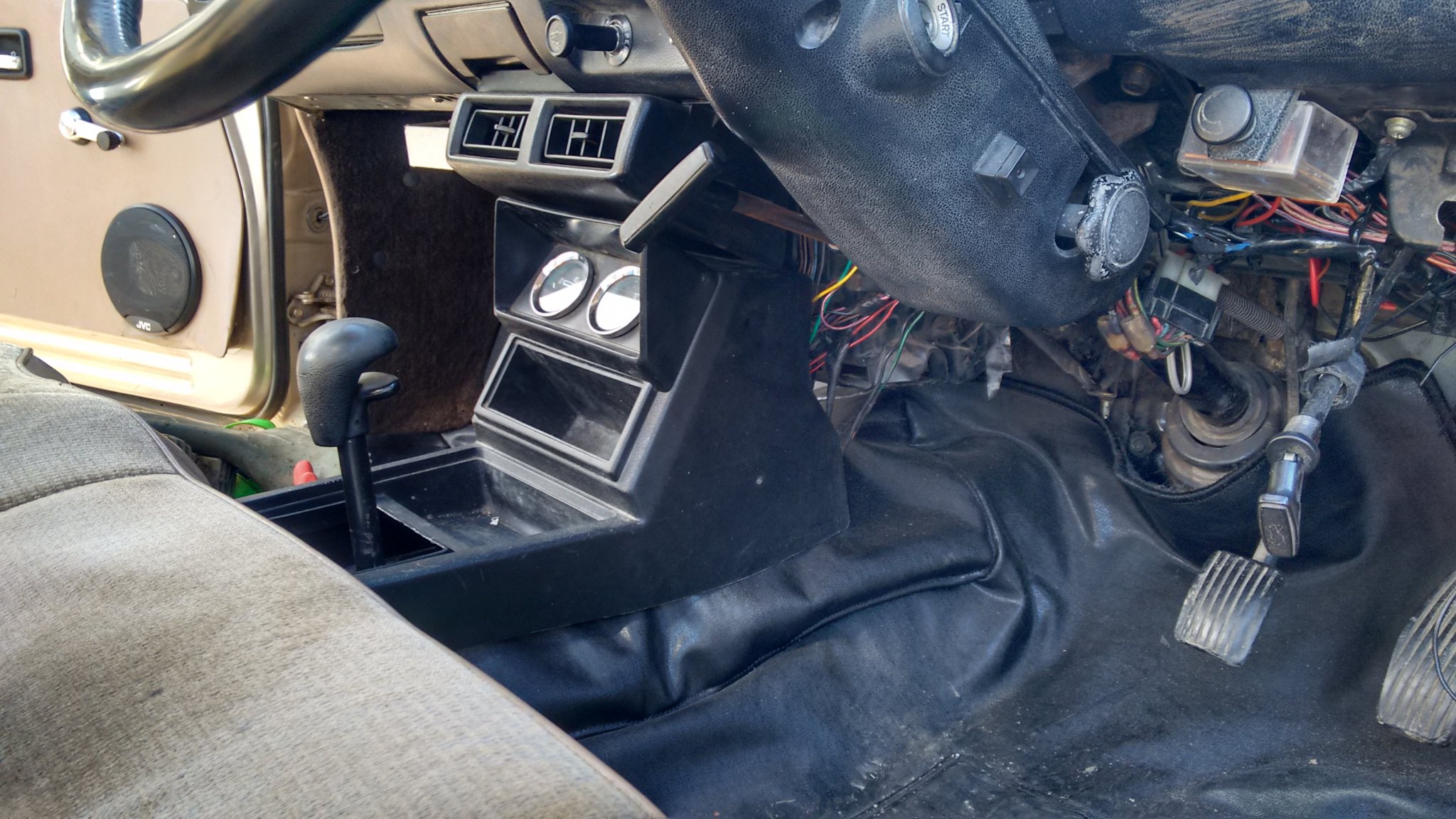

tortron Posted October 30, 2017 Author Posted October 30, 2017 Fresh out of the Mojave desert, I got this dodge d50 sport centre console with gauge pod add on. The yanks actually got sport models with bucket seats, sun roofs and wild decals, we just got farm trucks with maybe a clock Probably the only one in the country 9 Quote

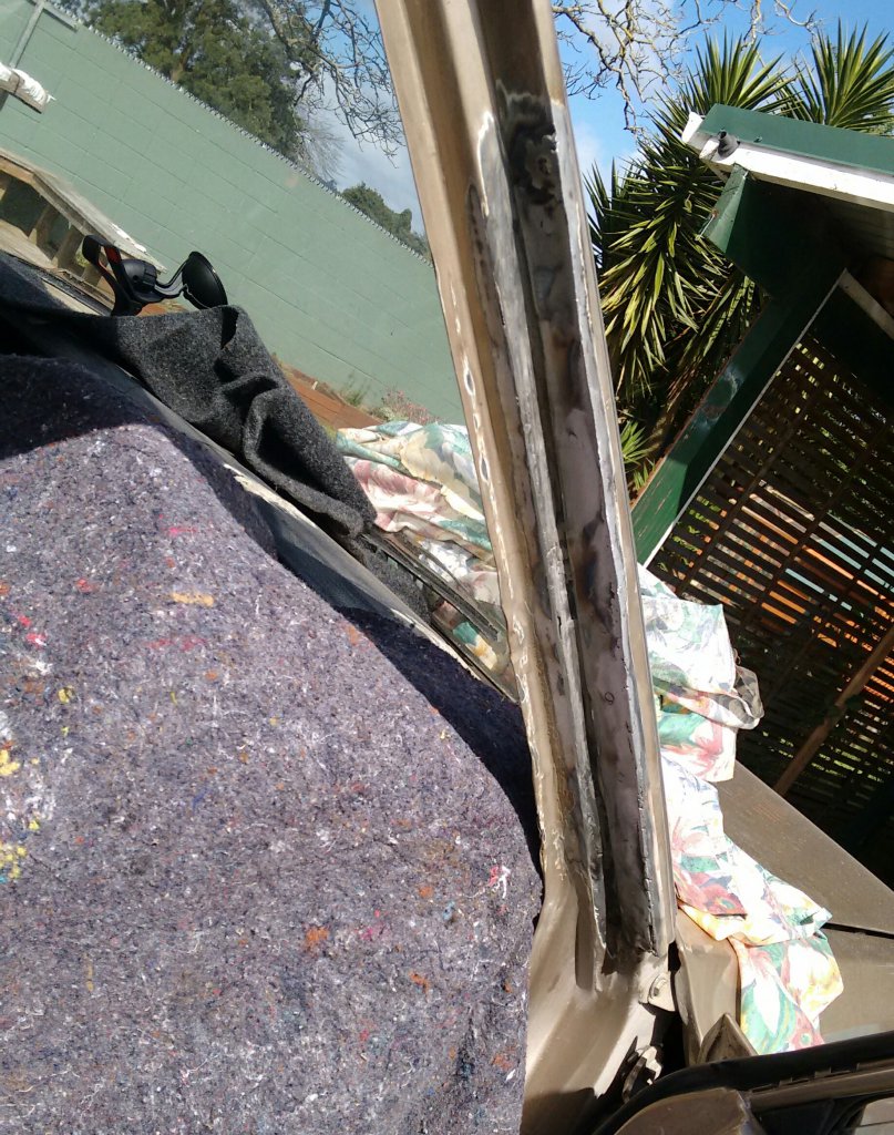

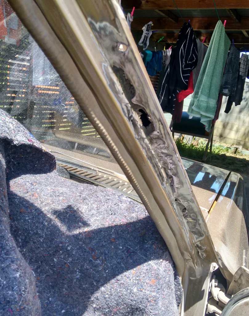

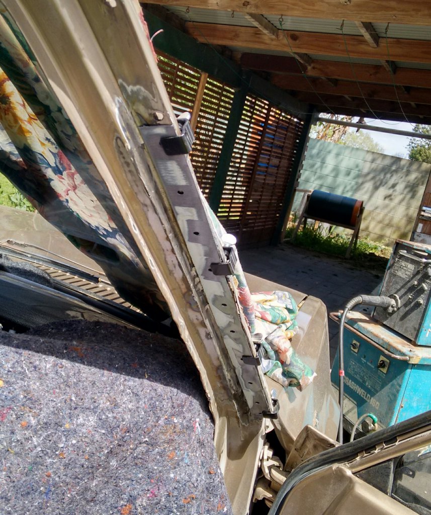

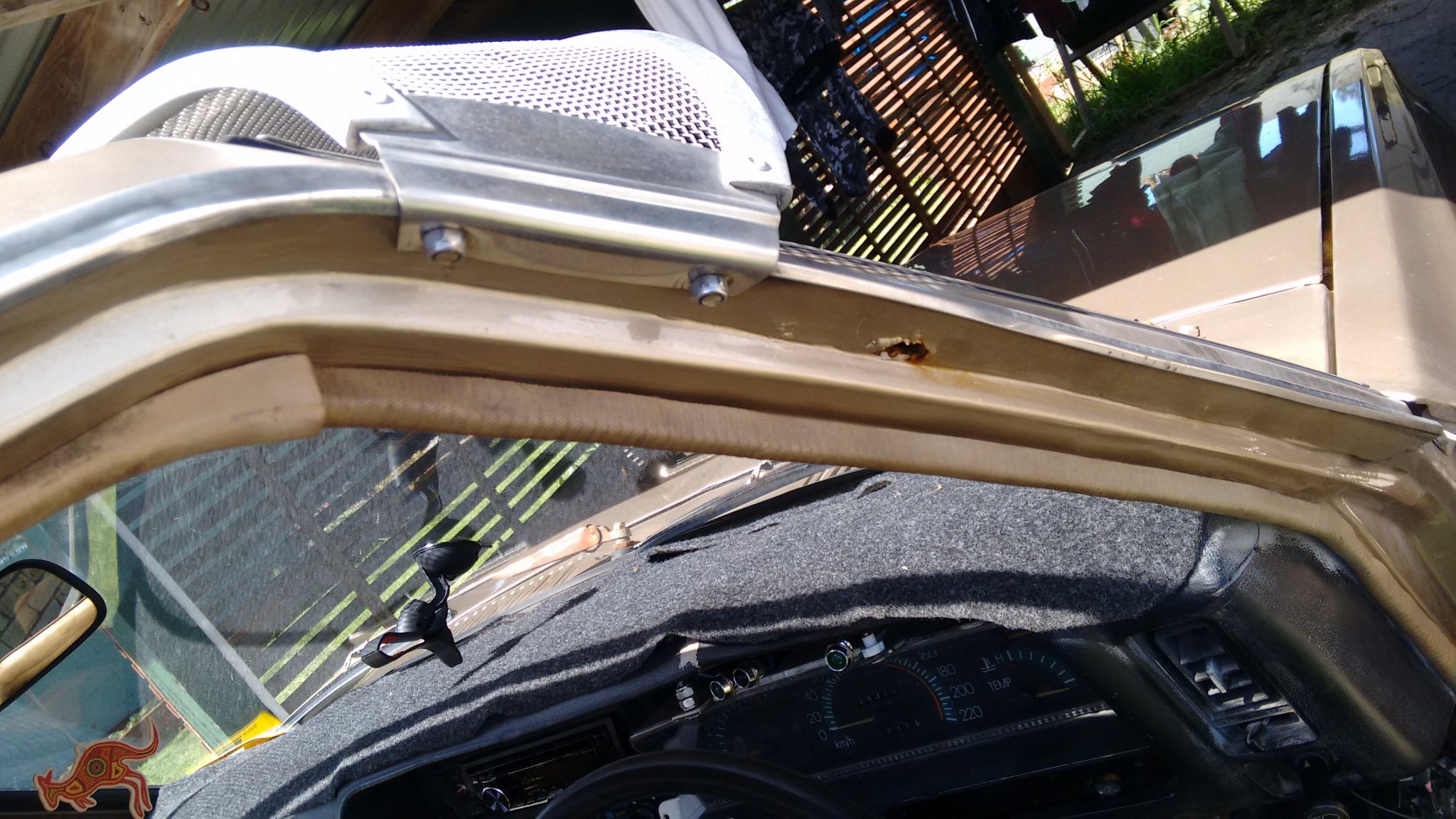

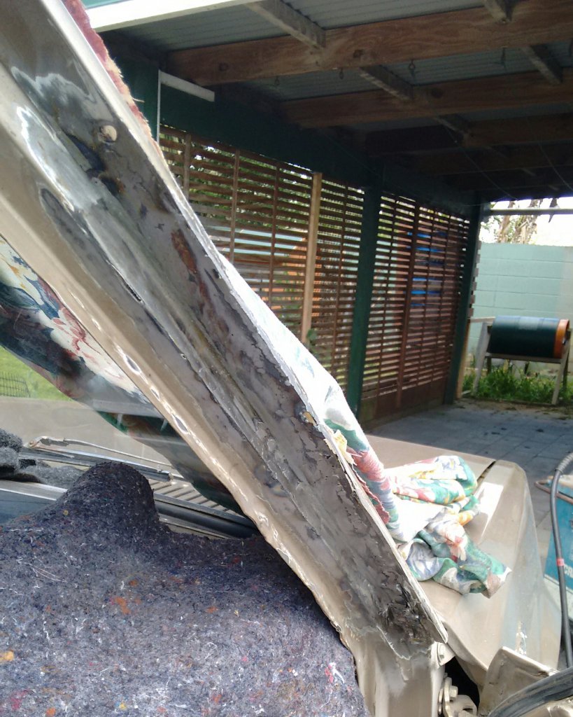

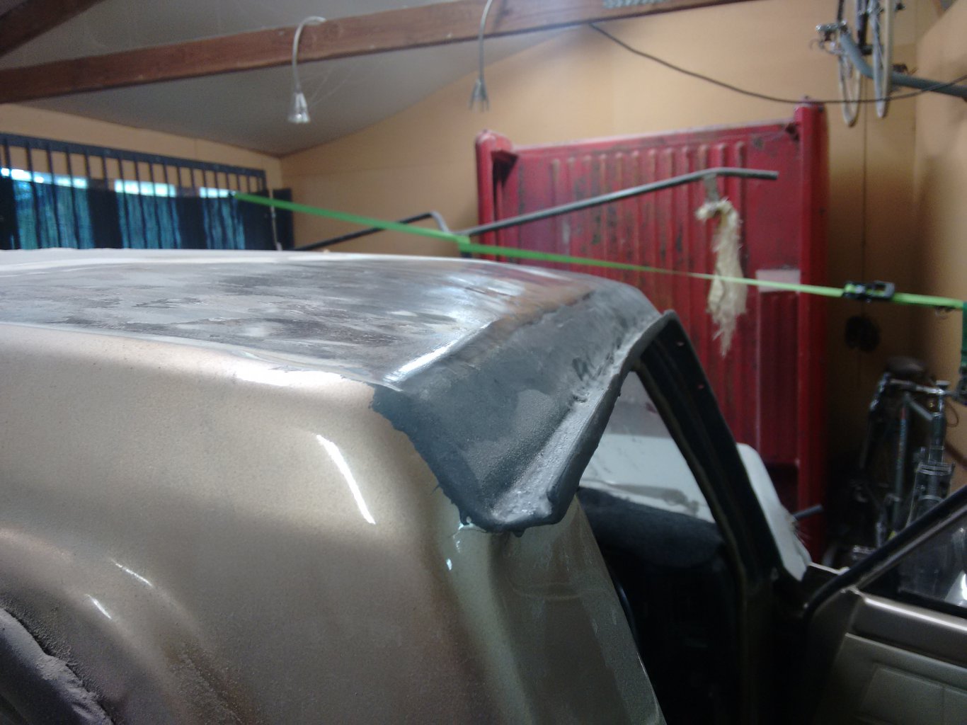

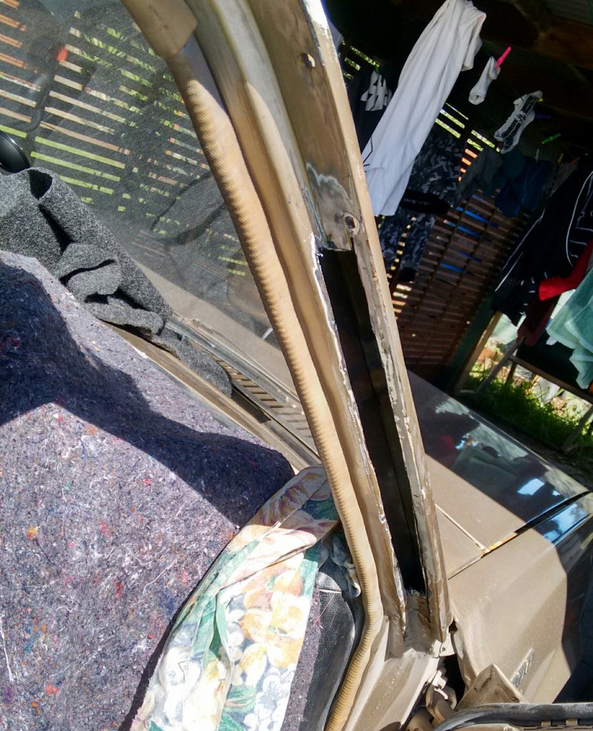

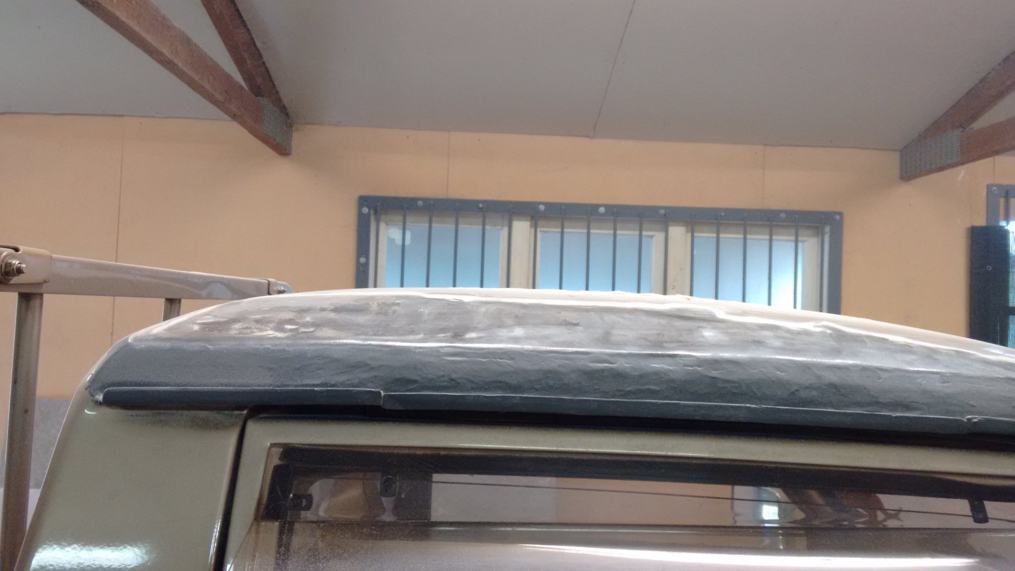

tortron Posted November 13, 2017 Author Posted November 13, 2017 Have had a bit of an oil leak, getting worse over the last few months, looked like the power steering pump. I think probably just the reservoir o-ring, but I got a whole seal kit anywaylooked decent inside, and has been good the last couple of weeksGot stuck into some more rust this weekendhad planned to do some down in the sill, but wanted to clean up some of last times stuff. This got me to picking scabs. It all looked good with the paint on, but I had been getting some water dripping from the upper door trim plastic, it could only be coming from a hole in the rain gutter, so I stripped it backyup pretty manky, about a 1/4 inch of bog up the a pillar and roof, I think theres a lot of bog on the roof as some has cracked (probably before it was even painted because the clear coat is smooth over it), some rough old patches, and some good old space age nu-tech better than metal fillerchop it outComing in though the bottom tooso cut that out as welldoor frame back infound some more filler on the corner, theres an aweful lot of nutech near the screen seal, from what I can see through the hole it doenst look like its full of holes, probably just the good old technique of bash it in with a hammer and fill over everythingI'm wanting to use the truck so I cant take the screen out right now, but at some point il take it out and baremetal the roofall patches in, looks rough as can be because theres a step down on the roof filler to the metal, oh well, hopefully I get some time off this summer and il get it looking decent 7 Quote

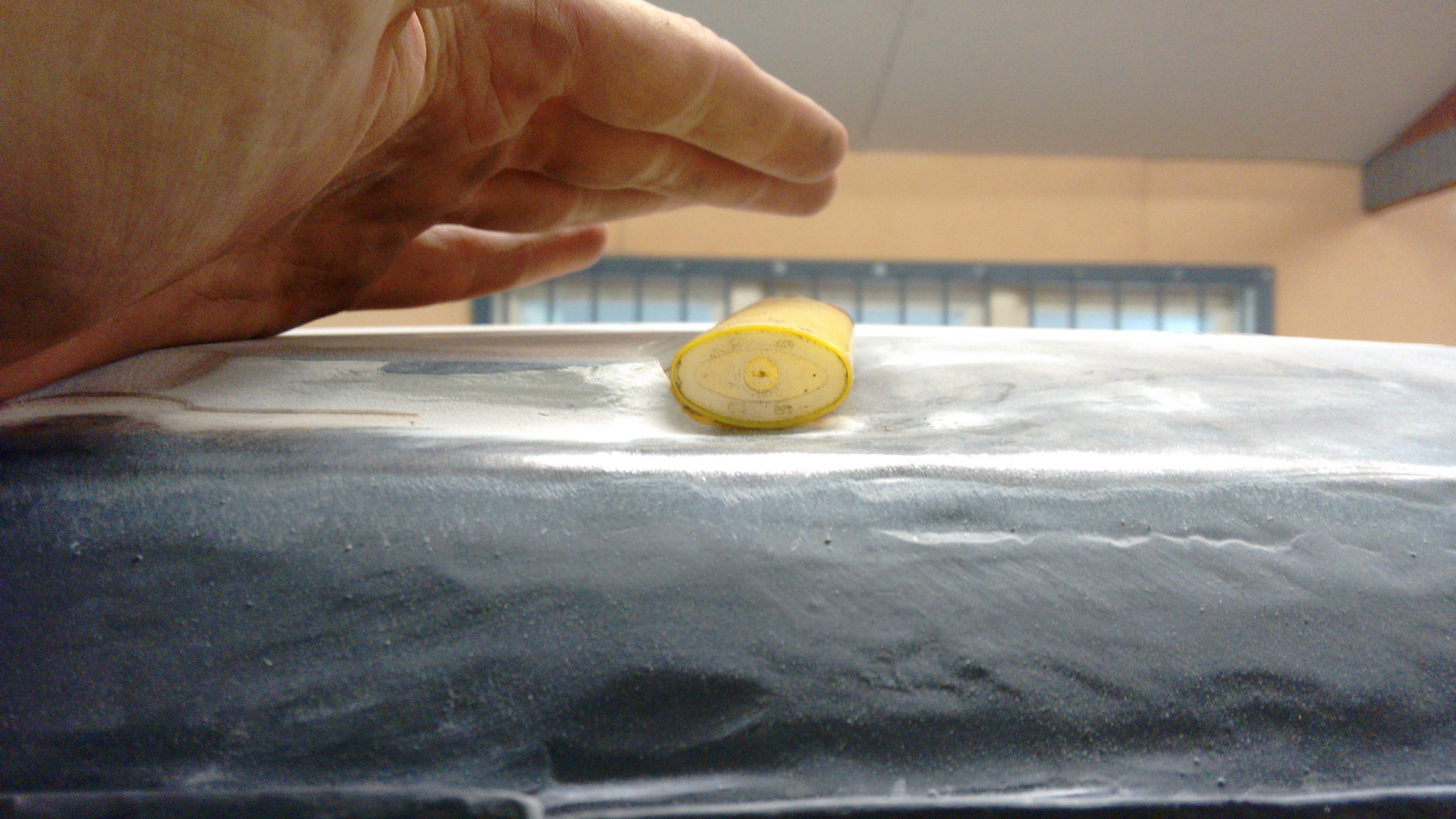

tortron Posted January 4, 2018 Author Posted January 4, 2018 I dunno man, maybe I'm getting old, but it literally only took the playtime of blister in the sun to knock out 90% of those dents. Only levered them out and haven't started panel beating yet. Surely that's better value than a gallon of bog even on special. There's a bit needs shrinking down in the middle and the windscreen corner is a bit tight to get under, but Il knock that out sometime soon 5 Quote
