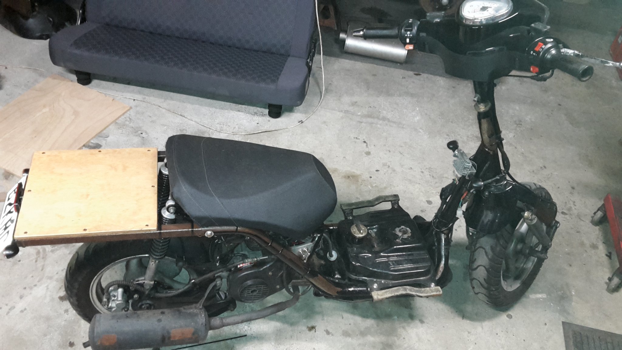

Popular Post cletus Posted August 12, 2018 Author Popular Post Posted August 12, 2018 Prep for eastcape ride. I have ordered some stuff off ali to make it go a bit better and will get some more off road suitable tyres. Made a bit on the back for carrying crap , mounted the lights further back. I looked at it when I finished and came to a terrible realisation Barryness has occurred *wood used on a motor vehicle *self tappers used to attach wood *application of penetrol with a brush 16 1 5 Quote

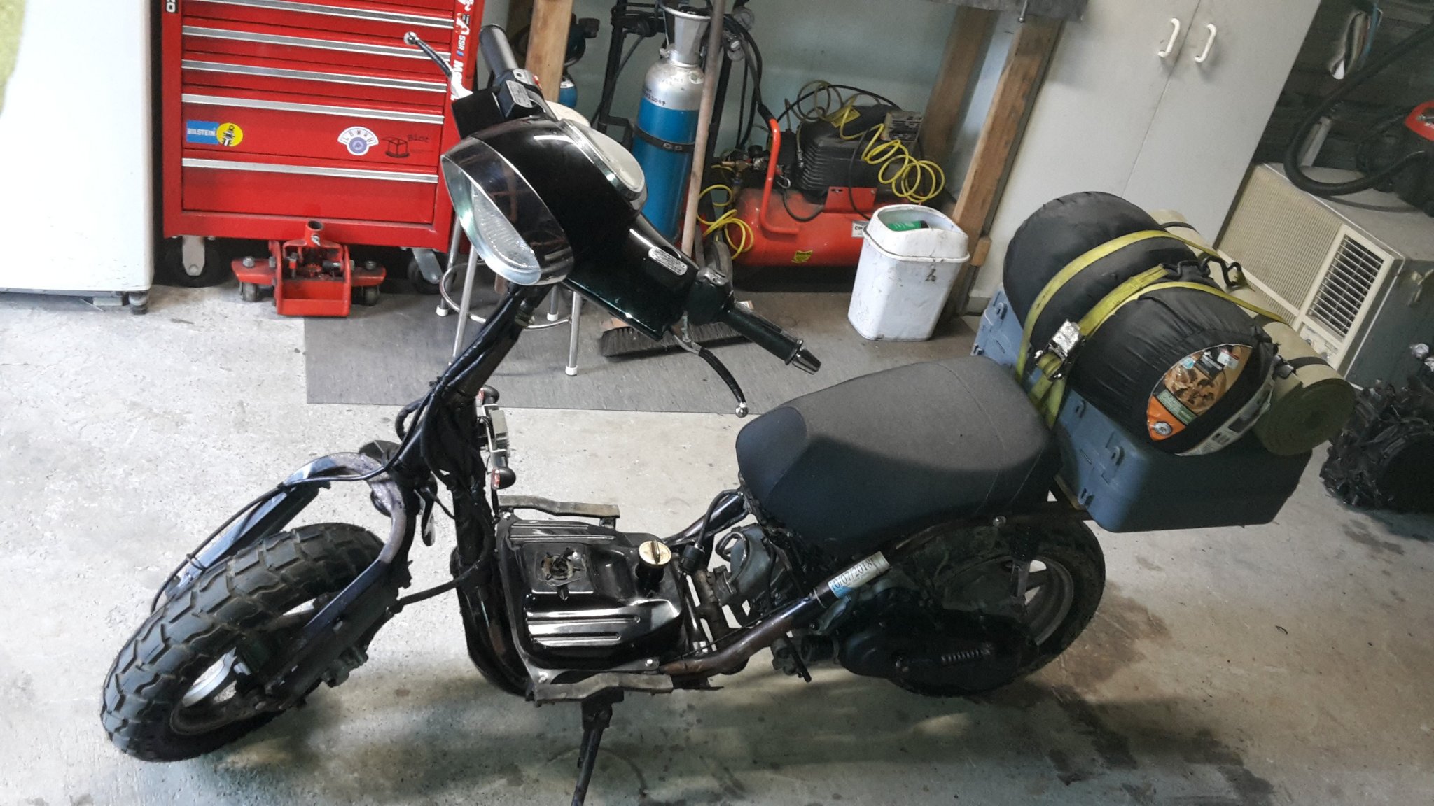

Popular Post cletus Posted September 16, 2018 Author Popular Post Posted September 16, 2018 I think it's ready. New "49cc" piston and barrel, new cam that china says is better, pit bike foam air filter, and opened up the exhaust a bit. Fitted some dual purpose tyres. Went for a run in ride today for a couple of hours, did some off roading and fell off, changed the engine and gearbox oils, and tried out its cargo carrying abilities. 13 1 Quote
Chris.QCR Posted September 16, 2018 Posted September 16, 2018 Does it wheelie easily ? Damn thats a good setup for cargo Quote
cletus Posted September 16, 2018 Author Posted September 16, 2018 Nah not at all. It's quite heavy and not very powerful. I did get it to do one but I was sitting on the cargo bit Also my wheelie skills are weak, I have got another bike I need to make a fuel tank for, for wheelie practice 2 Quote
cletus Posted September 19, 2018 Author Posted September 19, 2018 Meh... It does go better but it's no rocketship. It is quite heavy for wat it iz It did go up a steep grassy hill that I didn't think it was capable of though. 3 Quote
RUNAMUCK Posted September 19, 2018 Posted September 19, 2018 How fast is it tapped out? (I really don't wanna be the slowest guy on the escapade) Quote
Vintage Grumble Posted September 20, 2018 Posted September 20, 2018 2 hours ago, RUNAMUCK said: How fast is it tapped out? (I really don't wanna be the slowest guy on the escapade) Old mate Dan's coming on zoomer, that thing tops out at like 62kmh, so you should be safe. 5 Quote
cletus Posted September 20, 2018 Author Posted September 20, 2018 Have seen 80kph downhill with no regard for how it sounded at the time, but the speedo seems a bit optimistic, will GPS check and report back 3 Quote
