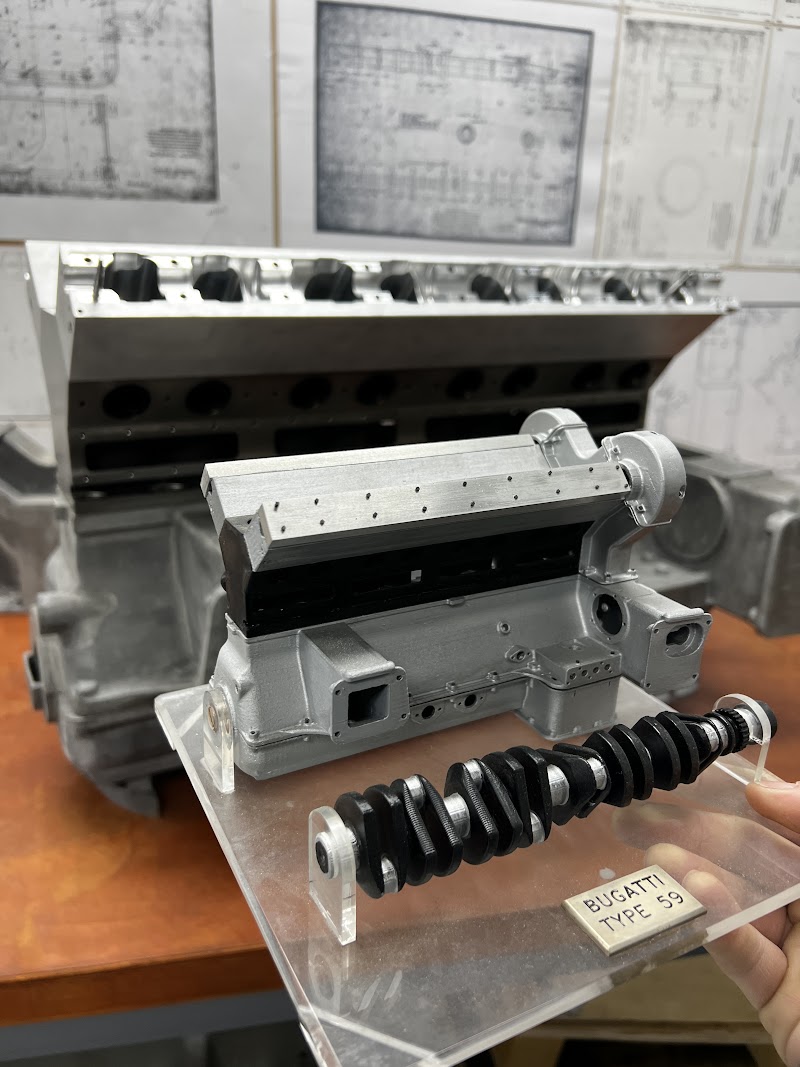

I have to admit, when I first saw this thread, I thought that you were 3d printing a plastic engine, as a model and lost interest, but I have come back a few times and holy hecka- how many hours are you into this project?ย
Mind Blowing
If only it was a model engine! Would have been done a decade ago!
ย
No idea on hours. 1000s and 1000s. Generally expected/accepted that a full car like this would be 16-20k hours.
