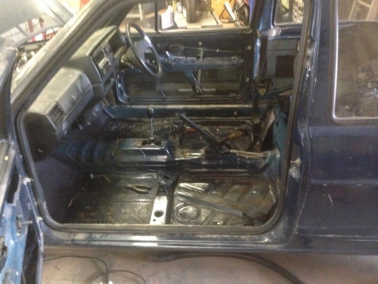

First step was to clean the inside of the car out as it was foul. I picked up The seats and door cards out of a GTI off trademe so that saves me getting the originals fixed but the rest of the interior still needes work. Ill get to that later.

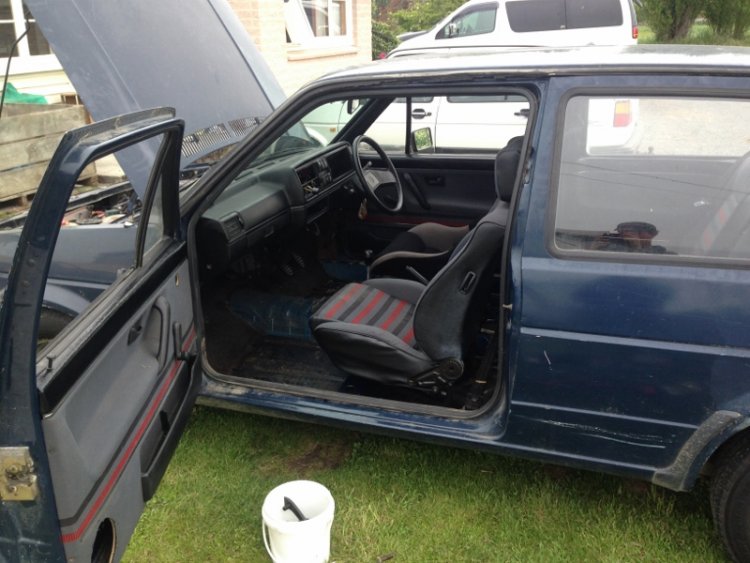

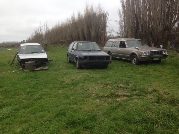

Another Mk2 3 door came up for sale in Nelson with straight(ish) panles and as every panel on mine is dented I jumped at it. It was a wreck, 1.6 diesel manual with a run big end. A few bits had already been taken including the trans and front guards dammit. My brother and I went for a road trip with the car trailer to get it. There was a few unexpected goodies in the diesel including factory central locking, powersteering and A/C. Those might make it into the 1.3.

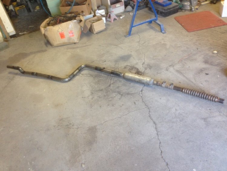

At some stage a resonator had been added to the exhaust system but the car still sounded weak so in the spirit of stupidity the back half of the exhaust and the muffler were cut off and replaced with 2” pipe. Now it sounds good.
The interior gutting continued with nasty carpet lifting which revealed damp and mouldy sound proofing. All of which was promptly put in the bin cause weight reduction bro.

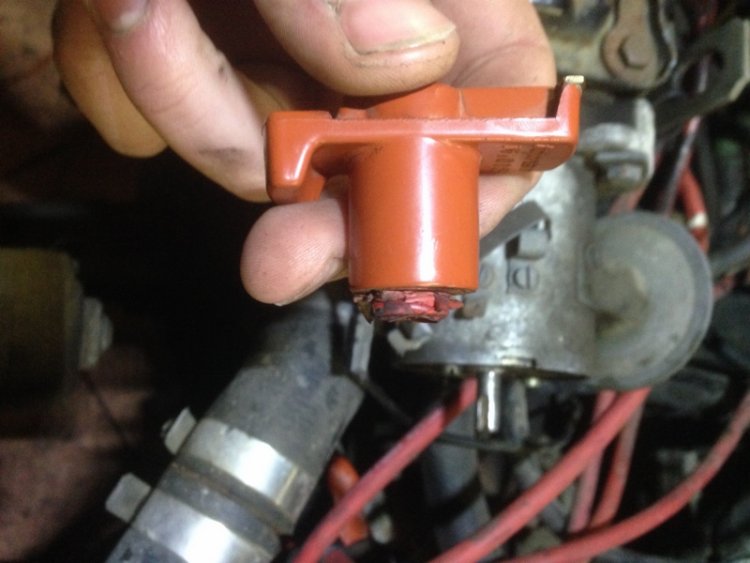

The last couple of weeks have been filled with sorting small issues, lots and lots of small issues. The indicators and hazards don't work and after spending most of a day on them I'm still confused as to why not. I made the rear fog light work, helps to have a fuse in it. It was missing a little so I decided removing the distributor cap was a good idea. I was greeted with scenes of butchery I cant even begin to fathom. Someone in the past couldn't get the right dizzy rotor so decided packing an 1.8 rotor with electrical tape so it fitted on the shaft was a good idea. Problem is there was nothing but hopes and dreams holding it in place and was rotating out of time. Getting the right rotor is proving difficult so a dot of super glue is keeping the timing for the short term.

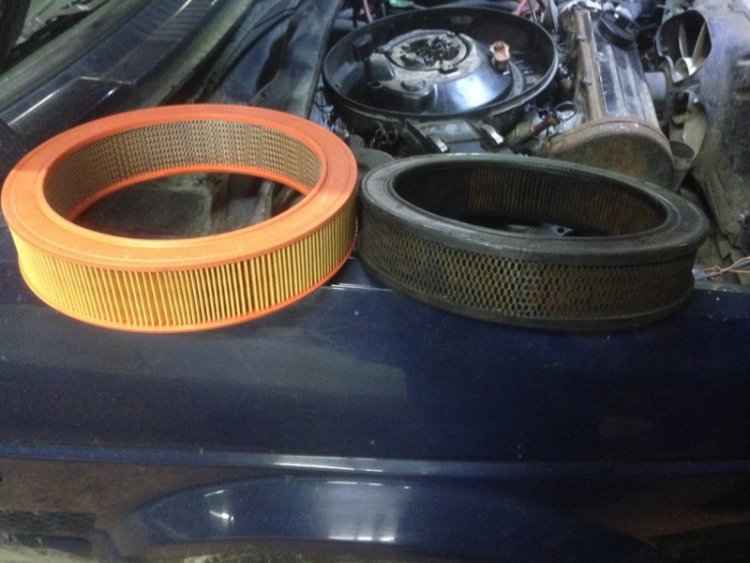

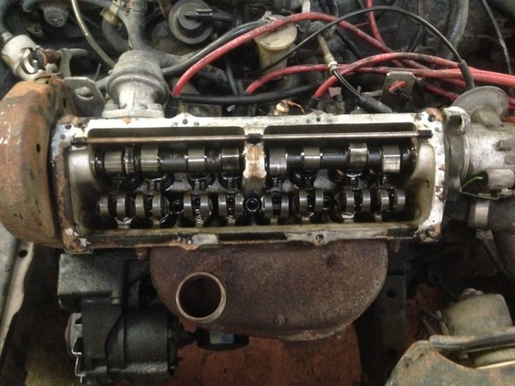

After changing the air filter, cleaning and re gaping the plugs, setting the valve clearances which were almost 3 times what they should have been and tweaking the idle speed I had the little golf running smooth as a fancy gold watch. It was running so well I decided to go for a quick squirt up the road. It accelerated well, sounded good and road well. The gearbox has a massive jump between second and third, almost feels like there should be an extra gear in it. Pretty much now its just needs the electrics sorted, new tires and the seats bolted in and it should be ready for vinning.

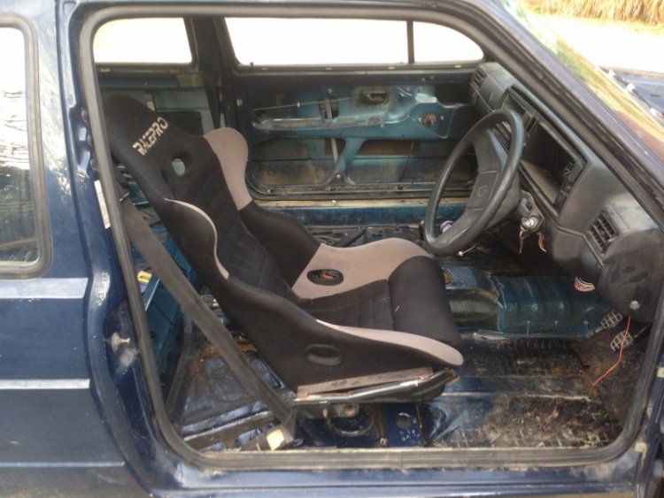

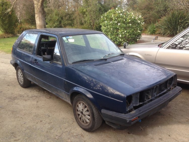

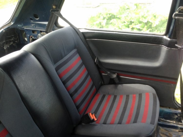

I Bolted in a basic interior consisting of door panels, seats and dash. No need for anything fancy. The original gauge cluster had Chernyobled a few components resulting in nothing working so the diesel parts one was sub in. the kms have jumped up 100,000 (no I can't be assed pulling it to bits and winding it back) but everything works and I gained a clock. Plus it has a redundant glow plug light which might make people confused.The diesel parta also donated various nuts and bolts, a straight front bumper and rear seat mounts.

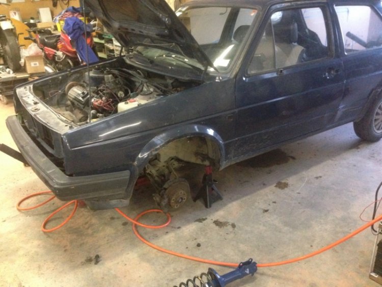

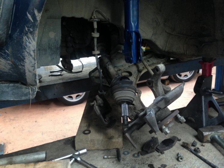

I decided to pull the brakes to bits to inspect them, in hind sight this was a bad idea. The rear linings were down to minimum, rear wheel bearings and seals were on their last legs, a CV boot was split and the front discs were heavily pitted from sitting for ages.  The rear was cleaned and reassembled (it works so it is fine for now) but the front required action. Upon inspection the diesel discs, pads and calipers were in good condition so I spun the discs on the lathe and cleaned them up with a bit on emery paper and then all was installed. While I had the brakes apart I replaced the CV boot and cleaned and re-greased the CV itself. It was the first time I pulled a CV to bits but it's really simple.
So with everything bolted up it got loaded on the trailer and dragged to Ashburton. I put it up on the hoist at work and gave the underside and engine bay a steam clean, probably removed a few kilos of dirt and yuck. Hopefully the list from the compliance place isn't to long.

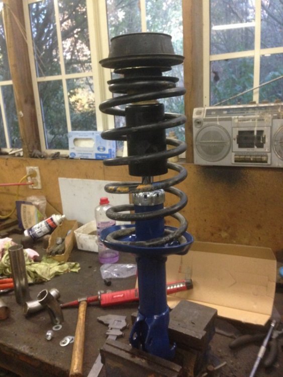

Had a bit of spare time on my hands so I decided it was time for a little work on the mighty Golf. First port of call was removing the carb and giving it a damn good clean because the car has been running like shit for the past couple months. I cut out a new gasket for the 2 halves of the carb but was lazy with everything else and used grey RTV. Next was breaking out the Bosch one way lowering kit. having a extra set of springs from the parts car comes in handy about now. After a bit of measuring I thought lopping a coil out of each spring was a good start. I could probably take another coil out of the rear springs but the fronts will no longer be captive if I make them any smaller. I should just stop being cheep and get a set of coilovers if I want to go lower. It hasn't made a huge amount of difference but the rear end has come down getting rid of the "Stink Bug" stance.
