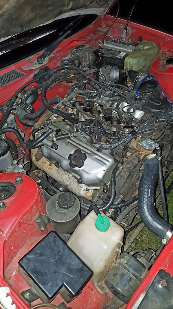

Temperature gauge was hovering just below half way the entire time which is normal. On the trip back to Nelson that night, everything seemed fine. Had to pull over due to a accident with a car towing a boat on the trailer flipping over(hope they were alright, car looked alright though) and noticed steam coming out from under the bonnet. Then noticed it had no coolant in the radiator or hoses. Radiator hoses were just fine, no leaks or anything. Main suspect was a small hose under the intake manifold. But as it was about 10pm and getting a tow truck was too expensive, and we had no tools or parts etc. decided we were going to leave the Z sitting in a paddock while we went back up to Nelson.
Next day, drove down again with a mate and his Hilux and car trailer. Picture of it on the trailer
Drove all the way back, almost ran out of diesel, but finally got it home.
Then took up the task of finding that leak.

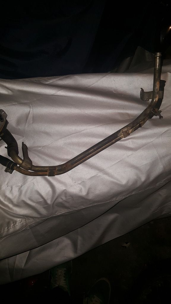

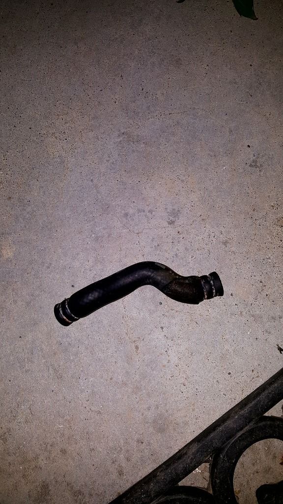

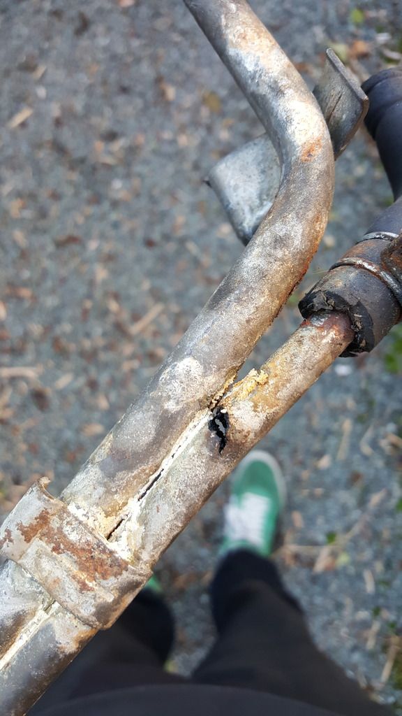

Found the shagged hose, then discovered that it wasn't the only leak and found a big split on the coolant pipe to the throttle body
Fixed all that and the Z lives again. Thankfully it didn't overheat

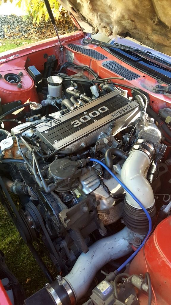

Also, I've painted the intake manifold cover as it was looking a bit worse for wear
