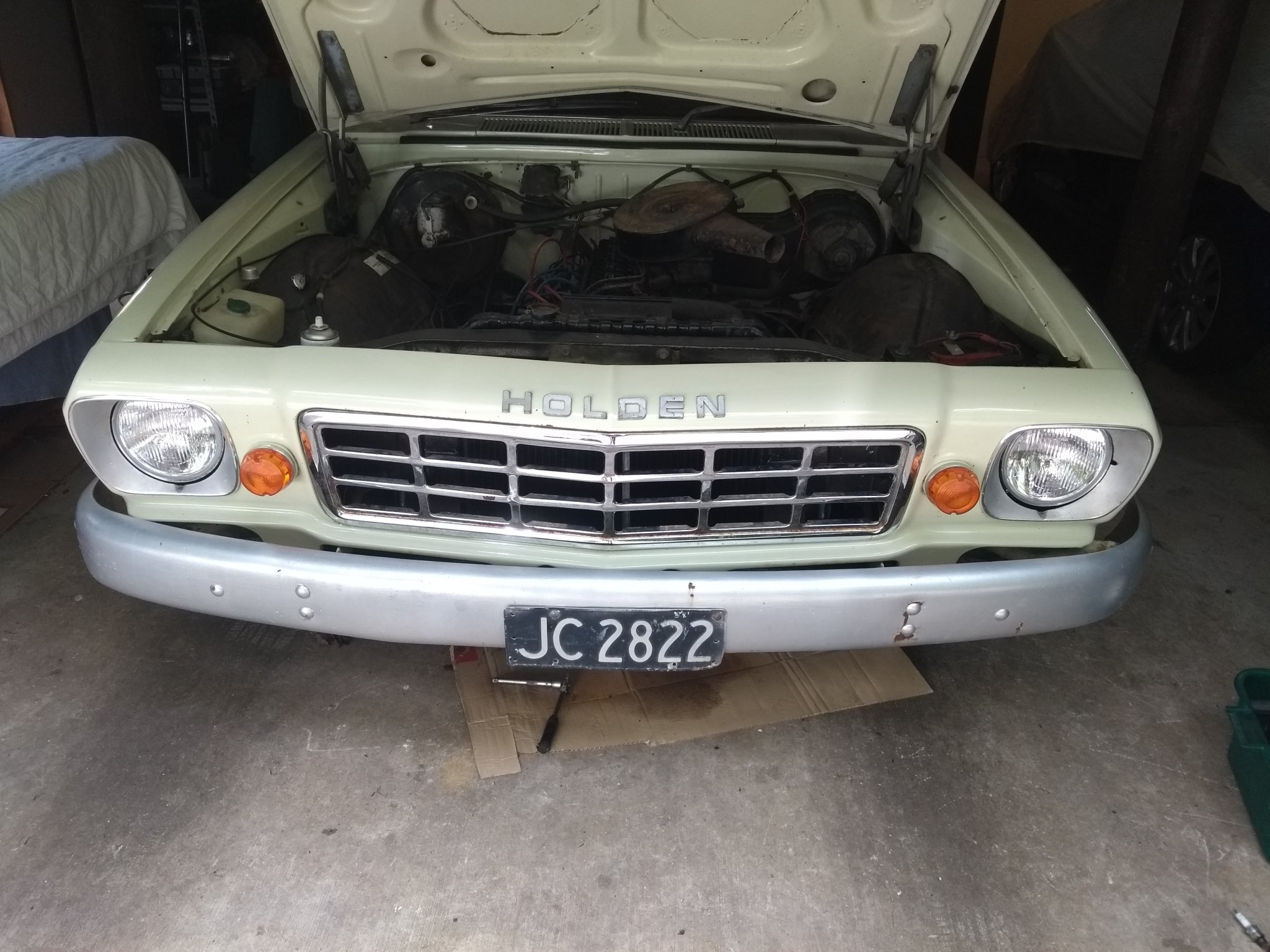

I finally put the front back on. Somehow I've lost the headlights so I grabbed some semi sealed h4 inserts. Chucked the time yesterday I'll have to align them this weekend.
