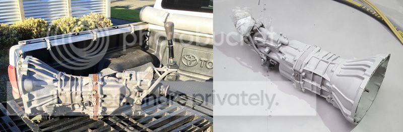

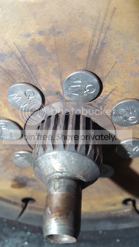

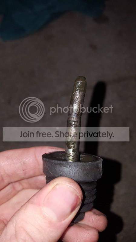

Alistair Posted July 24, 2016 Author Posted July 24, 2016 Carrying on from the above, tune was unlocked through...methods... I bought a W58 getting ready to replace the W55 and glass bead blasted it while I was at a customers servicing the room Drove it to work one day about a month ago and got nearly all the way home. Stopped on the motorway offramp and couldn't get back into gear. Managed to smash into second so drove it home like that and parked it up to get the box out. Clutch slave body and pin had seen better days Then took all the bellhousing bolts off and found no matter what levering I did I couldn't get it to pop off and it seemed to always spring back into place which indicated something was catching the pressure plate. Had Chris/EURON8 around again tonight and decided to holesaw the bellhousing to be able to undo the pressure plate bolts. Got that off and suddenly the box popped off without even levering and found the clutch plates looking like so... This disc was free but had pretty fucked splines This disc however has twisted and locked onto the input shaft. Even some hefty hammering hasn't freed it to allow the pressure plate and this disc to come off. Both clutch discs have cracks and the plates inbetween have some pretty good gouges so need discs and plates at a minimum. Hopefully the flywheel section and pressure plate are salvageable. So likely a bit more money to be spent to get it mobile again! Did buy this lush gearknob in the interim from http://www.nostalgic-grains.com/ Laser engraved Rosewood 8 Quote

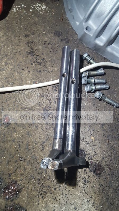

Popular Post Alistair Posted August 21, 2016 Author Popular Post Posted August 21, 2016 Lame update time... Started off with trying to put the w55 tail section onto the w58 box. That didn't work because the shifter didn't line up in the hole and the bearings were wrong (not that big a deal but the aforementioned problem was the main one). So I put the 58 tail section back onto the w58 box and thought I could put the w55 selector shaft into the w58, nope has a way fatter bottom section which grabs the forks so wouldn't fit into the 58 as you can see below: So spoke to Brendon at Convert who had only had it once before, and easiest way is to drill and tap the w58 selector lower down at the same height as the w55 (thanks to Chris/EURON8 & Strange's drillpress) then put the w55 selector bush onto the shaft and mash it all back together. So the mishmash gearbox ended up looking like this: As before, both plates of the twinplate were fucked, also had to buy a new floater plate, fingers for the pressure plate and the flywheel got a skim. Also discovered when I sent the stuff back to MRP for skim and parts that it had an 800hp spring in the pressure plate. This has been replaced with something more in my realm of power now so it shouldn't be a leg press to use the clutch now... Nearly all back together now, gearbox in, driveshaft etc etc. Changed out all the fluids again and also changed rear main, rear gearbox and diff snout seals while it was all apart. Need to fap around with the slave cylinder as it has been mounted at a strange angle both vertically and horizontally and not pushing straight on the fork. Got sidetracked today and my need to bling things took over so gave things a bit of a polish up to look fresh again Thats all for now, might get to drive it again this week! 15 Quote

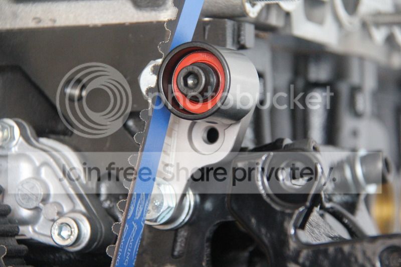

Alistair Posted December 14, 2016 Author Posted December 14, 2016 New VVT pulley did the business. Super quiet now compared to before can hear all the other rattles and squeaks I was missing haha. Also put one of these fandangled MRP Belt stabilizers on: And have ordered wideband and Link G4+ Storm to replace the haggard G3 trying to keep up with G4 software. Lol how I said I wasn't going to do much to this car when I bought it. 9 Quote
