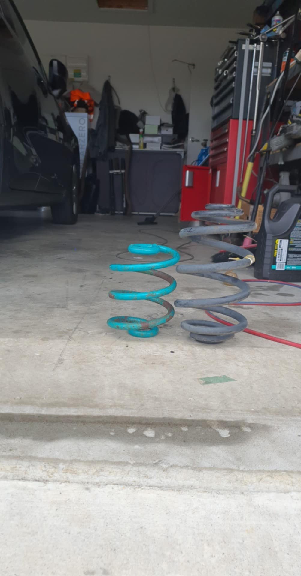

zach_munce Posted February 8 Posted February 8 Dad's got teins in the back which i think are shortend so should be fine for little bit will buy some Monroes or something when I get my car Quote

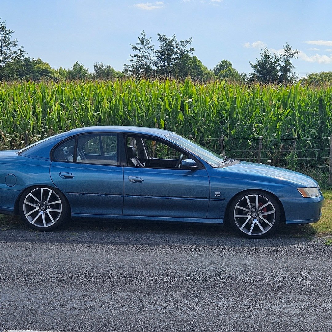

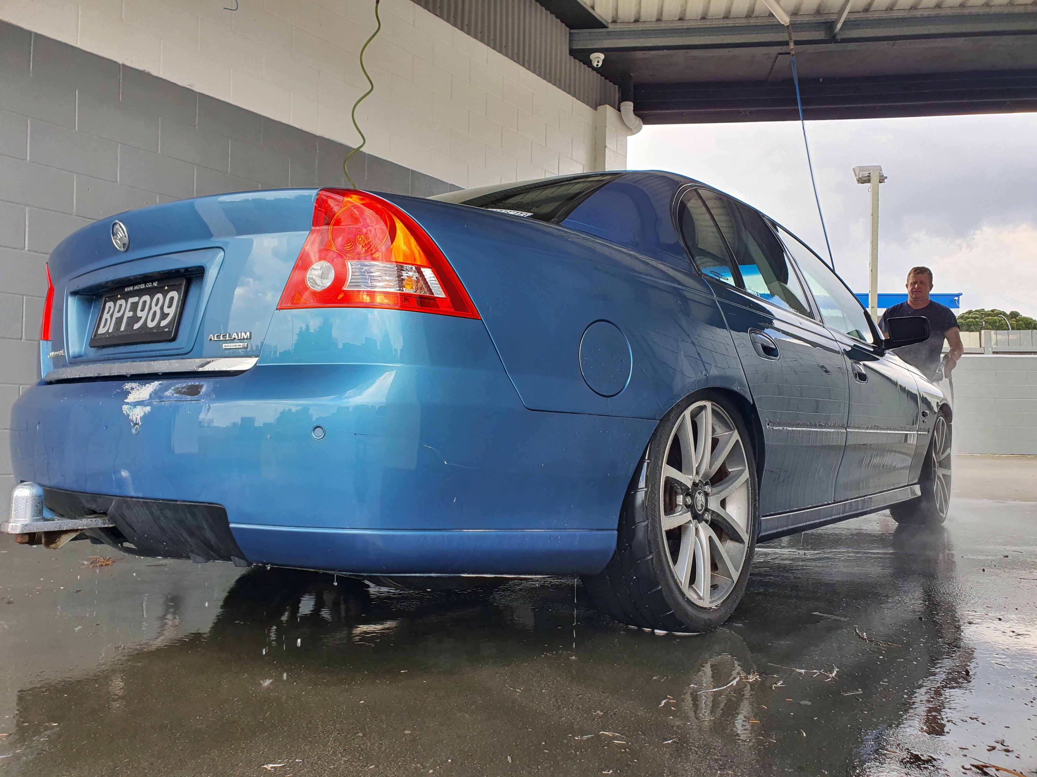

Muncie Posted February 8 Author Posted February 8 Can confirm the Teins hold the springs in fine ride is actually better than I was expecting bit of rubbing have smacked some inner guard bits back hopefully that's all it needs. Am I too old for this look?? It does make it very easy to wash at least. 3 Quote

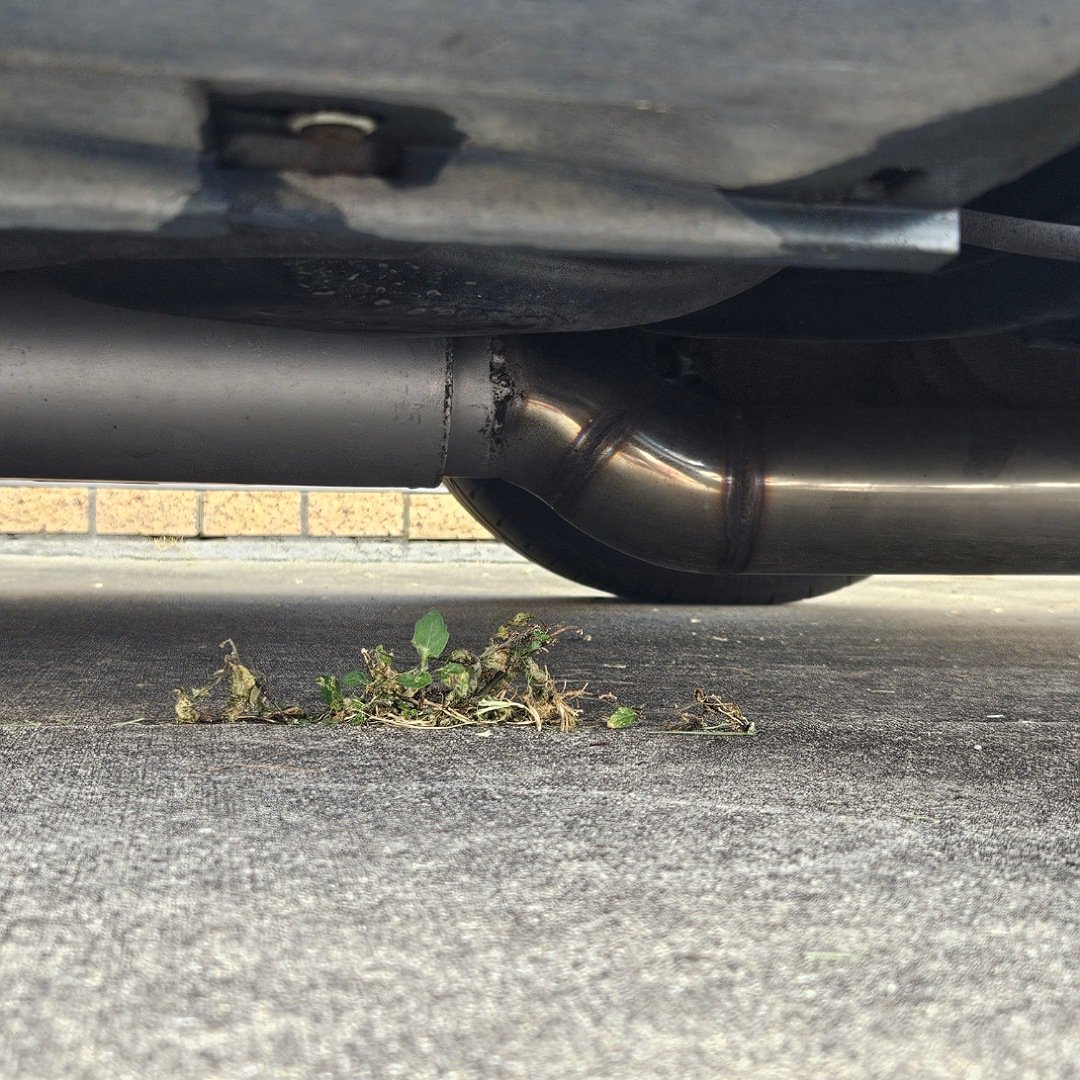

Muncie Posted February 8 Author Posted February 8 I might rethink my exhaust where it passes under diff make it oval or something ride quality is fine but I do like to tow a trailer and scare passengers not been able to do that would suck. These springs are Zachs so I might just order some the next level up. 70mm drop instead of 100mm i'd consider airbags for back only if it wasn'ta dog to cert. Last car I had this low was my Triumph brings back cool memories every time you hit bumps. 2 Quote

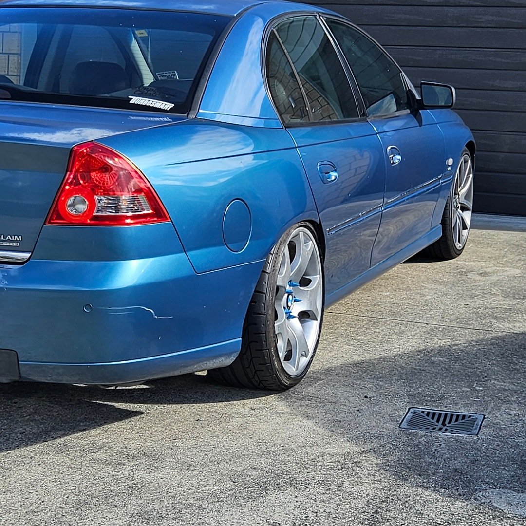

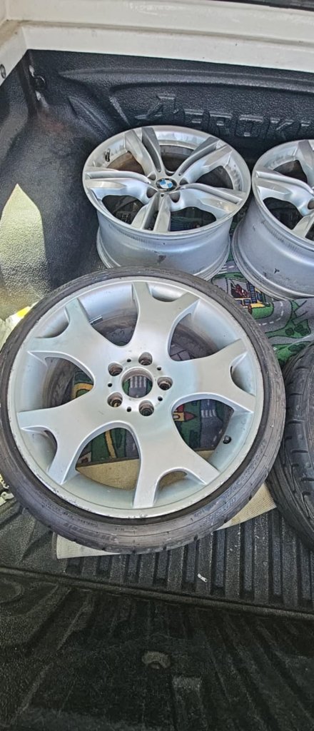

Muncie Posted February 21 Author Posted February 21 More rims still 19x10 and 19x9 but different offsets I don't love them but they will fit and get massive tread under the front and back whatever I'll probably put Simmons on at some stage anyway. It's probably going to be too low with the ultralow springs in free 20mm drop 30 profile tyres so my FE2 springs will probably have to go back in. 1 Quote

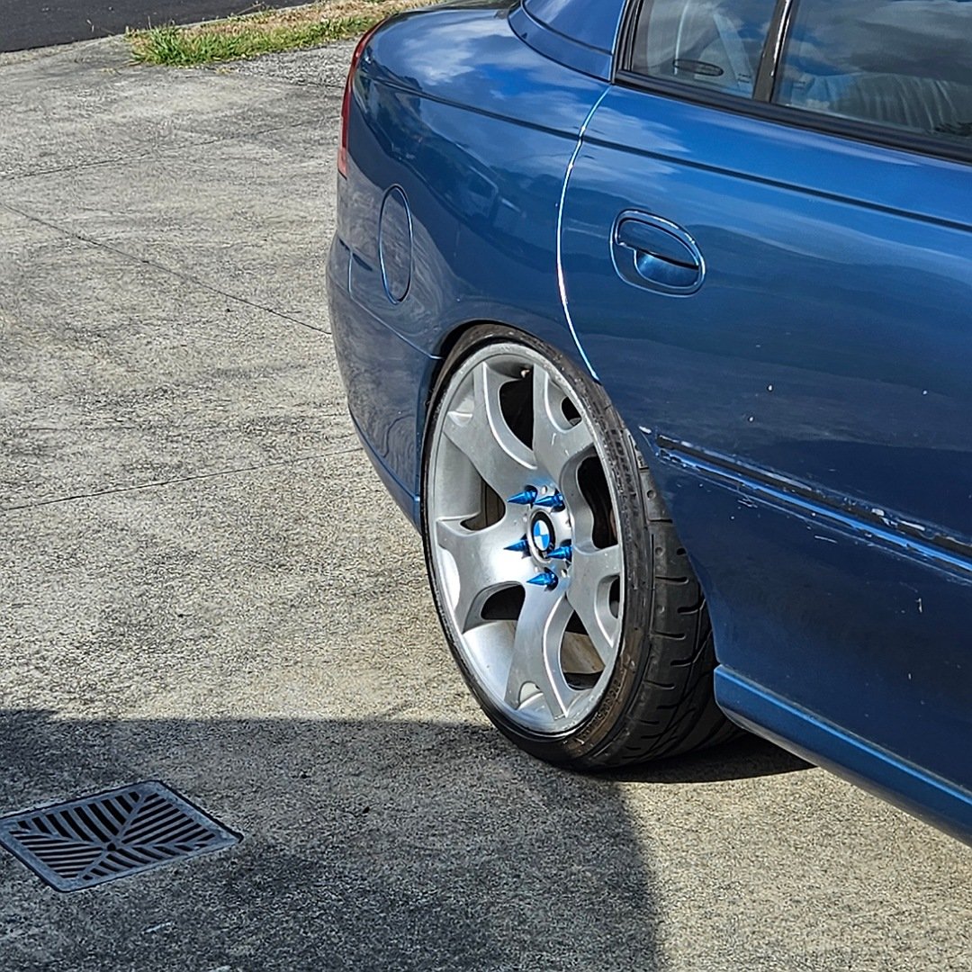

Muncie Posted February 21 Author Posted February 21 Bloody finally side quest of getting a 275 under the bum achieved! Think the fitments is on point its flush with the outer guard and inner guard potentially could go a little wider tyre with some hammer buggery but as is it moves it's just ever so slightly touching inner guard plastic this low so I'll just trim that back and tap back anything single skin metalwork to ensure I'm clear with people in back. Like these wheels way better on car. 6 Quote

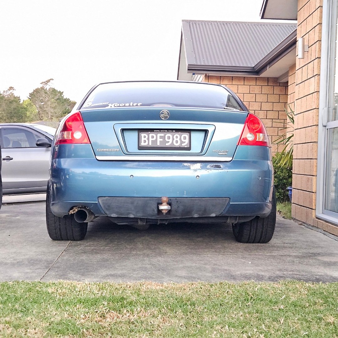

Muncie Posted February 22 Author Posted February 22 She's sitting nose up now and exhaust is about 25mm from ground so other springs are going back in for now, and a little minorly invasive surgery with a block of wood a hammer and the guard roller is going to happen so everything fits nicely has lots of travel and doesn't rub. This will do for a bit while I start working through Cert stuff I have a uncut bumper support which I'll mount a cut down intercooler off as this one is huge and inlet air temps only ever rise in nose to tail traffic so can lose some core without hurting things too much. 3 Quote

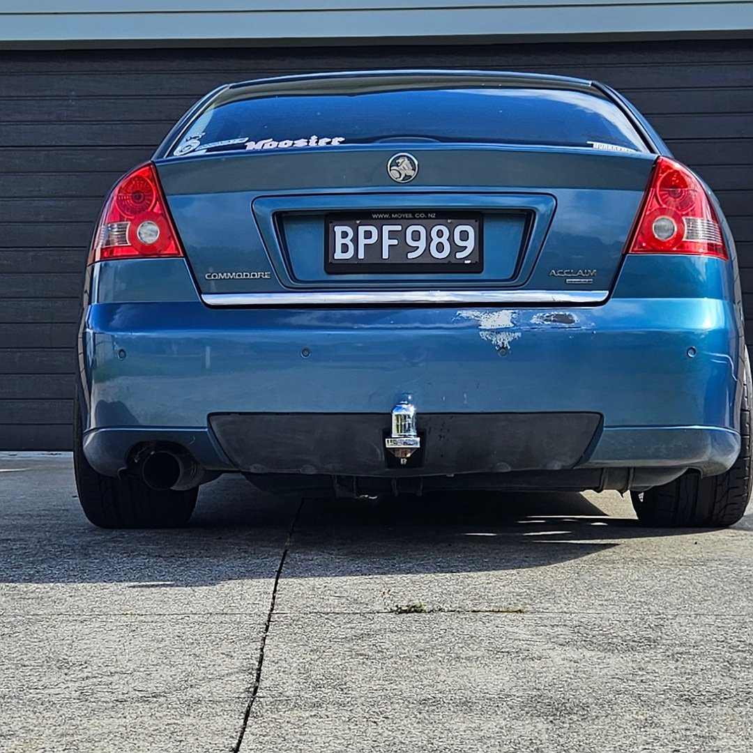

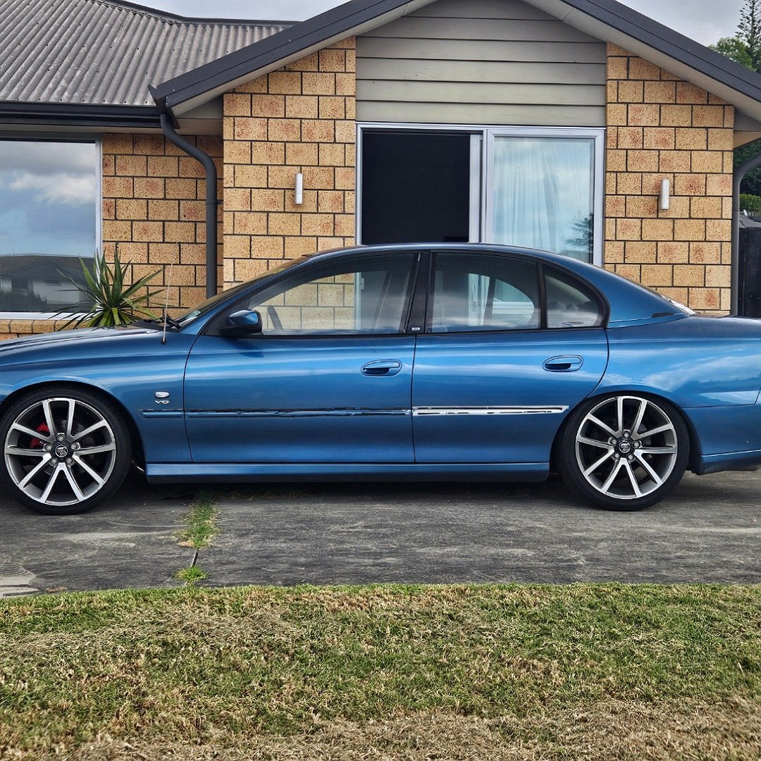

Muncie Posted February 23 Author Posted February 23 FE2 springs back in inner wheel arch plastics trimmed back and some rubber mallet bashing everything fits its bees dick clearances on inside but not touching. No mexipoke and looks meaty from back the look I was going for and doesn't get all wild when you punch it. Slightly smaller rolling diameter tyres so I've picked up a slight ratio change which could get me into the 13's if I run it down strip again. 7 Quote
