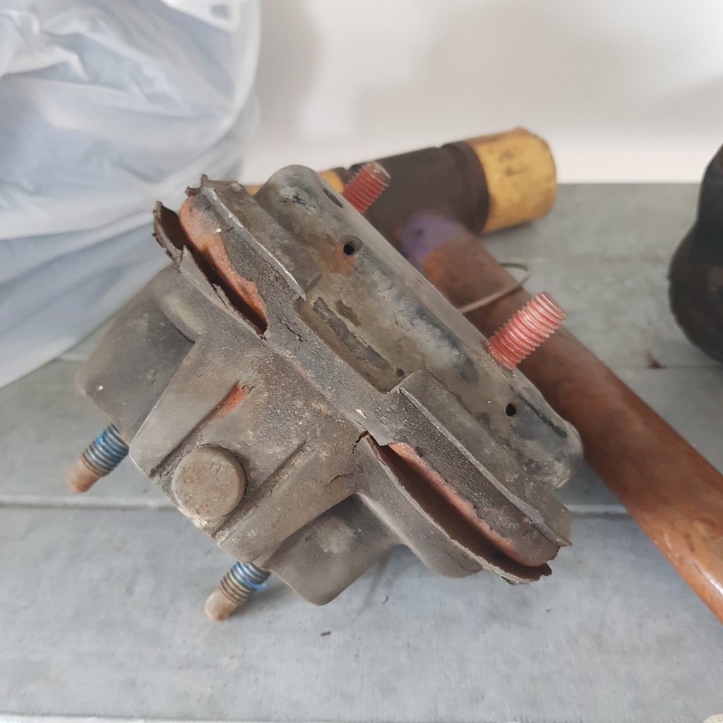

Muncie Posted February 23, 2019 Author Report Share Posted February 23, 2019 Removed 2 rooted engine mounts got new ones from Mace Engineering for 90 ozzy dollars and achieved a Wof today. Boom! Legal for under a grand. Engines sweet had a weepy corroded thermostat housing which leaked into the valley of engine and blocked thermostat All sorted for nothing, it was able to drain itself without leaving a puddle though hence old owner didnt notice it till it got hot I'd guess. 3 Quote Link to comment Share on other sites More sharing options...

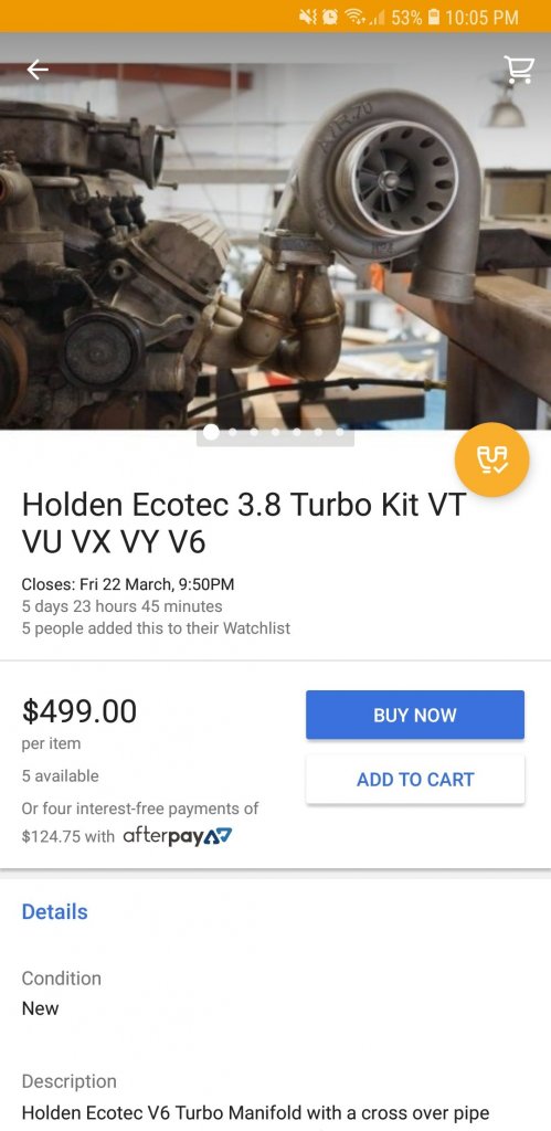

Popular Post cletus Posted March 15, 2019 Popular Post Report Share Posted March 15, 2019 9 2 4 Quote Link to comment Share on other sites More sharing options...
Muncie Posted March 16, 2019 Author Report Share Posted March 16, 2019 FFS i actually have money in bank and a car to sell...... someone talk me out of buying this. 1 Quote Link to comment Share on other sites More sharing options...
tortron Posted March 17, 2019 Report Share Posted March 17, 2019 i saw those too probably should buy it Quote Link to comment Share on other sites More sharing options...

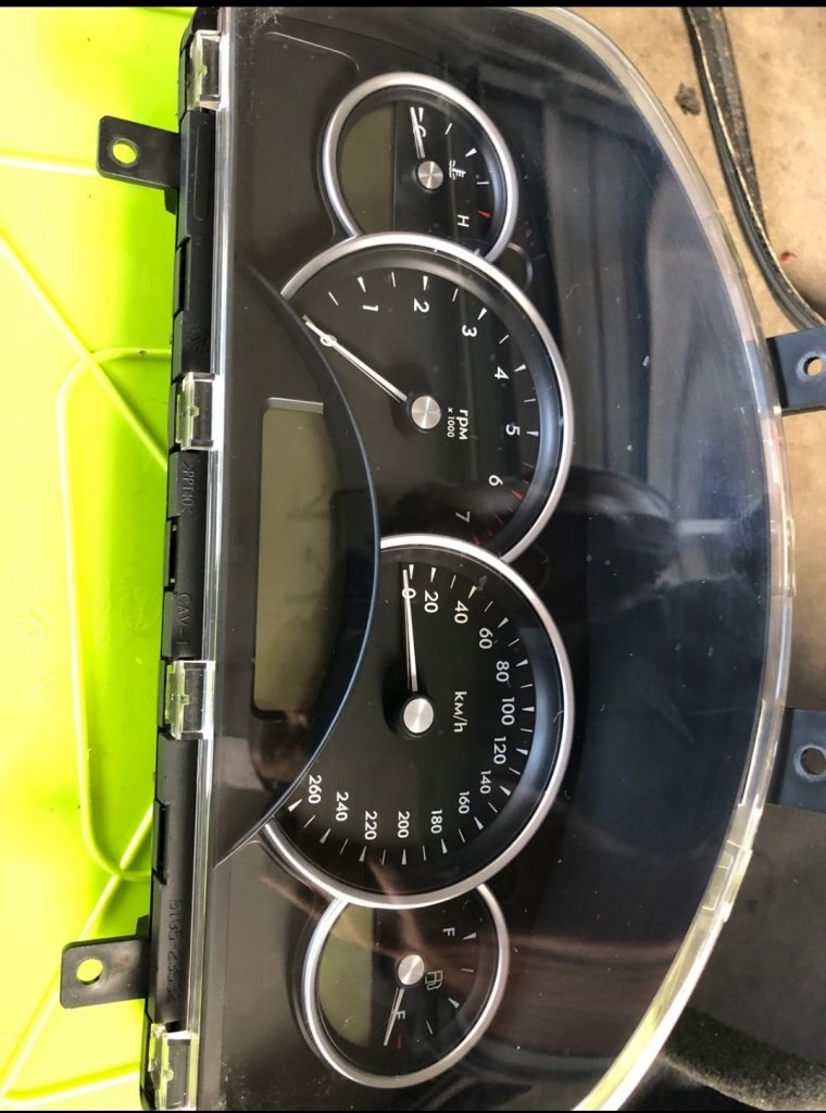

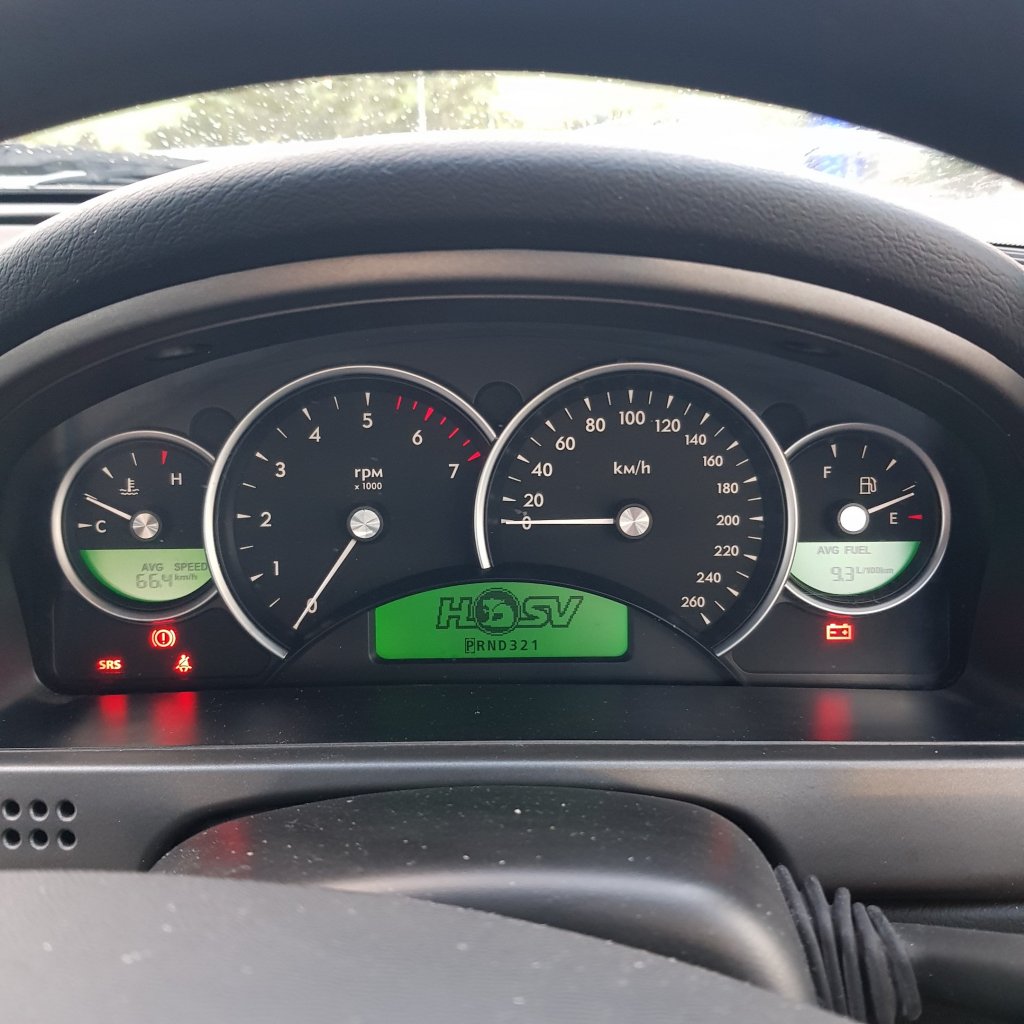

Muncie Posted September 25, 2019 Author Report Share Posted September 25, 2019 Since this has been fitted with VE wheels the speedo has been out by miles..... like 14ks out at 100 ive come close to getting a ticket so decided to sort it. The dash has always flickered and rattled so i decided to do a level 1 to level 3 dash upgrade and buying a license to reflash the body modules. This was fun as you can add the Hsv startup GIF and a cystom off message currently the "Blue whale" after the nickname it got from getting airborne chasing my work colleague in his sports car thing. Apparently Breaching is what my car does over undulations. So now i can plug in just like my VW and change shit in the BCM and ECU 2 Quote Link to comment Share on other sites More sharing options...

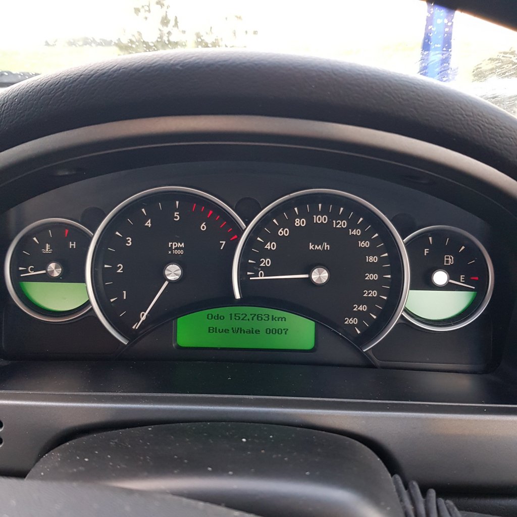

Muncie Posted September 26, 2019 Author Report Share Posted September 26, 2019 Looks cool all the info it spits out across 3 screens is handy as well. 5 1 1 Quote Link to comment Share on other sites More sharing options...
