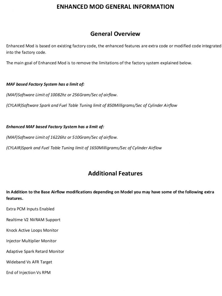

Muncie Posted August 1, 2021 Author Posted August 1, 2021 @vk327 Hey mate have a squizz at this currently running this modified code in my spare ecu runs better than stock, i have a few tunes to kick things off with hence im willing to give the flash ecu a go. If it doesn't work.... well i might have a wiring loom job for you or will go manual and chuck a decent aftermarket ecu in it. Quote

vk327 Posted August 1, 2021 Posted August 1, 2021 havnt played too far with the v6 ecus myself but that looks like it should give you enough headroom on the maf table, could possibly use the AC pressure sensor input as a way to input a wideband 0-5v and be able to log it if you can define your own parameters and calc like im able to with HP tuners for LS Quote

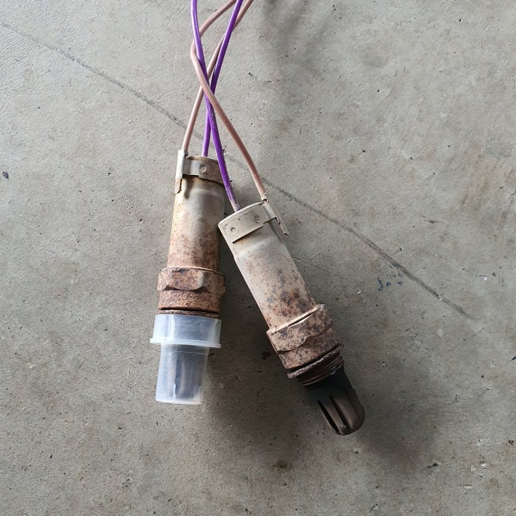

Muncie Posted August 21, 2021 Author Posted August 21, 2021 Threw new O2 sensors in today runs nice and idles better took all of 10 minutes to do both fuck it was easy! Why ive not done them before now escapes me thought it'd be a bitch of a job. Also threw in another cam sync sensor cos the one on my new engine was visibly newer for good measure. Think ive got a theory on the crank sensor fault, may not actually be the sensor ive got 2-3 mm of float on the crank when you go to start it the starter pushes crank forward. And at low revs just the tips of the reluctor ring pass through the sensor giving a shit signal. Give the crank a nudge back and the idle improves if its pushed forward so it might just be that. 1 1 Quote

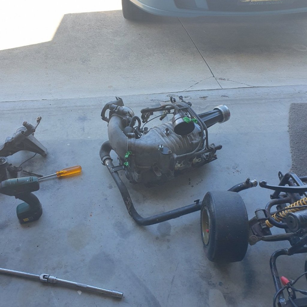

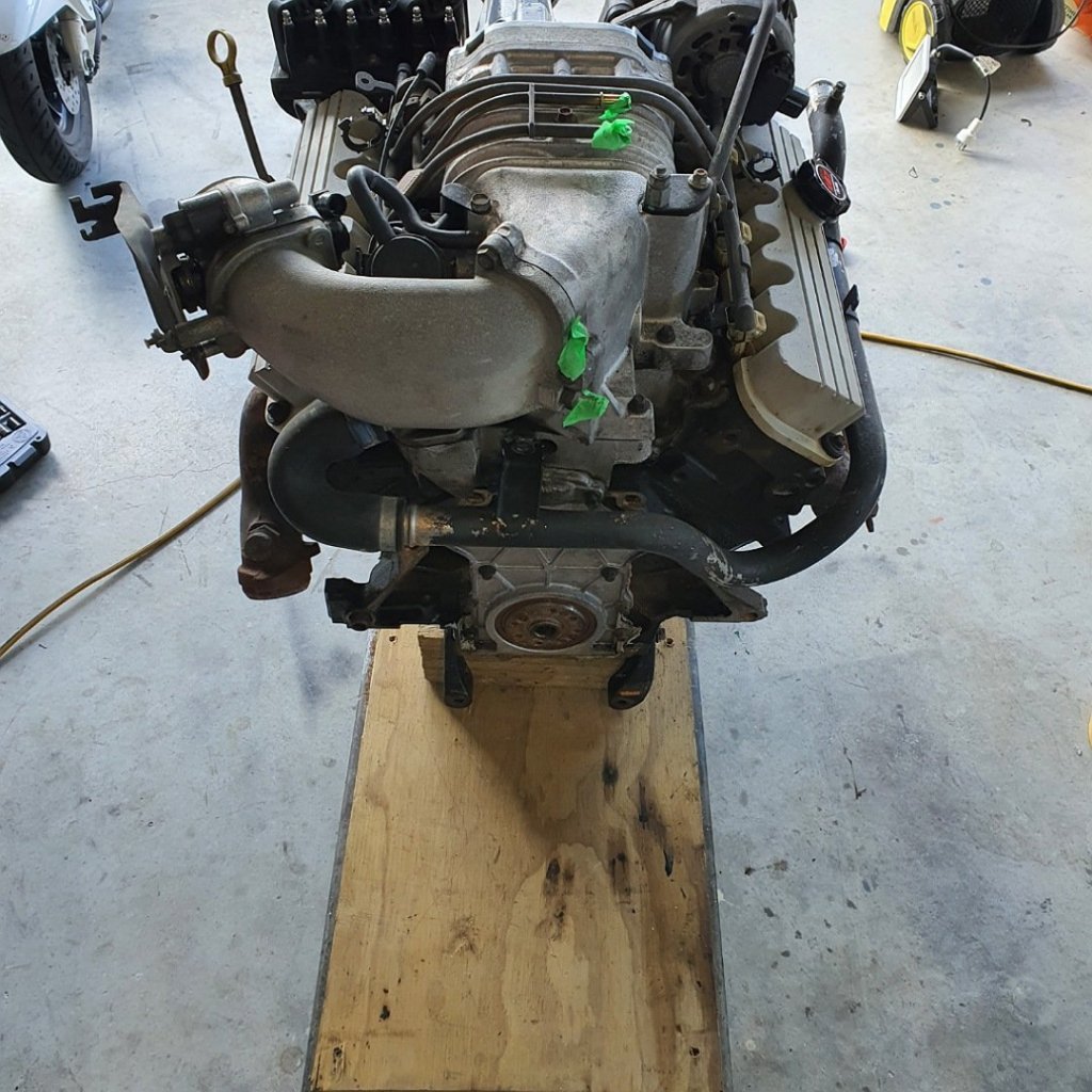

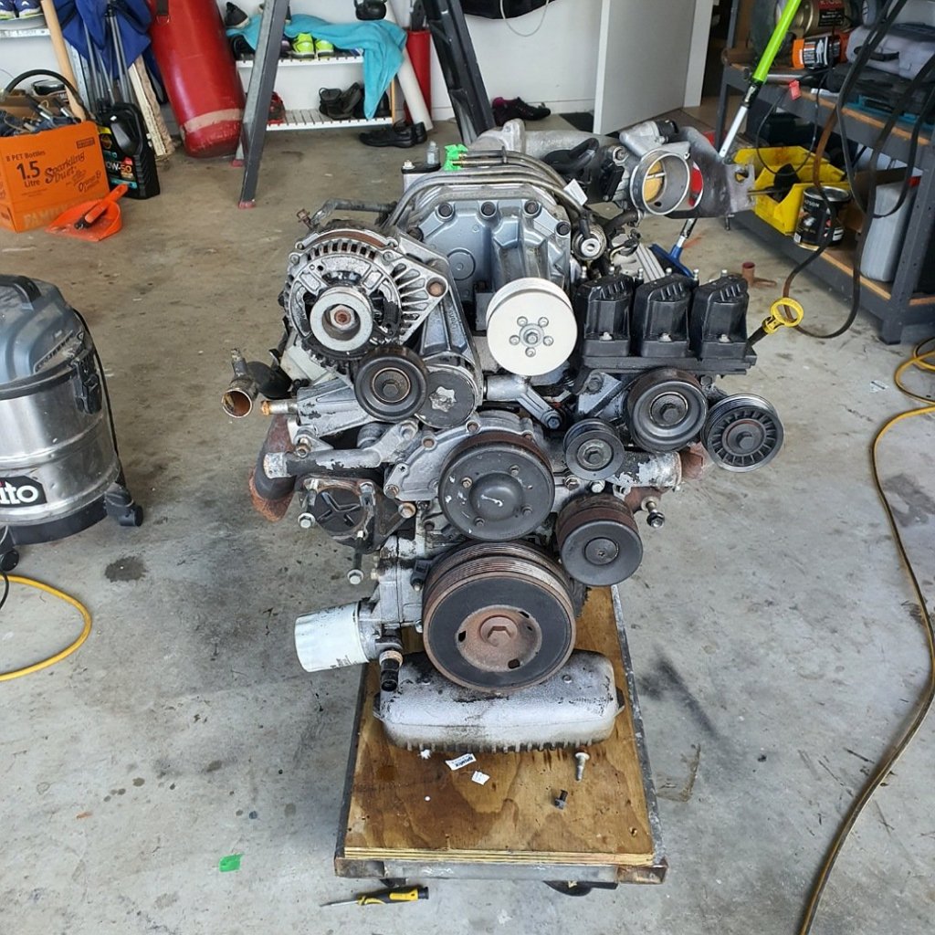

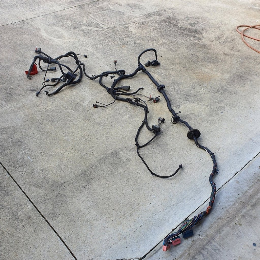

Muncie Posted August 22, 2021 Author Posted August 22, 2021 So with the ecotecs health now down graded to running but may become terminal soon, I started on stripping everything that wont be going in with the engine swap off the L67. Including one rather haggard in places engine loom. Just exhaust manifolds to go and thats as far as it'll need to go. Quote

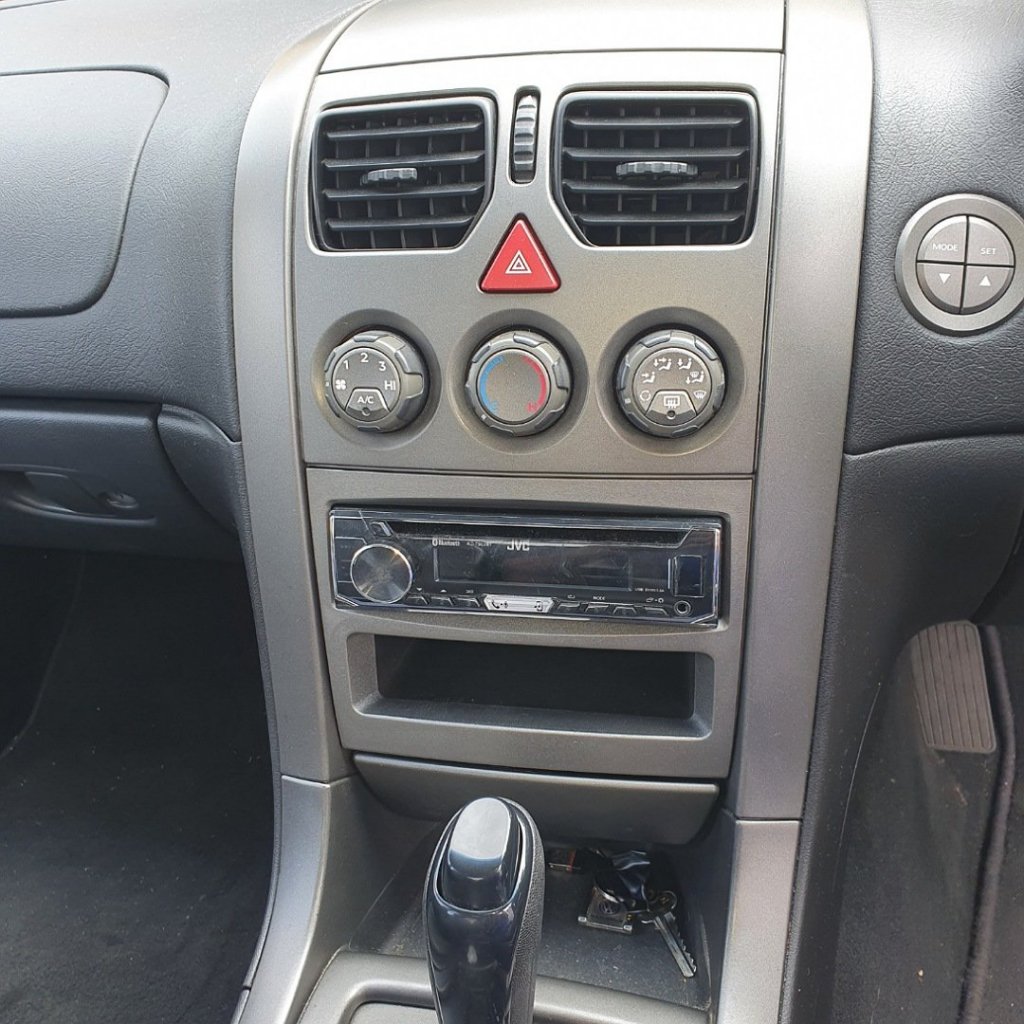

Muncie Posted November 29, 2021 Author Posted November 29, 2021 Oh I also dropped $500 on stereo gear to get my stash of stuff installed, walked into cash converters on weekend and scored the triple pre-out head unit I needed for fuck all the fitting kit and fascia cost more than the stereo. 1 1 Quote

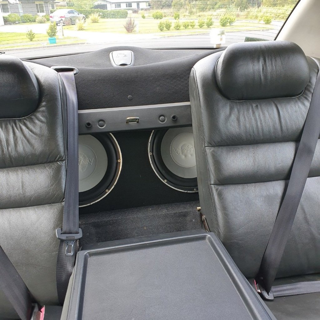

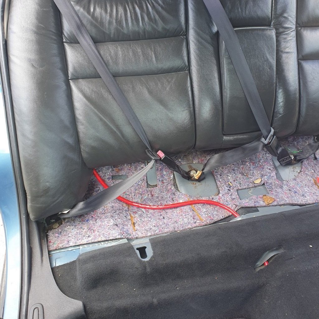

Muncie Posted December 20, 2021 Author Posted December 20, 2021 Seeing as I can't obtain engine parts why not fit an obnoxiously big stereo and leather upholstery... it's not easy hiding 2 gauge cabling but it's done aided by pulling the interior to 100's of pieces even managed to snake through the chassis under seat so no lumps showing 4 Quote
Muncie Posted December 21, 2021 Author Posted December 21, 2021 Added 2 sets of alpine components these have a nice tweeter to point at your face (even in the back) everything in stock speaker pods so nice and crisp no rattles. Taken better part of 2 days to swap all the upholstery over as my body loom had no power for passenger seat and needed some fettling in diagnostic console on laptop to make airbags talk to the controller, all works mint now. Spent the cash on a install kit for head unit which looks sweet. This is the weapon of choice for road trips as it's a big armchair. 2 Quote

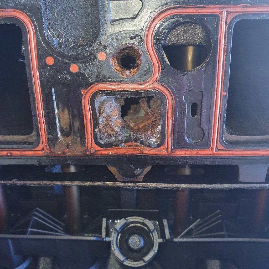

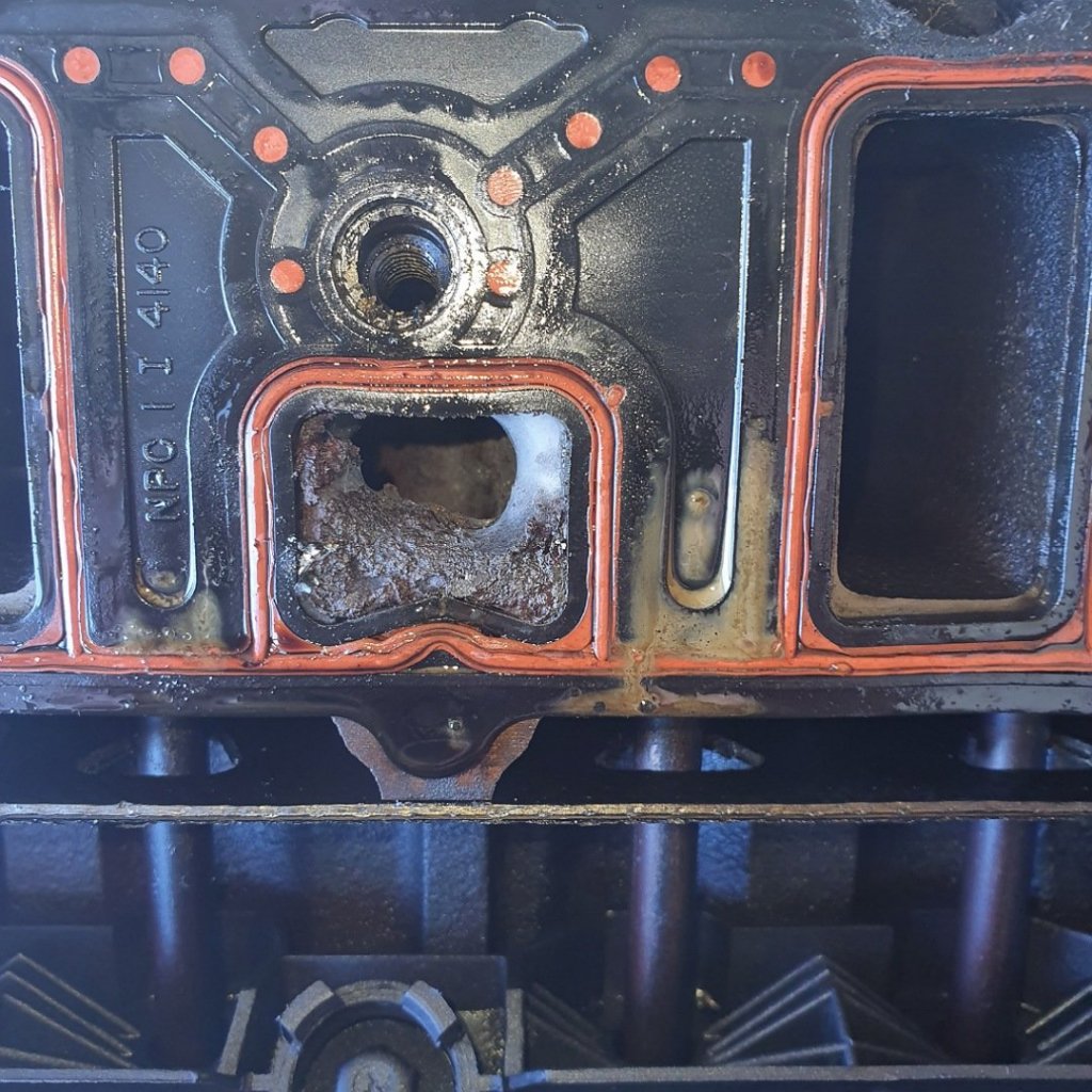

Muncie Posted January 8, 2022 Author Posted January 8, 2022 The fuck is this!? Antifreeze motherfucker have you heard of it? 1 2 Quote
Raizer Posted January 8, 2022 Posted January 8, 2022 6 hours ago, Muncie said: The fuck is this!? Antifreeze motherfucker have you heard of it? First time working on a car "maintained" in NZ?? 3 3 Quote
johnnyfive Posted January 8, 2022 Posted January 8, 2022 Might be some of the factory issued cooling system mud? https://www.ebay.com.au/itm/263772990975 2 Quote
Muncie Posted January 8, 2022 Author Posted January 8, 2022 9 hours ago, Raizer said: First time working on a car "maintained" in NZ?? Must of got his hands on some Triumph 2500 Lucas radiator grot, ive had worse just wast expecting it this far into the 2020's. 1 Quote
