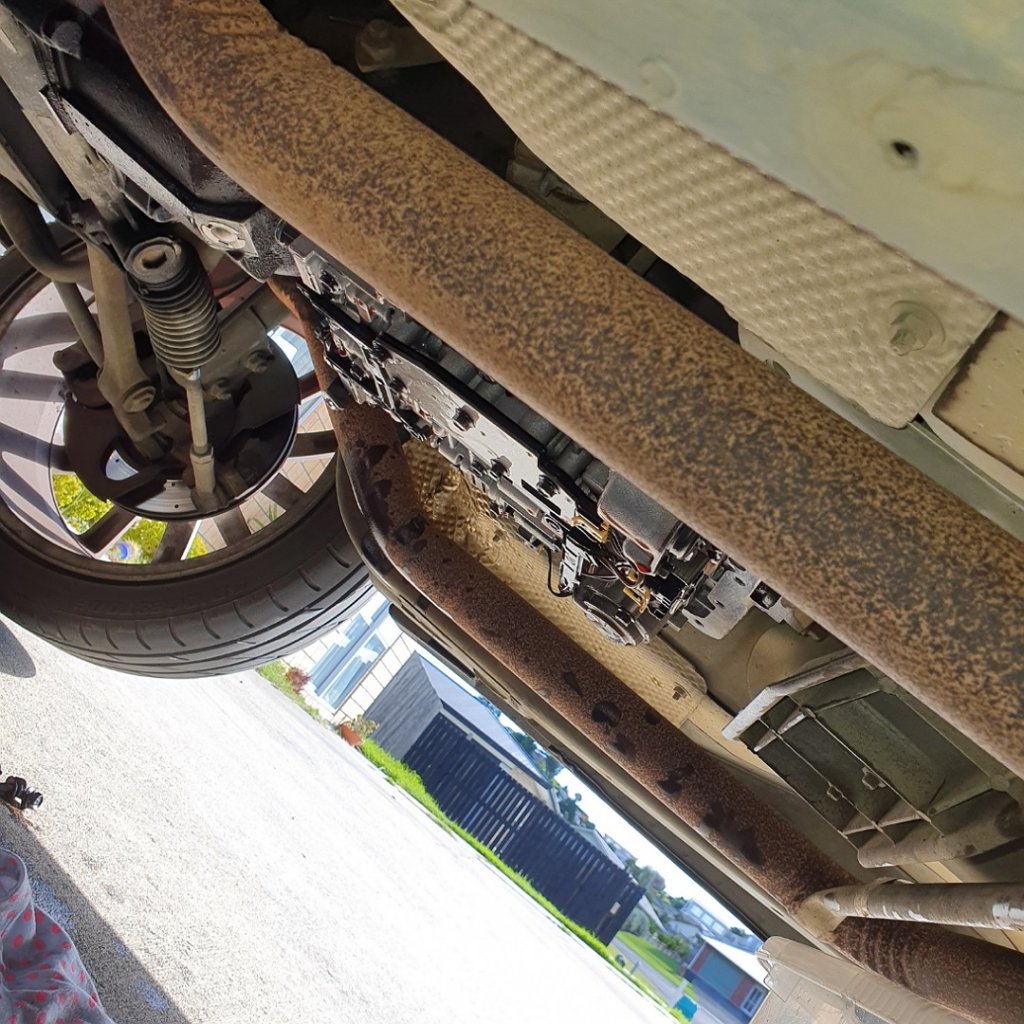

Anyway i got stuck into a transmission fluid change as it has been in there ages and smelled slightly funky.
  • Replies 897
Whoever decided to not put a drain bung in the pan of this needs a dick punch huge mess, but overall easy job good to check it out no real sludge or anything in there.
Will dump again when i do shift kit which will ensure all the old fluid is flushed out of system

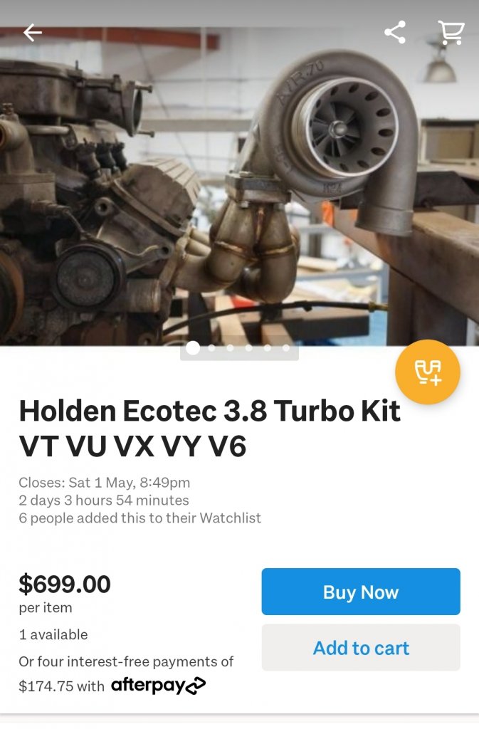

Currently trying to decide if going turbo would be worth doing in scheme of things i could have a manifold and turbo on for $1200 bucks. Would simplify the exhaust for me....
I would really struggle to talk myself out of taking the blower off though. Why not both? Thats what i keep telling myself.
Then i remember my Transmission has been labeled the box of neutrals by the internet which brings me back to reality.

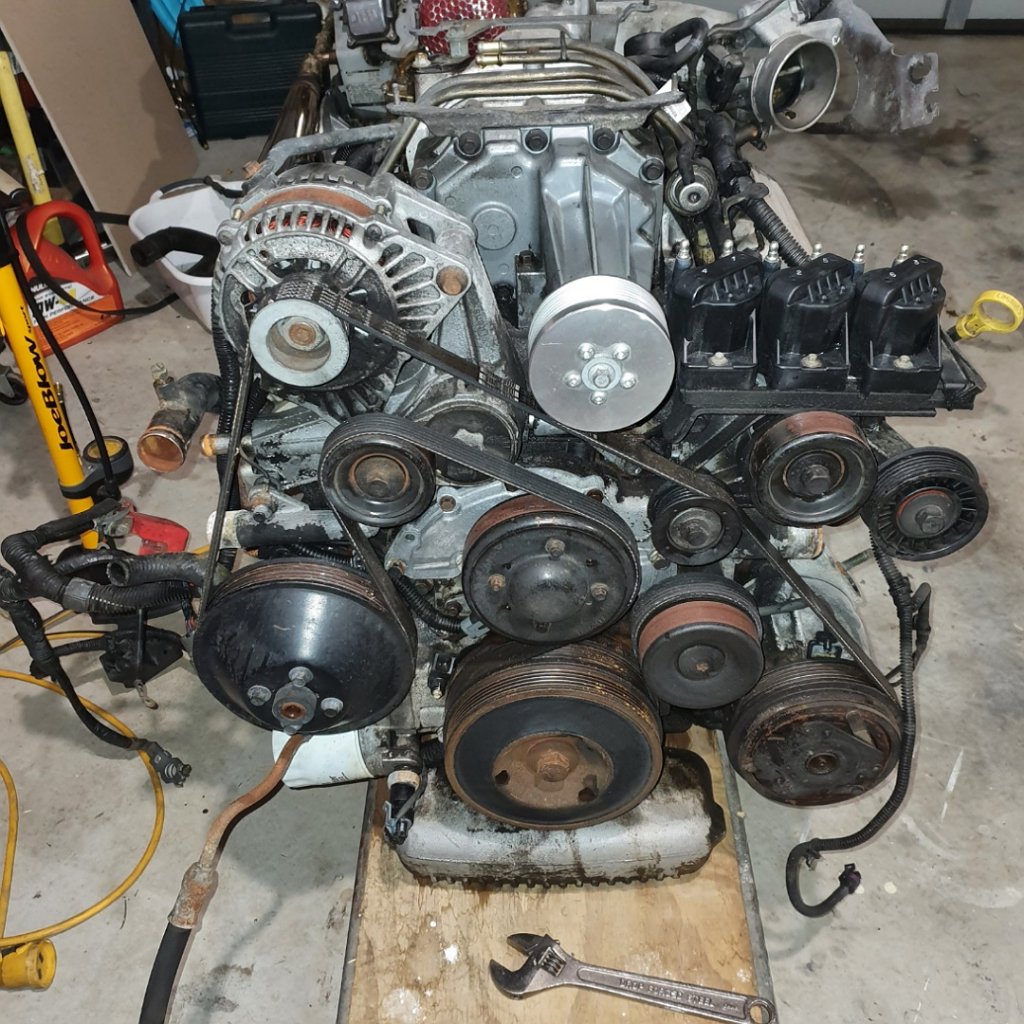

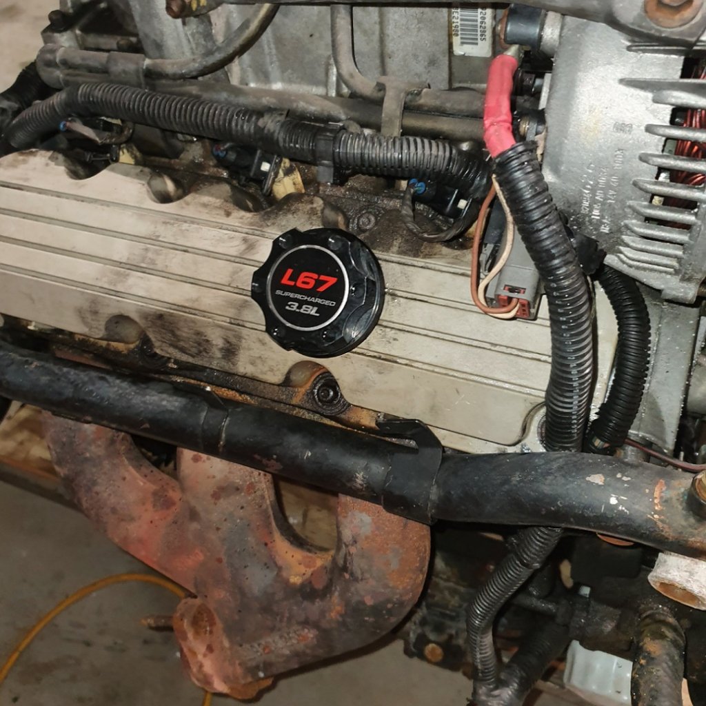

New engine is home so finally got a chance to look it over...... its fucking filthy! Power steering hoses must of leaked forever and they just topped it up.
Cool stuff though after a casual poke around.
Billet mace engineering oil cap cheesy but cool, A mace modular blower pulley setup has been fitted so its a piece of cake to change sizes/boost
Egr delete has been done on head fully gone!
New looking water pump, belts and rear main seal have been done recently.
It came with the pcm bcm and ignition key so i could potentially just slam it in if its compatible with my cars body loom.
The Meh stuff.
Doesn't have the flexplate as it was a manual. theyre balanced different to the ecotec I'll ask around i may be able to get my ecotec one balanced to suit i will be using an ecotec transmission anyway. Not end of world.
Loom has some twist and tape joins on the trans section of loom easily reversed but the pcm will have to have had some reflash to allow the manual to work.
The exhaust manifolds have lots of snapped bolts..... it obviously had headers which they kept.
I didn't even get it in garage before waterblasting the shit out of it! Less greasy its obviously had some love in past as it looks ok.
Now to plan, do i pull the heads and clean the ports up fit studs and new head gaskets........ or just get it in hmmm.

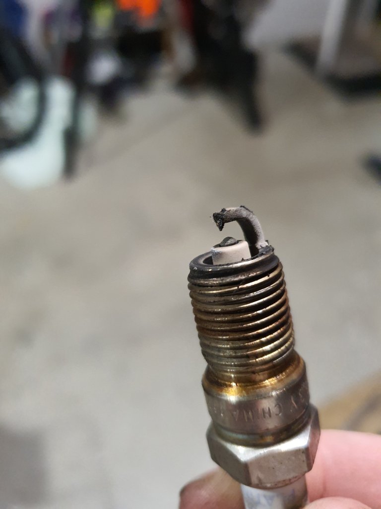

Randomly shit a coil pack on the ecotec last week limped home running on 4 fitted a spare complete ignition module from my hoard back in action and only hour late to work.
Something must of caused it though so rockauto'd some new plugs what do ya know 2 melted electrodes so probably 2mm spark plug gap that'll do it.
Been running stock ECU so shouldn't be the tune..... will get some new oxy sensors as they're old as fuck and a new fuel filter just in case my my fuel pressure is a bit sad. Looks very lean.
I think the lean is your key to that electrode melting, shit got far too choochie.
Was expecting this to die 18 months ago thrashed snot out of it ran it on kerosene while i got it for free. Played with tuning etc its been through a lot and just keeps running doesn't burn oil or use water....... now ive said this it'll probably blow a head gasket on way to work tomorrow.

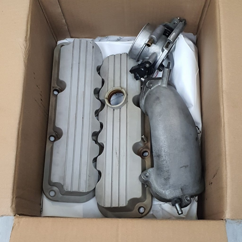

Stripped off the rocker covers, throttle body and manifold from throttle to supercharger for a trip to the parts cleaner at work, bit greasy externally but internally everything's tidy especially the rocker covers.
Pretty sure this engine has had a leaking power steering pump or hose failure which has showered the engine in oil attracted dust and not been cleaned up.
No warning bells so far everything looks good.
Going to port the throttle body and inlet manifold to the supercharger as there's meat to spare for sure.... maybe a v8 throttle body if i can find one with a cable.
Came up a treat! No before photos cause who needs to see gross v6 stuff.
Will paint the rocker covers got plenty of colours at moment will need to decide. They'll go back on for now to make engine watertight so i can go to town with the degreaser again to get the rest of the gunk and paint the block.

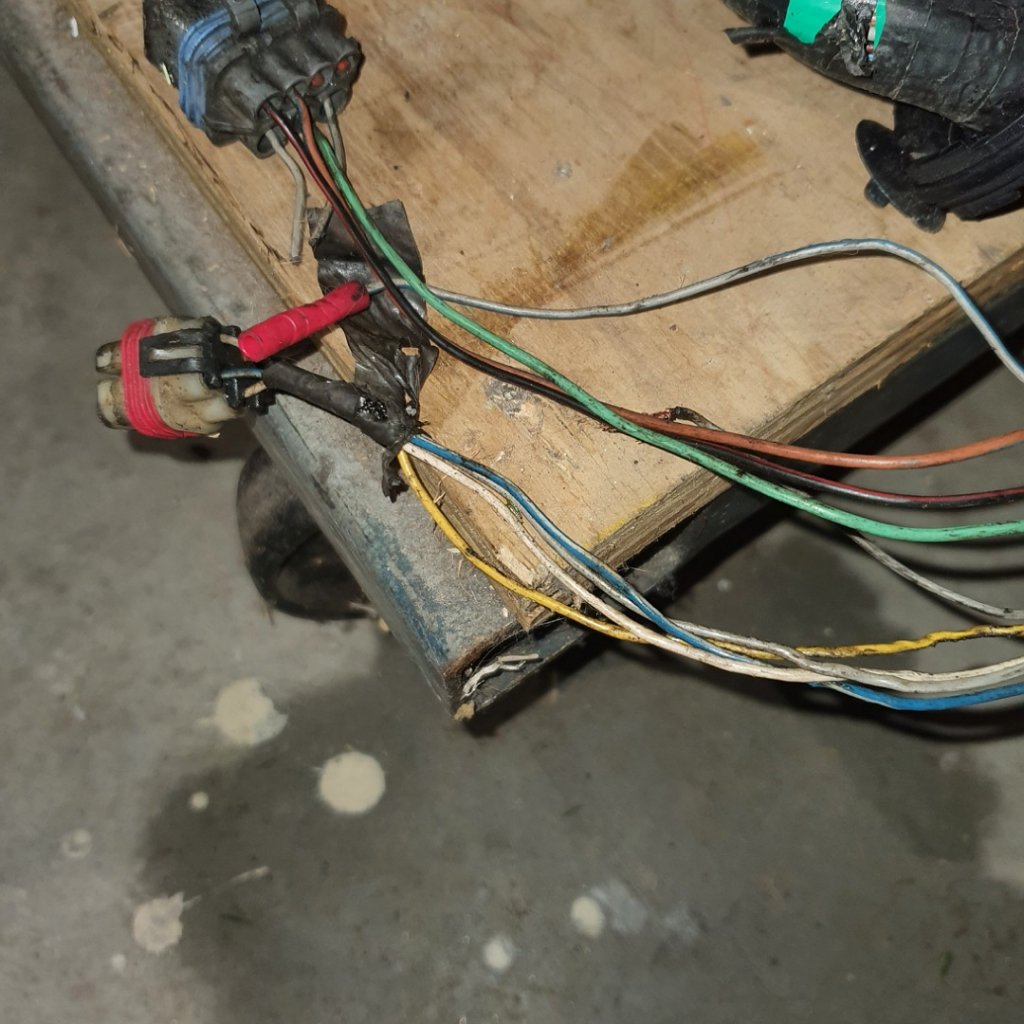

First day at new job she started randomly dying full engine shut down no sputtering rev counter straight to  zero fortunately i was only going to pick up my work ute.
Suspect ive killed another crank angle sensor (number 3 its deaded) though could be an ignition module i have new one so will try that first.
Im going to have think about improving this with new engine getting to be pain in ass.
