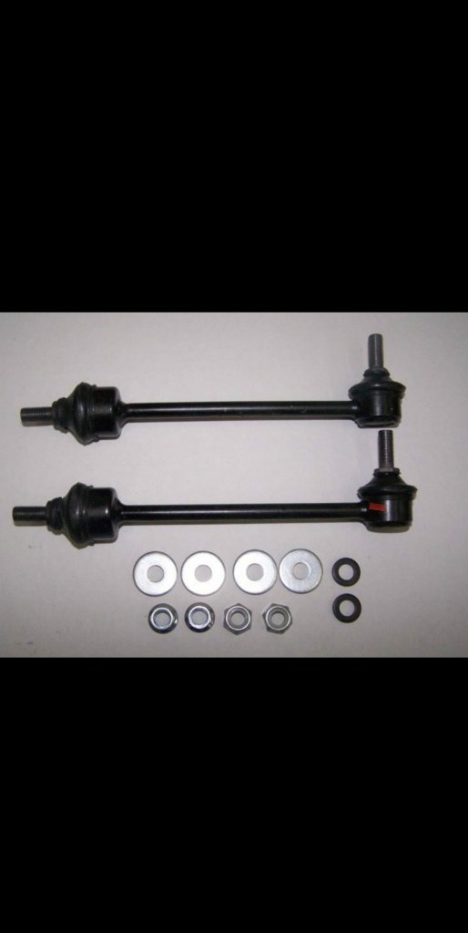

Muncie Posted January 1, 2021 Author Posted January 1, 2021 Shit I'd forgotten about but rate are fitting extra heavy duty sway bar links (HSV) they aren't expensive but really crisp up stock suspension if you enjoy carving up corners a bit. No rubber just big nuggety ball joints. Will think about some new bushes this year if the warrant man says any are buggered. Quote
Muncie Posted January 1, 2021 Author Posted January 1, 2021 10 minutes ago, Cobranz said: Link to those sway bar links? https://www.trademe.co.nz/2922836868 1 Quote
