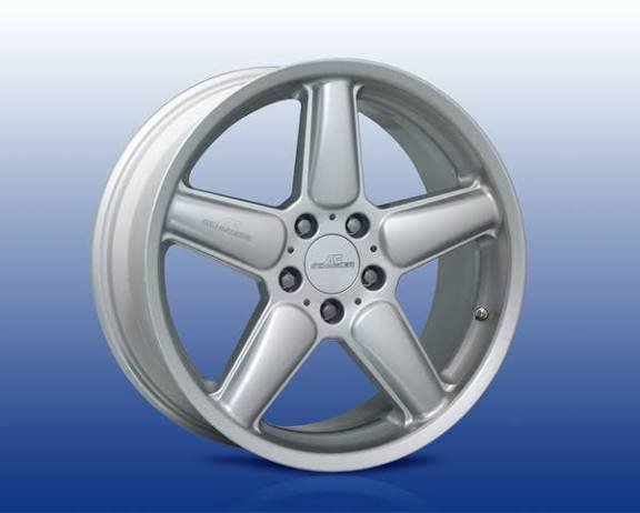

Muncie Posted October 5 Author Posted October 5 Was hoping to have a really clean tidy engine bay...... yeah think im past that for moment i just want it running again. Zach pointed out that ive blown the sleeper aesthetic with the BMW wheels I might see if I can find something that'll fit the hsv brakes inside without giving the game away, the ridiculously loud turbo spool can do that for me instead. Countdown to drag day 3 Quote
zach_munce Posted October 5 Posted October 5 I think ac schnitzers probably reps would be good 17 or 18 inch and still very wide and 18s are easier to find good cheap tyres for Quote
zach_munce Posted October 5 Posted October 5 Good looking wheels but definitely not as suspect as the tiger claws Quote
zach_munce Posted October 5 Posted October 5 or just get vy ss remakes (20s) just quite spendy tho 1 Quote

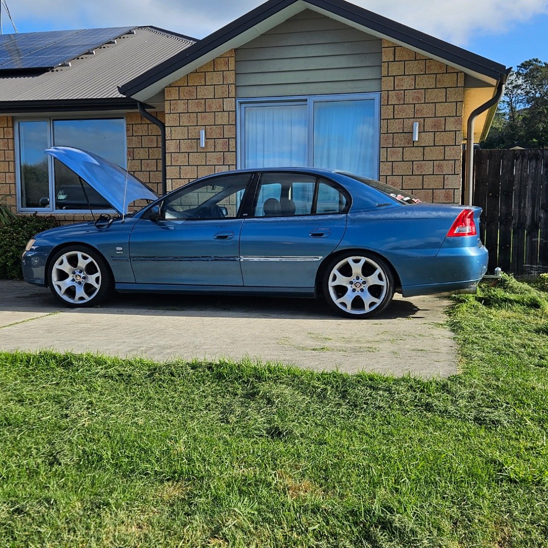

Muncie Posted October 7 Author Posted October 7 New springs arrived today as like 1900's me last year i cut my front springs to look cool and spent the year worrying about it catching the bumper on everything.... no mucking around full set 50mm drop Jamex springs seemed like bloody good value (spare me your horror stories if they are shit) and arrived in less then 24 hours thumbs up for service. The rears are bloody tiny but chunky i won't be wrestling to get these in! Oil, coolant miscellaneous sundry item are all here some other items are on way. Heat management is a priority this time so new turbo and wastegate blankets have been procured waiting to be stuck on. Bends to sort the routing of crossover pipe are here as that only cleared cross member under heavy acceleration and wrap to cover it all up. Basically heaps of small jobs left i think once on ground ill need to rework rear of exhaust as I'll now be identifying as lowered and will smash It repeatedly if I dont. 6 Quote
Muncie Posted October 8 Author Posted October 8 And rear springs are in still got 100mm of clearance under exhaust so will be where it stays im done changing bloody springs! 1 Quote
Muncie Posted October 8 Author Posted October 8 Engine bay is slowly going back together so much wiring to try untangle and make tidier its getting there. Will aim to start up on weekend. Manifold got a couple of cold looking mig welds reflowed with tig. 6 Quote
Muncie Posted October 10 Author Posted October 10 Wiring is done except for plugging 3 connectors in to transmission meh I'll do that when I do driveshaft. Only crossover pipe to be rejigged i put up with the rattle for ages because it worked but was hard on v bands so I'll tuck it up a bit higher then turbo can go on. I could put a battery in and check for oil pressure..... I've got the weekend to get everything done i am expecting some water leaks so have forgone anti freeze till I know its not going to need revisiting. All in all maybe 4-5 hours till i drive again. Nice! 6 1 Quote

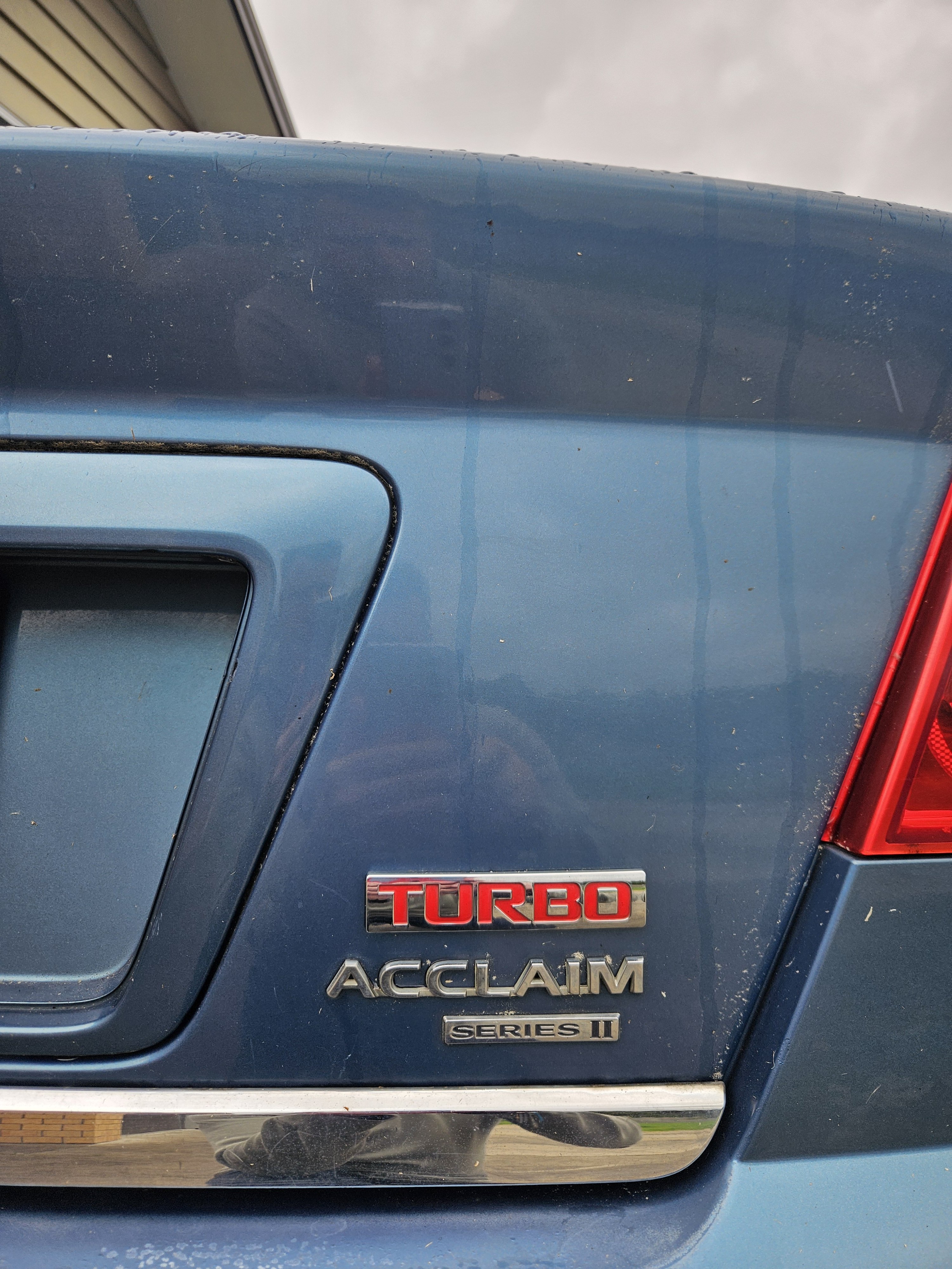

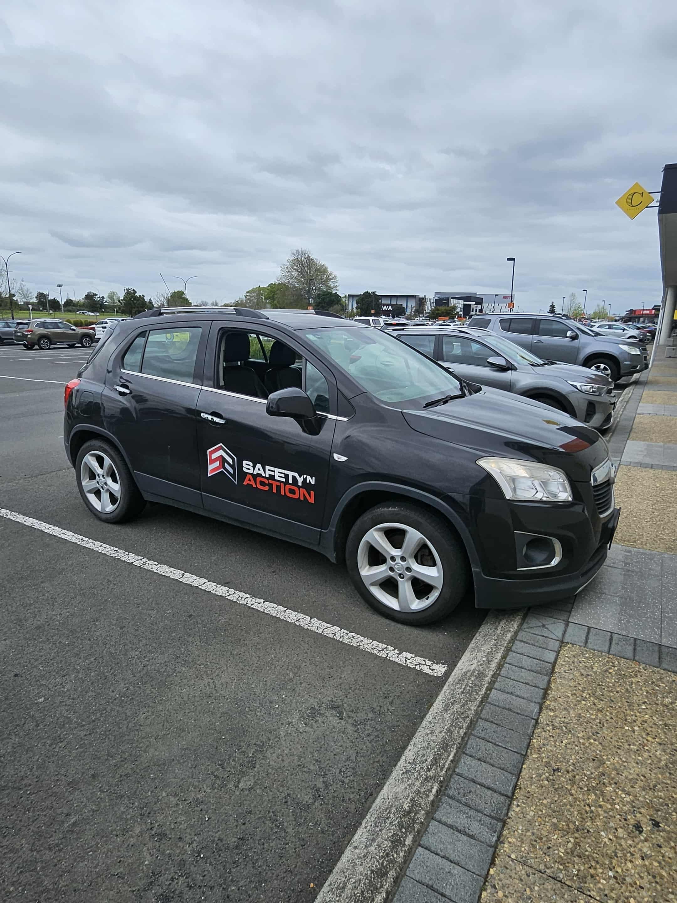

Muncie Posted October 13 Author Posted October 13 Found a cool turbo badge on sales reps Holden Trax at work so yoinked it 3 4 Quote
Muncie Posted October 13 Author Posted October 13 Wof is booked for 27th again took a week off work to cover getting er done! Oh and i bought another turbo Holden for Zach to sit his licence in ironically the car i took the badge off was off to be traded in they lowballed i counter balled with less dramas so took it home. If the commodore doesn't make it this will be the stand in maybe remap the poor thing. Quick service and flick it will pay for this last round of mods once Zach has got driving sorted. 3 Quote
