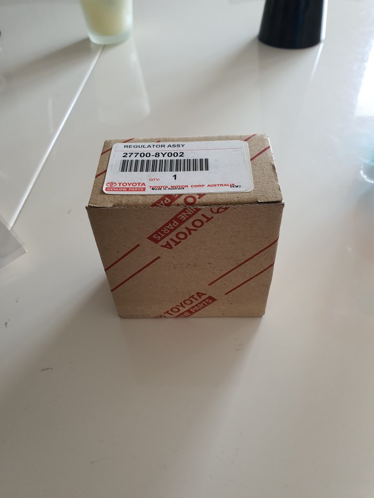

So it just out of the blue thru up a battery light and all the other warning lights at same time just after fitting the new dash and would work then die on and off at random.
The cause after much diagnosis was a dead alternator voltage Reg.
Only genuine parts would do! And were surprisingly hard to find.

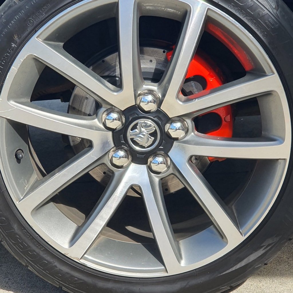

Treated myself to some more wheels gone for 19's this time. Slowly turning into a donk no intention to lower it its awesome never snags on anything.
I was also energetic enough to run the buff over it which has made quite presentable again.

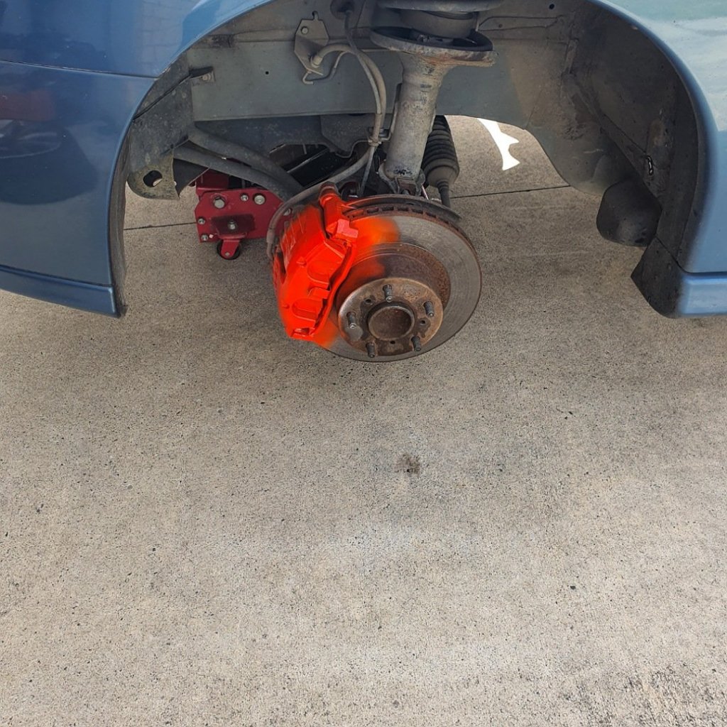

Front rotors now warped might be time for some new curve slotted brembos.

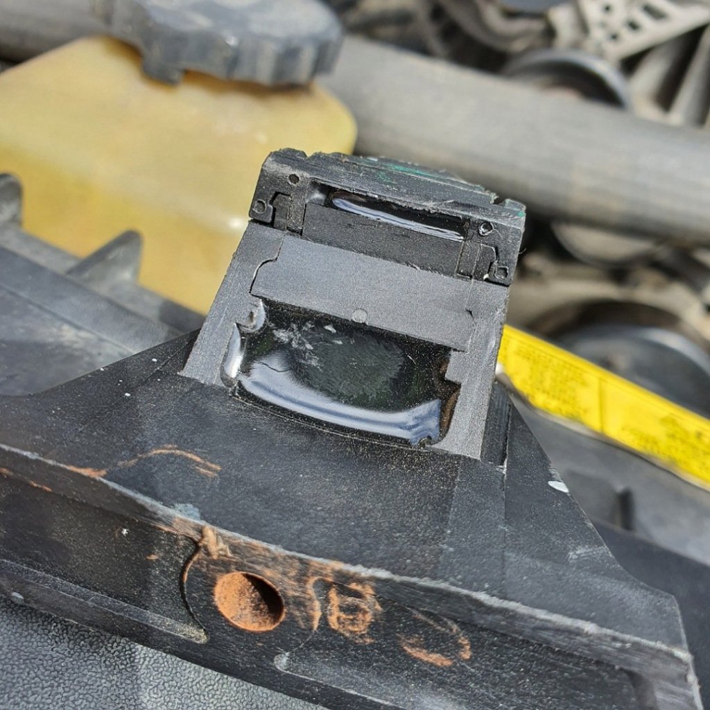

Also discovered it has about 4mm of crank end float. Thought maybe the crank trigger disc on Harmonic balancer was pushing forward and not getting picked up by sensor.
Did some testing with laptop and data logging to see if that was the issue.... nope

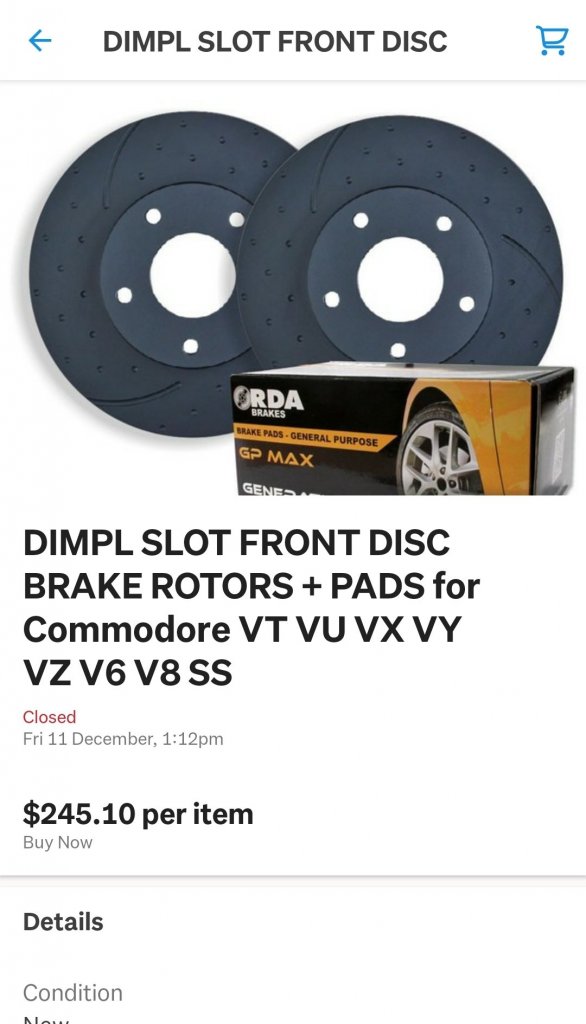

Some of these on way too, not brembos but 200 bucks less is worth a try and are actually a reputable Australian manufacturer.
Anodised too.

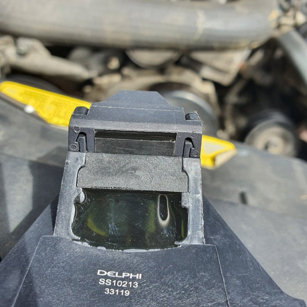

This morning i fitted the new genuine crank angle sensor, coincidentally it was $30 cheaper then the non genuine one i had fitted months ago. I've actually taken a step by step on how to fit one should anyone find that interesting let me know I'll write it up.
Anyway the 4 month old sensor, you see its starting to come apart and visibly the channel the trigger wheels run through had deformed (P.O.S)

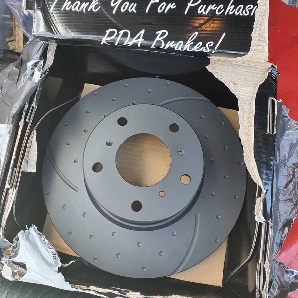

Bedding in procedure done as per installation instructions can tentatively say i think these are better than the brembos i had on the calais previously.
Slipped a cheeky 3mm spacer in as the whiskers on the tyres make a slight fizzing sound on the struts when im giving it beans into corners I'll pull them out once those wear off.
