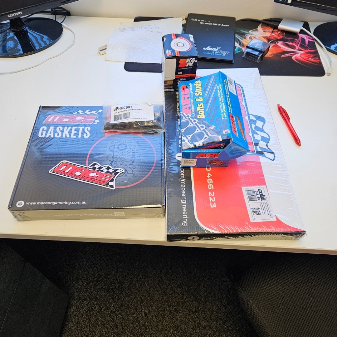

In other news my overnight parts from Japan...... oops Victoria have arrived I can start fudging this thing together.

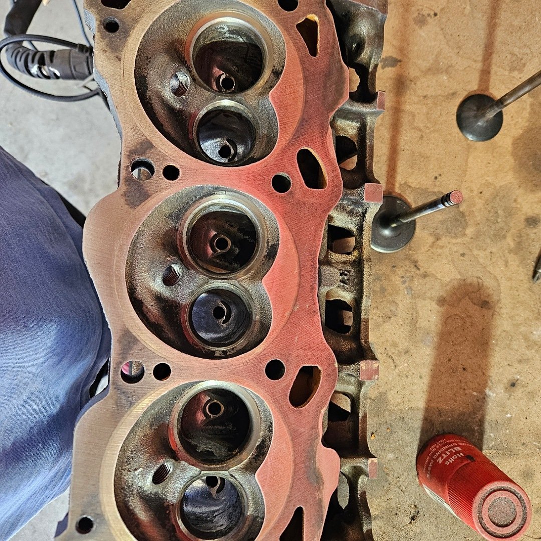

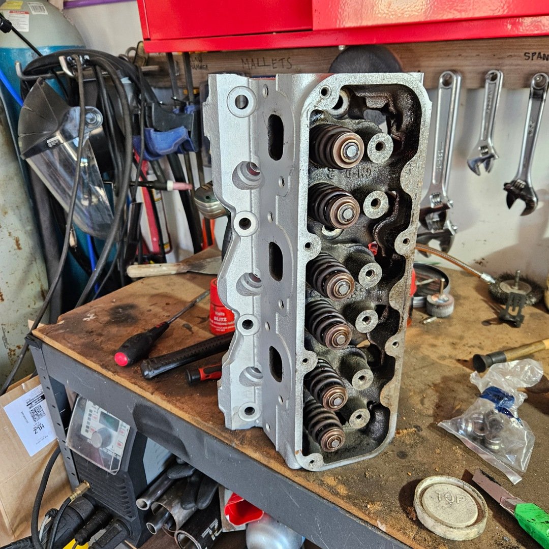

Time to start on the heads, these were a score no cracks in usual places seats are mint i could throw straight on if I wasn't replacing stem seals.

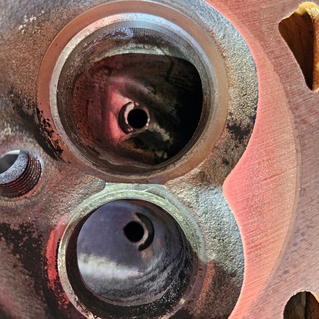

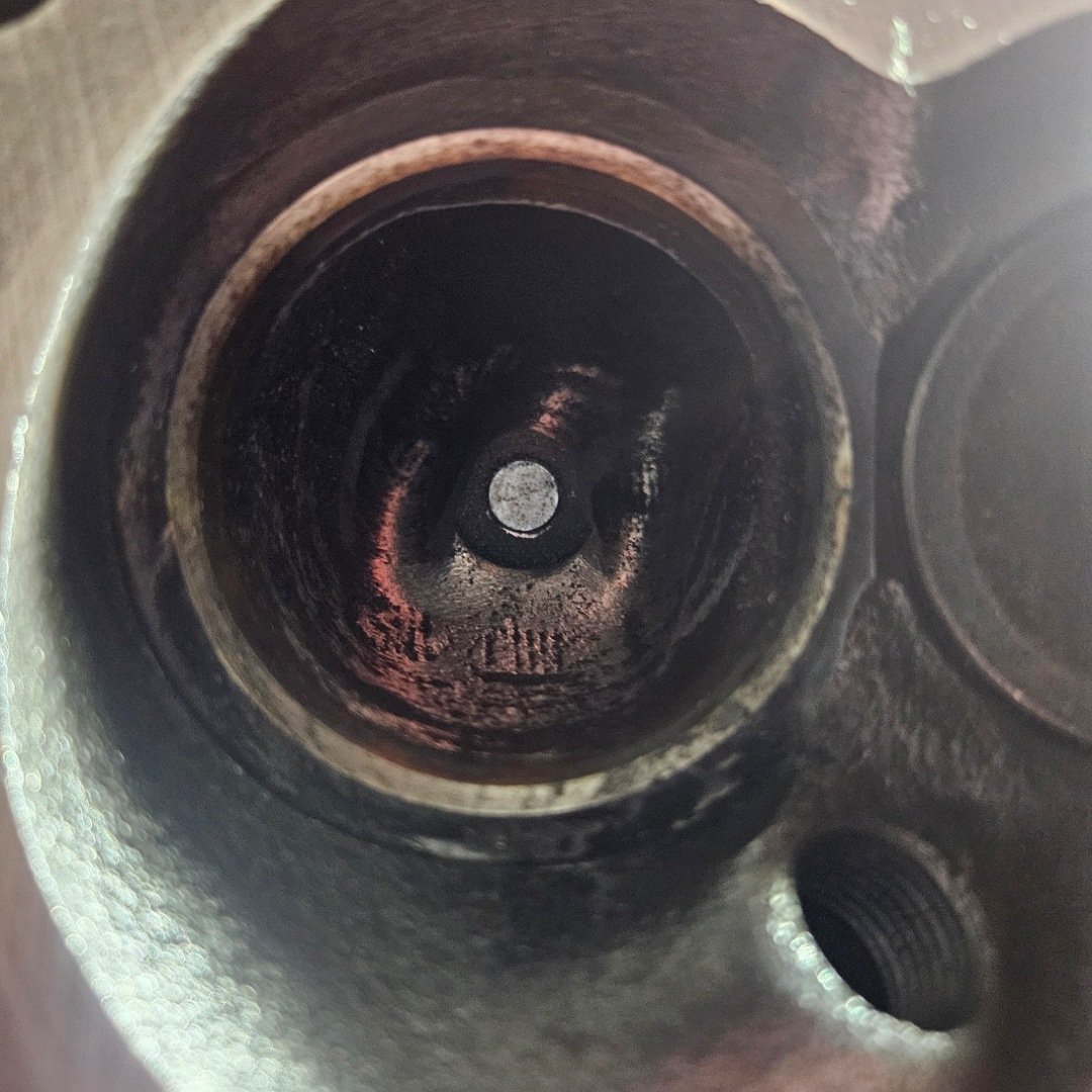

Cleaned up surfaces and popped a valve out to see ports the casting is really rough on these and has a lot of protrusions around valve stem so spent a bearable around of time knocking dags off and reducing shit around the stem.
I dont really know what im doing with porting so will only go this far as these heads look easy to break through on not a lot of metal in between Port and water galleries.
That should burn up all my spare time during the week.
  • Like 5
Ended up doing a bit more on intakes then got carried away did exhaust ports as well they were marginally less shit.

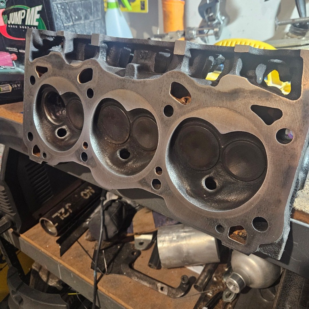

One head down painted and ready for reassembly starting on other one will give a light lap on valves as a few had some dark areas on valves themselves so will get that all gone. The stem seals were basically hard as Bakelite so this hasn't been a pointless exercise.
  • Like 5

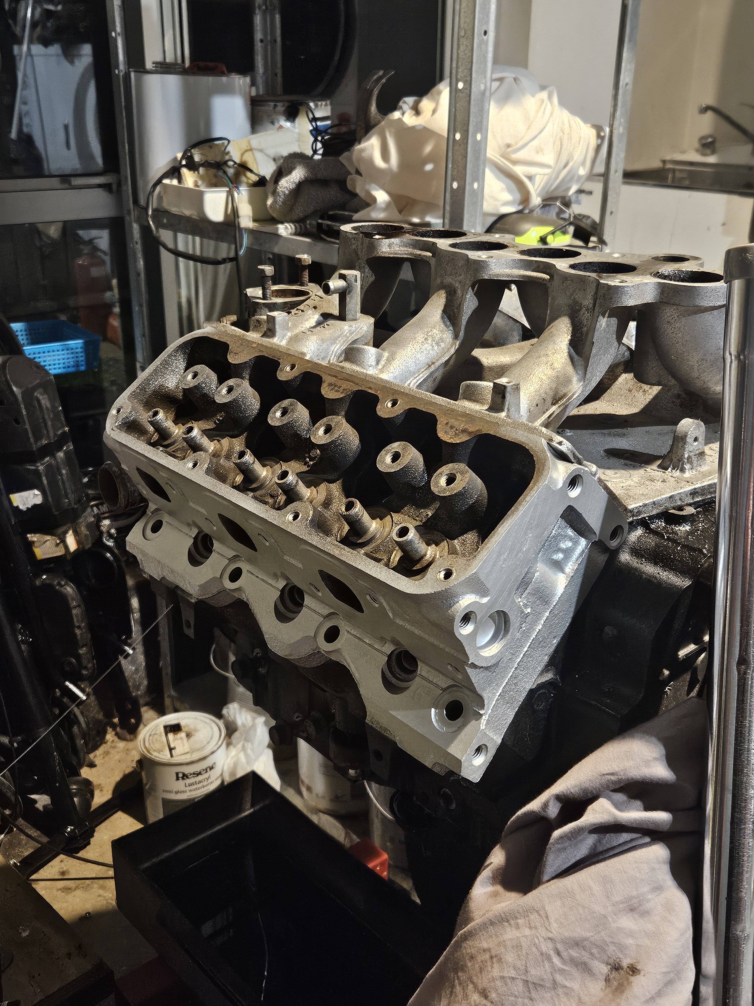

Ready for reassembly will wait for the other one to be at this stage before reassembly so i can get on a bit of a roll, all cleaned out though with oven cleaner no sludge varnish or oil carbon left.
  • Like 4

I stuck them both on bench and went to town on them realised there was a disgusting hump and sharp edged casting mark in exhaust so that got deleted and everything smoothed out, probably bit over a kilo of shavings on bench and garage floor so if it doesn't flow go better I'll be very surprised. Who am I kidding its definitely going to help its no race engine quality job and my first one ever its worth a try.
Currently heads are done, ported valves lapped lightly new stem seals and reassembled and painted ready for the block.
Ready to start on block next needs a degrease and a squirt of silver and I'll start putting it together.
