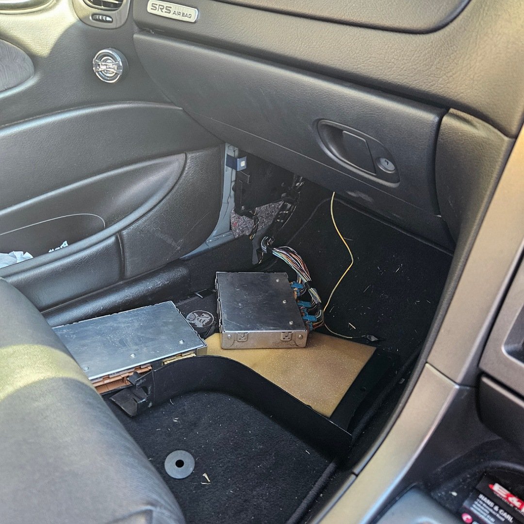

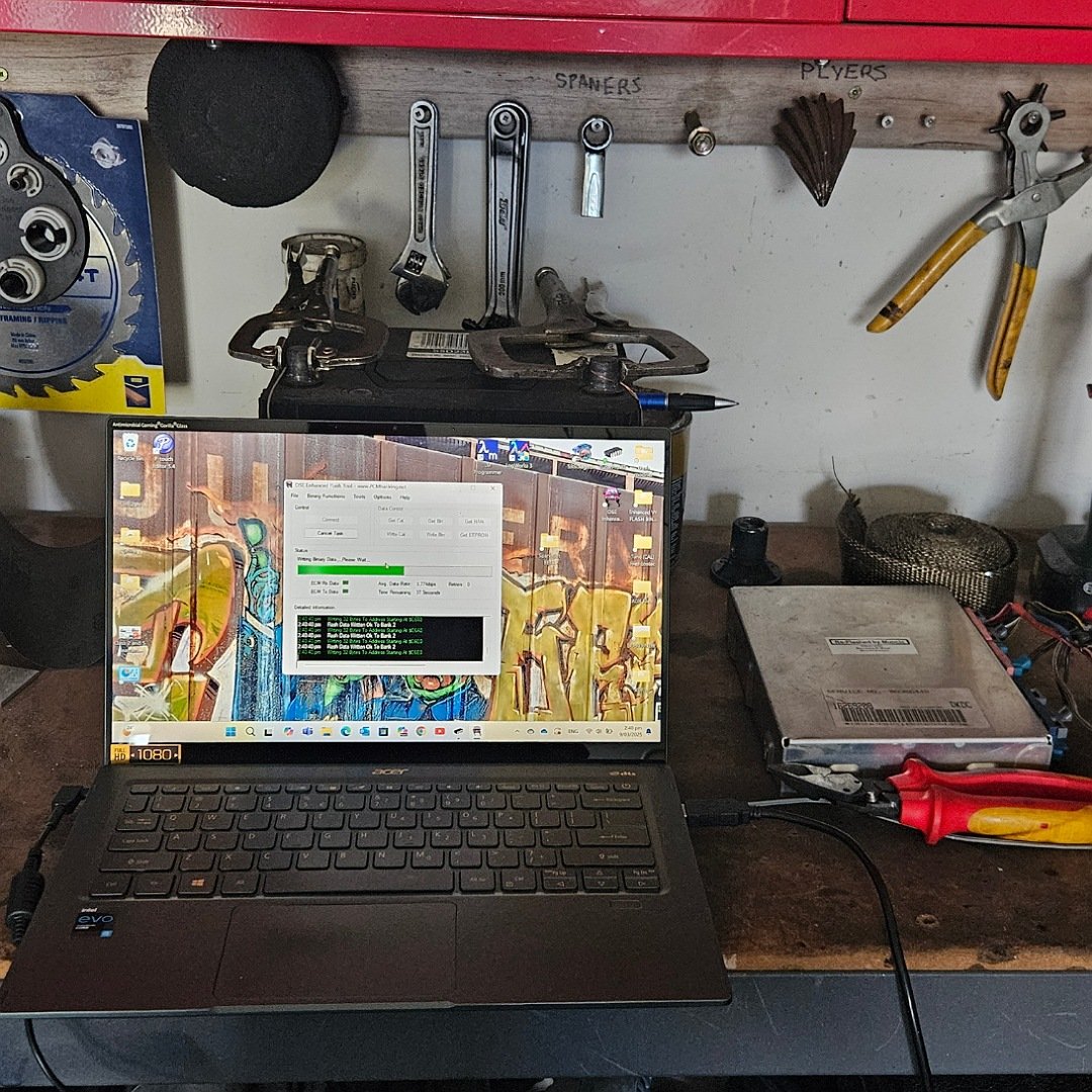

Muncie Posted March 9 Author Posted March 9 Decided a bench Flash would be safer here as any niggling shit like the BCM saying hi on the network can kill the PCM. Flashed everything in hit key and it started instantly which is weird as i normally need to floor it to get it to light off, running same settings but different dwell for coils so may have been issue the whole time. Went up road fine everything as normal let it warm up then gave it a rev to see if 4000rpm spark cut limiter was doing its thing nope straight past 7000rpm oops I've fucked up. Check engine lights on so back to the laptop to see what ive missed but hey 7000rpm it's never got there before. Calling it a partial win. 6 1 1 Quote
Muncie Posted March 14 Author Posted March 14 Testing stuff..... means passengers floor is a mess..l For first time since I flipped the inlet manifold and fitted big injectors it now starts without needing to give it throttle which is fantastic and idles properly new software is showing my injectors are programmed as 950cc so I could definitely improve my economy a bit by going through fuel tables again. All in all its better than when i ran at drags. 6 Quote

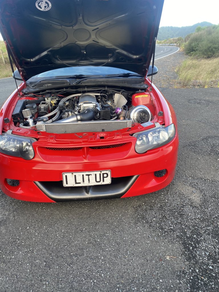

zach_munce Posted April 19 Posted April 19 Me and dad went for a drive to mess with tunes and this dude flew by in a red commodore so we chased him down and gave him a rev so he spun back to talk to us was not expecting this absolute beast 1 1 Quote

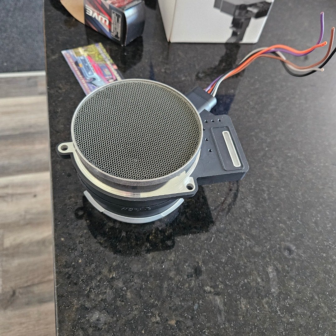

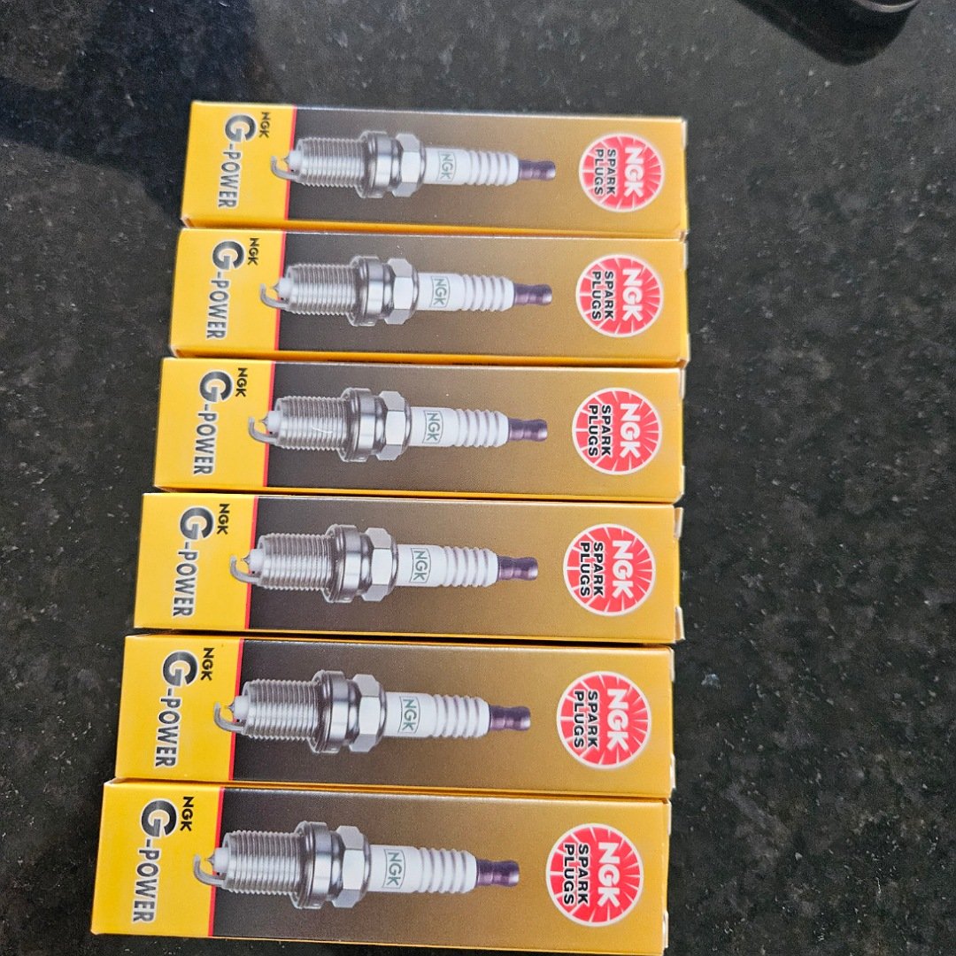

Muncie Posted April 19 Author Posted April 19 Which has led me order my next upgrade to an LS MAF Sensor and some new spark plugs for next round of tuning. I've maxed out the stock Maf before 15psi so this should get me to 20 plus which realistically I'll be breaking transmissions and diffs before I run out of head room, an ls7 card type sensor is good to over 30psi but is a bit beyond my tuning skills and needs fabrication to fit the inlet pipes so happy medium it is. I've been trialling a spark cut rev limit which works well spits flames etc and keeps the turbo on boost if your foot is down which I'll be running once the new MAF goes in. Each drag day I've dropped at least a second so hopefully I'm into the 13s or high 12s this year. 6 Quote

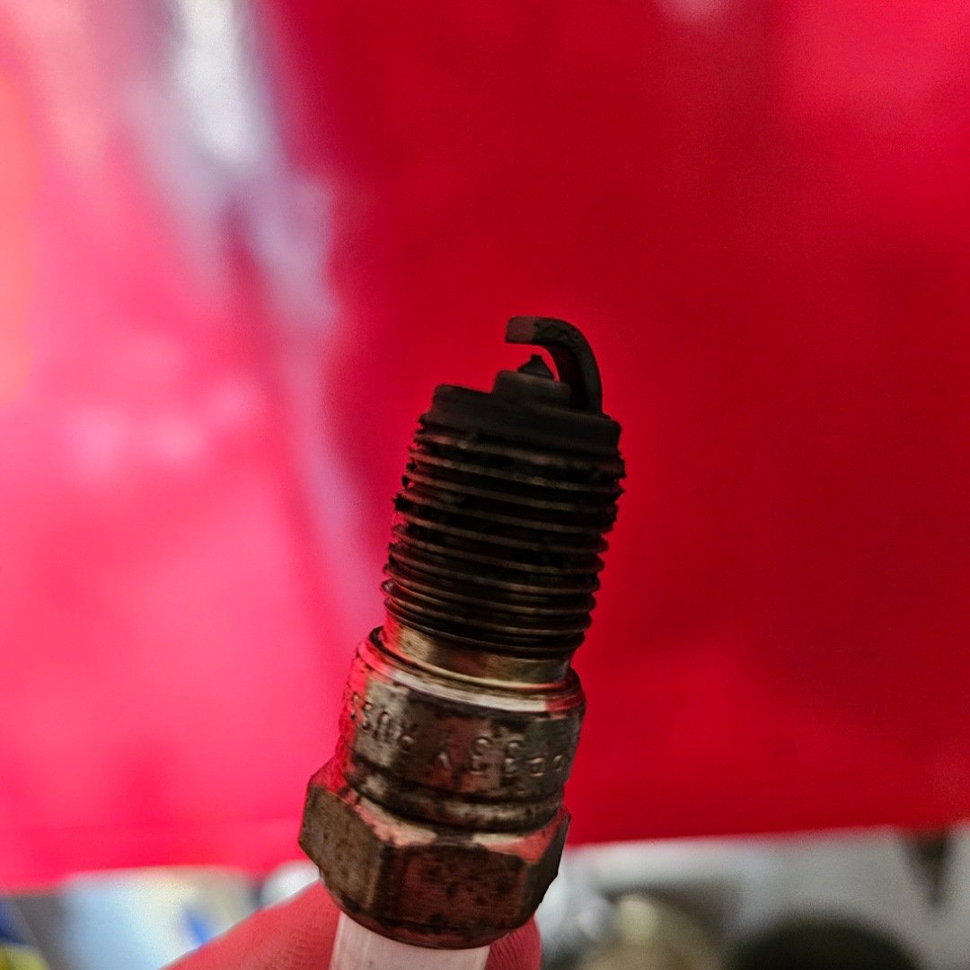

Muncie Posted May 3 Author Posted May 3 Did actual maintenance to this poor thing and replaced the rooted spark plugs that have been in since 2021 with fresh set of NGK's Also there's my new Delphi 4" airflow meter bit of work to do before throwing that in firstly finding out how to set up the scaling in tune so it reads correctly its a common upgrade so info should be available easy enough. Runs nice again all way to and through the red line again. 3 Quote

Muncie Posted May 4 Author Posted May 4 New file flashed in today this is of course another Beta version off Pcmhacking.net Has quite a few extra things that can be adjusted and a spare input is there for a 0-5v sensor not sure what I'll connect to that yet. My wideband calibration must be wildly off for the state of the plugs they were wet with fuel when I took them out. The calculator used initially to set up the fuel injectors was probably 20% off giving me specs for 1050cc specs instead of 850cc hopefully that helps the massively rich situation. The new tune file just has an injector size table and you add in the rest of specs from the injector info sheet and its away. 3 1 Quote
Muncie Posted June 1 Author Posted June 1 Did Some things today all software stuff uploaded a patched firmware that upped Max Cylinder airflow from 700mg/ second to 1650mg/ second Pulled 10% fuel out then took for a test drive and it now knows what its doing with timing and fuel at the top end i'm seeing up to 953mg/sec at 5500rpm if i change my shift points it will rev to 6400rpm now. Previously it would go flat after 700mg/s but still pull now it just goes and has mapping to do it. goes with one caveat i'm out of Range that my MAF can now measure peaking at just over 10800hz. i've got a LS2 MAF that is both bigger and able to output up to 14000hz which should see me hit my 6400rpm @20psi goals which should make around 450-500hp according to a few dyno operators in oz that have seen a resurgence of turbo Ecotecs now LS stuff has become expensive again. Fitting it will mean starting all over again and setting up the tune to work with the different output of the new MAF. Annoying that this Patch in the software probably would of got me a 13 second pass at drag day..... oh well I'm still Beta Testing a Spark cut Rev limit for Pcmhacking.net thats on hold for the moment as it needs some people much smarter than i am to tweak the code to get it operating quicker so you dont lose 900rpm per cut event. 5 Quote
