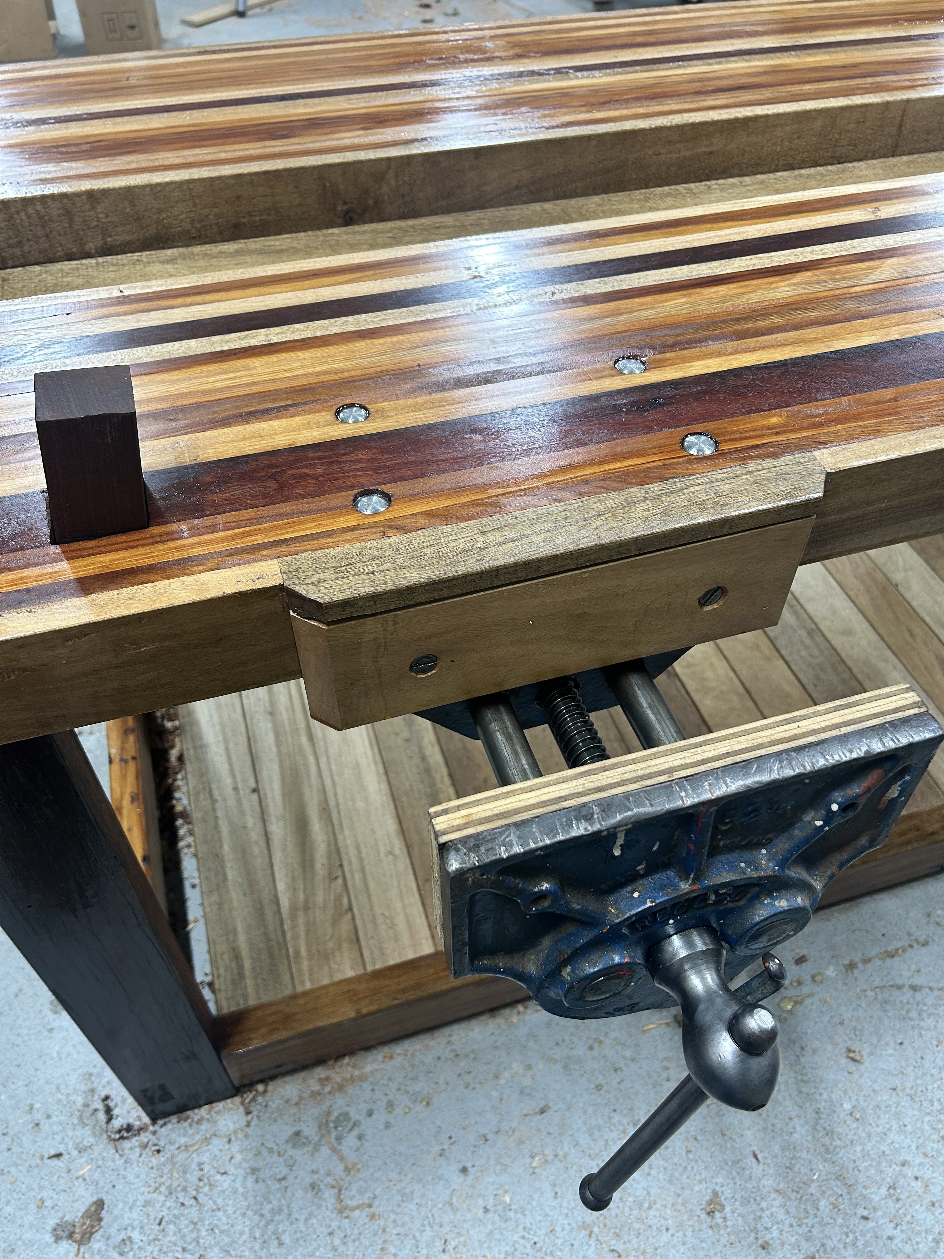

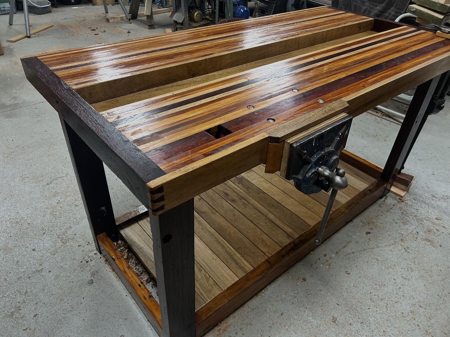

Popular Post nzstato Posted September 23, 2025 Popular Post Posted September 23, 2025 This is a bit of a different project for me, and my first real try with carpentry. I set the goal to make a workbench using all wood joints - no nails/screws. Every piece means something: Rimu (laminate top) - recycled from 1880s biscuit factory Rimu (frame) - from a large beam left in the garage when we bought the house. Rata (laminate and legs) - saved from the lintels from a greenhouse I had to take down (the beams were heavy) Macrocarpa (frame) - milled from a work colleagues house site overlooking Otago harbour. Wood vice (Record 52 1/2) - ex Otago Girls HS (c. 1950s) Blacksmiths vice - from my pops workshop (still more restoration needed) 35 6 Quote

chris r Posted September 23, 2025 Posted September 23, 2025 That's sexy! Did you pin/glue it together? 2 Quote
nzstato Posted September 23, 2025 Posted September 23, 2025 32 minutes ago, chris r said: That's sexy! Did you pin/glue it together? Yes the top is all glued. The frame is held together mainly with mortise + tenon joints (+drawboard pins) with a few housed dovetails. The lower shelf is handcut T&G in a housing joint, same with the 'trough' between the benchtops 7 Quote

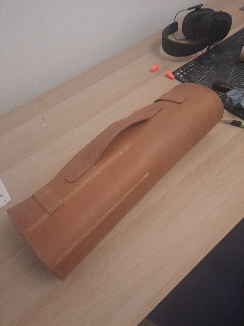

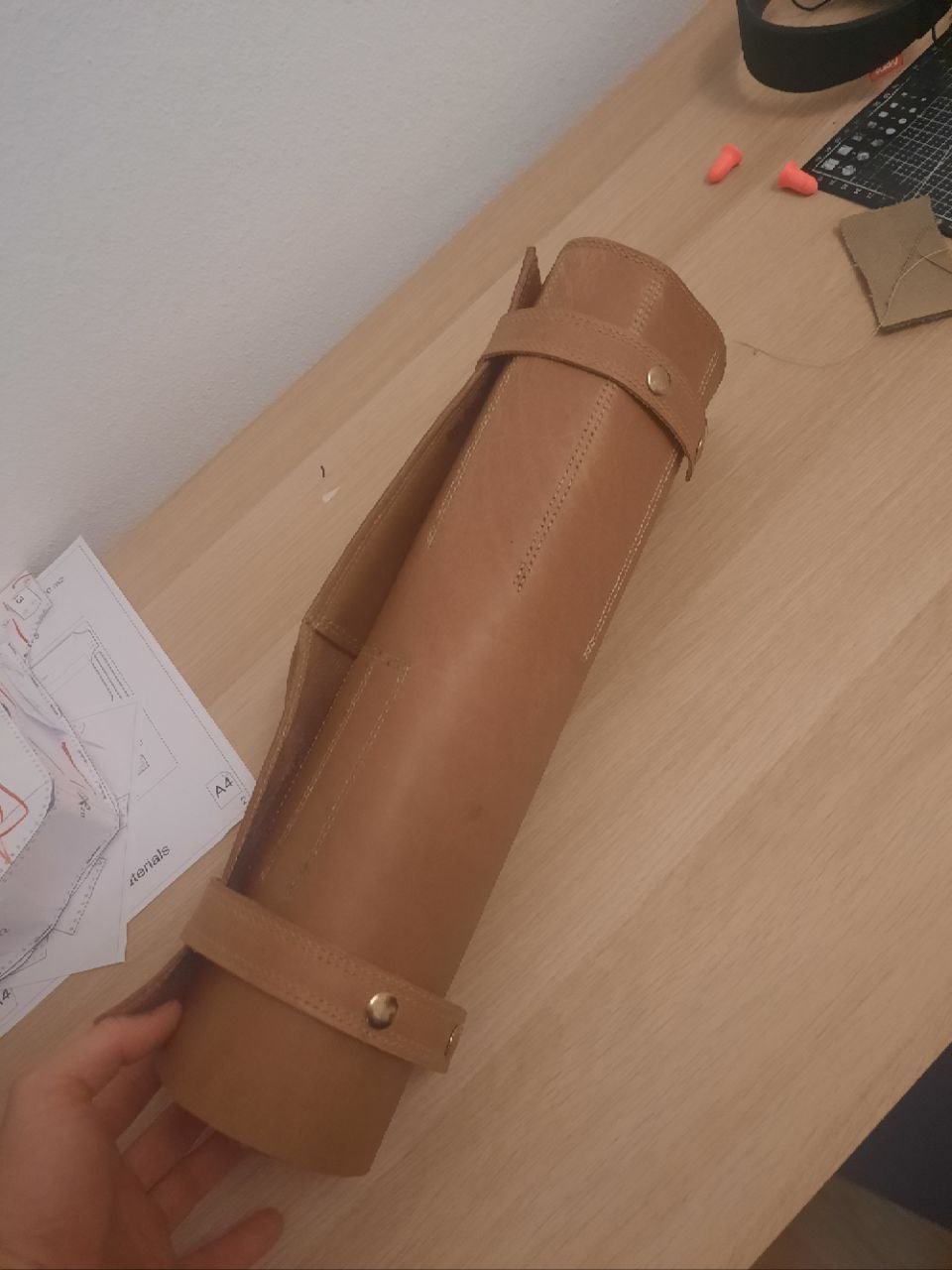

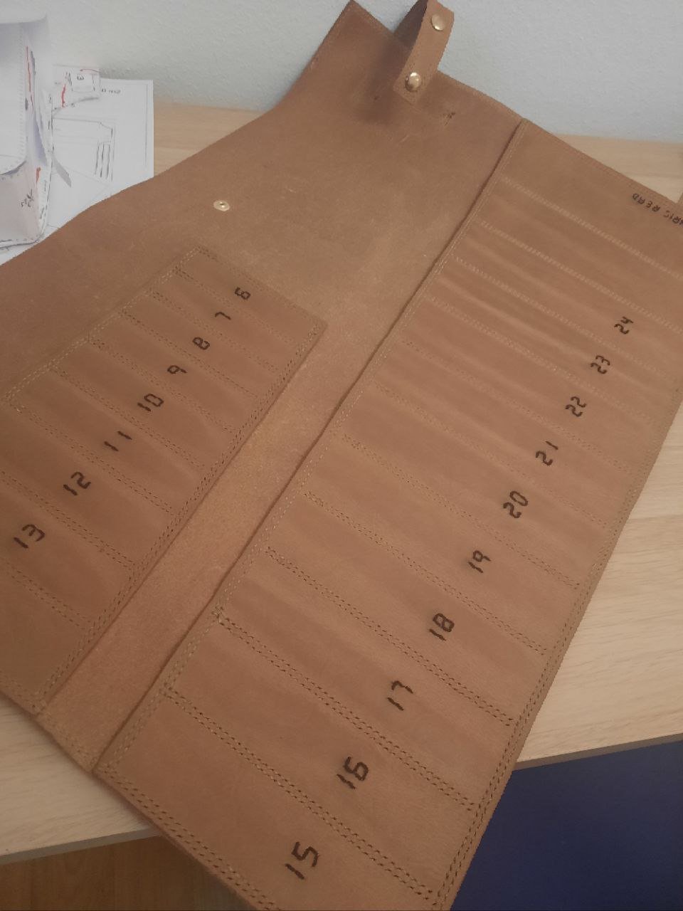

Popular Post chris r Posted September 23, 2025 Popular Post Posted September 23, 2025 Not my work but my brothers. He makes fancy leather slings and I was complaining about my spanner roll being fucked so he made this. Should outlive me 29 Quote
Bearded Baldy Posted September 24, 2025 Posted September 24, 2025 Very nice work. Would he be interested in doing a couple of knife sheaths? In 30 years when i get onto that project. Quote

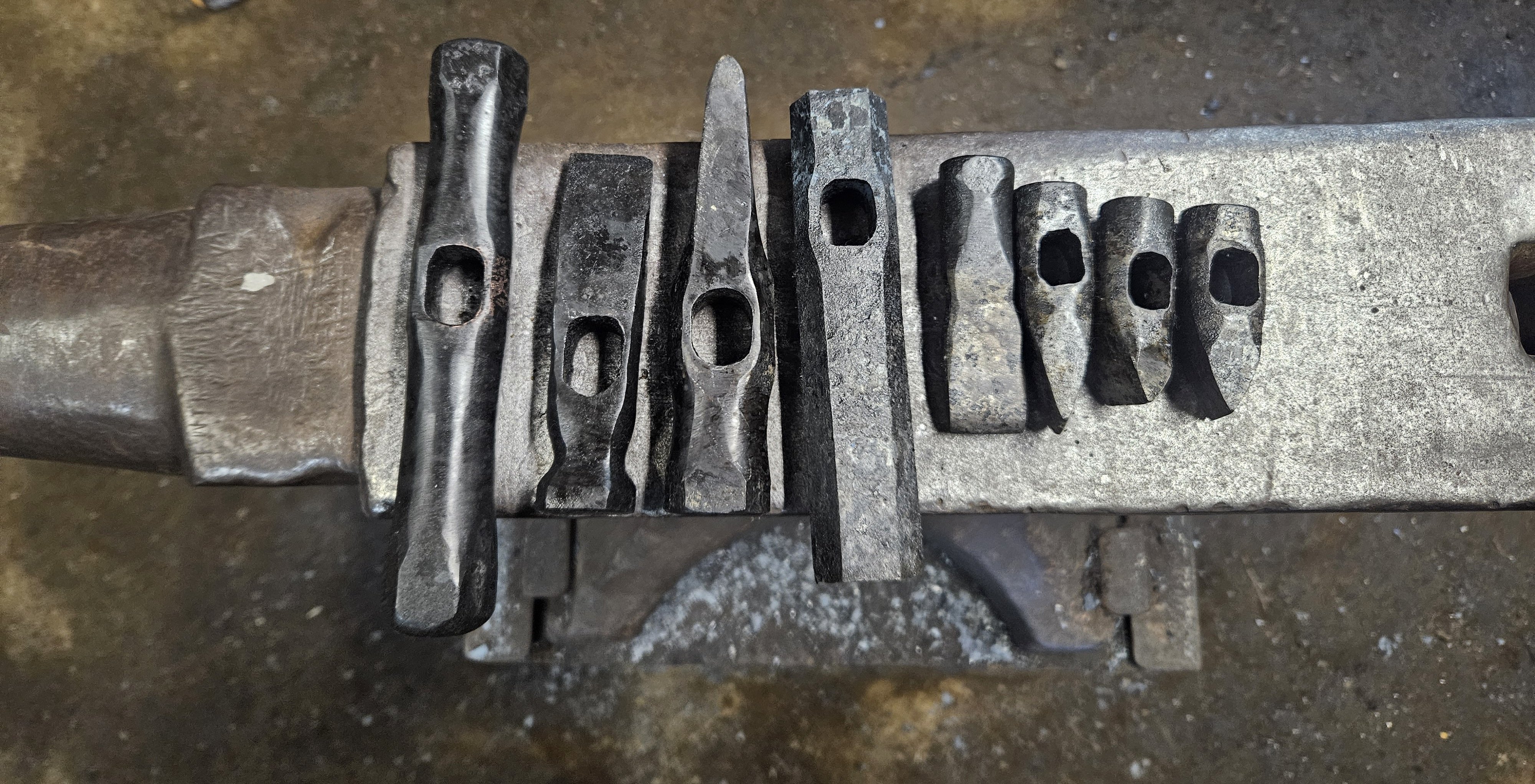

Popular Post SOHC Posted October 10, 2025 Popular Post Posted October 10, 2025 I was making hammers and a hot cut set this week when I was sick as a dog. 12 Quote

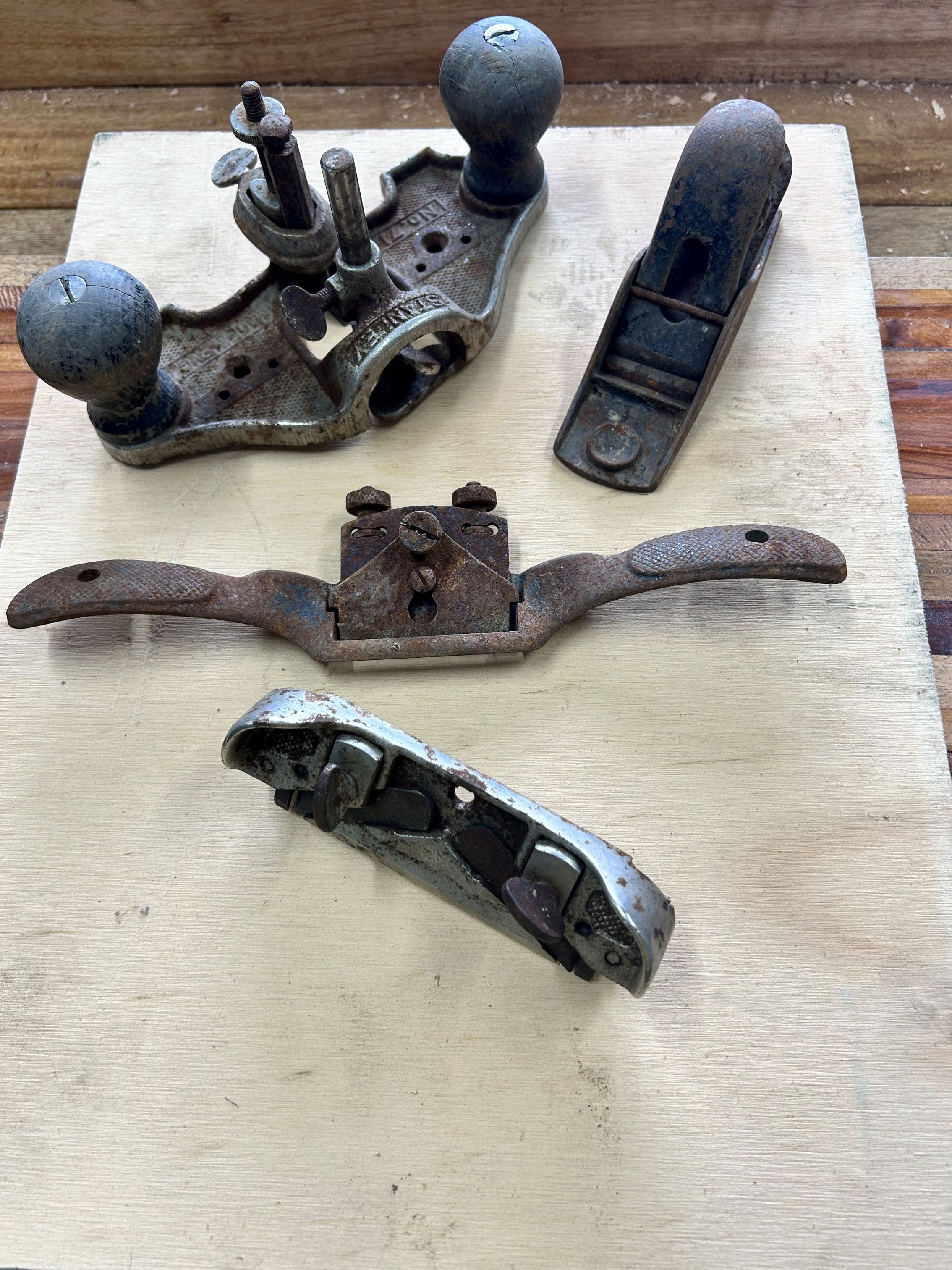

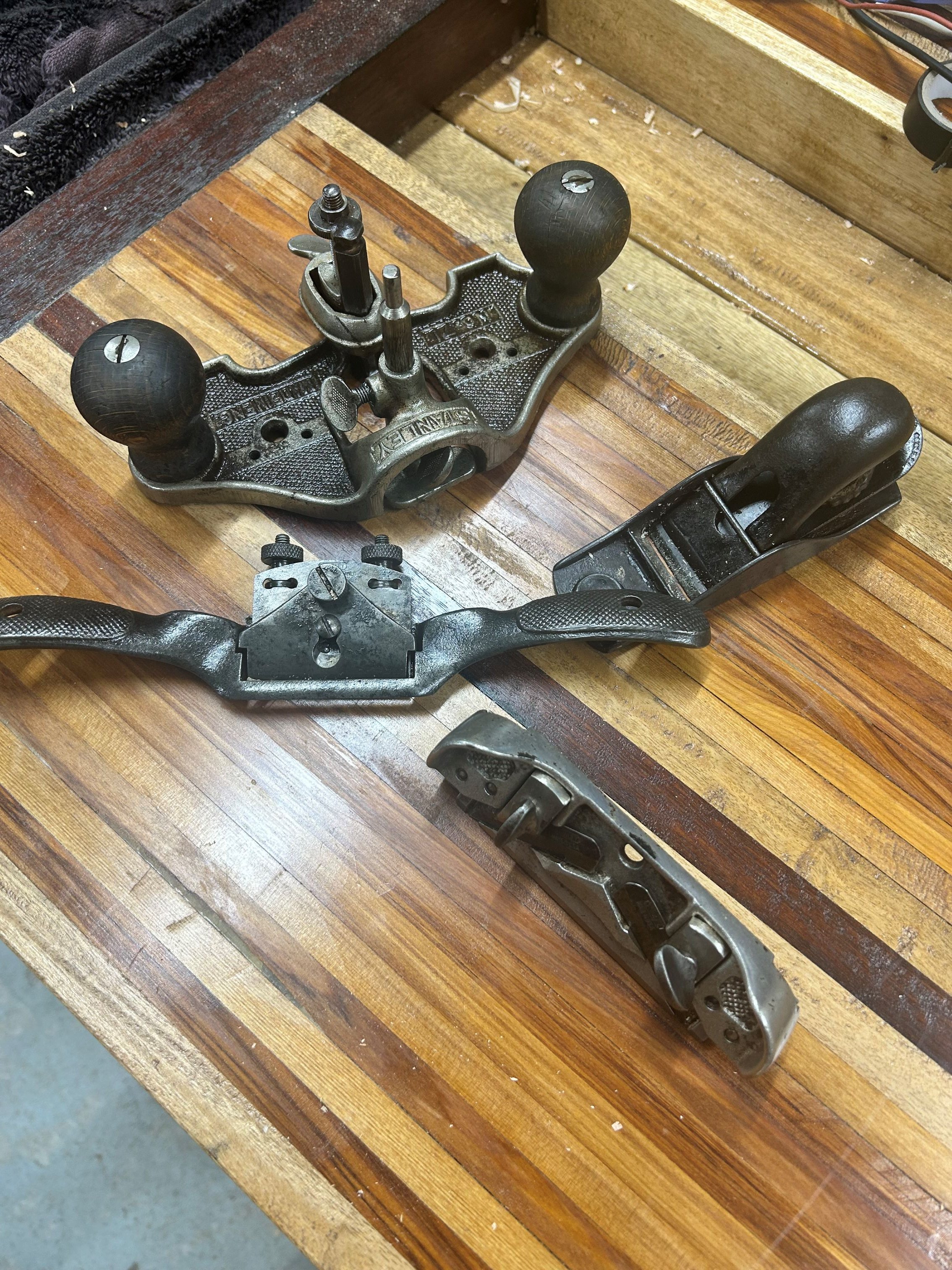

Popular Post nzstato Posted October 15, 2025 Popular Post Posted October 15, 2025 Doing lots of little tool restoration at the moment - the shed cant take any workshop machinery. I really dont like cosmetic restorations of tools or 'collector only' stuff- my preference is to keep whatever age/patina is there and then get it working how it should/straight/sharp etc. Kinda worked out my own process for derusting stuff like this (FYI for anything else). I tend to go with the brass wheel on a bench grinder to knock off the major stuff, then dunk in a tub of water/oxalic acid for a few days, back out and on the wheel and repeat untill the rust is gone and any exposed bits have a black iron-oxalic acid complex to them. Nickel plated stuff I'll scrub any excess off with a tooth brush and steel buff off on the wheel - coating in CRC or linseed oil keeps them fresh. You can buy oxalic acid as 'bar keepers friend' from bunnings for cheap. 21 Quote

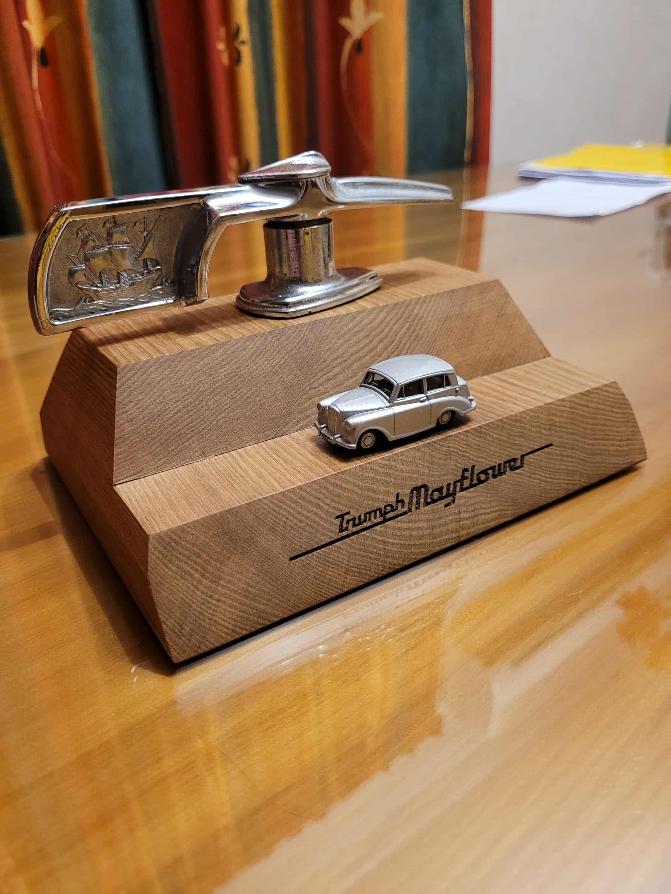

Popular Post Willdat? Posted October 22, 2025 Popular Post Posted October 22, 2025 Great Uncle has a Triumph Mayflower that he replaced a Datsun 1200 Coupe with in the 90s, he wanted a display piece for a hood ornament and model. 25 Quote

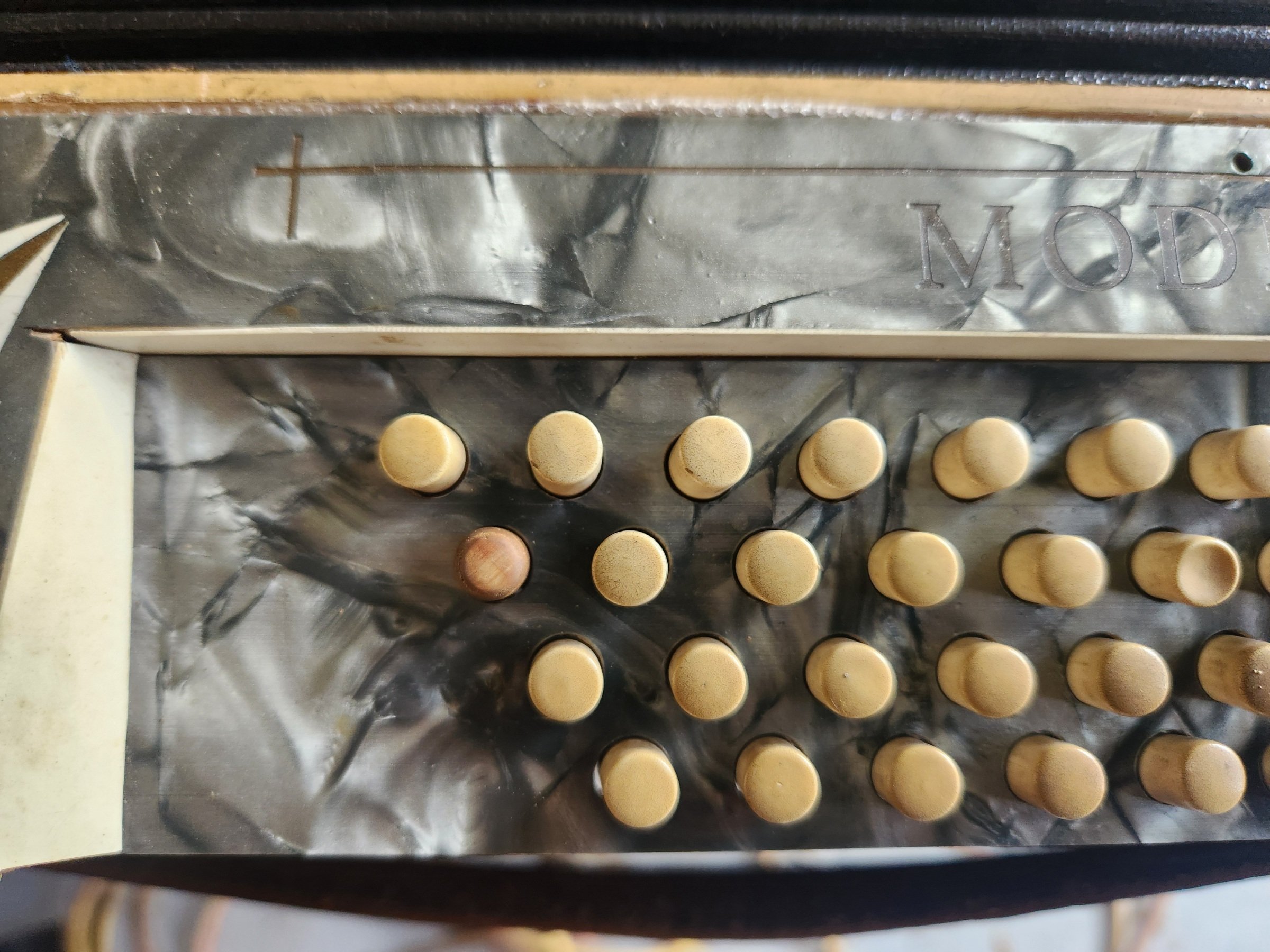

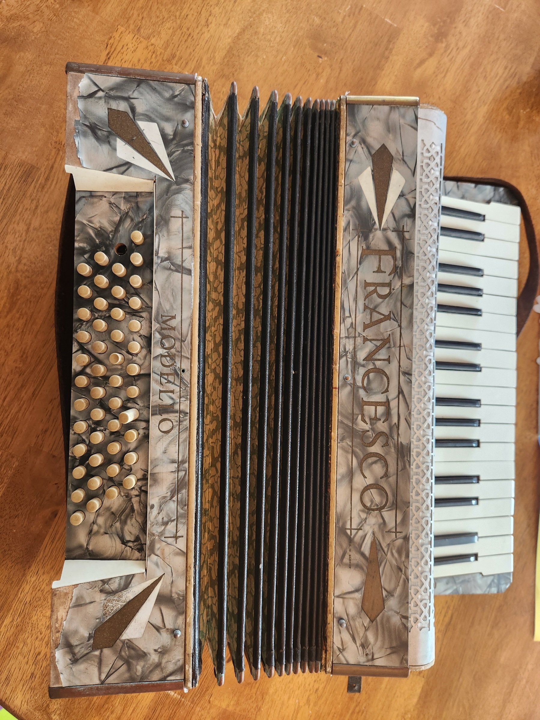

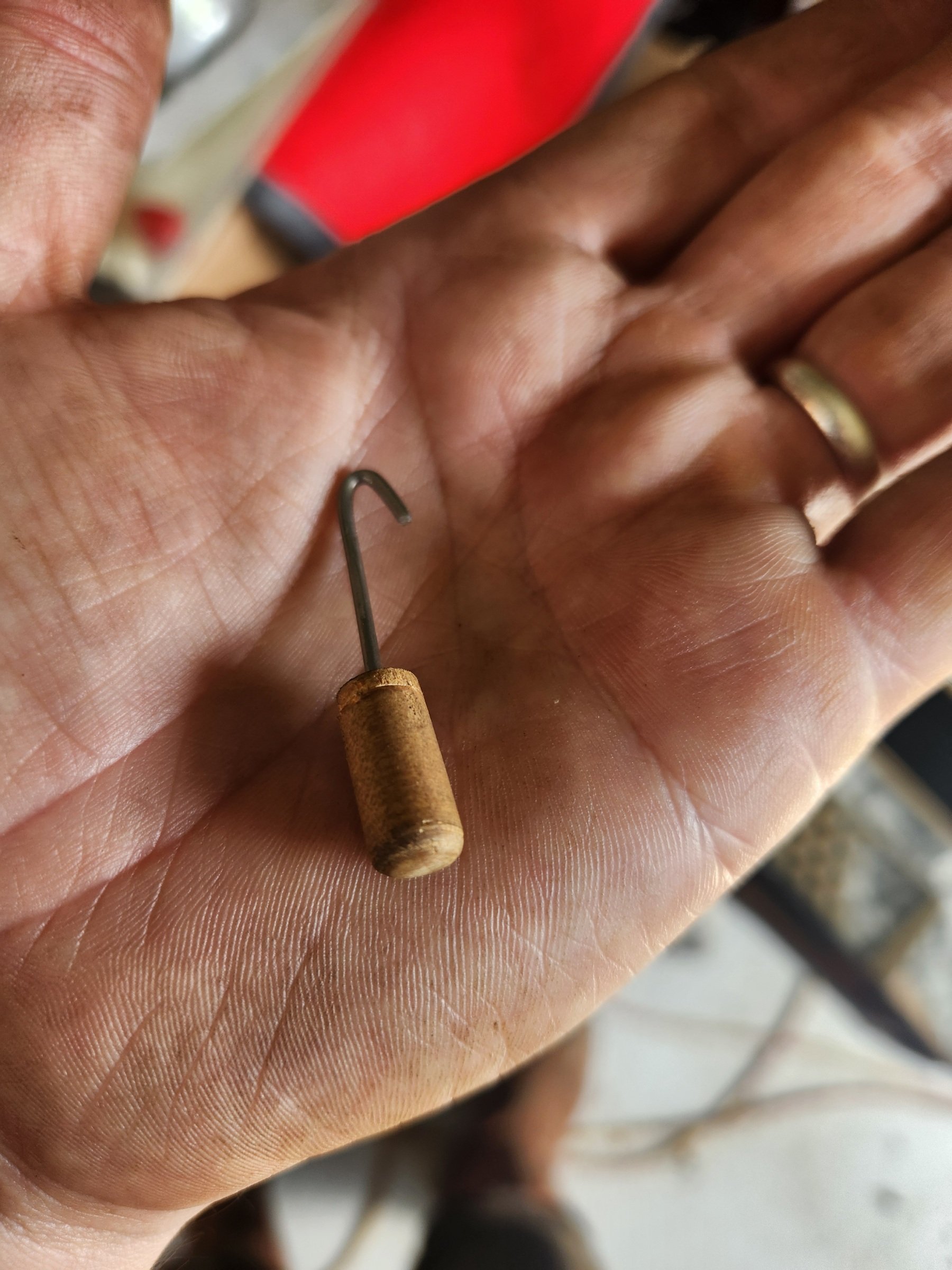

Popular Post tortron Posted November 1, 2025 Popular Post Posted November 1, 2025 got an old pianno accordion. BROKEN has been misshandled, probably dropped or something, one of the bass valve rods had jumped out of line and was laying over another at one end, so some valves were always open, buttons were stiff and sticky, and generally no good. easy enough to just realign those. This let me otherwise test it and other than a small air leak in the bellows, that will come right with some fabric tape, it seems to play fine. other than that there is one button that is always out, and one button that was missing along with its linkage rod. (both on the same bass valve rod, so probably related) sticking out one is easy enough, just some adjustment bending of the linkage rod and it sould sit just right For the missing one, i made one out of some 1900 villa wood and the rod was about the same as the broken lawnmower control cable that i left on my bench from yesterday Thats lovely, the originals are casein. 11 Quote

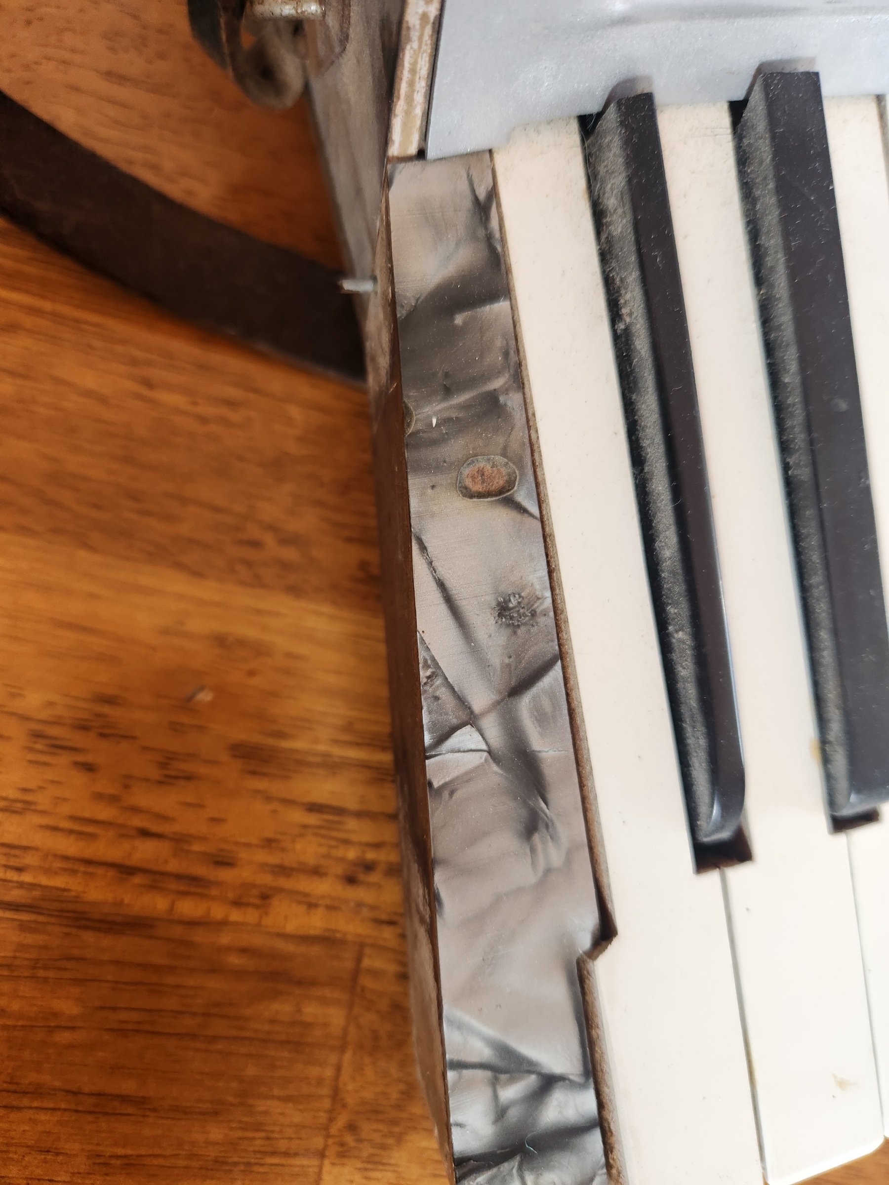

tortron Posted November 2, 2025 Posted November 2, 2025 this here is great. the bit of pin sticking out appears to have held a spring clip for holding your ciggy, as the ash drops down and burns the (highly flammable) celluloid shell 9 Quote
