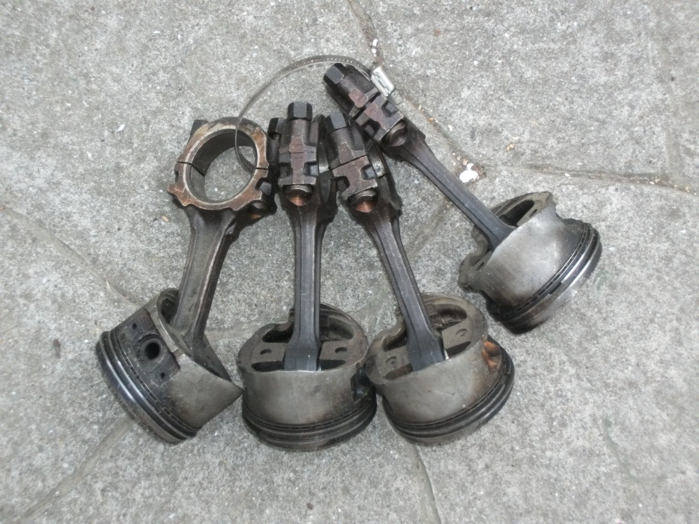

gettinroundtuit 220 Report post Posted May 7, 2017 Been shopping on trademe, road trip to Port Charmers to pick it up today. Long awaited 2y crank trouble is its still wrapped up inside an engine. Now to strip it tomorrow night & get crank off to probuild 2 Share this post Link to post Share on other sites
Toddy415 887 Report post Posted Wednesday at 08:29 Good to see some more progress on motor. Very interested to see how this turn out. What are your plans body wise for this thing? Share this post Link to post Share on other sites
gettinroundtuit 220 Report post Posted Wednesday at 20:02 Strip it to a bare shell, fix what needs doing & toss a coat of paint on it. When shopping yesterday - CA18 det rods!!!!! Off to Probuild shortly check out crank progress & drop these off. 2 Share this post Link to post Share on other sites

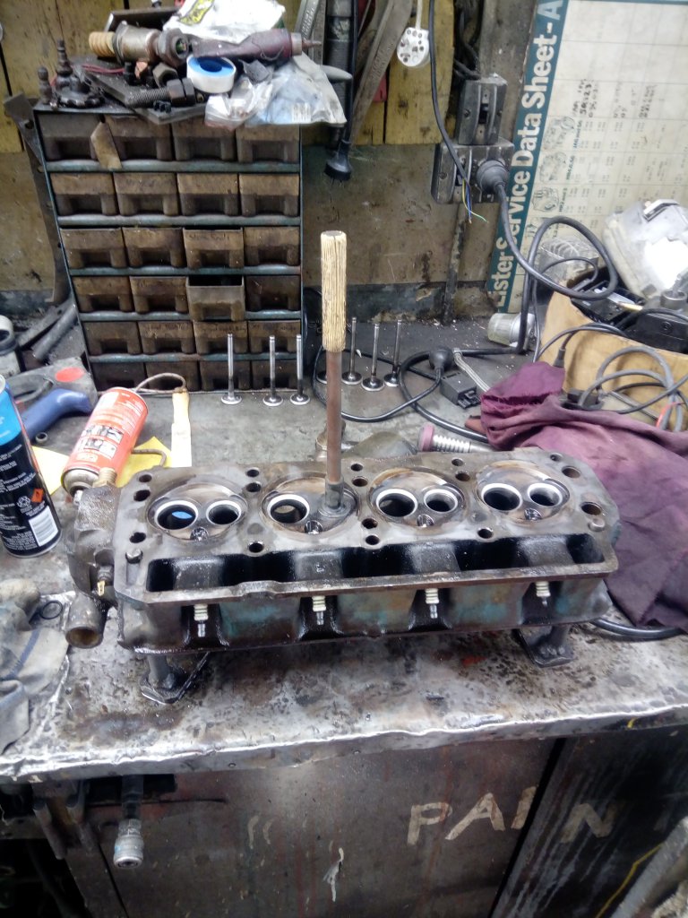

gettinroundtuit 220 Report post Posted yesterday at 08:58 Gettin temp engine ready the old school way, lapping valves- valve grinder broken 1 Share this post Link to post Share on other sites
