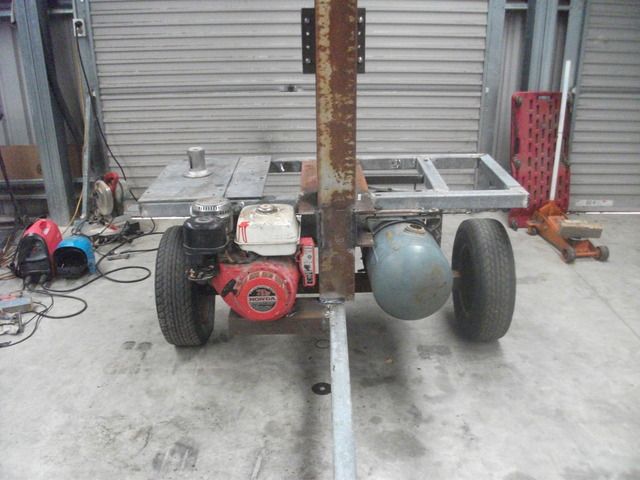

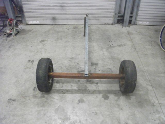

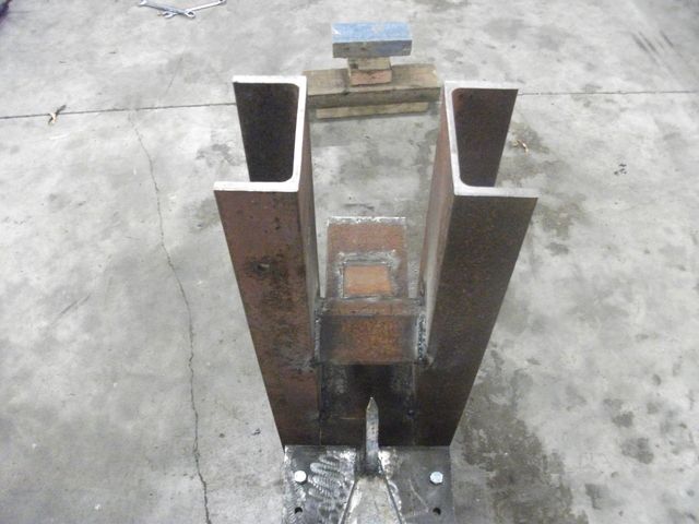

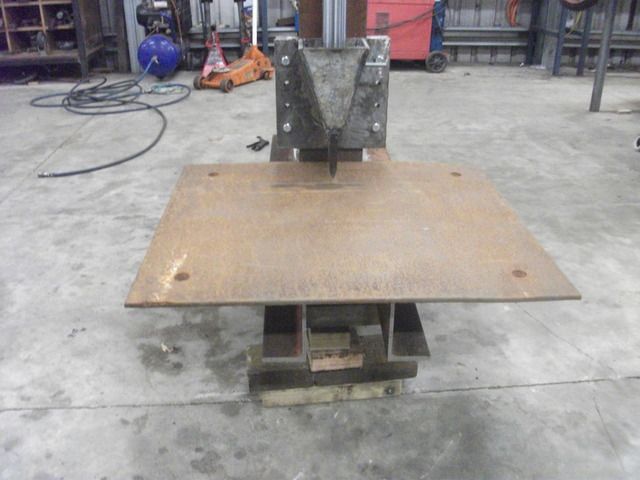

Valiant Posted March 25, 2015 Posted March 25, 2015 This project has been a few years in the making between a friend and I. We've been scrounging parts and looking for bits and talking shit. The plan is to make a good splitter for as little as we can get away with. It needs to be a trailer mounted, with a WOF and rego, upright ram, with a nice big table, good motor, fast cycle times and good force. So here's where I'm up to. All the steel has been recycled and or dragged out of skips around and about. So far I'm quite pleased. It's very heavy, too heavy to weld successfully with my little Mig so it's out with Arc which is rather satisfying. More later. 7 Quote

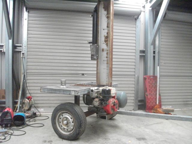

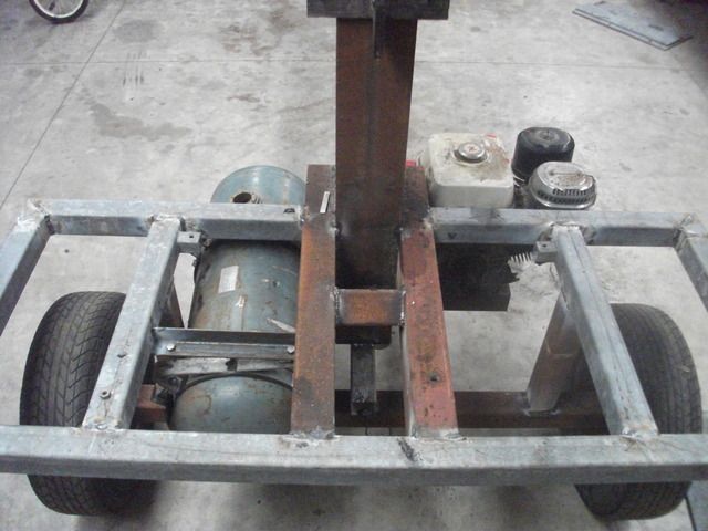

Popular Post Valiant Posted April 11, 2015 Author Popular Post Posted April 11, 2015 I've been working hard on this and it's starting to look the part. 11hp Honda to power it and an old LPG cylinder for a hydraulic reservoir. Table's all framed up too. Industrial accident is just around the corner! 13 Quote

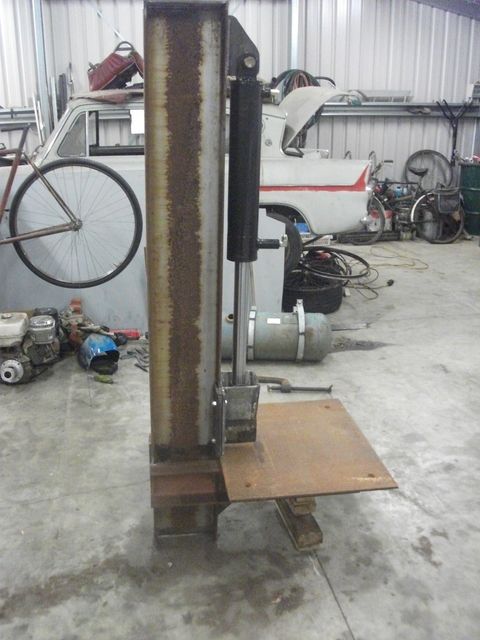

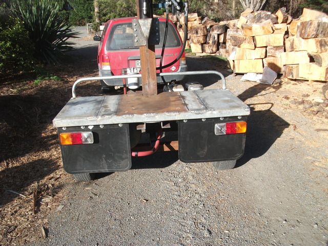

Popular Post Valiant Posted June 27, 2015 Author Popular Post Posted June 27, 2015 Chipping away, nearly finished. Lots of little bits done. Mud flaps, half done tail lights, safety chain, decent pins for each end of the ram, most of the table top welded on, and a hydraulic tank that was a LPG cylinder. The tank was quite a bit of work, It has a removable top so I could get inside it and clean and paint it inside so no grit or welding splatter goes through the pump. It also mounts the return filter. If I did it again I'd do it a bit differently. So it goes. Everything's plumbed up, pump is mounted and it works! Well even. There's a couple of things to do yet, the Chinese ram has a pin hole in a weld and leaks oil, there's a couple of braces and guards to make, and wire up some tail lights. Then it's all go. 11 Quote

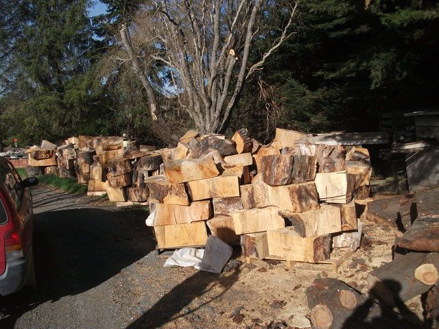

Popular Post Valiant Posted July 5, 2015 Author Popular Post Posted July 5, 2015 This is finished! I took it to the firewood pile this afternoon and gave it a good work out. It works great! Fast and powerful, it chomps through the knotted pieces of wood with ease. The tables are a good size and height Dave and I had no problems stacking blocks on it we split probably fiveish? cubic meters of old pine and gum, on about two thirds of a tank of petrol, in about two hours. The engine doesn't even need to be on full RPM. It doesn't have WOF and Reg yet but that's not a problem we'll sort that out next season. Project finished. WIN! 19 Quote

yoeddynz Posted July 20, 2015 Posted July 20, 2015 Good work. Damn I need one of these! We have many a pine tree to fell and wood is stacked up doing nothing due to no splitter. Where did you get the ram from and what type/size pump did you use? 1 Quote
Valiant Posted July 20, 2015 Author Posted July 20, 2015 Hi Alex. The ram came from Trade me it's a specific log splitter ram. 3 to 4 inch bore is the ideal size for slpitters according to the guys at the hydraulic shop. It has a large spear so it retracts quicker. It's Chinese, the first one had scratched chrome and this one had poor welding that leaked. Chinese parts life I guess. The pump is a two stage one that I got from the hydraulic shop. It does high flow under low load and high pressure when it is loaded up.I can't remember what size it is. It works well, the equivalent is on TM for about half price. It has chomped through everything we have thrown at it so far. Quote
