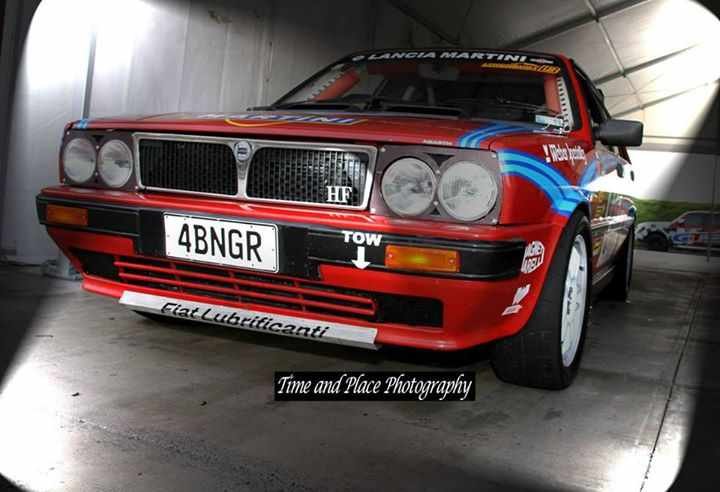

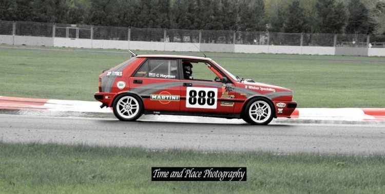

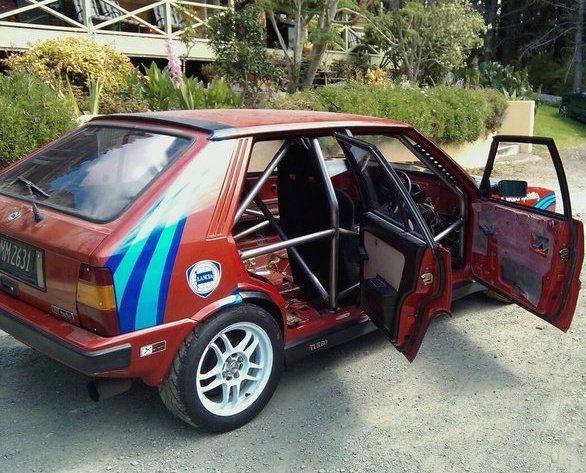

Drummer888 64 Report post Posted September 12, 2014 Hey guys, My project is a 1985 Lancia Delta HF Turbo. Purchased about 3 years ago as a stock-standard 130 flywheel hp front wheel drive carb turbo HF, i proceeded over the first year to rollcage it, have the suspension built, and upgrade the brakes. I then spent a year hillclimbing/street sprint/circuit racing it - then decided to opt for more power. Its now about 80% complete with a Fiat Croma 2 litre 8 valve injected turbo, same engine effectively as the Integrale but without balance shafts (the Group A cars never ran balance shafts in the block). Turbo is T28 from GTIR, bigger cams from N/A engine, bigger throttle body and manifold, front mount intercooler, 440cc evo injectors, Group A chip, Delta GTie gearbox, ARP rodbolts with new bearings, gated sump, HKS blow off valve, carbon-kevlar custom clutch with shot-peened lighter flywheel. Im hoping for roughly 200 - 220 wheel hp @ 950 - 980kgs when i turn the key. 14 Quote Share this post Link to post Share on other sites

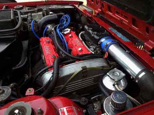

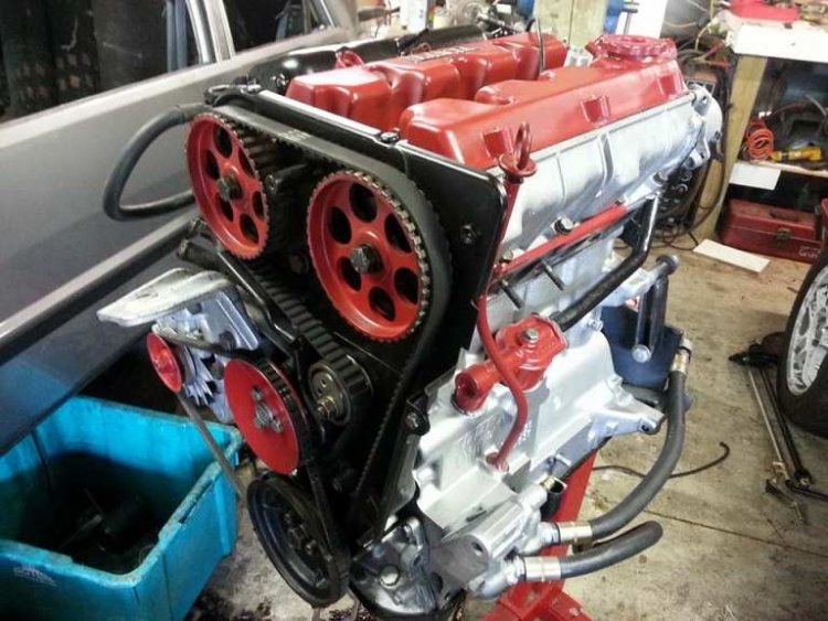

Drummer888 64 Report post Posted September 12, 2014 A couple more pics with the new engine built up and transplanted into the hole. 6 Quote Share this post Link to post Share on other sites

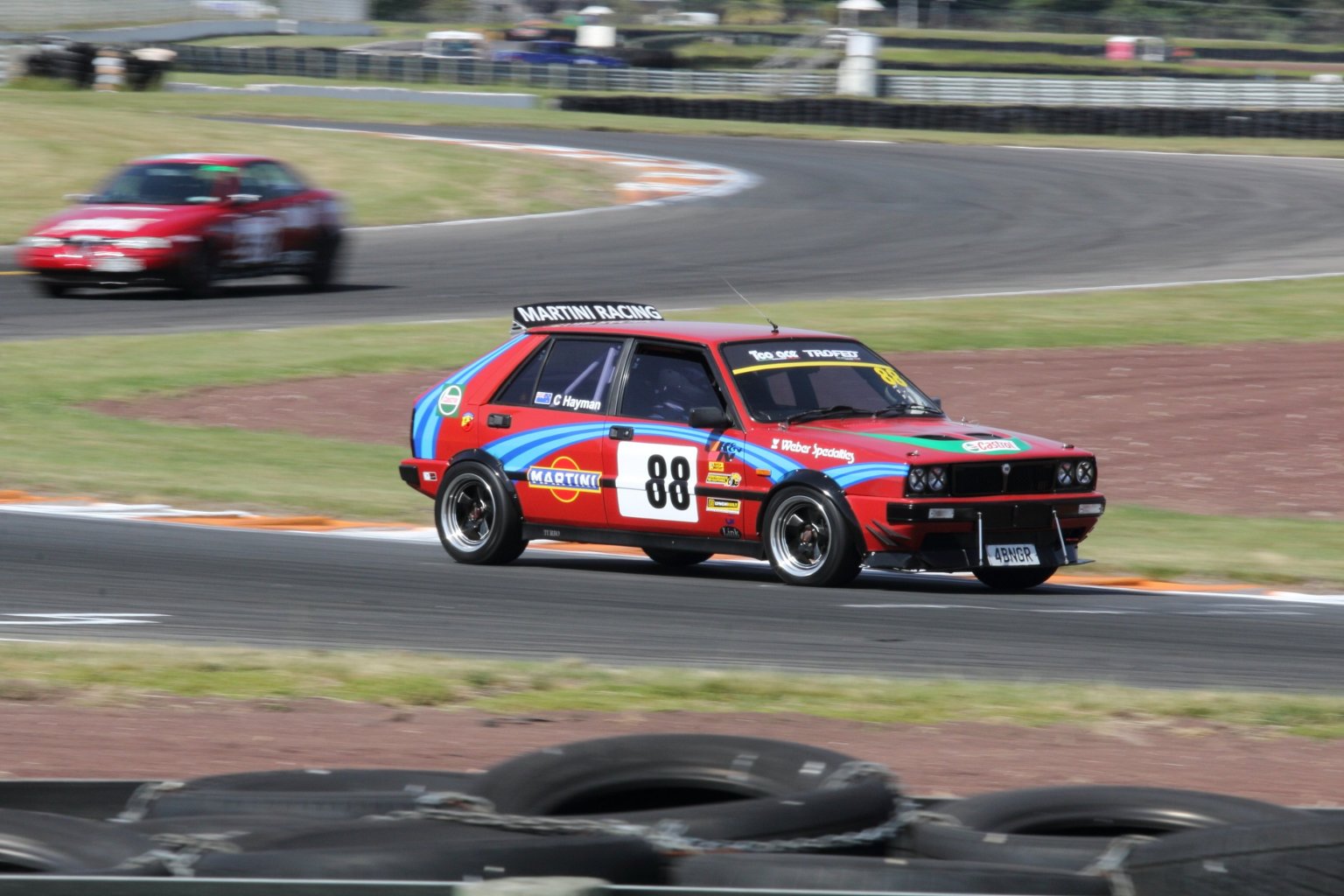

Drummer888 64 Report post Posted September 12, 2014 And last but not least, a couple of pics at Pukekohe with the 1.6 carb engine (which i had ported and polished, tweaked the boost, modified the carb, and was running 140hp @ the front treads) 5 Quote Share this post Link to post Share on other sites

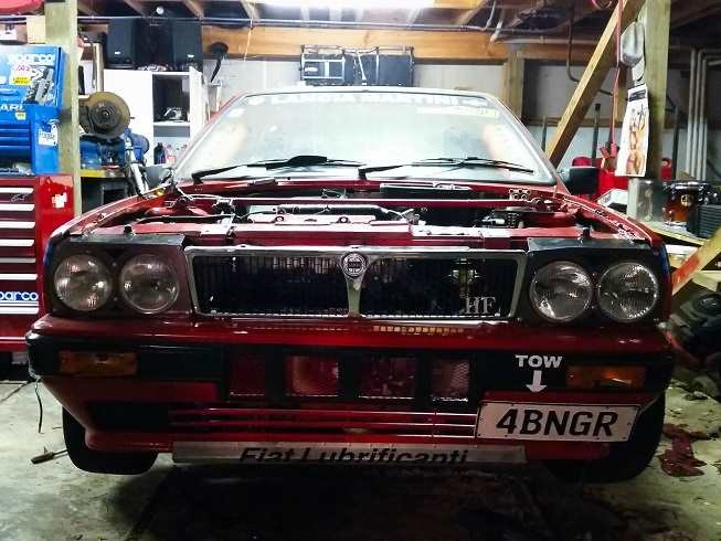

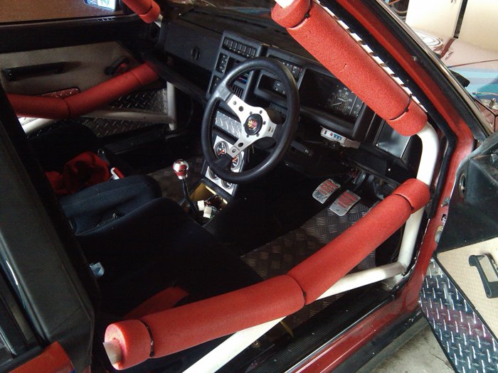

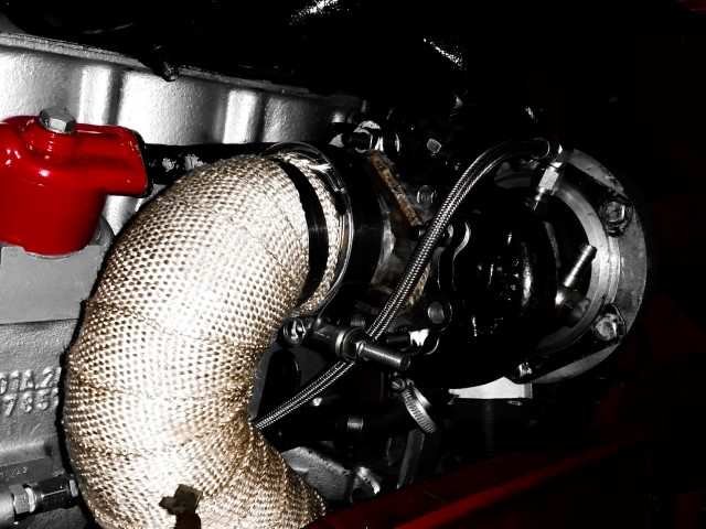

Drummer888 64 Report post Posted December 15 Haven't been on here in ages. Plenty has changed. Ended up building a forged engine, new turbo, link ECU, going to 15X8's with flares, 225 rubber, etc etc. Current tune is 240hp @ the hubs on 17psi boost, intending to do some cam timing adjustments and retune in the new year with a much higher redline and a bit more boost. A quick shakedown at Taupo first time out qualified mid pack with so many areas to. Improve, and was only running at about 70% race pace. 10 Quote Share this post Link to post Share on other sites
