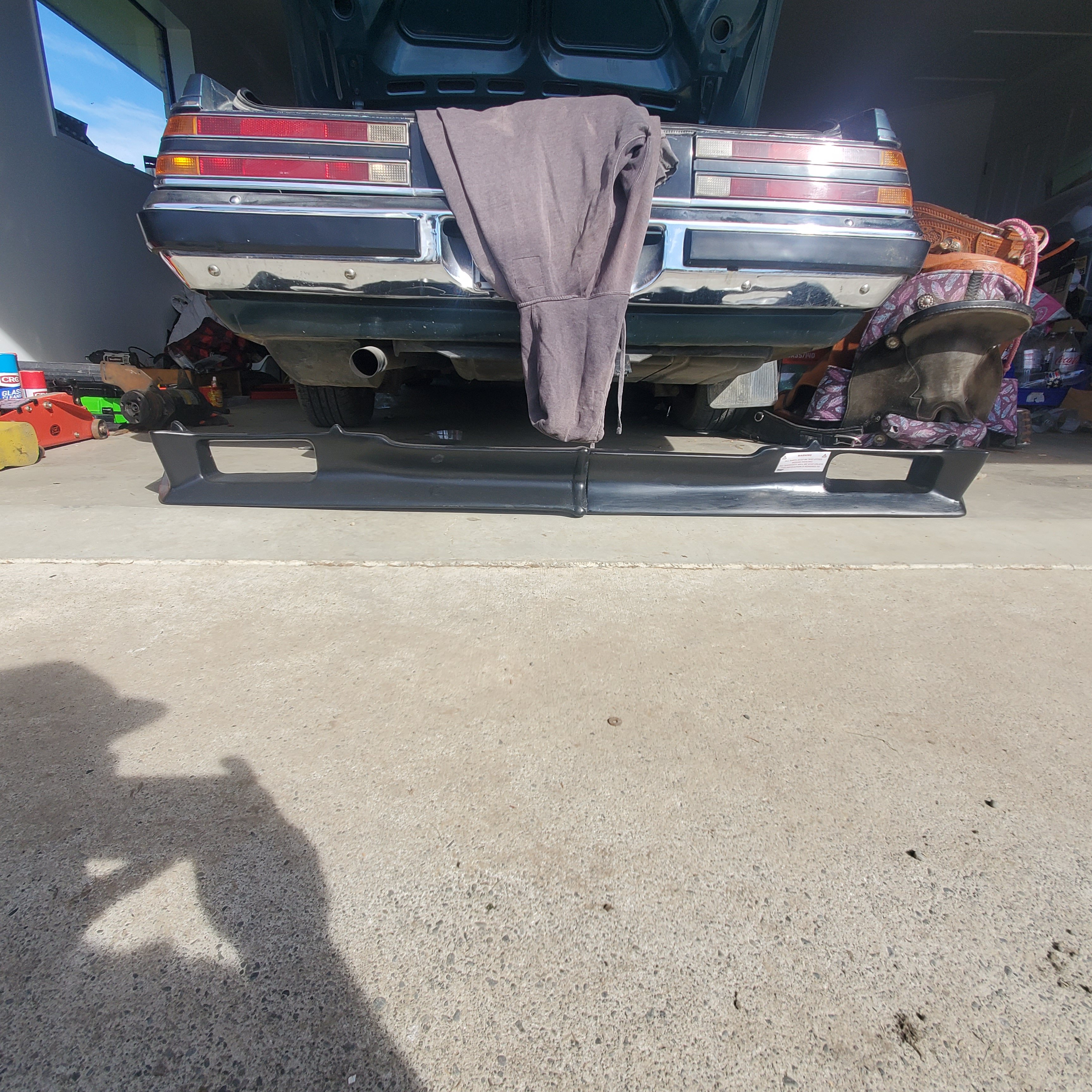

Nominal Posted April 30, 2025 Posted April 30, 2025 22 minutes ago, dr.wylde said: so had a quick moment over the Anzac weekend. didn't really achieve anything except tidying up around the garage where I keep the car , sorted and arranged tools and various other bits. one part that I bought 6 months ago that was a bit of an impulse buy , I didn't need it but I wanted it was a chin spoiler for the WB series. s am debating whether to fit some fog lights in it. what do you lot think? Isn't it supposed to go on the front? 1 1 Quote

dr.wylde Posted April 30, 2025 Posted April 30, 2025 34 minutes ago, Nominal said: Isn't it supposed to go on the front? it is , I just had it at the back of the car so I could take a snap Quote
Nominal Posted April 30, 2025 Posted April 30, 2025 58 minutes ago, dr.wylde said: it is , I just had it at the back of the car so I could take a snap I know, I was just winding you up. 1 Quote
