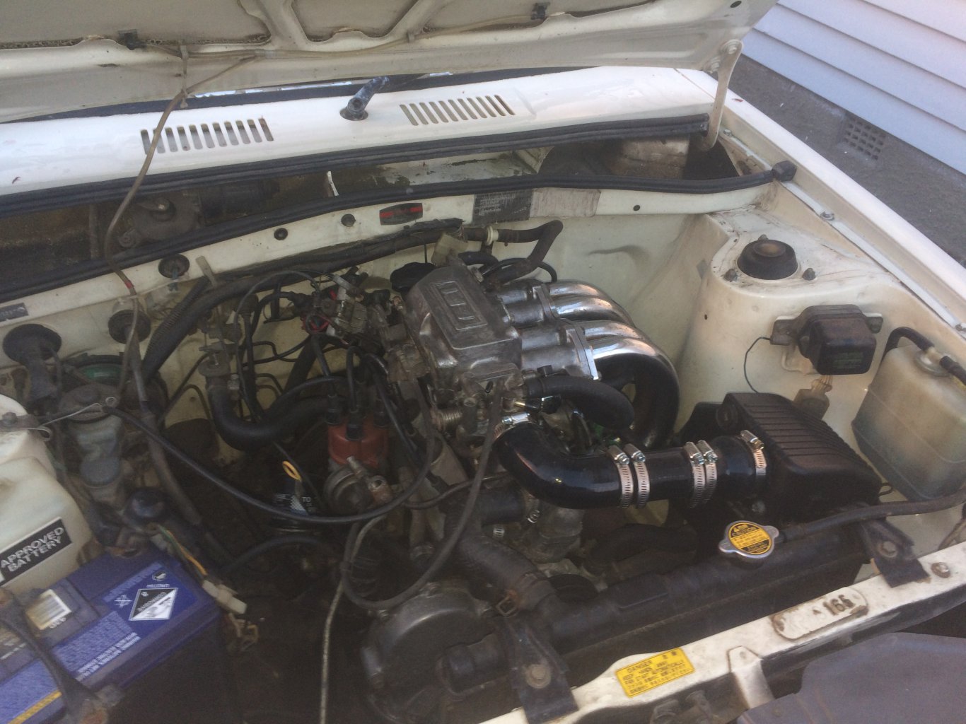

ajg193 3,458 Report post Posted September 3, 2017 So I've been accruing bits and bobs to convert this car to EFI recently. I'm currently just waiting for the ECU (microsquirt) to arrive in the mail, hopefully this will be tomorrow or the next day. I started to diddle with the car today, ripping off the carburetor/intake manifold and making the EFI stuff fit. Until I have the ECU I can still work on a fair few things, mainly the fuel plumbing. I have all the required hoses, fittings and pump so I will try get those all in place over the next few days. I'll need to make a bracket to mount the pump to existing mounting locations on the car as I don't want to drill any holes on factory bits. I also need to make up some braces to support the plenum and air intake box. I will need to swap out the lower thermostat housing for the EFI one (extra sensor, to provide temperature to ECU) and run a coolant line to the idle speed control valve. I also need to remove the mechanical fuel pump and put a blanking plate on the block, this shouldn't be too difficult. The oxygen sensor will need a hole put somewhere in the exhaust system. Most sources online say to put it about 600mm-1000mm downstream of the engine to reduce overheating of the sensor. I have a blanking plate on the exhaust manifold underneath where the carburetor would have been but I think this may be too close to the engine. Otherwise it would have been ideal to place the sensor on this plate (so as to not drill a hole in a factory component). Has anyone on here got experience with placing wideband sensors close to an engine of low power? Once I have the ECU I can do all of the wiring and hopefully have it fired up fairly quickly and then employ Jane to give me a hand tuning it. That photo makes my engine bay look disgusting... I'll have to give it a good cleaning out at some point. Hopefully I don't end up having any issues come WOF time as I don't really want to fork out another pile of money getting it certified. I'd probably end up just putting the carb back on if I have any trouble like that. 4 Share this post Link to post Share on other sites
ajg193 3,458 Report post Posted September 10, 2017 The car is now running! One week turnaround isn't too bad. I still need to make up a brace for the air cleaner and go to pick a part and get a decent MAP sensor - currently running a MPX4250AP which is sitting in the engine bay. I spent ages trying to bleed the fuel system last night, only to come to the conclusion that the tank was empty. After making a quick walk to the fuel station to get some fuel the car started right up. There were a few hickups after that but I will go over that this evening and provide more details. Here's a crappy portrait iphone video of the engine running when I first started it: 3 Share this post Link to post Share on other sites
ajg193 3,458 Report post Posted September 10, 2017 So with the help of a friend we managed to get a reasonable tune on it before the laptop battery died. It's currently running way too rich at low loads at around 3000 rpm so I'll need to deal with that next time I drive it, other than that the fuel map is pretty good now. The car runs smoother now throughout most of the map than it ever did on the carb and seems to have a little more power. The fuel pump is quite noisy though, I'll have to coat it with a silicone sock or something at some point to make it quiet. I'll need to tackle warmup enrichment over the coming week. So the remaining jobs are: - Put a permanent MAP sensor onto it, I have one now. - Make a brace to hold air cleaner in place - Tune and hoon It's amazing how much of a difference it instantly makes when someone adjusts the fuel numbers in the table, at first the car would run out of puff at about 5000 RPM and be way too rich, now it pulls happily right up to the 6000 RPM rev limiter in the gears I have tried it in. Going up a hill is great when the numbers get adjusted and it starts making power. I'll get around to a more technical post once I have had lunch/dinner/done more hooning 10 Share this post Link to post Share on other sites
ajg193 3,458 Report post Posted October 8, 2017 The guys at VTNZ were happy with the EFI system when I took it for a WoF this morning. The guy took a look at the engine, then the chassis tag, then the engine number and then scratched his head. He walked over to me and I was sure he was going to be grumpy but he just said "well done, it looks good. Good to see someone finally doing a tidy job of the wiring on a car." WoF obtained, now legal for another 6 months. I guess it's about time I put up a bit of a technical post with regards to the EFI conversion. The EFI system uses an original 4KE inlet manifold, injectors, regulator, runners, plenum, valve cover and throttle body. Most other bits were scrounged together from the internet: - TPS is from LS1 - IAT sensor is from LS1 - CLT sensor is from LS1 - MAP sensor is from a Mira - Fuel pump is Aeroflow "500 hp?" (smallest one I could find) - Air filter housing is from an EP9X Starlet - O2 sensor is Innovate LC-2 - Intake piping is 45 mm silicone hose, with a 63-45 reducer where it connects to the filter housing The ignition coil needed to be moved towards the brake booster in order to clear the EFI valve cover, looking at old brochures/documentation this appears to be the case with factory EFI Starlets also. In order to make the OEM injectors play happily with the MicroSquirt ECU I need to add some inline resistors as the injectors are low impedance (2.6 Ohm or there abouts). I ended up using 1x 10 Ohm 25 watt panel mount resistor per injector and these worked fine. I also have a stack of 8 Ohm and 4.7 Ohm resistors sitting around that I thought I would have to used if the 10 Ohm ones were too high resistance. The resistors are bolted to the panel that the ECU is mounted to. In order to make the ECU work reliably with a fuel only setup I need to replace the R20 resistor on the board with a higher power unit, so I used a 1000 Ohm, 0.5 watt resistor and this has been fine. A bead of silicone gasket goop was run around the inside of the ECU housing and the ECU was bolted to a plate which mounts directly to the existing bolts holding the radiator overflow bottle to the inner guard - the ECU is on the back side of the inner guard, above the plastic liner and seems to be in a fairly dry area that doesn't seem to have any moisture/dust issues so far. The loom runs through the existing hole in the inner guard that the indicator light wires went through. The loom is tied to existing mounting points along the chassis rail to keep it away from the exhaust manifold ( :/... long story there). The exhaust manifold for the carburetor setup has a huge hole in it for heating the bottom of the original intake manifold. This hole is now covered by a 6 mm thick aluminium plate which has been shaped to allow the intake manifold and runners to clear (well actually sit on). There were sections of the intake manifold which needed to be ground down in order to fit the manifold with the plate on the exhaust manifold but there is still enough thickness remaining that cracking shouldn't be an issue. The O2 sensor is placed in the exhaust system at the final collector, at an angle of about 35 degrees from the horizontal and has quick response. For the fuel line setup, I just put a brass T into the line at the tank, with one branch going to the old feed line (4.5 mm now return), one branch going to the fuel pump (8 mm) and the remaining branch going to the tank (5.5 mm hole). The high pressure fuel line from the pump is just a soft line, following the existing fuel line and using the existing brackets where possible (from OEM there is space for extra lines). I run the power feed lines to the pump alongside the fuel lines. The fuel pump is mounted to the chassis using an Integra fuel pump bracket and a piece of angle iron. The Integra bracket has a rubber isolation mount where the pump goes into it so there isn't too much vibration - the pump is still quite loud though so I might cover it with some silicone hose to try and damp the sounds. The pump bracket mounts between the tow bar and chassis using the original fuel tank strap. There is currently no baffling in the tank, I may look into it in the future - but I haven't had any issues yet in the 1,000+ km I have driven it. The fuel filter is a Ryco Z200 unit and fits perfectly into the original fuel filter mount in the engine bay and has barbed fittings on each end so it was simple to install. The fuel pump is running through a 20 Amp fuse, all of the injectors are running through a single 5 Amp fuse, the O2 sensor is running through a 5 Amp fuse, the ECU is also running through a 5 Amp fuse. The factory idle speed control valve seems to be a bit out of specification and doesn't open up far enough when cold - which required using foot throttle to keep it idling for the first 10 seconds or so. I bypassed the idle valve by using a heater control valve connected to the choke cable - giving easy manual control of the idle / cruise control. One day I will look into either modifying the factory valve to get more flow when cold or I will install an electrically controlled unit ($$). But for now I am happy using the choke cable when cold. I needed to make up some support braces for the intake plenum and air filter housing. The brace for the air filter housing connects to the alternator bracket, the exhaust manifold and two points on the filter housing. The two braces for the intake plenum are just simple flat bar which has been bent to shape and connect the plenum to the engine block at the OEM locations. At first I only had a brace on the front of the plenum to the engine block but there was a horrid vibration at around 4,000 - 4,200 rpm. Adding the second brace fixed this vibration. I was initially having issues with the IAT sensor heat soaking and leaning out the idle, causing the car to stall. This was fixed by changing the settings in the ECU so it completely ignores IAT at idle just uses the coolant temperature as estimated inlet temperature. All in all, the only hole that needed to be drilled in the car was for the O2 sensor to go into the exhaust, other than that everything was OE Toyota or fabricated to fit with the original holes and mounting locations. The engine definitely has more power now compared to with the carburetor, with a lot more torque around the 3000 rpm area. The engine also runs much smoother and is much more responsive to throttle inputs - no more slight stuttering during rapid transitions. The engine does seem to be a bit easier to stall though, but I'm sure this is just something to do with the VE map not being very well tuned in the <800 rpm region. The Auto Tune feature of TunerStudioMS is an absolute champ, all you have to do is define a target AFR table and let it do its thing (as well as setting up some sensible filters). Auto tuning makes it really easy to fiddle with settings such as IAT control or your actual physical setup. Two to three minutes of driving and it has pretty well returned the tune to near perfect, a feature definitely worth the money. I'd also recommend getting an inverter or something so that you can power your tuning laptop for more than an hour or two while driving. I'd be interested to throw it onto a dyno at some point to see exactly what it is putting to the ground. Does anyone know of someone with a cheap to use dyno around Christchurch? (Only really need to do one run). One of the next jobs on the car will be to look into getting the radiator recored as the fins on this one are starting to rot off and I don't really want to risk cooking the engine. I'll also look into getting the last of the rust dealt with at some point (little spot under the hatch window seal). I may throw some pretty graphs of the VE tables and other logs up tonight when I get home. 12 Share this post Link to post Share on other sites
