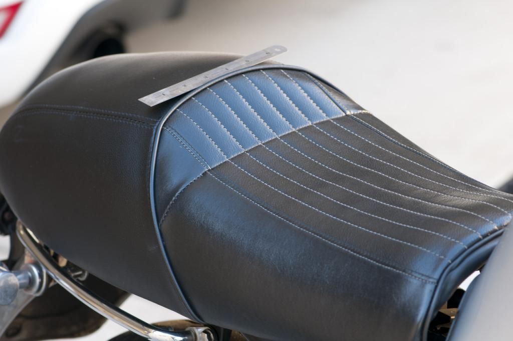

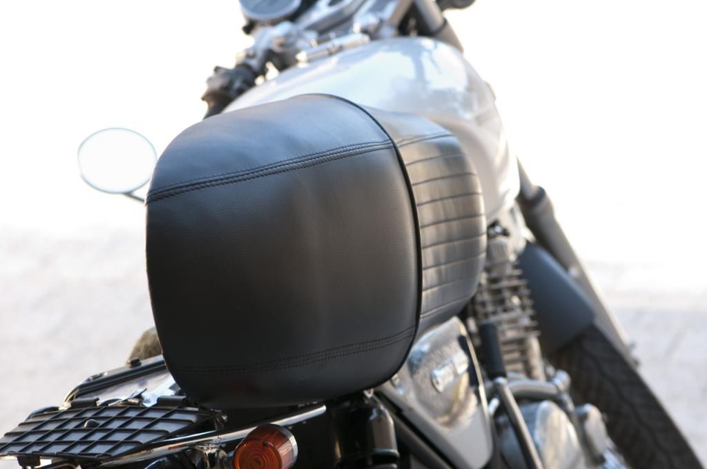

crispymk2 313 Report post Posted June 6, 2014 Hey mate, looks like it is definitely a stock GB500 solo seat that they have re-shaped the hump on to be more two-up friendly. 28 inches long, hump is 7-ish inches high at its peak and the humped section makes up the rear 16-ish inches Photos of seat: Only thing I don't like is they should have used higher density foam for the hump as it is a little lumpy just as it crosses over the built-in storage section. Quote Share this post Link to post Share on other sites

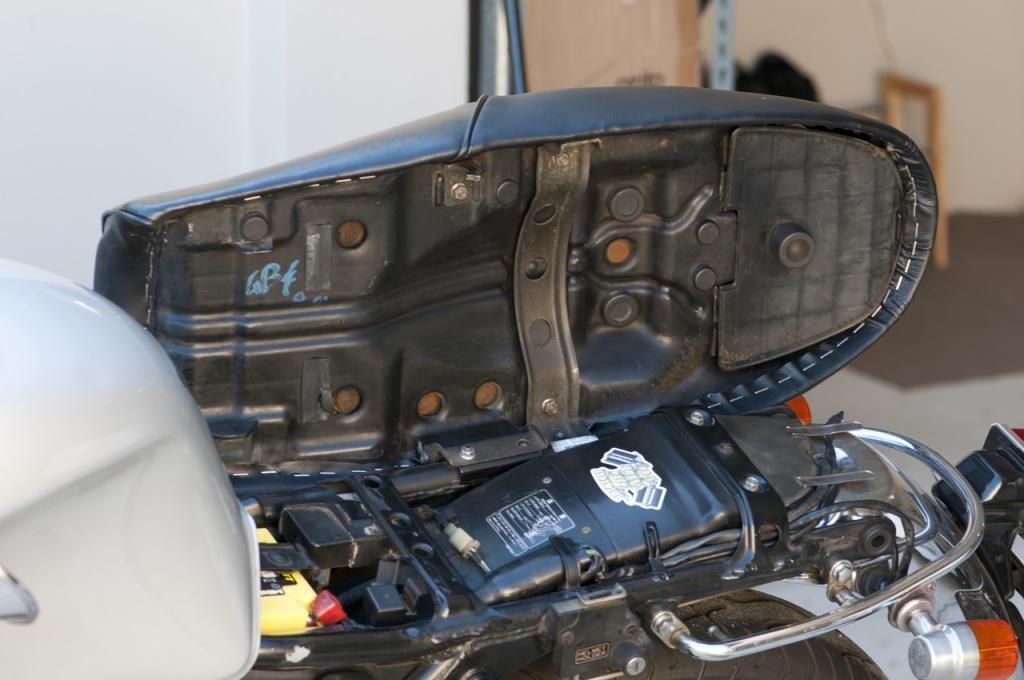

fivehunnit 2 Report post Posted June 10, 2014 Excellent pics — Thank you. From what I'm gathering with your photos, and some other research, is that your seat is actually not a stock GB500 single-seat. It is definitely a stock GB400 seat judging from the original mounting hinge and the functioning latch, but I feel like it could've been a single or dual. The 500 single-seat has a much larger hollow area underneath the hump. This area is so deep that it covers a larger frame-mounted tool box and is impossible to flatten out and re-shape into a dual-seat or shallow hump single-seat. (which is the problem I have) The 400 seat has a much shallower hollow area. This area appears to hold a small strap-on tool bag in it's underside that has some sort of pop-off lid. This area appears shallow enough to be re-shaped for a dual-seat or shallow hump single-seat. (what you have) Now I just need to find a pan like yours and I can re-shape... thanks for the help. Old pic of my 500, with seat open: 1 Quote Share this post Link to post Share on other sites

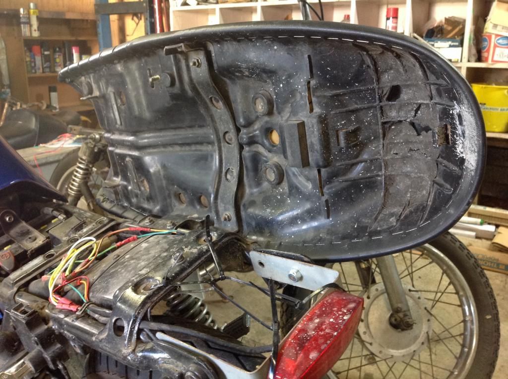

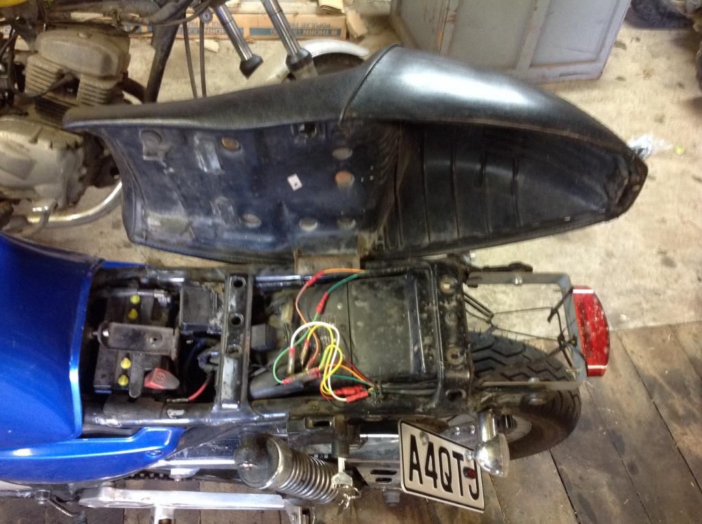

Duke Blackwood 256 Report post Posted July 3, 2014 So this is the bottom of a standard single seat (GB400 or 500) And this, the base of the standard two seater (again, 400 & 500) Modifying this was soooo cheap and easy. Crispy your bike is awesome! How fast does it go? Anglia4 recently got 128 indicated outta mine which is probably more like 135!? Quote Share this post Link to post Share on other sites
