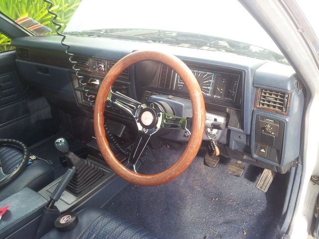

Beaver Posted April 17, 2016 Posted April 17, 2016 slow progress is slow. new wheel installed, more wood. i love wood. Turns out the new bosskit didnt have the doohickys for cancelling the indicators, so grabbed the back plastics from a nissan wheel at pickapart and cut out the doohicky and glued/epoxied to the bosskit. Should do the trick. also had a nosey at the rear end (gigidy gigidy) for ordering lowering blocks. Have some u bolts left over from something that will work a treat, perfect size. Starting to look for wheels as well, looking at 15x7 or 7.5 with around zero offset. Will fit nicely without having to fuck with guards. will run something like a 195/50 tyre. discussion //oldschool.co.nz/index.php?/topic/41006-beavers-87-gloria-wagon/page-4 8 Quote

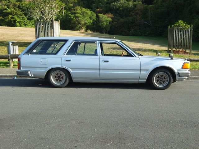

Popular Post Beaver Posted May 1, 2016 Popular Post Posted May 1, 2016 Here is a photo of a not so jacked gloria wagon. 50mm blocks in the back and kawasaki special springs up front. sills are pretty much spot on level but looks whack as front guard opening is so big. would like the front a touch lower at some point but this will do for now. Next is wheels, either 15s or 16s to help fill the guards. not much room in the back so wont be anything cray cray //oldschool.co.nz/index.php?/topic/41006-beavers-87-gloria-wagon/page-6 23 Quote

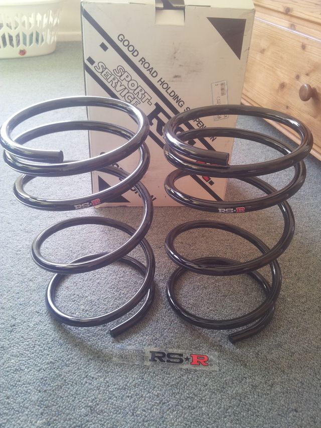

Beaver Posted May 17, 2016 Posted May 17, 2016 Overnight parts from japan (well not really), 20/30 mm lowering springs Chucked them in tonight, looks to sits about the same as before but should settle a bit so will recheck in a few weeks and trim to suit. they have an extra flat wind/are somewhat progressive so will be a much nicer fit even when trimmed. 4 Quote

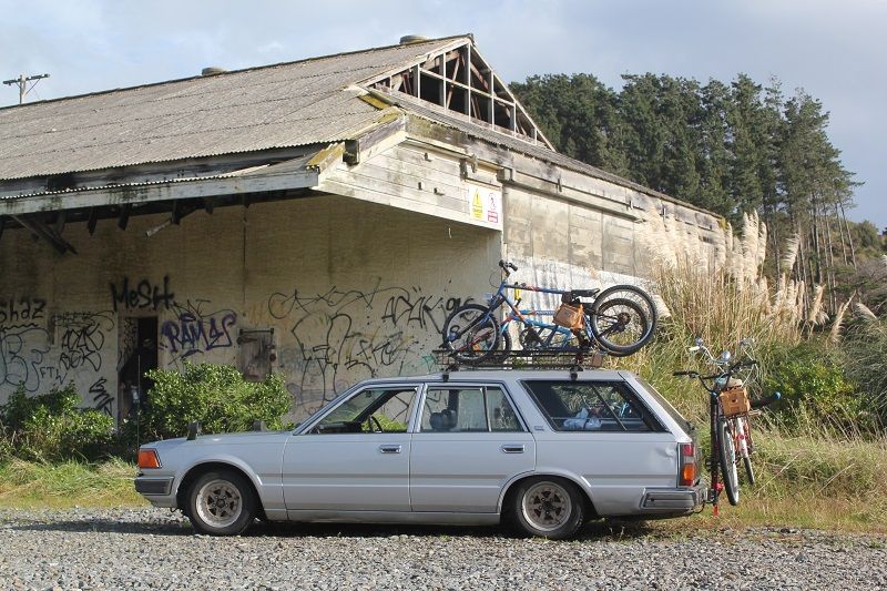

Beaver Posted June 28, 2016 Posted June 28, 2016 Went to BIke Summit. Loaded bikes and people in, on and around the car. Such a packhorse. 5 bikes, 3 sexy men and a sexy lady. 8 Quote

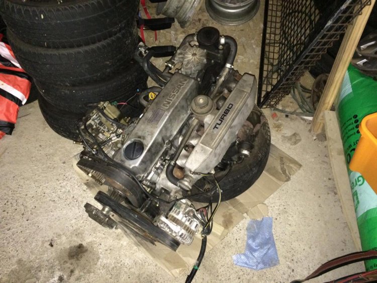

Beaver Posted August 4, 2016 Posted August 4, 2016 Nearly Hanmer time which means another sick roady brah/wag lyfe. Needs a wof but should be sweet (Aye Rog....) In the meantime, I bought a turbo. Actually four of them. Steve will be proud. Need a good clean up/scotchpad polish and repaint but they were dirt cheap. Wonder if they will fit.... Abuse //oldschool.co.nz/index.php?/topic/41006-beavers-87-gloria-wagon/page-7 8 Quote
Beaver Posted October 18, 2016 Posted October 18, 2016 Oh yeh, Hanmer was rad. (PS Ive figured out how to make it not do this anymore) Much like Al's mum, this thing loves the abuse and keeps on trucking. Was meant to bid on a low km RD28 on tradme the otherday but forgot and it sold for $200 which pissed me off. Woudl be nice to not smoke so much (blue smoke, yum). Test fitted turbos, look like it will be mint, just need some tyres. 9 Quote
