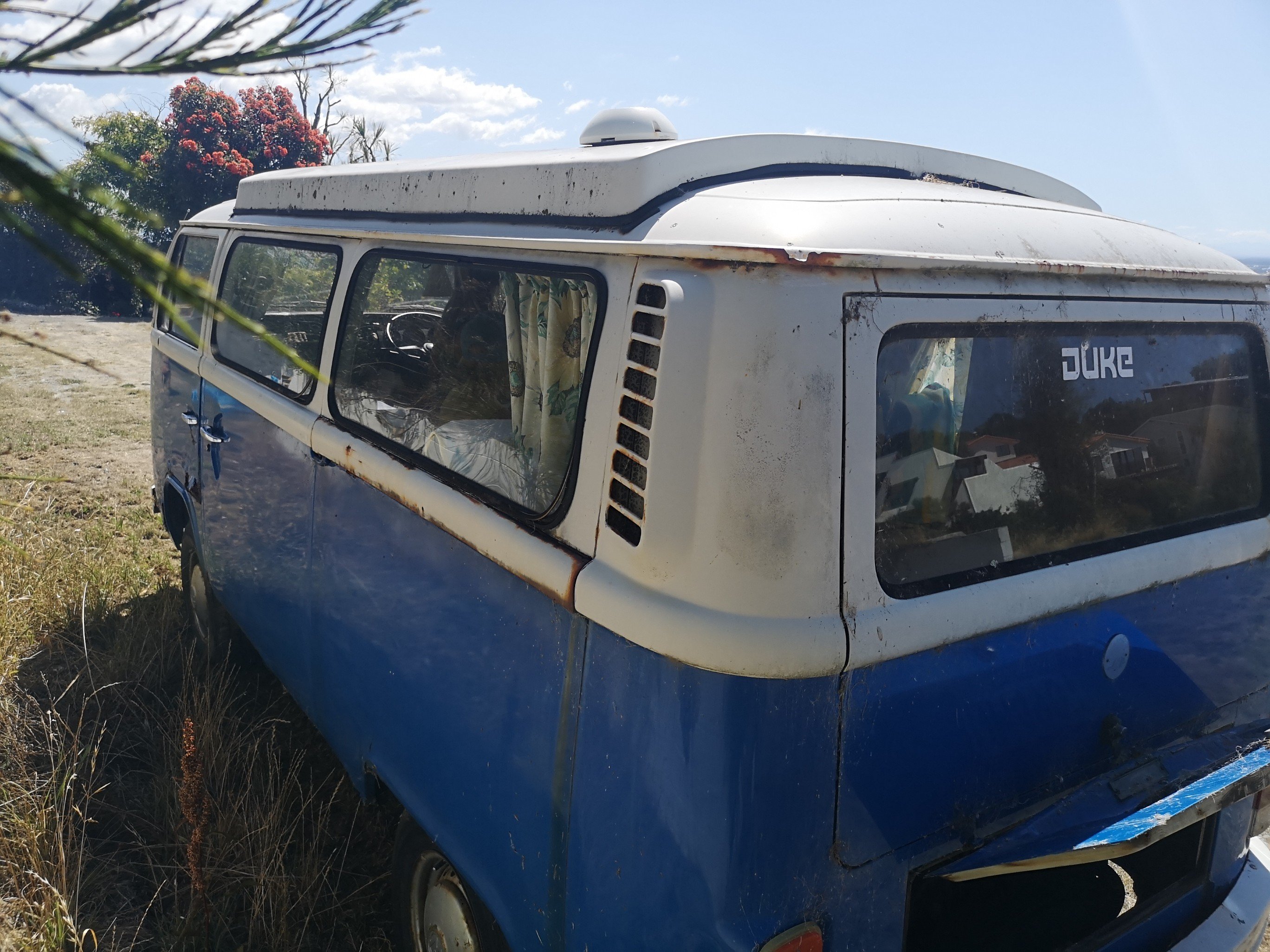

Popular Post yetchh Posted February 23, 2020 Author Popular Post Posted February 23, 2020 Well.... 6 years have passed and I've done totally fuck all to this besides drive from brotown to up in a far less corrosive environment on a section in Mt pleasant and then watch it fall into total disrepair. Needs a fair amount of rust cut out to make it road worthy again, and of course mechanical repairs. Have mate doing the body repairs as I have zero time to give it but went up there this arvo to try and move out from its resting place for the last 3 yrs. Bit of gas down the carb and a jump and it fired right up then died while it tried to prime the carb so three attempts and of it went. Took a bit to get it to move as one of the rear tyres was totally flat but again, once I managed to roll it over it propelled itself along as good as it could.. even idled after it warmed up.. Amaze Some pics... 16 Quote

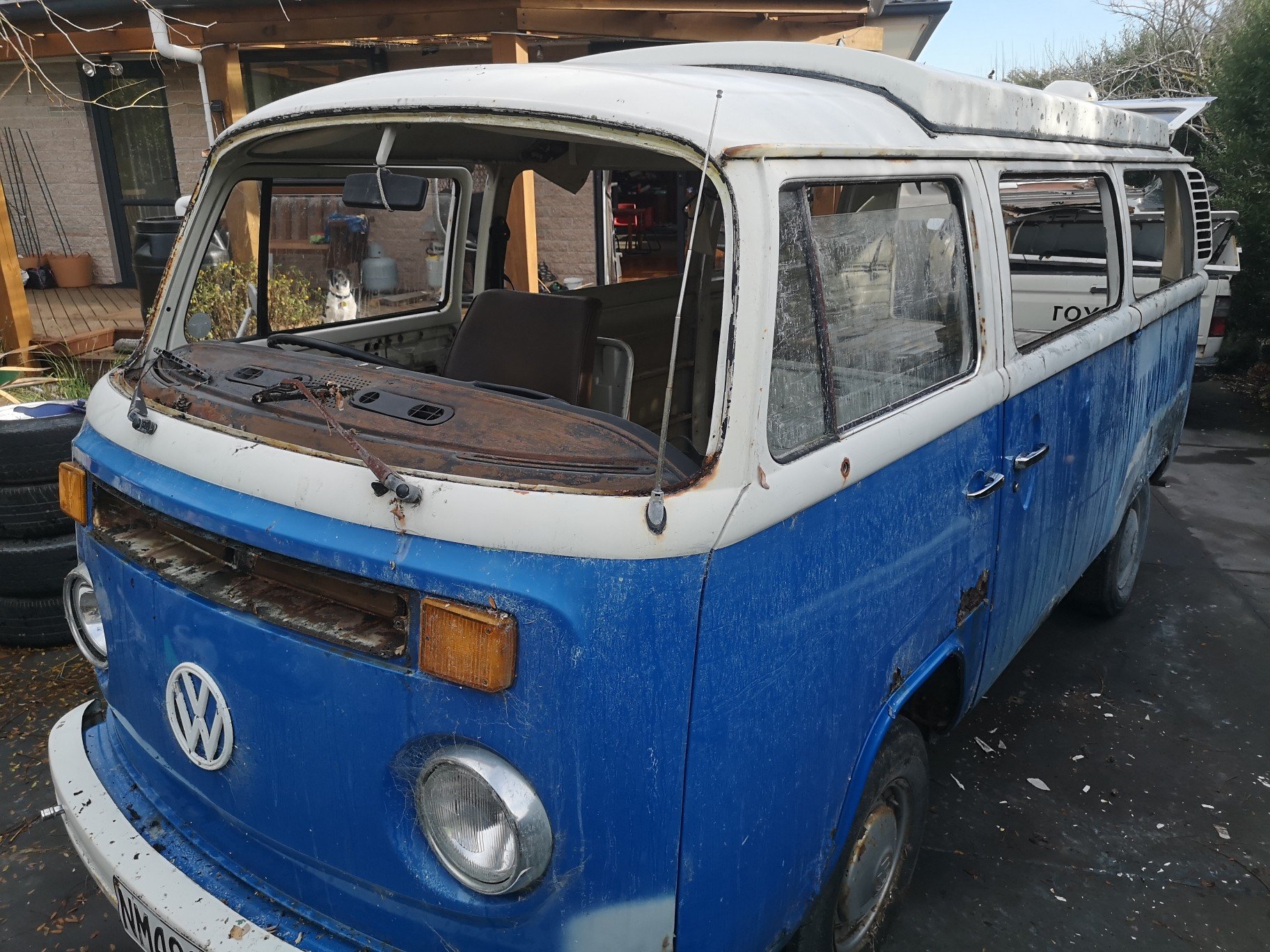

Popular Post yetchh Posted February 23, 2020 Author Popular Post Posted February 23, 2020 As you can see it needs a bit of work. As my dad passed last year and this was at one point his pride and joy we collectively pulled finger and decided to get on with its restoration in his memory.. 30 Quote

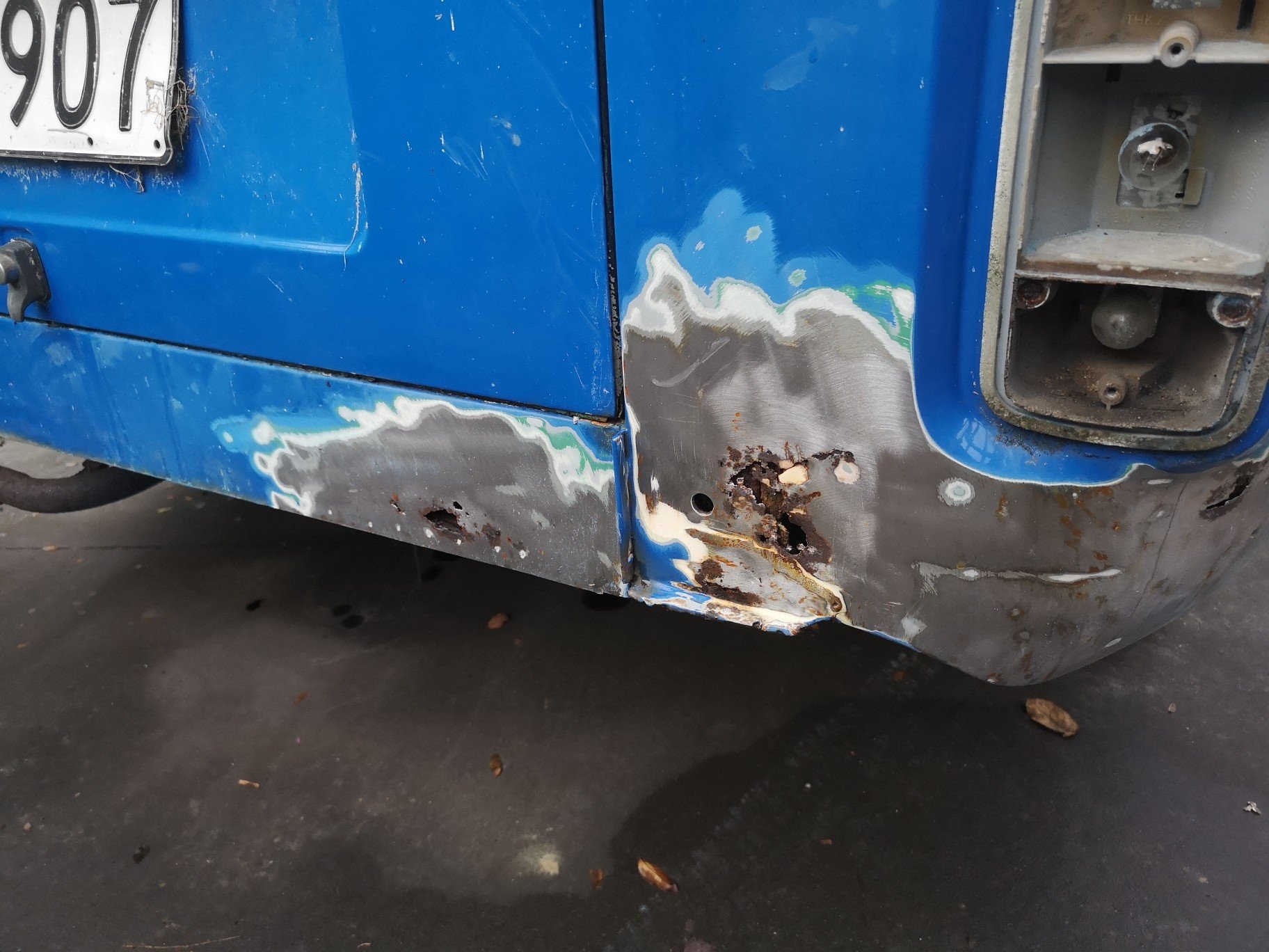

yetchh Posted June 7, 2020 Author Posted June 7, 2020 Pic dump..... Window seals have been leaking pretty much everywhere, Although I think this bit of rust is front the vent.. I think this floor has been rusting for a few years before it was parked up, its spent a long time outside in Brighton. 6 Quote
Popular Post yetchh Posted June 7, 2020 Author Popular Post Posted June 7, 2020 Windows pretty much fell out, (one did and it slipped through my fingers onto the concrete, somehow it didn't break) Its mostly pretty good except for the bottom corners of the front wondow, def needs new seals tho. Can also see where my sis side swiped a courier on the pass rear arch, can see above where Chris pulled it out somewhat. All fit on the back of my ute to be stashed under my house for now (along with tons of other shit) Not sure what to do about the motor, do I bother getting to see if the beetle motor runs or just rebarrel this one as it's the matching numbers engine, then rebuild the the beetle one and sell it for max profit.. Quite keen to get a twin carb kit for 3 more hp. 11 Quote

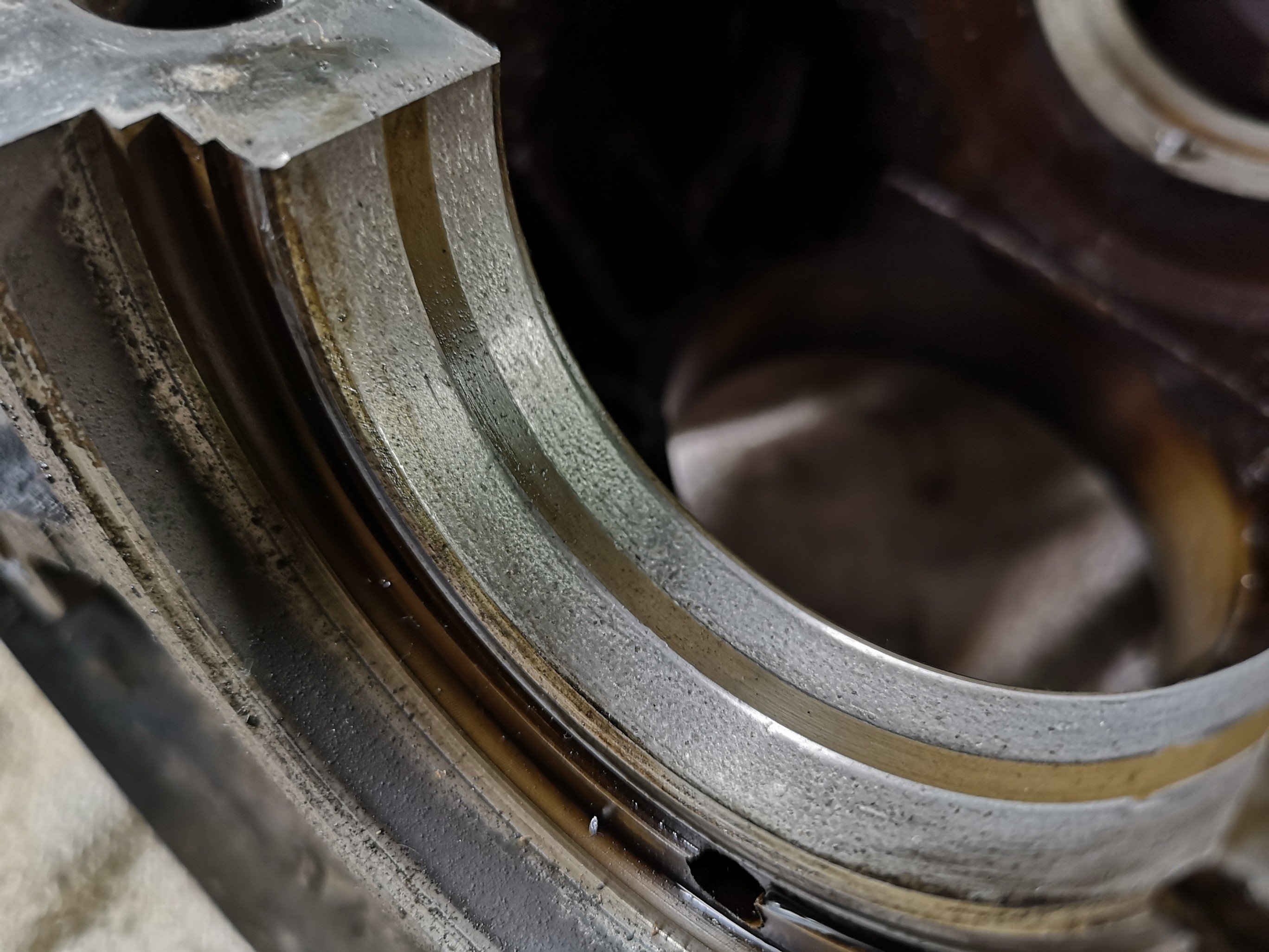

yetchh Posted July 7, 2020 Author Posted July 7, 2020 So much for a quick rebuild.... Split the case today, came apart with little to no effort. Didn't take a pic of the bearings, but had definitely had some shit through them. Crank journals are surprisingly ok.. could prob just get away with a polish, but I'm getting a new one anyway. Definitely some wear in the tunnel tho, took it in to car aid at lunch time to get it line bored and barrels fitted. These aren't the bearing faces by the way Gonna get spendy real quick. 6 4 Quote
