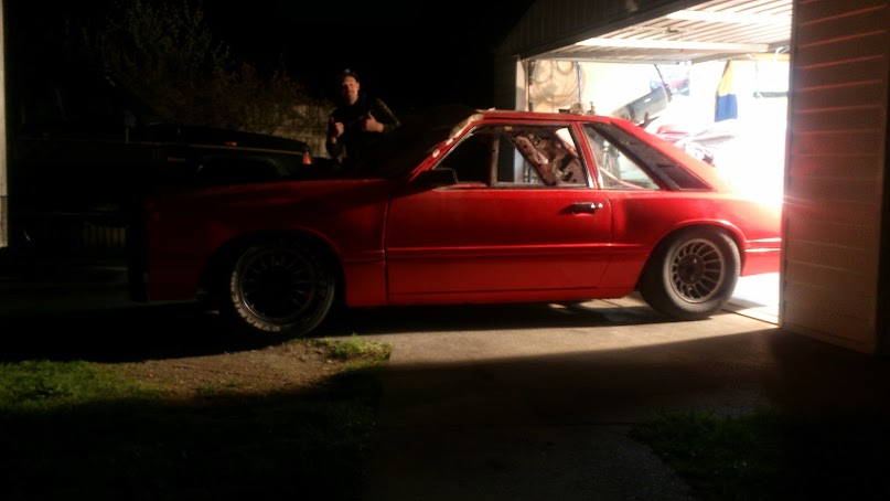

Testament 8,182 Report post Posted April 8, 2015 got 10's but 255/60/15 would not fit maori boys at the tyre shop told me they could jump through the gap between the bead and the rim so will keep eye out for some 26x10.5's or 275/50/15s I got 8s as well though so I got them put on those haven't cut the tubs yet (it is imminent) but I could shove it this far, maybe has 10mm left to the top of the wheel tub but fouling on some other junk (which is gonna get cut out anyway) will probably be sitting axle housing on frame rail at this height then tried a 235/60/14 definitely C Notch time 23 Quote Share this post Link to post Share on other sites
