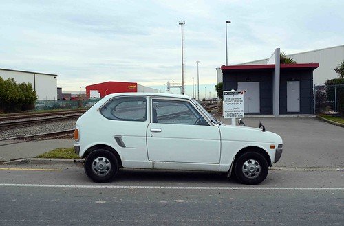

Now a while ago, when the Max was parked, a guy bangs on the door and says, I have one, want parts? I chase him down, work out who owns the car (it's been given away, reclaimed, stored on a farm, etc). I call the guy who owned / owns it, and he decides later he'll give it to me for just a lamb roast. GC! I go and meet Aaron, deliver the not-so-smallgoods, co-ordinate with the farmer, and tow it to a (new) mechanic this week.
http://img96.imageshack.us/img96/7653/360donor.jpg
Today I score some Danish pastries as a bribe, head out to disembowel the donor. Trial run: fit battery, connect starter. Weak spark; clean the points, a couple of litres fuel, a few big squirts of ether, and fire it up. Win! No silencer, sounds like some bratty rotary. Smoke. Lots of smoke. I spend the rest of the day pulling the motor and gearbox.
