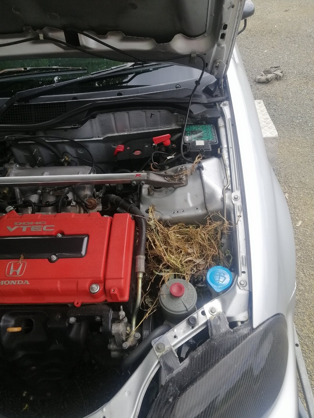

mjrstar Posted May 19, 2025 Posted May 19, 2025 I run a shorai, in my car it's situated under where your wiper motor is. Ignore the birds nest that's an optional extra you probably don't want. 1 6 Quote

mjrstar Posted May 19, 2025 Posted May 19, 2025 The reason I run a shorai is a guy at work was throwing it out because it was "no good" also the battery he replaced it with was also no good so that piqued my interest. There are probably better /cheaper options than that. I bought a proper shorai battery management charger thing that plugs into the port which I have never needed. 4 Quote

yoeddynz Posted May 30, 2025 Author Posted May 30, 2025 On 19/05/2025 at 12:01, mjrstar said: Is that a Mugen nest? 2 1 Quote
yoeddynz Posted May 30, 2025 Author Posted May 30, 2025 Just for the record. I put the battery in the front of my Imp because it's about the weight of one standard bag of 'handling improver' concrete. 6 Quote
mjrstar Posted May 30, 2025 Posted May 30, 2025 43 minutes ago, yoeddynz said: Is that a Mugen nest? Could be, whatever it was it worked fast, wasn't there the night before and had appeared by the morning. Plus the car was in tow back from an event in taranaki for a portion of that time. 1 Quote
