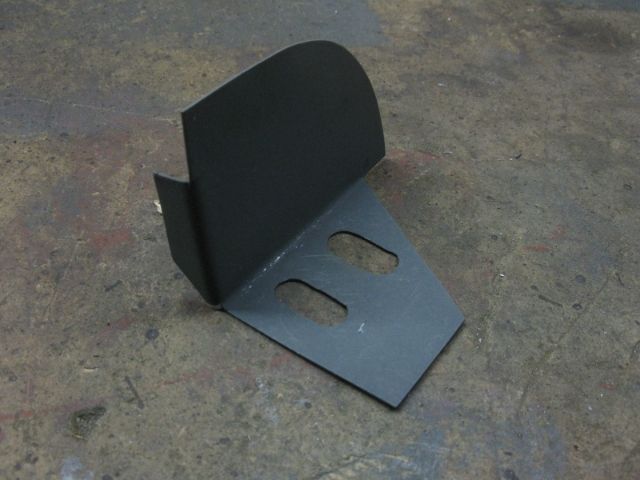

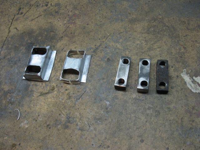

this is the end cap thing for the front of the heater channel

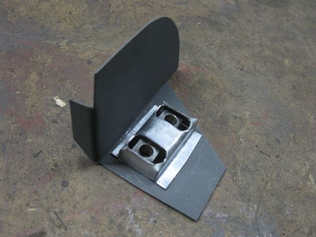

these hold the nut plate things in place inside the channels, the second one I made was a much better design.
and goes together like this.
The old nut plate(is that even what they're called?) where badly pitted so I had the guys across the road knock me up some new ones.

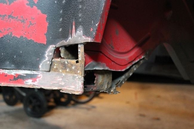

As well as the channel end, I had to replace the flange where the wheelwell meets the panel under the rear seat.
Feels good to have another corner solid.

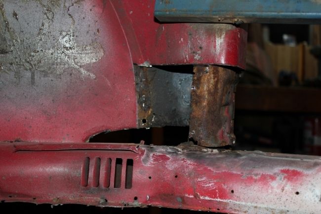

Got the rest of the bottom plate off the heater channel.
some funking looking whiteish decay in there.
small batch on the rear of the sill, was all pin holed.
Larger patch up front.
I think I've got making those little dents down now.

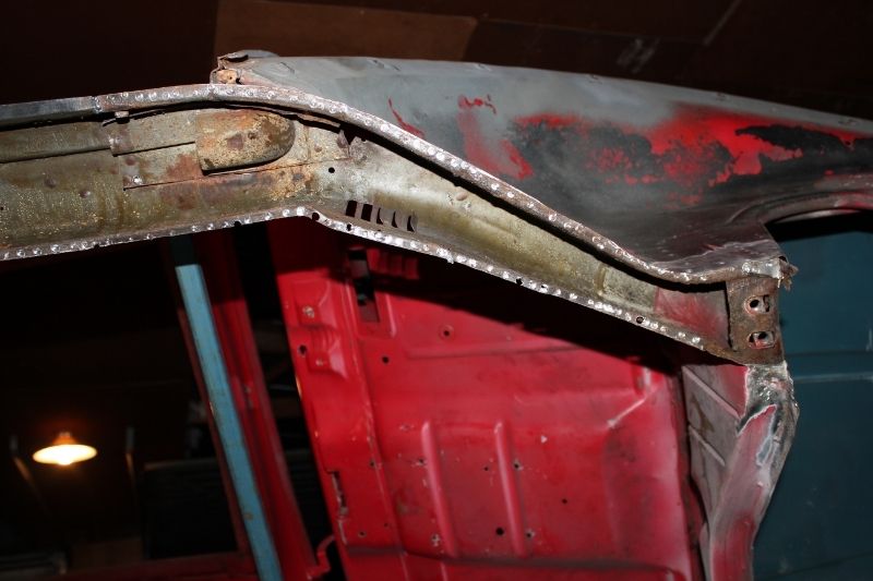

When we last saw our intrepid hero he had welded up the rear strengthening panel and had cut the other end of the channel and the A pillar open.
Well I don't have a photo but the rear panel is welded back in place and looks just like the other side now, I then chopped even more of the rot out and last week sandblasted the lot.
front
side
inside
the bottom lip on the front of the channel there was not as shot as the passenger side, so I decided to keep it and try to weld up the small pinholes caused but rust pits and some idiot with a spot weld drill(me).

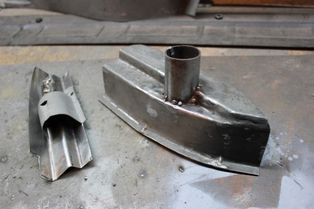

just finished welding up the heat pipe last night, while I had the blaster out I cleaned up the air scoop that goes inside the channel, and bent up the inside panel that it mounts to. Just need to smooth the welds on the heat pipe out and weld into the channel, was hoping to have it done this week but i kinda forgot about the heater pipe things.
Chur
And done.
smoothed out nice.
no one will ever know!

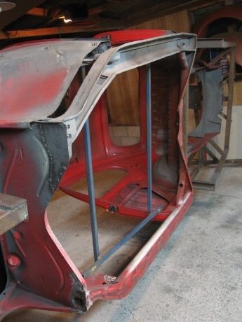

next up I started finishing up the panel I had roughed up months ago when I first cut this side open.
mocking up er'thang, Door to panel to fender to running board to door to....
With the extra weight of the door and fenders on one side, I have to prop the stand up with my chair. icon_lol.gif

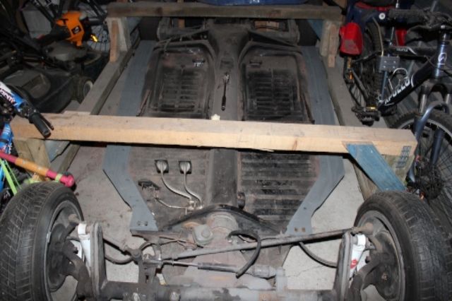

dug the pan out from it's resting place, heater channel bottoms bolted on.
IMG_0923_zps1dldbrnc.jpg?t=1445813625
enlisted 8 year old to paint the insides of the channels with rust kill paint, will be flooded with more paint and fishoil once done.
also to help in lining up the two halfs, I got a couple nice long bolts that fit the four front floating nuts, cut the heads off them and cut them in half, then screwed them into the floating nut things, this made placing the shell a little easier.
nearly ready to go, I took the shell off the spit first myself, lowered it onto the wooden frame.
then a couple of my awesome neighbours helped lift it onto the pan.
WOW! been a long time, been a long time!
icon_surprised.gif icon_eek.gif icon_cool.gif icon_twisted.gif icon_biggrin.gif icon_smile.gif icon_biggrin.gif icon_biggrin.gif icon_smile.gif icon_smile.gif
Oh joy!
had to do a little mocking up!
the 8 year old looking pretty pleased, and so am I, everything lines up, nothing seems twisted or bent, fucking win!
