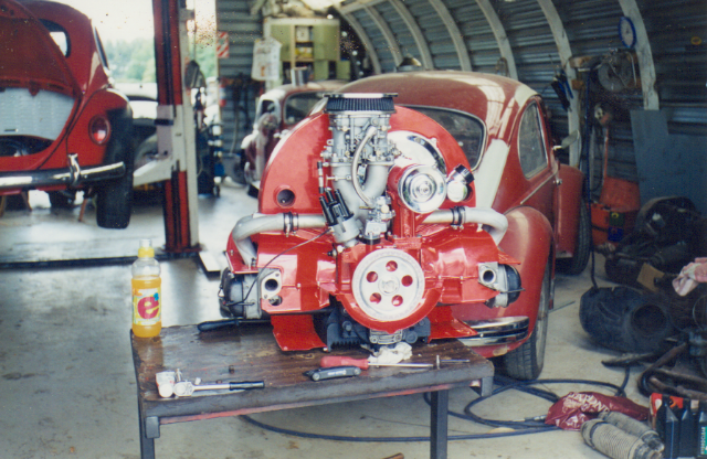

and this is the new engine being installed by my brother and myself at the VW shoppe in Hamilton.

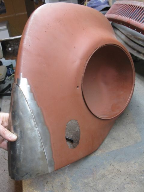

got the fender looking like a fender
needs a good smashing with the hammers and dollys
lit this so you can see the wonkyness, i have since spent some time time hammering it, and it looks much better.
( no pic of that yet)
happy with the overall shape

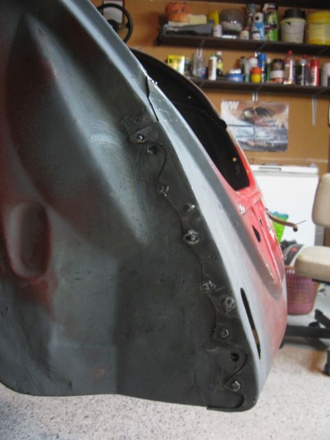

I've pulled it all apart again, took about 5mins, and nearly finished welding the valance back on.

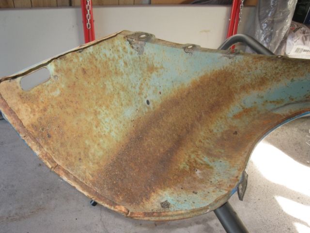

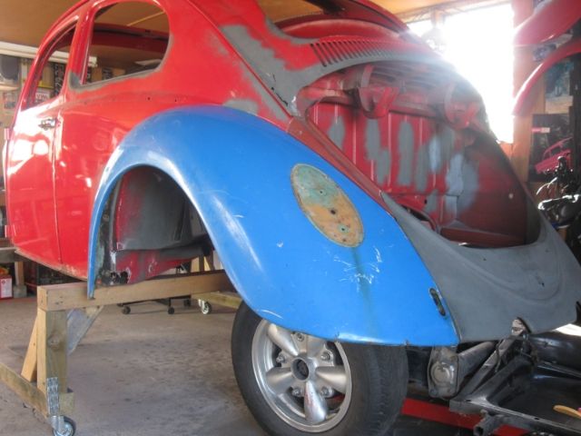

While I've been working on the front fenders, I've also been thinking about the rear fenders. The left one I had is a awful pattern panel that was about an inch to long where it matches the valance, was a stupid shape and the tail light (both actually) were on a angle. So I got this lovely old thing off the veedub shoppe in hamilton, Solid OG fender, Me happy.
someone had painted over the factory paint with this lovely BLUE!
Just two cracks in the bottom edge, which should weld up sweet.

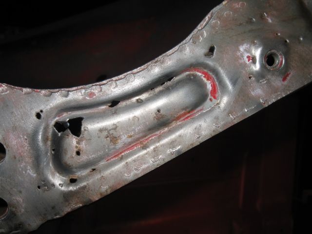

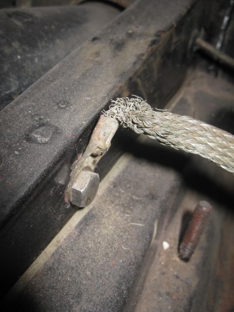

Also found this while looking at my pan
wonder if that's why the electic's sucked on this thing?

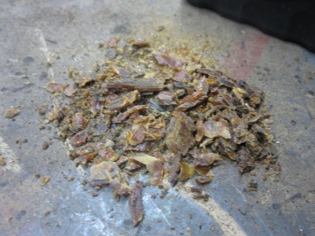

luck for me everything was caked in fish oil, so is pretty solid.
I scrapped some of it off, it's like wax, but it has done it's job well.

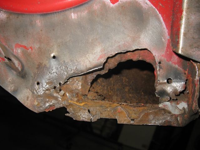

first real good look inside the channel
this is the state of the metal on the inside of that part i cut out

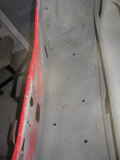

Carrying on from the last post, spotwelds! what fun! meters and meters of fun, stuck together every 10=5mm apart. holy shit thats alot of spotwelds!
These ones where not so bad, this is the outside edge of the channel, where the running board attaches.
the inside edge however!
was a fucking bastard of a thing, I don't think there was enough room to get the spotwelder in like the other side, it was really stuck.
and some where invisible, and then someone had double tapped these ones.
Like I said such fun! The trick I found that worked good for me, was to drink quite heavily while doing this mind numbing work and listen to very loud heavy metal or punk, Motorhead, bad religon etc...
And before you know it the week is finished and victory is yours!

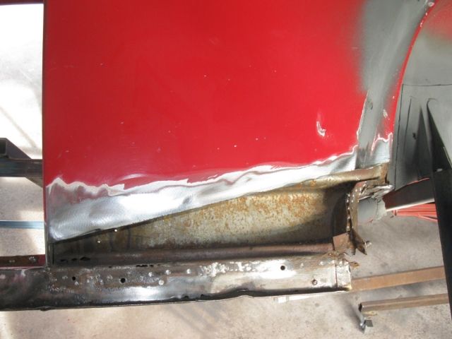

this is going to take some thunking.
another double layer for strength/rust. There was also a scoop that attaches to the hole, it pretty much fell out.
rear end of the channel,
Ones I've seen overseas/online have a second pipe running inside the sill, you will notice the lack of any kind of heater pipe inside this channel, wonder if this an aussie car thing?
trimmed abit more from the front wheelwell to get a better look, hmmmmmmm.
I think I'll start at the back and work forwards, give myself some time to think what to do next, any help would be greatly appreciated, I have no idea right now/suss it as I go.
Any sane person would replace the whole thing, but to be honest that scares the crap outta me!

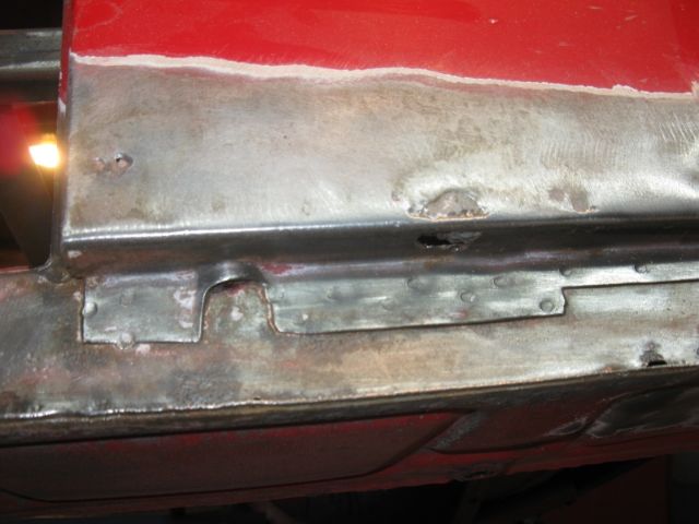

Another week, another patch.
or two. A couple 5cm sections all fixed up.
made this to close the end of the channel
slots in here.
welded
grinered
this was a pig to smooth out, the grinder wouldn't fit, so was done with the dremmel, a less than perfect finish, but no rust any more is the main thing!

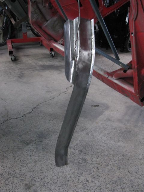

So i made this thing, which is the end of the channel its self.
goes here
that took a lot of work to get right, pretty happy with it.

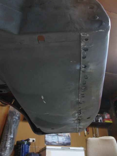

this me checking the bottom plate still fits.
these bottom plates are actually pretty good, the pressing are not exactly the same as the old stuff, but the main thing it that the bolt holes are in the right place and line up with the pan perfectly, I will fill in the big drain holes that are in them, and they will need a wee bit of trimming but thats okay.

Right, got this finished up.
stuck the dents and air pipe in.
goes here
camera is on the way out, flash has stopped working.
not all that happy with this join, but will be covered by the inner wheel well.
this is better
ONTO THE NEXT BIT!!!!

I did wire wheeled/blasted these parts up.
don't think I will be able to save the hinge cover though, just to tricky with my limited skills and tools.

Glued the scoop to the new inner panel thing(there is a hole on the other side icon_wink.gif )
and welded it in here.

I have been spending a lot of time messing around with bottom plate, I think the best thing is to finish all the other repairs to the channels on both sides, then test fit the shell to the pan before welding the bottom plates on for good.
I don't know, I've never don this before!
The plates seem to fit the pan perfect, but when I stick them on the shell they seem 5-10mm short?
So a test fit seems prudent.
I had to dig the pan out to get to all the camping stuff for the hoilday so I took a couple snaps.
