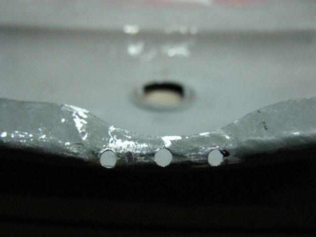

detail of the bottom gap for the drain holes

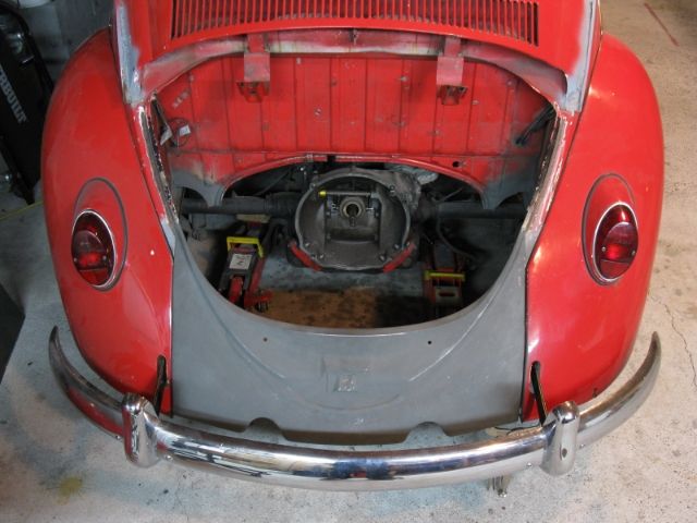

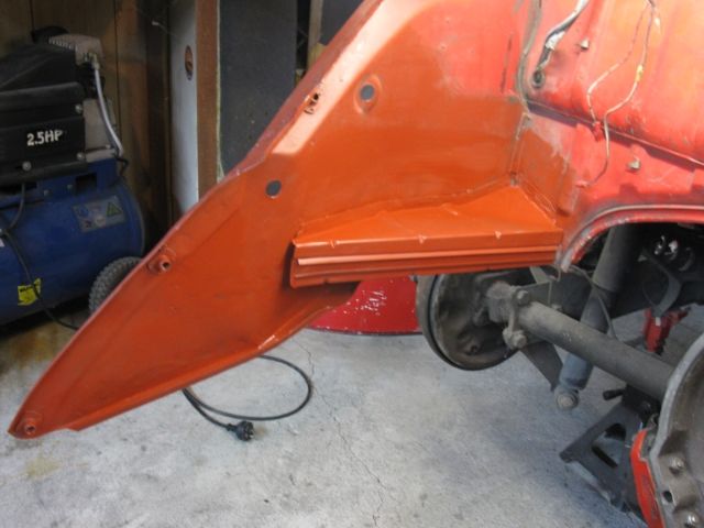

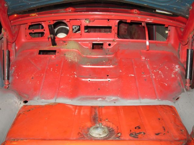

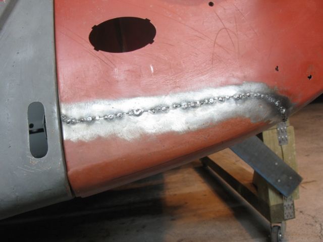

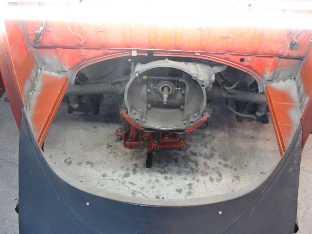

Very excited as last night, I tacked in the engine trays on both sides!

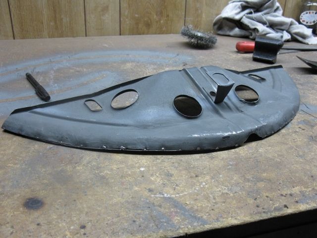

Both bumper mounts are fully welded and smoothed out on the weekend.
Will post some pics soon, feels great to have it back in one piece, the dremal will be very handy for getting into these tight corners once the trays are welded, such a awesome little tool, BIG thank you to my brotherinlaw Rob who I nicked it off, chur!
Pics of burnt melted metal
from the welding side
good penetration(snigger)
both trays in
check out my fast and furious rear wing, neon baby!
plug plug
plug plug
inside
everything seems to be in the right place

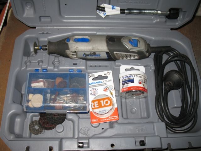

I did find another great use for the dremel
try starting a drill right on the edge like this with a huge powerdrill.

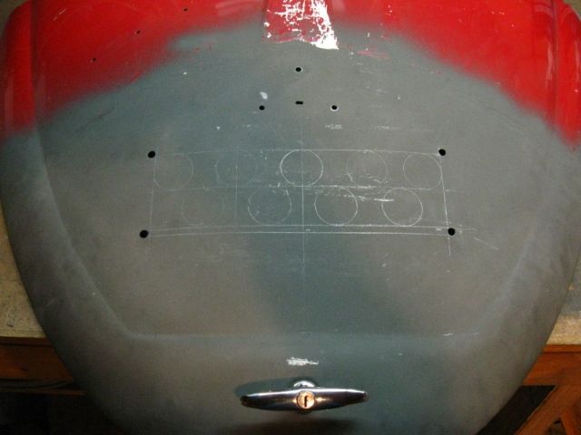

And started planning some extra air/speed holes!
if you look at the top pic, the plan is to space out the number plate.
Would like to weld in some later/kab style vents also.

So any thoughts on the speed holes idea?
I'm a bit worried about rain getting in?

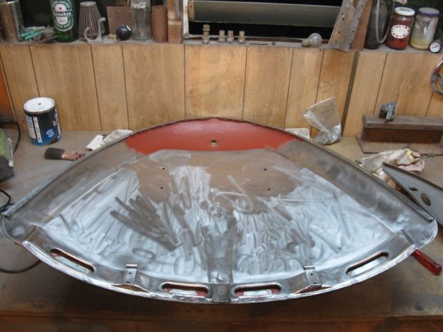

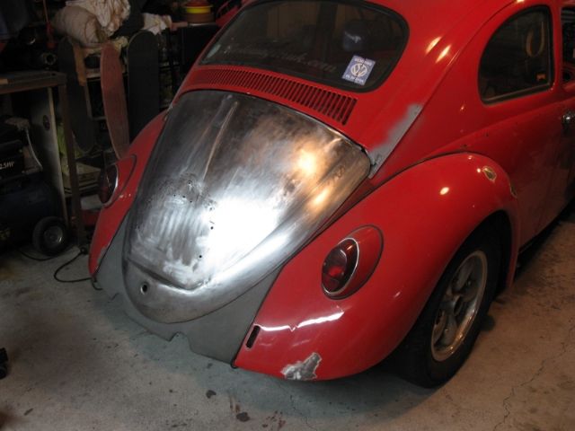

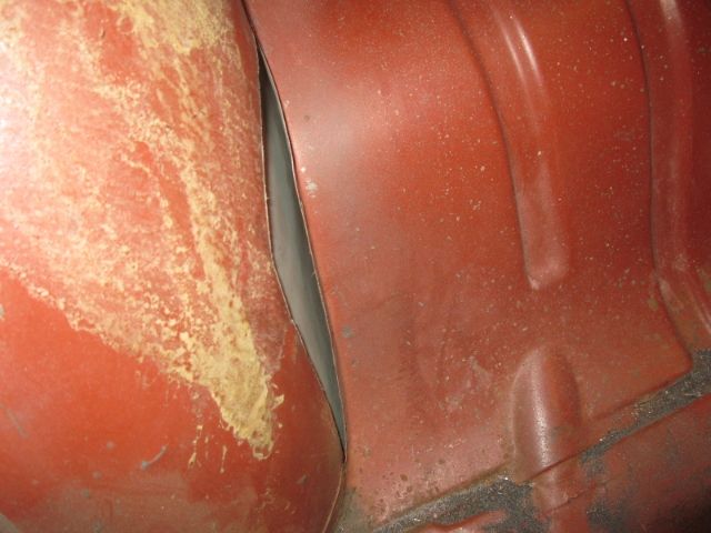

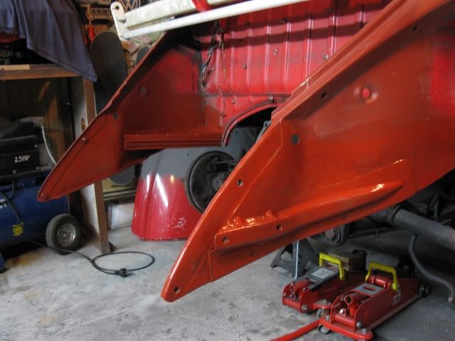

I've spent age's trying to get the engine lid sitting better, not 100% yet but much better, the gap under the vents use to be huge, you could see the top lip that is ment to tuck under the body, alot of bending, tweaking and test fitting.

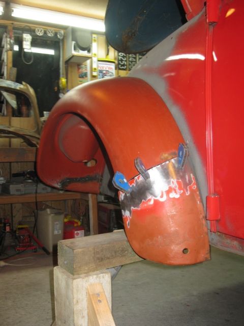

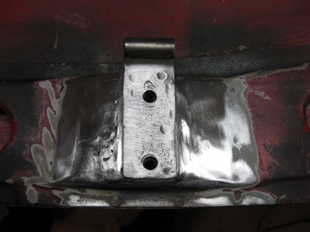

Welded up the 1300 badge holes
all smoothed out now

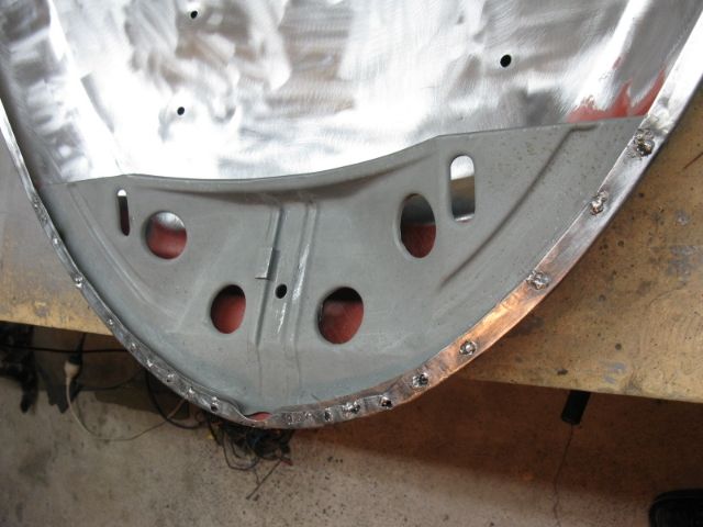

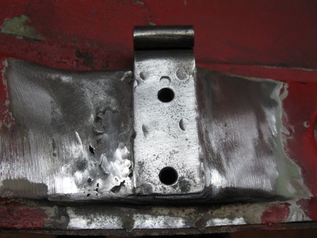

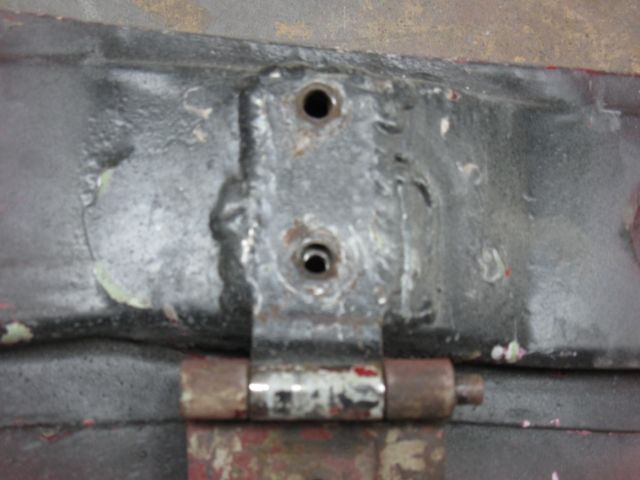

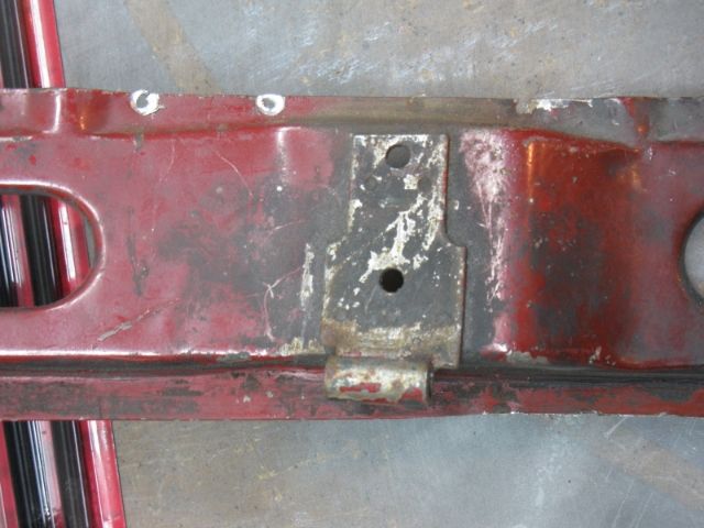

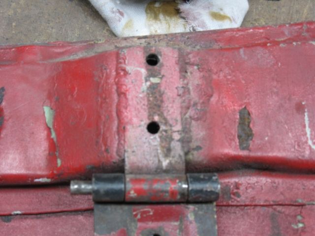

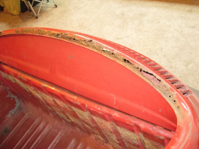

Still trying to suss out what to do about the hinges?
both pretty hammered!
I separated the inner panel from the scrap on the other lid I had.
but so far I'm to chicken to cut into my lid.
these hinges are in much better nick.
my options are,
a; grind down the shitty old welds and hope there is enough metal to hold everything together.
b; cut just the hinge area and let it into my inner panel
c; or undo all the spot welds and replace the whole inner panel.
what would brain boitano do?

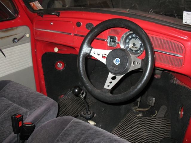

Did this last night
cal look, no chrome.

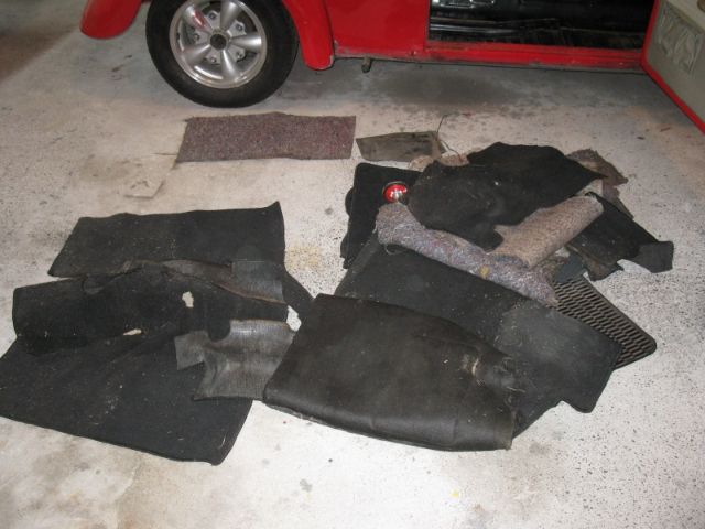

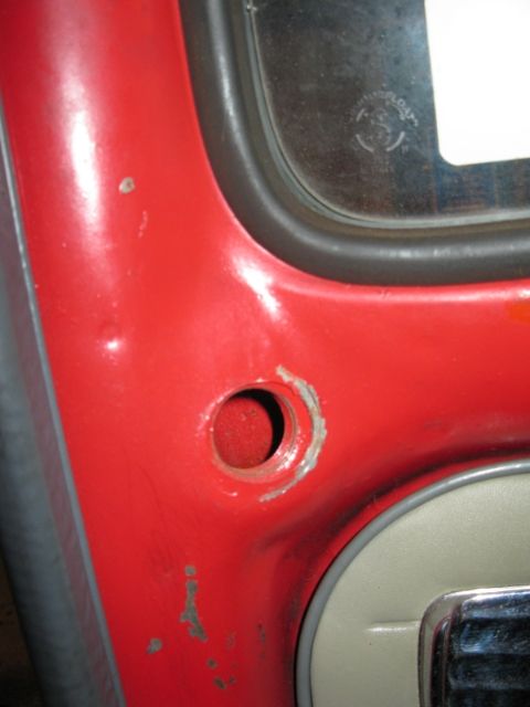

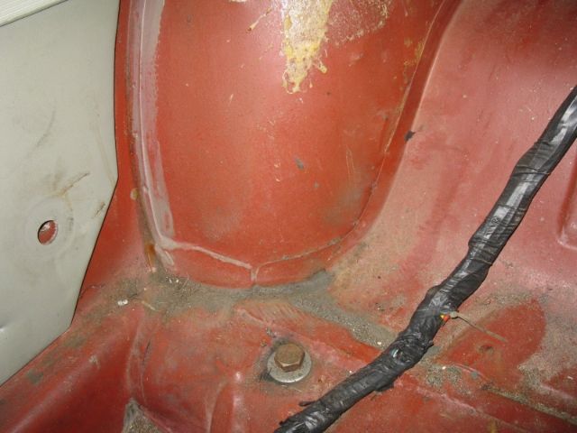

strange I thought how all but one seat belt mounts came out with the belts, kinda good as this held all the nuts and washers together.
this was a not so nice surprise

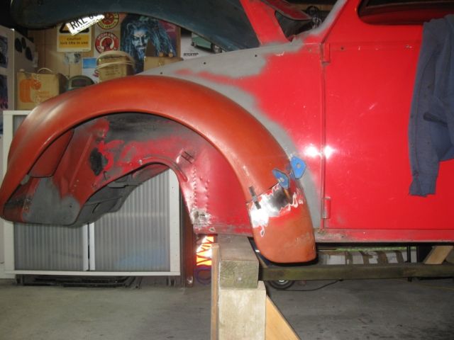

that little spot of rust bubbling through the wheel arch means there is a major bit of work involving the rear body mounts and that double layer of metal that it attaches too. icon_evil.gif
other side hasn't come though yet.

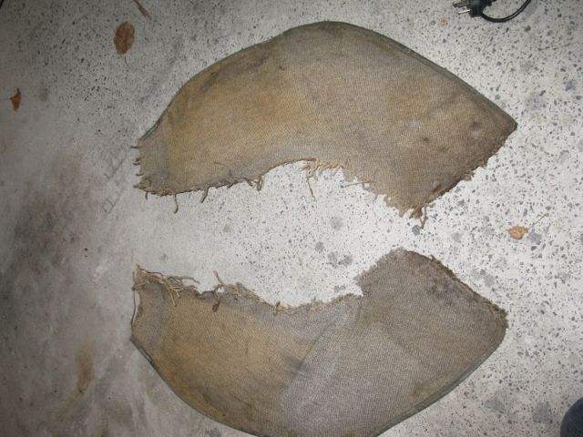

rust was covered by these awesome period old school patina fulled OG factory wheel arch carpets, must be worth a fortune!

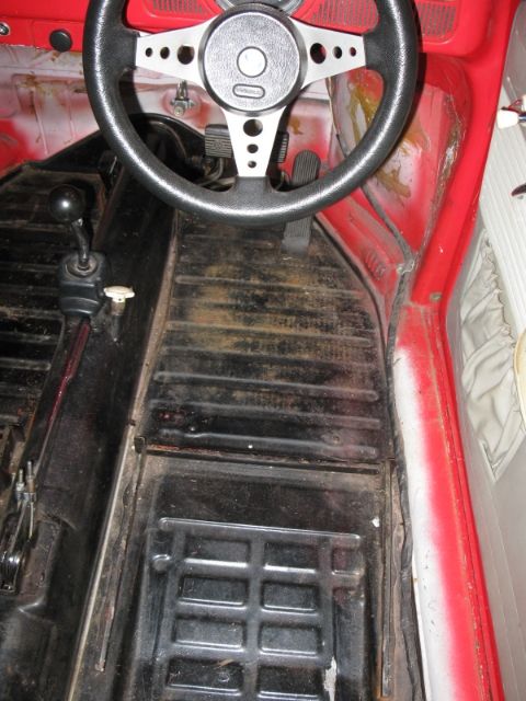

Carried on with the strip down, just the doors and the sunroof left now, pulled the steering column so that was the last connection between the body and pan.
002_zps54b05286.jpg\
shitty wiring all gone, yes!

tidied up the hinges, had to make two small patches and weld them in, pretty happy with the outcome.

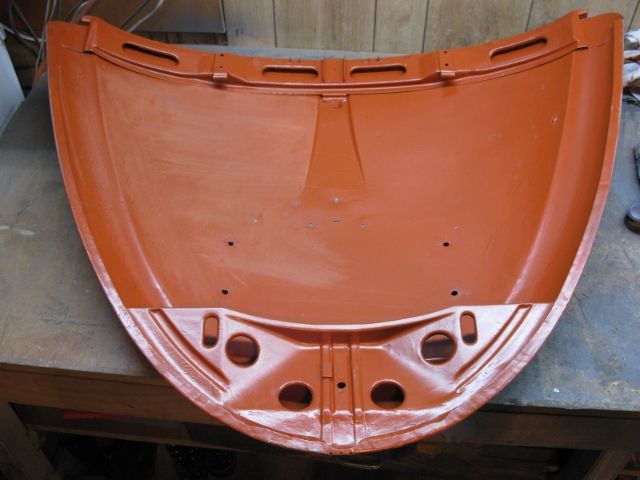

then stripped the inside of the lid.
and finally!

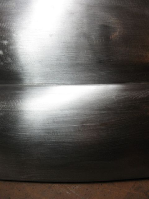

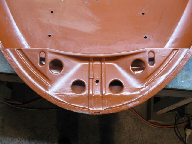

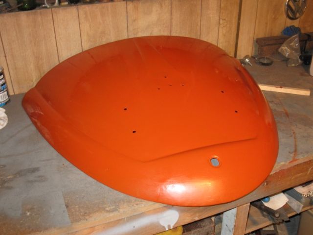

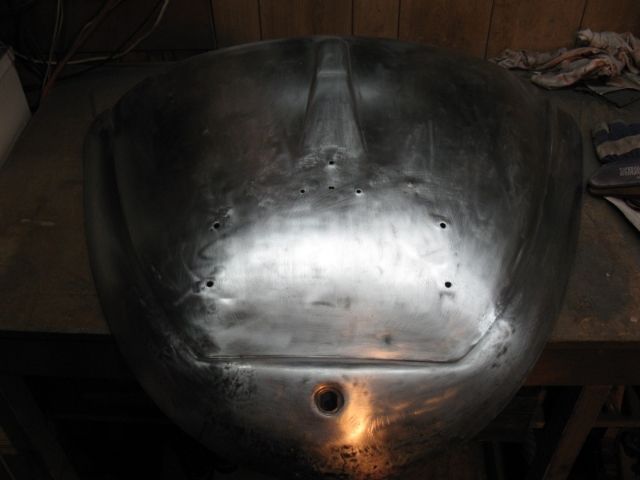

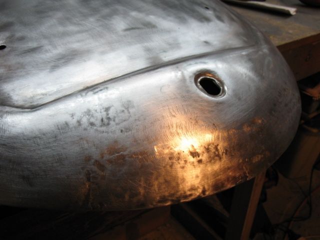

Finished off the lid on the weekend, still needs a bit of hammering/heaps of bog.
like new!

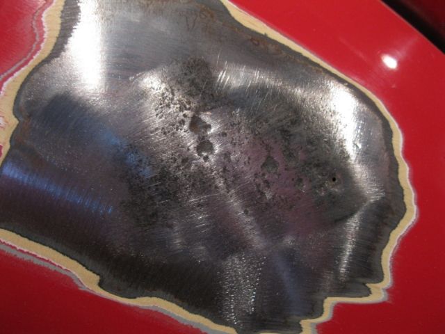

bare metaled the outside
just to show it's not perfect, much better than it was when I started.
and slapped some primer on the outside to.

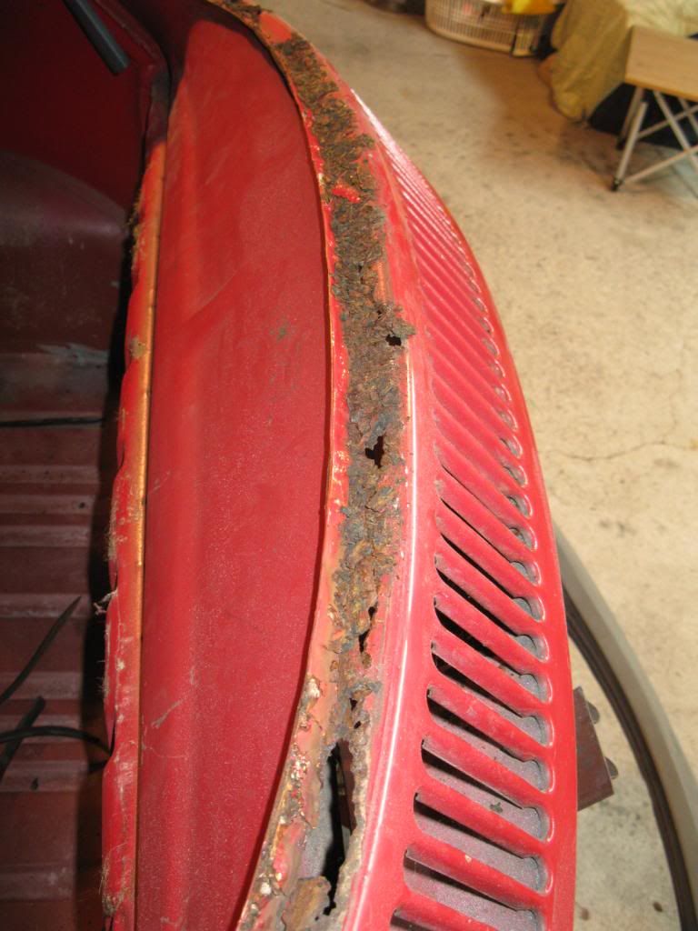

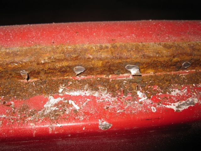

Pulled the rear screen the other night, damn! I knew it was rusty under that rubber but WOW!
First time I've had to use a pan and brush to remove car parts.
at least 50% of the sill is gone
close up of the nasty

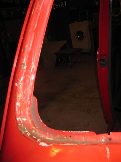

front screen is out.
not very pretty, but not as bad as I thought

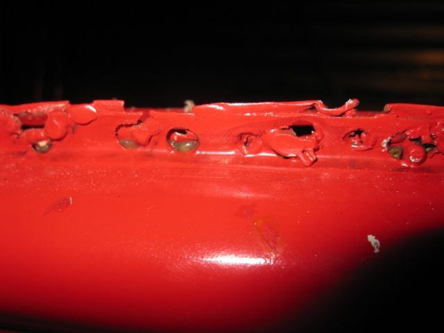

the entire bottom edge looks like this, looks like all the spot welds were drilled out at some point then quickly welded back together? this is how the water was getting under the dash, in a couple places the holes have not been sealed up very well.
There is damage, and or course rust!
gave it a quick wire wheeling, a huge bit of bog came off here.
not so much rust in this side, but man the bog was thick!
Upon further examination, it would appear that the scuttle panel has indeed been replaced before. Damn PO steeling my thunder!
Also found rust hole half way up the pillars, past the patch job. This thing must have been so fucking rusty under that screen seal!
from what I can see so far it looks like both corners on the front screen have been repaired/replaced at come point with some quite nice homemade patches, the weld has been ground down a little, you can see it in running across on a diagonal, then covered in several mm of bog, which is fine, but all these holes in the bottom lip have let water under that bog, which is not good.

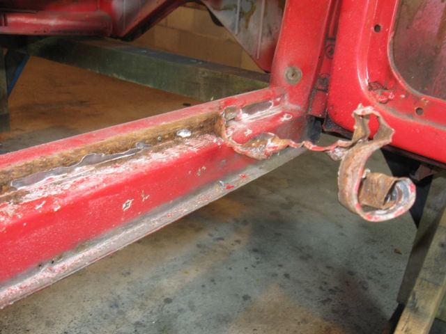

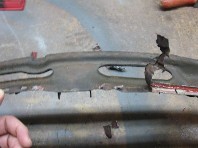

found this, the bottom hinge on the drivers door has been ripped off and welded back together.

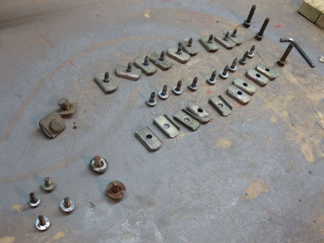

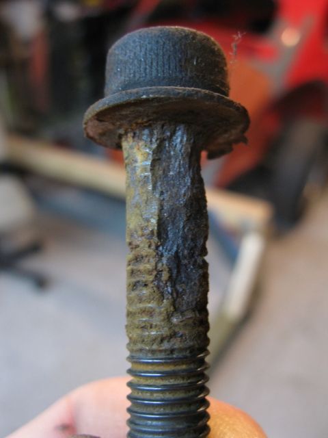

removed all the body to pan bolts, the big square washers under the sills have that gold coloured anodizing stuff on them, should have done the whole car! they are still mint and shiny as.
notice one of the big allen head bolt is missing up the top?
this is what it's friend looks like,
it's just spinning while making crunching sounds and dropping red dust icon_sad.gif
Ah well all the others came out pretty easy.

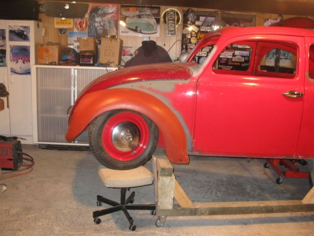

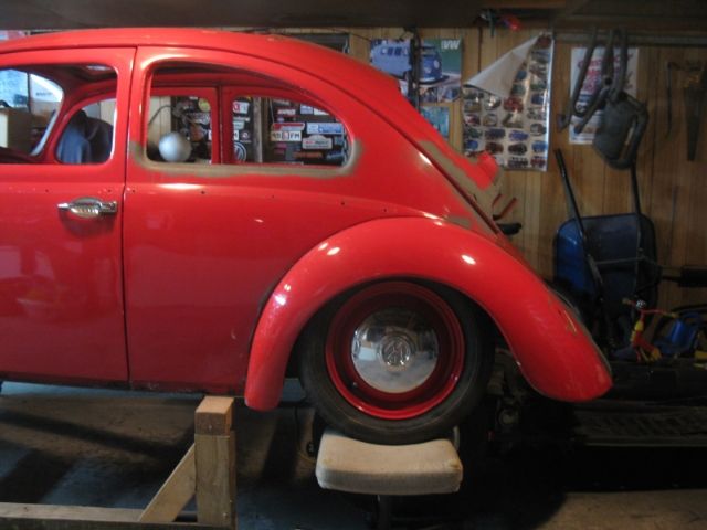

Ed came round on friday night, roped in a car guy neighbour and the three of us lifted the shell off the chassis.
floorpan is in tip top condition, stoked!
world biggest skateboard!
now shit gets real!
As promised better photo's
It's a bit cramped with all the bikes and other crap, I have rearranged things a little better now.
the trolly makes working on the shell easy once the honda is outside.

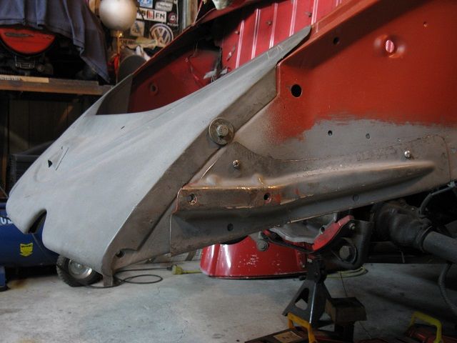

First up, the body mounts
sorry bad pic.
this is up underneath, looking from the gearbox's view, I didn't know this was here until i pulled the body off, very well hidden.
and after several days of drilling, banging and swearing.
didn't really want to pull these things off, but I'm glad i did now.

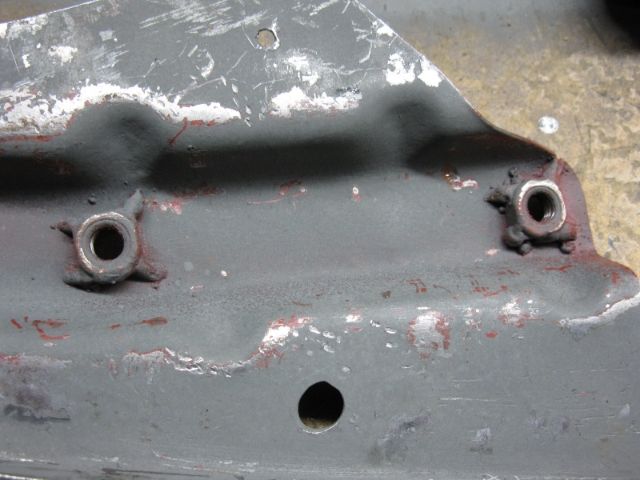

these are made of thicker metal like the bumper mounts, badly pitted but should be able to be reused after a sand blast.
and after a quick grind to see what I've got to play with.

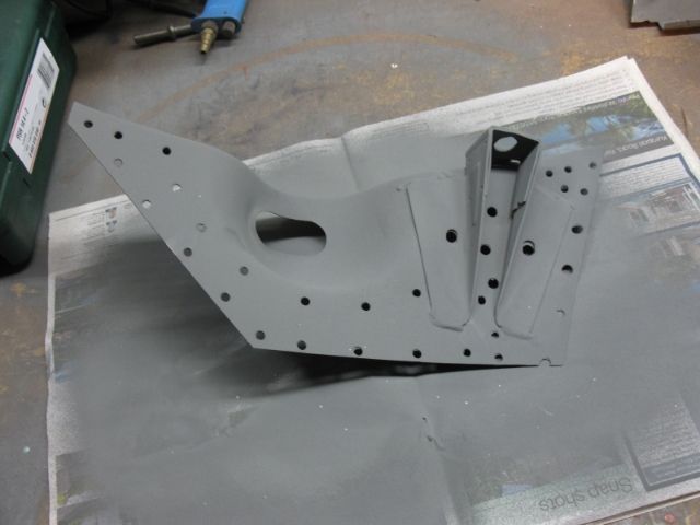

spent one afternoon sandblasting, did the side here, the body mount and gave the new patches a little blast.
primed the outside
see that black stuff on the right side, that needs more blasting.
patches ready to go in

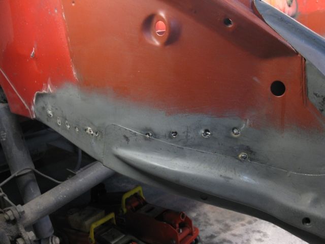

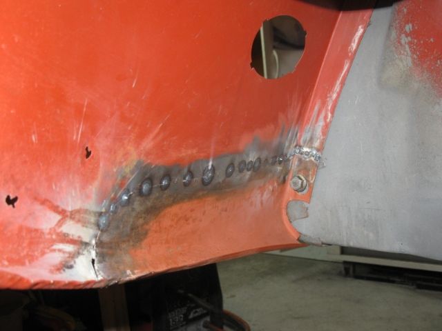

took quite a lot of welding, had a few gaps to plug, I drilled four holes though the inside panel and used pop rivets to hold the patch in place while I tack it up, I then drilled out the pop rivets and plugged them up with more weld.
The join at the top was the hardest bit, couldn't get clamps in, so I just worked it into place a inch at a time.
with the car spun sideways, this is the workspace.
and that's that bit done, well nearly, I did find one pin hole and I still need to grind down the inside, but the mount panel seems to fit back on sweet, so once I finish blasting the back of it, that can go back on, may need some more pop rivets.

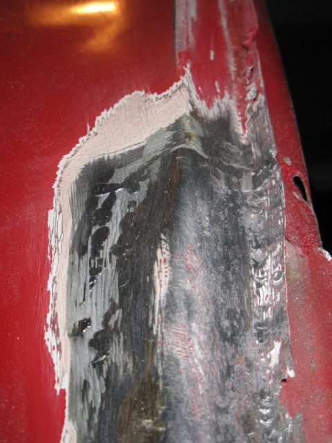

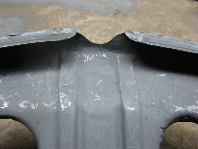

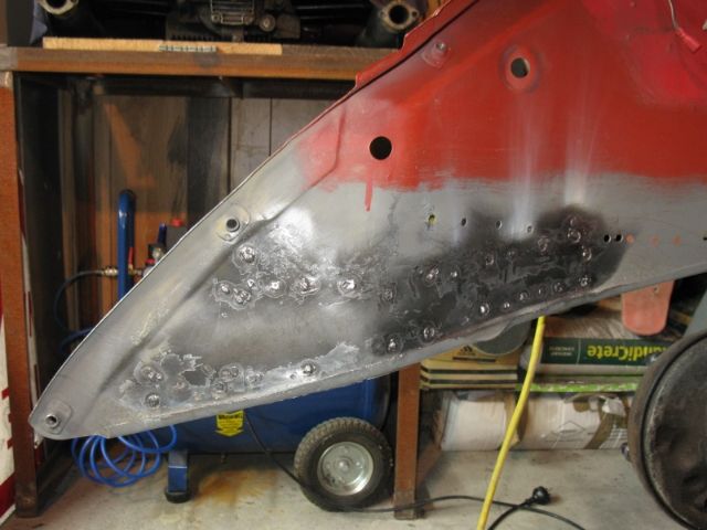

Small update, while the body mount was getting blasted I patched up some small holes that old bugs tend to develop between where the fenders bolt onto the shell
patched up the tinworm
cut out crap
make patch and tack in
carefully and slowly weld up
grind weld down
and because I'm a bit silly I like to smooth it out with a sanding disc
and prime.
body mount looking a bit better.
check out those pits
getting there.

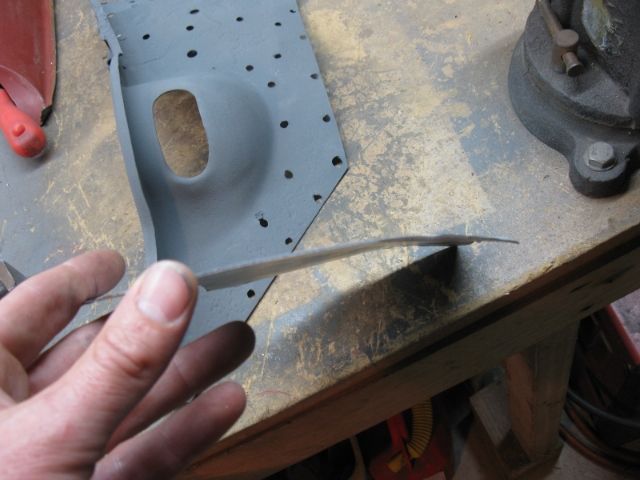

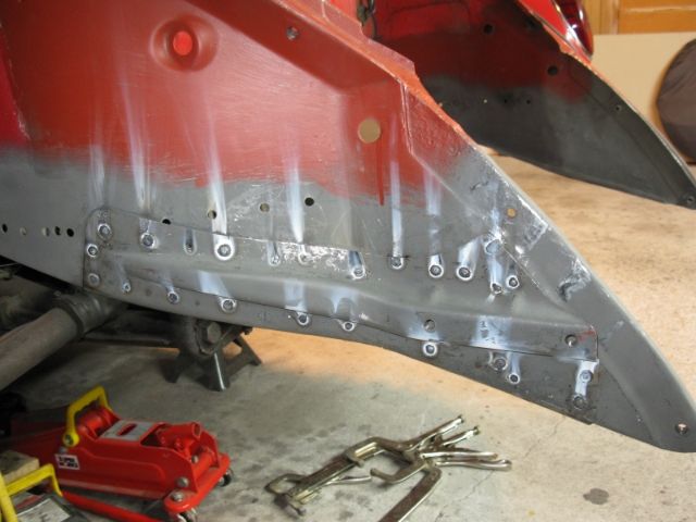

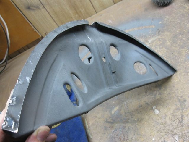

I needed some more panel steel for patch making, found a workshop just down the road from home, got this bit for 5 bucks, seemed like a good deal.

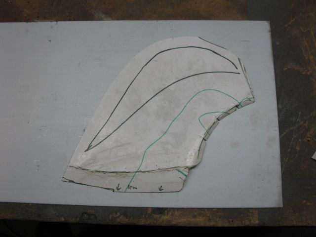

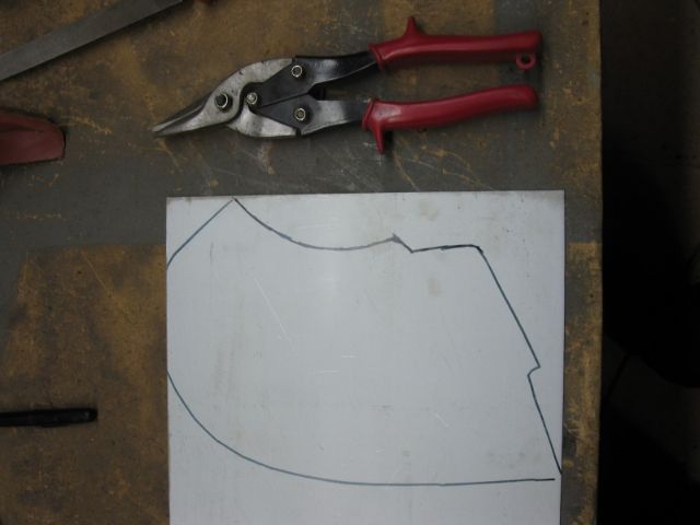

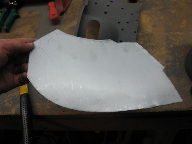

thought I'd show how I make this patch
template, I made this when I did the other side, so i knew it was pretty good.
trace template
cut out, then hammered flat as the tin snips twist the edges
looks about right
file down the edges and start shaping/hammering
as with most things it's harder than it looks, the panel is concave, so the curve goes side to side and up and down, which means the steel needs to be stretched/beaten into submission.
kinda hard to show in pics.
this is the hole from above, tricky.
starting to rough in the return lip, always amazes me how simple things like this strengthen the thin panels steel and how clever the people how made this seemingly simple cars where.
and bending up the bottom edge, using the mount panel to get the fit as close as possible.
and this is where i cocked up. That bottom fold is actually alot straighter than that, guess the old template wasn't as accurate as i thought. And that is where the problem is with this shit sometimes, It's not until you actually get the patch to fit ALL the edges and the side of the floor, can you see if they fit correctly.
Because I had already cut the shape of the edge when I moved the fold back where it should have been, I had run out of metal, doh! not a problem, just stick some more on!
welds be gone

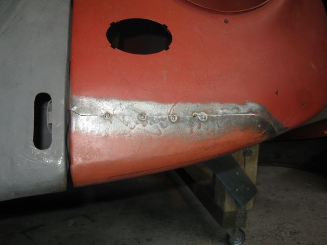

that's better, trimmed to fit
fits pretty good too, pop rivets like a pro!
weldy weldy
inside looking good
different angle
nearly done.

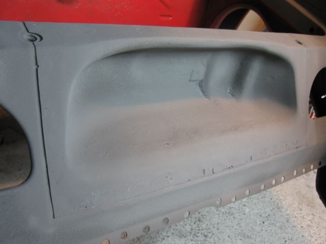

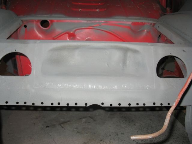

So I was looking for something else to do the other night, opened the hood and thought hhmmmmm....
When I had the sandblaster out last I finally blasted the back of the area the water bottle panels attaches to
under where the beam sits.
This will allow me to weld the spare wheel well back together and I'll be able to mount the shell onto a spit of some kind so I can attack the rust in the sills.
but back to the water bottle panel, I'm not planing on using this for the brake fluid res, whether I go duel or not I'll use one of those tanks on top of the MC, also I don't think I bother will the screen washer either and if i do I actually have a brand new tank with built in electric pump off a ford lazer or something, only problem is it's so ugly!
anyway more welding
all done just needs grinding
this sits up the front behind the spare wheel, the plan is to mount a fuel pump and filter in here.

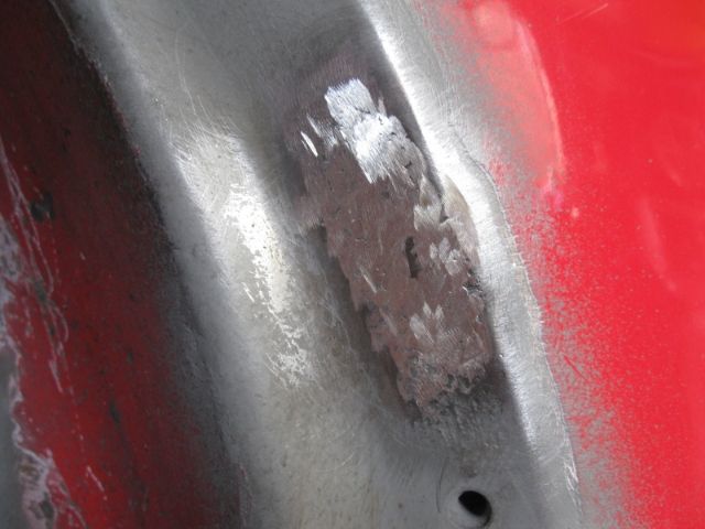

Finished up the grinding on the rear mount
and the inside, come out a bit better than the first side so i must be learning sumfing.
smoothed out the bottle tray
started welding it back in
that fucker is never going to move again!
decided to start working on the fenders.
on the left is the old fender that was on the bug, the middle one is the holey oval fender and the right on is a 60's fender that I first practiced welding on , filling the horn grill hole and the indicator hole.
lace work on the oval fenders, the plan is to use the 60's fenders to patch the 50's ones.
chopped out the shit
getting there
tacked in place
not a bad start, needs alot more work, there is a small ding where the two parts meet on the edge of the fender, after I get a few more tacks done hopefully I can smash it into shape.
I also pulled the carpet holder downer thingy off, I will remove the passenger side one, but the drivers side really had to go, was krusty as
no holes in the sill, should be sweet after a blast.
Got this thing sorted on the weekend
pretty happy to be sticking things back together somewhere.
smoothed out the tack on the fender while I was at it
see the dent to the right side of the weld, bog fixes erthang!
more tacks
inside
thought I was so fucking clever so i chopped the back of the fender off as well
part of the 60's fender not full of holes like the 50's one.
it would seem that the oval fender is about 15mm wider than the later one, hhmmmmmmm....
