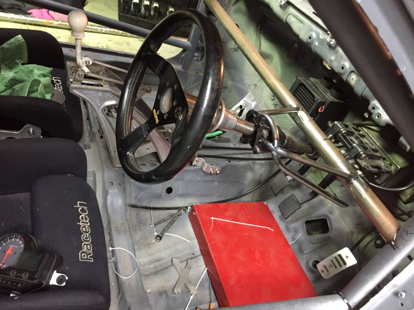

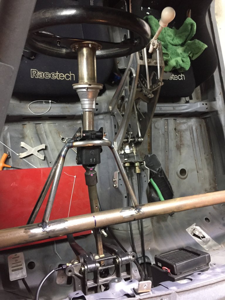

Needed to remount my steering column as it had too much flex and wasn’t happy with it. Not finished yet but happy with the direction I’m heading in and getting good use of my pipe bender!
makes mounting the motorbike dash and a few other things a lot easier too.

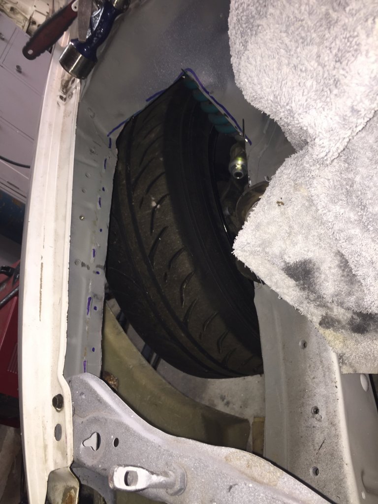

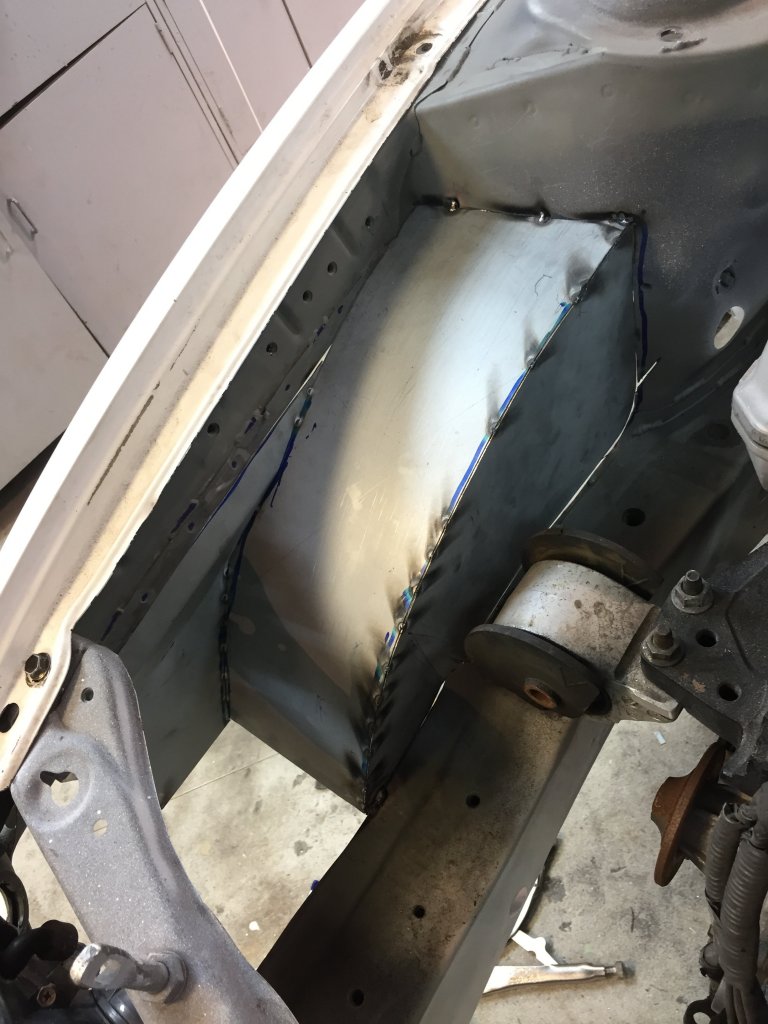

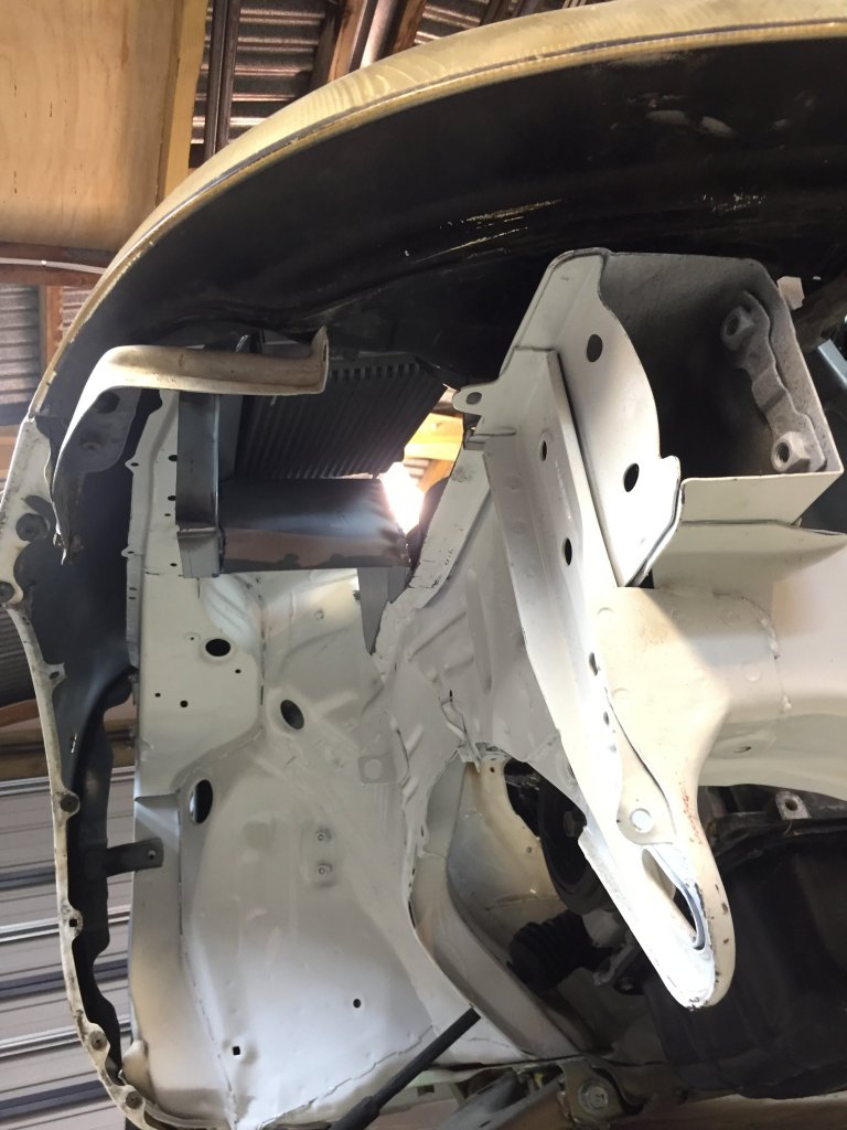

Cut out the front tubs to make the appropriate clearance needed for the ride height and got a bit carried away with the grinder. Long story short I’ve got a bit carried away again and want to manage the airflow in the dead spaces of the car such as this from high pressure areas to reduce drag
Made some cardboard CAD templates but not yet happy with the result so watch this space

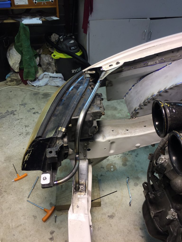

Decided the radiator support also will go once I replicate the headlight mounting points also as I won’t have a radiator in the front and will free up space for the air box.

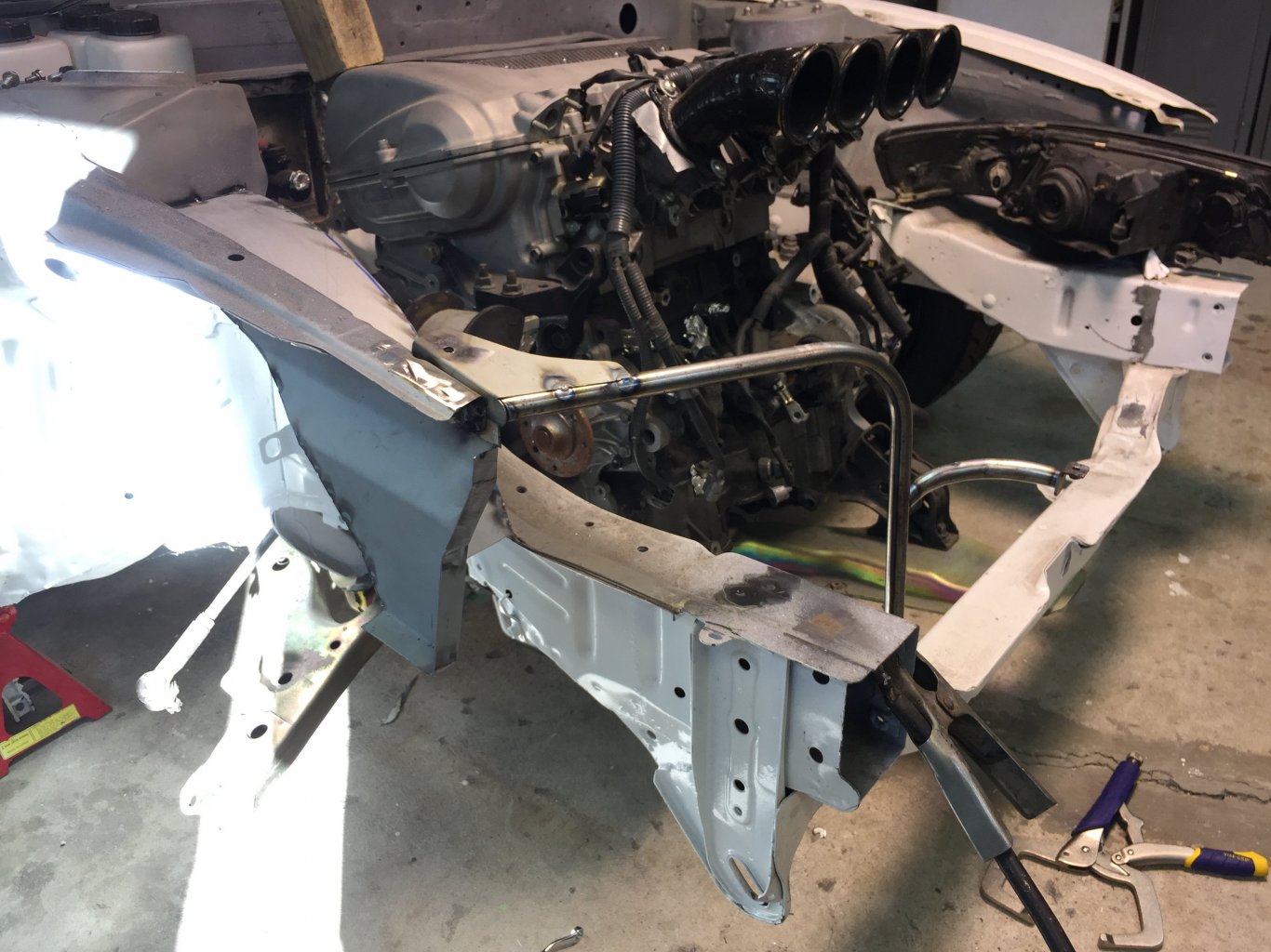

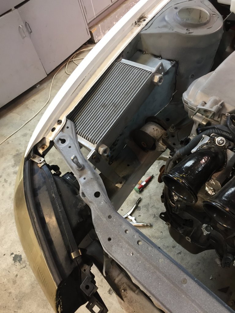

Have been making some progress on the first tub. Holyfuckshitballs it is heaps of work!

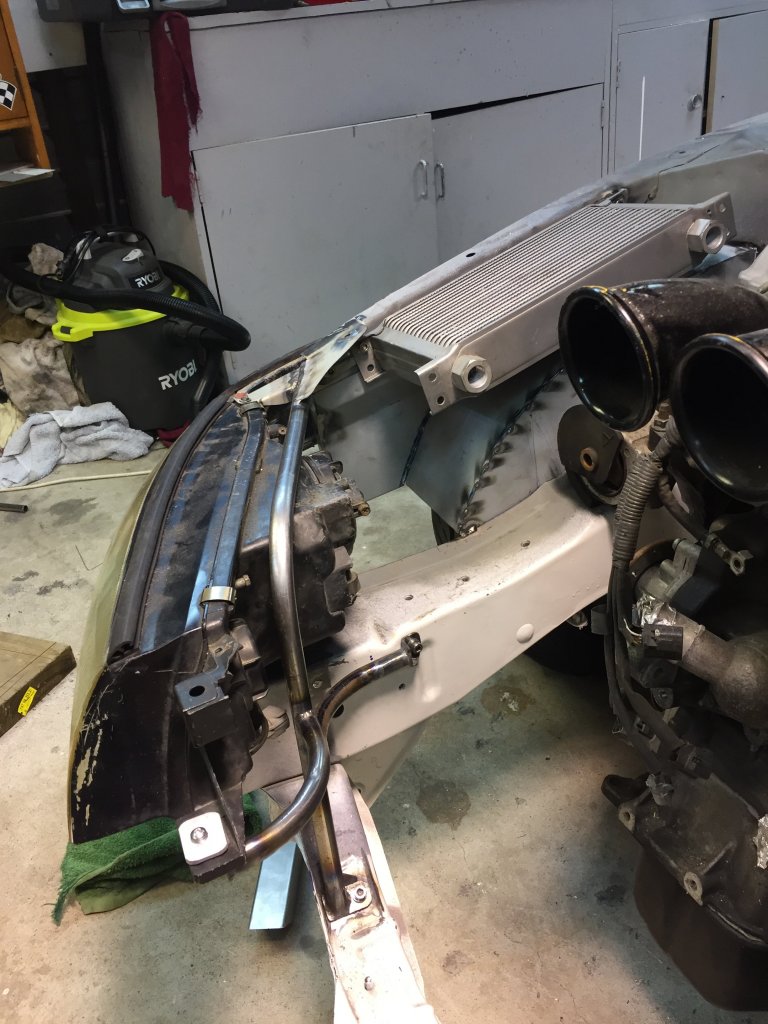

Cooler will sit on top of the tub and be fed from bumper below as such.

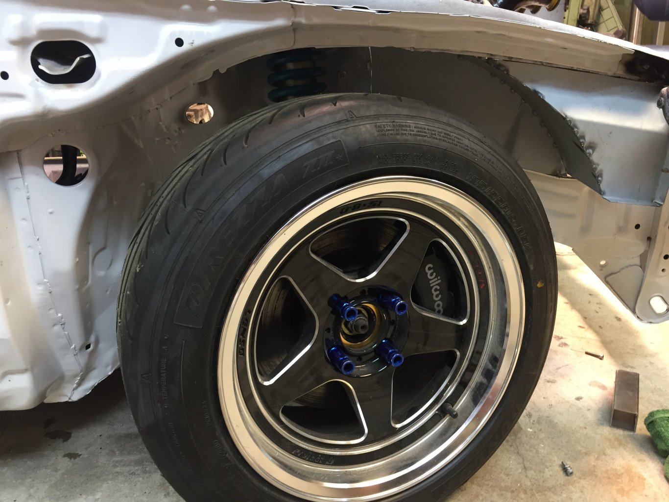

so much room for activity at full lock. Time for some caster you say?? I’m really trying not to talk myself into making some bottom arms for this...

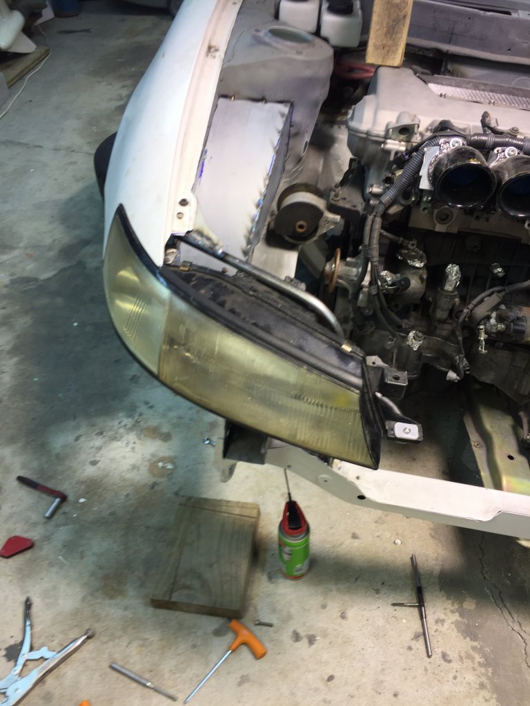

Added a few more braces to the mounting without trying to make it too strong so frontal impact etc isn’t effected too much.
Has some movement so I’m sure will rattle with solid engine mounts but shouldn’t effect night driving too much
Hopefully saving some weight too I’ve cut heaps of shit out of the front end and not a lot going back in..
got oil cooler mounted and will start ducting that when I convert my shed back to Ali after I’ve finished all this mild steel fab.
Any opinions on what colour/coating these headlight mounts should be?? They unbolt so I can remanufacture when I crash it/bend it.
a) zinc passivated like subframes
b) powdercoat white
c) powdercoat gunmetal grey
d) other options??
Im 76.9% sure engine bay will be painted white. Tossing up gunmetal cause it looks tidy but like the idea of the carpet matching the drapes etc.
