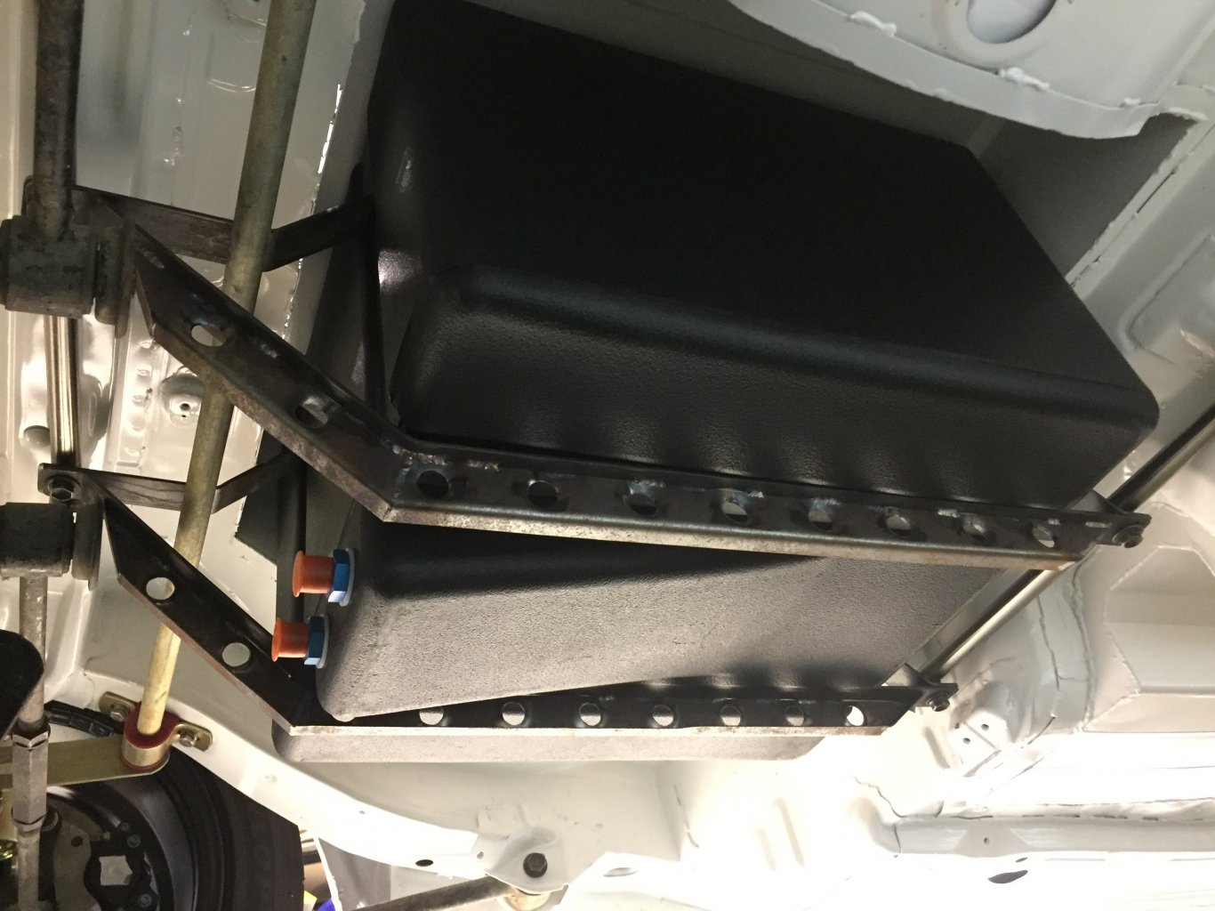

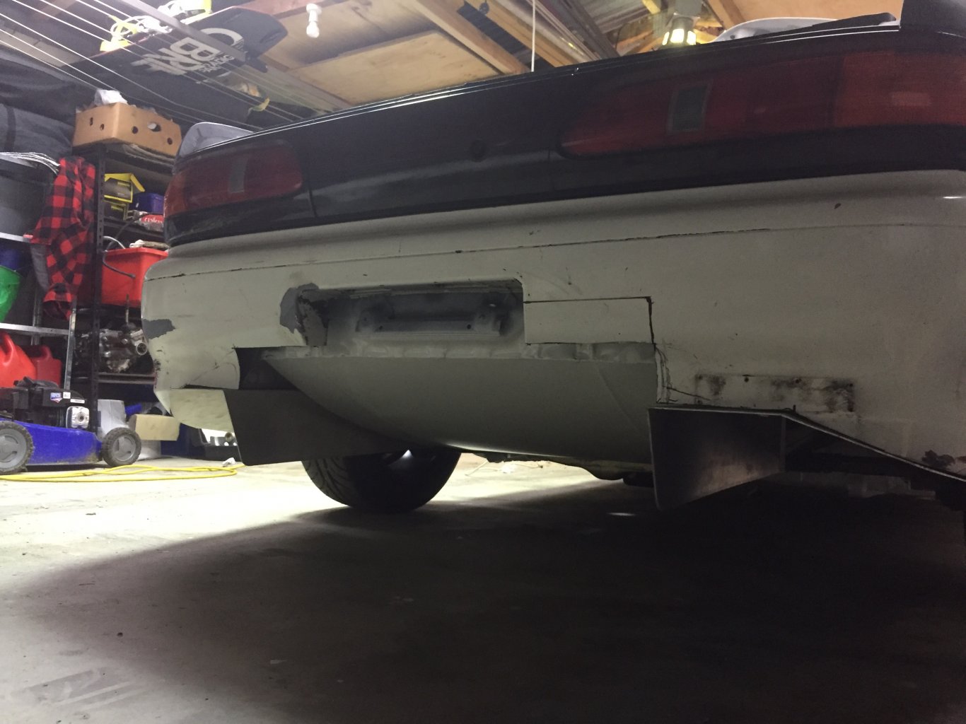

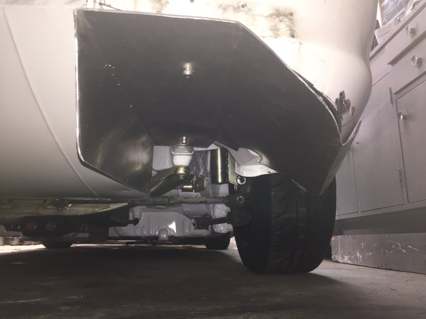

Rhyscar Posted August 20, 2018 Author Posted August 20, 2018 So it’s probably about time I put an update on this. Since I last posted a lot has changed. I bought a house and got engaged! New shed is grouse and been actually working on the car and other people’s car quite a lot. Namely supercharging a k24 Honda engine. Damn it goes good. Progress report; rear diffuser side plates folded and fitted. Aim here is to empty the air from the rear tyre wells cleanly and just look cool and be functional-ish Lots of room for activities (got to get a bloody exhaust out here somehow too - but that’s a problem for another day) Fuel cell mounting is now complete also. Maybe over engineered it a little but it’s not going anywhere in a crash most importantly. Mounted straps to stainless tubing front and rear with bosses welded in. Was the strongest/lightest combo I could think of doing. Pretty glad this job is done it was a pain in the ass Haven’t finished off the plumbing for the top end of the fuel cell yet. Maybe it should be next on the list? 8 Quote

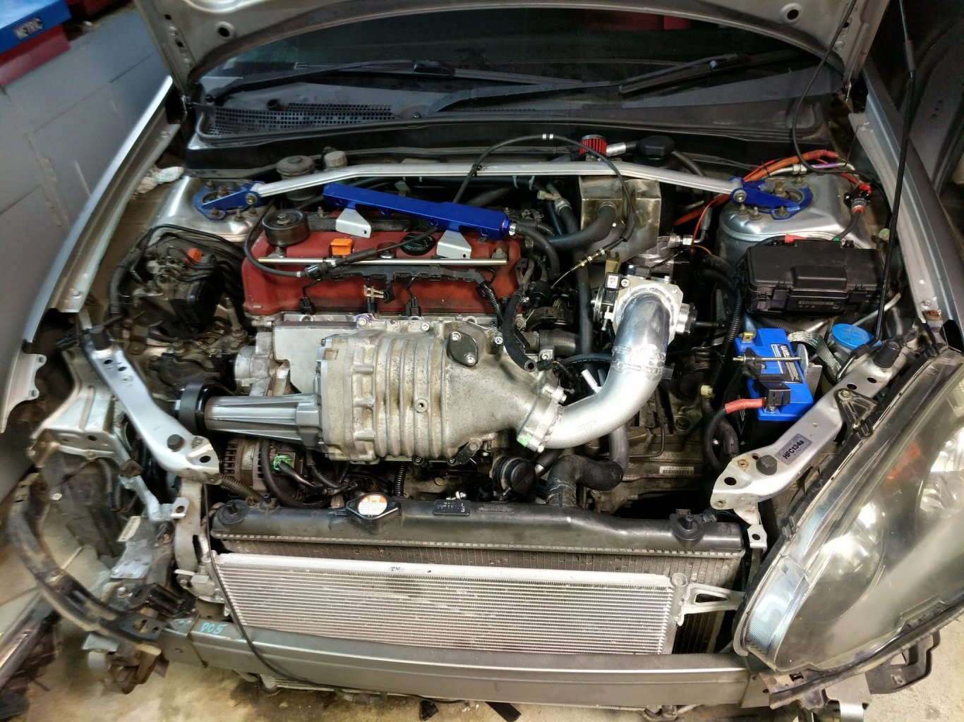

Truenotch Posted August 22, 2018 Posted August 22, 2018 7 hours ago, BobbyBreeze said: Pics/deets on blown K24 plz. Glad you're getting back into this! Keen to see how it all pans out. Might give me some motivation to get 205gti sorted.. It's a K24 with a K20A head and an Eaton M90. Made 200kw at about 6.5psi on a pretty conservative tune - would make far more with water/meth injection, but it's super fun as it is. Build thread: https://nzhondas.com/topic/183910-k24k20-dc5-m90-what-could-go-wrong/ Here's a pic from part way through the assembly: 6 2 Quote

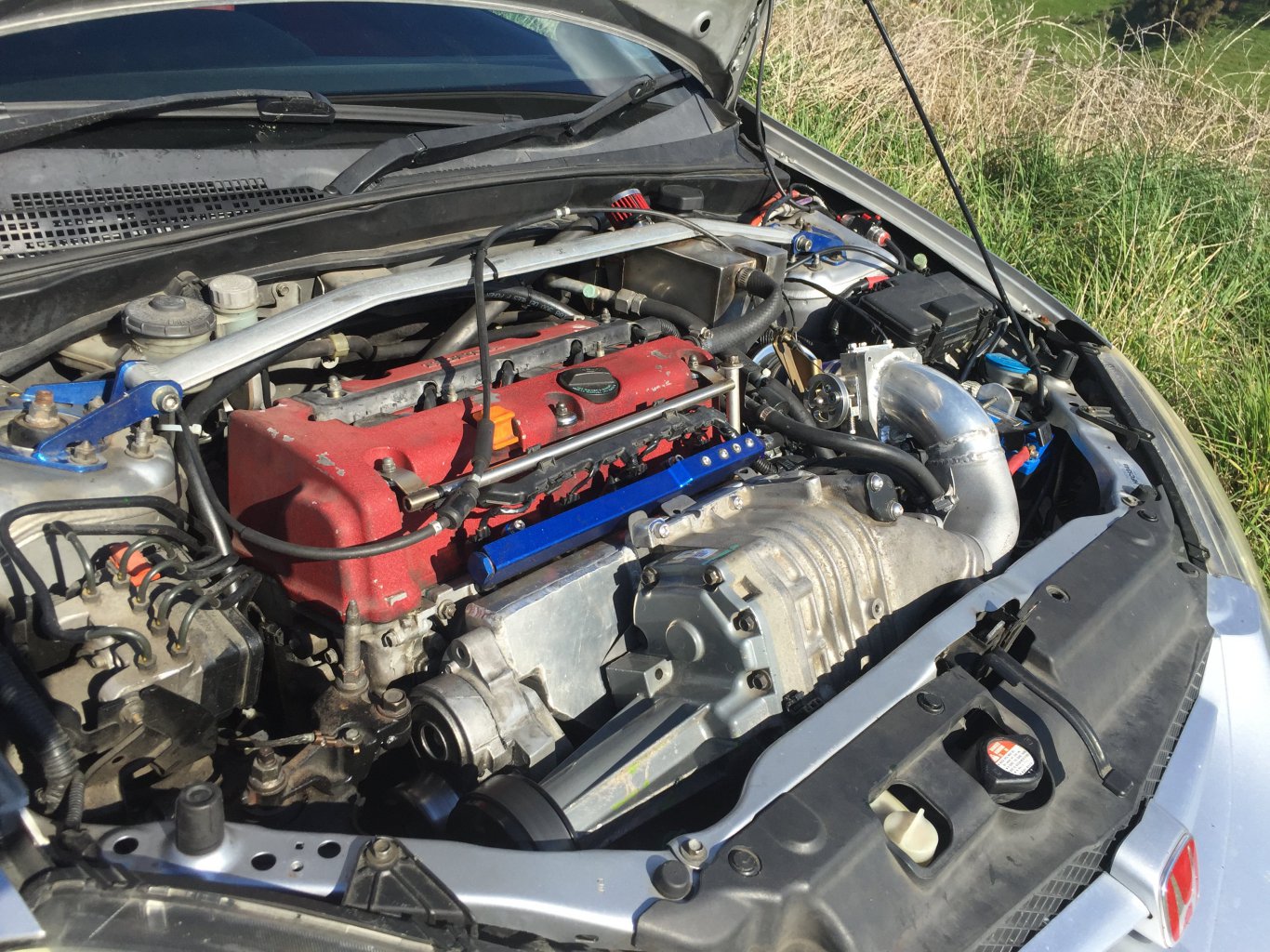

Rhyscar Posted October 22, 2018 Author Posted October 22, 2018 On 22/08/2018 at 09:08, BobbyBreeze said: Pics/deets on blown K24 plz. Glad you're getting back into this! Keen to see how it all pans out. Might give me some motivation to get 205gti sorted.. Here is said motivation requested 5 1 Quote
Testament Posted December 26, 2018 Posted December 26, 2018 On 22/10/2018 at 22:23, Rhyscar said: Here is said motivation requested Ooer nice. This is of interest to me. Do you know what ecu they used? Factory Honda or something else? Quote
Truenotch Posted December 26, 2018 Posted December 26, 2018 13 hours ago, Testament said: Ooer nice. This is of interest to me. Do you know what ecu they used? Factory Honda or something else? Hondata. It works fine, but a link would be better so he could add an extra map for water/meth injection. 1 Quote
