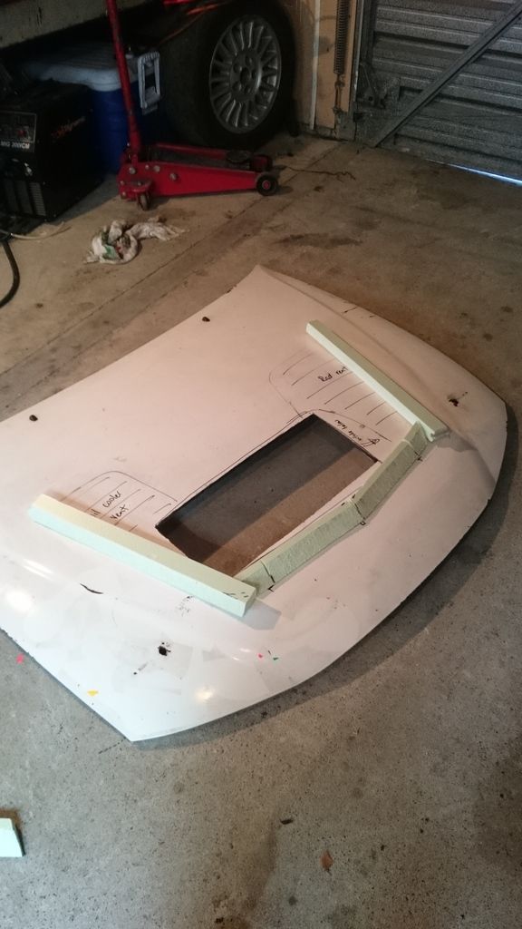

Could you not offset and relocate the intake from one of the similar doo-dadery's
eg. one of these
..but cut and moved to the position you require, being only slightly offset from centre it might still appear stock to the untrained eye.
The problem is it will always look a bit naff. I want to stay away from bad bodykit mods as much as possible to keep flatpeakers at arms length.
To get the performance I want I need a decent airbox rather than feeding directly from a scoop as benefits are +1000.
I agree Markku that car is le' tits. Makes me want to put a big cam in it straight away. Ive got uprated valve Springs already. I'm very interested to see what marks aw11 2zz mods make on the dyno
The only way I see you getting the clearance required indicated by that picture is remounting the engine rotated further forward or going BTCC spec and flipping it around the other way so your intake points up and exhaust down, followed by finding a gearbox to suit the mew rotational funtimes.
Clearance isn't as bad as I was worrying about
Starting to shape an airbox that will fit in the cutout below and the inlet for it will be on the passenger side. I'll still consider using a curved trumpet depends on how the airbox comes out. I'm still aware a curved trumpet may help airflow within the airbox considerably but will see if I can make these trumpets work first.
I'll use a half sized civic radiator in the middle somewhere and oil cooler on the left. I'm keen to vent each one through the bonnet to make sure engine bay temps don't get too high. May need to make sure I create enough of a low pressure area for bonnet vent that cooling isn't hindered at high speed.. hmm

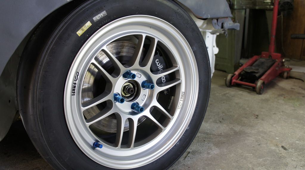

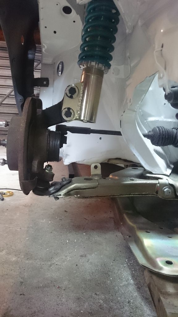

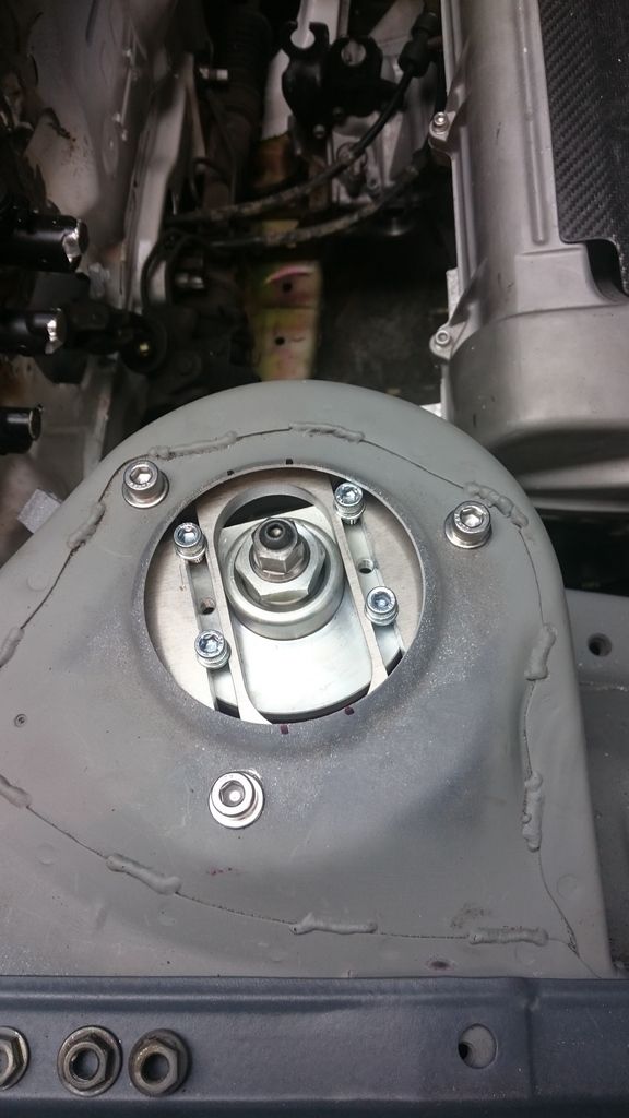

Slowly getting these shocks installed. Been getting tophats laser cut, new wheel bearings in front and waiting for 2 of my wheels to come back from being used to test-fit on dads ae82.
Top hats sorted. Thinking I may cut the strut tops with a slightly larger opening then tack in a lip to add strength removed when I cut it larger. Rear is a bigger problem than the front but have a solution for now (not entirely pretty though)
Got 1x strut installed. Pretty happy with the lengths and heights etc. Guna be so slam. This is full droop....

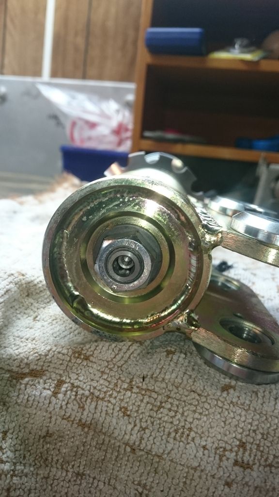

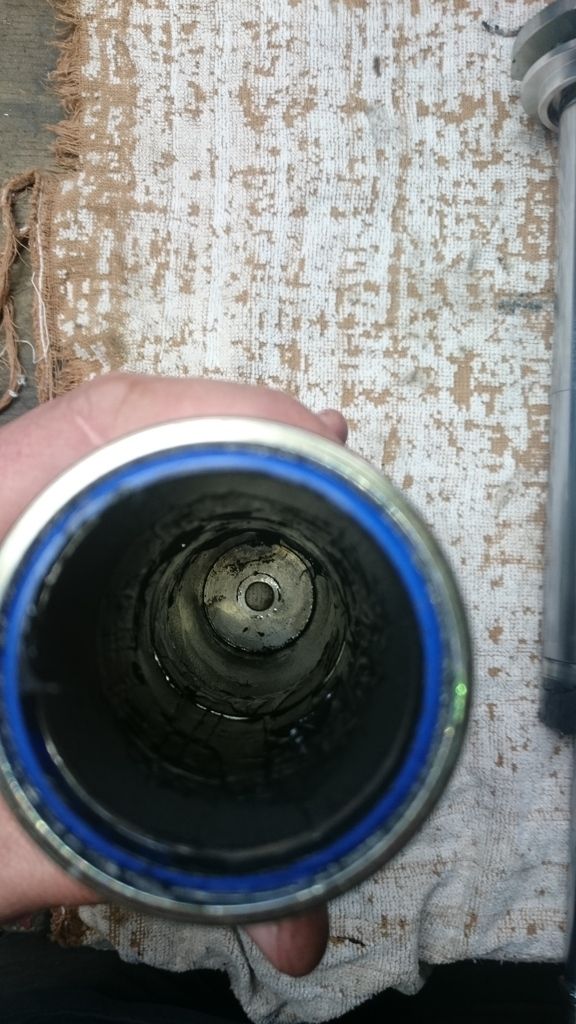

So here are a few details about the shocks that make them the tits and worth all the extra money over what I would call a 'street/track coilover' which are fairly light duty (high spring rates, no huge impacts). Some people perhaps have never seen this style of shock before or pulled one apart.

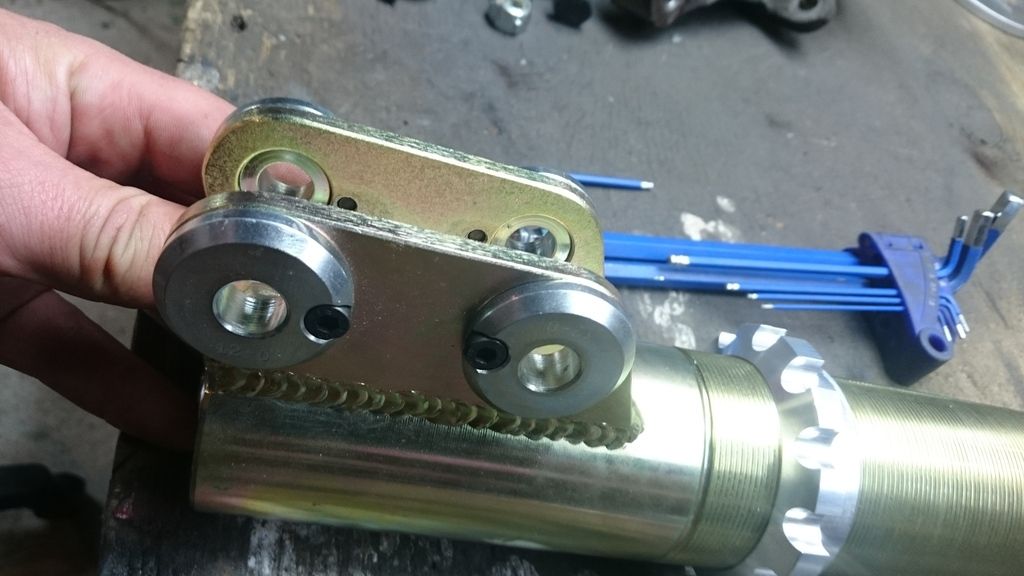

Big strong clevis made for doing jumps and hitting big rocks (all their gravel rally shocks are built exactly the same). Also notice the spring perch not having the stupid double locking setup most coilovers have - it has a small grub screw which locks it once adjusted.

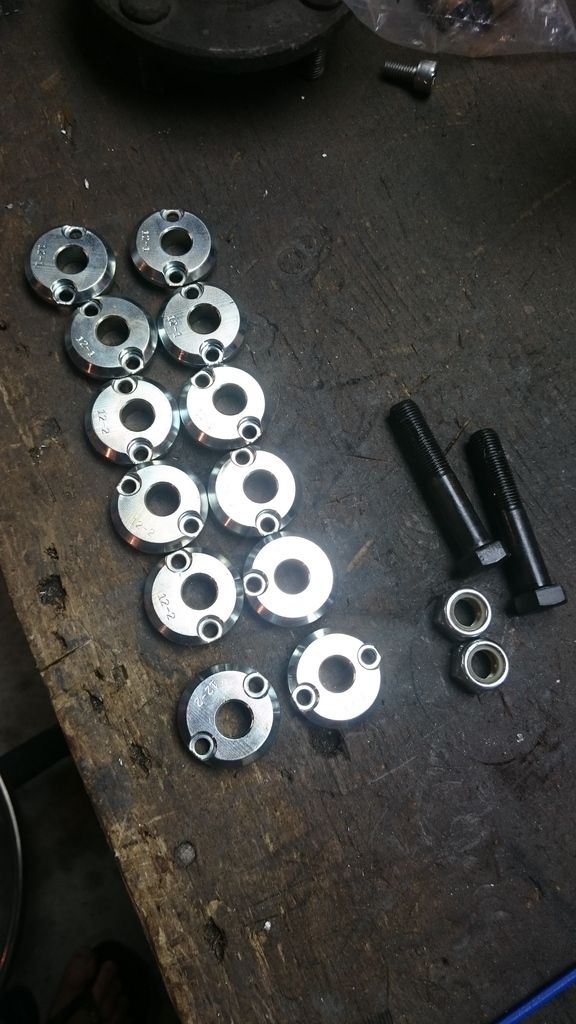

You'll notice the camber washers above. They have been supplied with 3 combinations of camber washers to adjust camber at the hub bolts. This is often done rather than at the top hat to help with guard/strut clearance along with having an adjustment which can't be moved (most rally cars don't have slotted top hats as they can move it you hit something big enough.

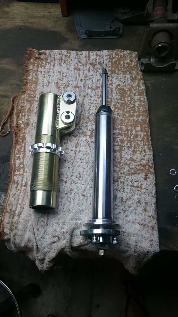

Shock is held in the strut by one big bolt at the bottom (also notice the adjuster inside the shock shaft)
Pull this out and you can slide the shock out of the strut. Essentially the shock shaft you see on the outside is the body of the shock and the shaft is inside the strut body. The main advantage of this is that the body is much stronger when taking impacts - especially on macpherson strut setups where it is essentially transferring force through an 'L' between the hub and the spring/strut top.
The next main advantage is the strut body itself has two brass bushes which guide the shock body and essentially eliminate any load on the shock shaft. These are fully serviceable/removable/regreasible and are a pretty robust solution as its easy to replace the dirt wiper seal or bushes.
Looks like they have only been supplied with rebound adjustment which was a bit different to what I understood. Just means I need to spend another $3k for the external canisters at some point to get the full potential from them. Keen to get the car going like this though, will add external canisters when I eventually get around to doing an event like Targa etc. Good things take time!

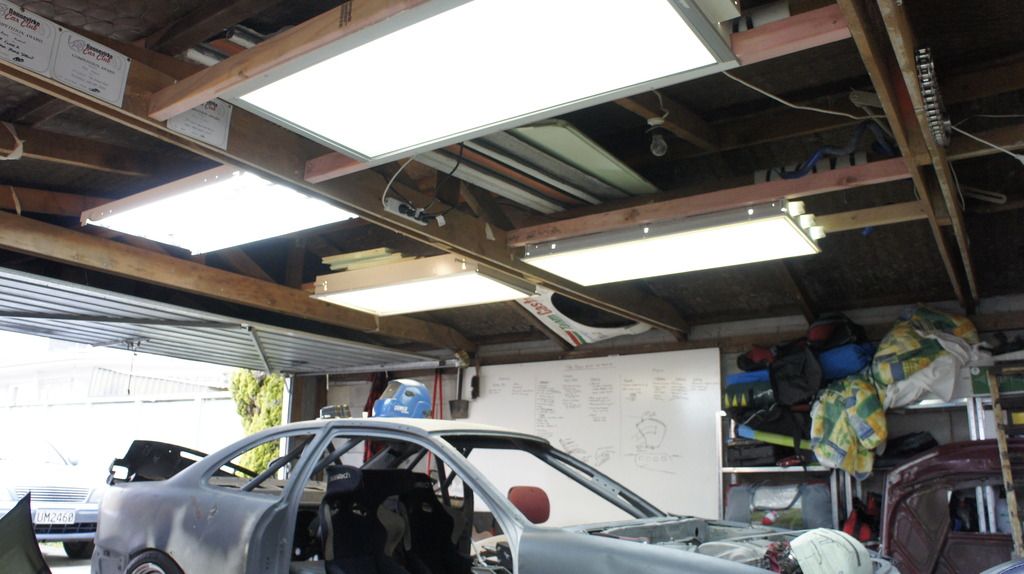

So god damn jealous of your white board.
Hah I had it sitting there for like the last year and didn't even think of using it!
I've got another sheet of the same stuff lying behind it currently. Can be anyone's who wants to come get it for a box of beers.
