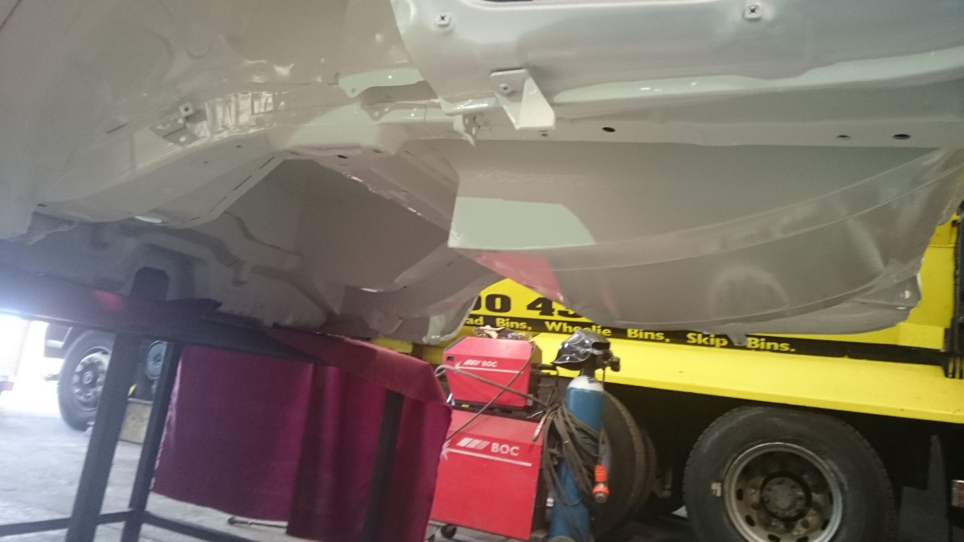

This thing is back to being rolling yuss!
Paint turned out really good in the end

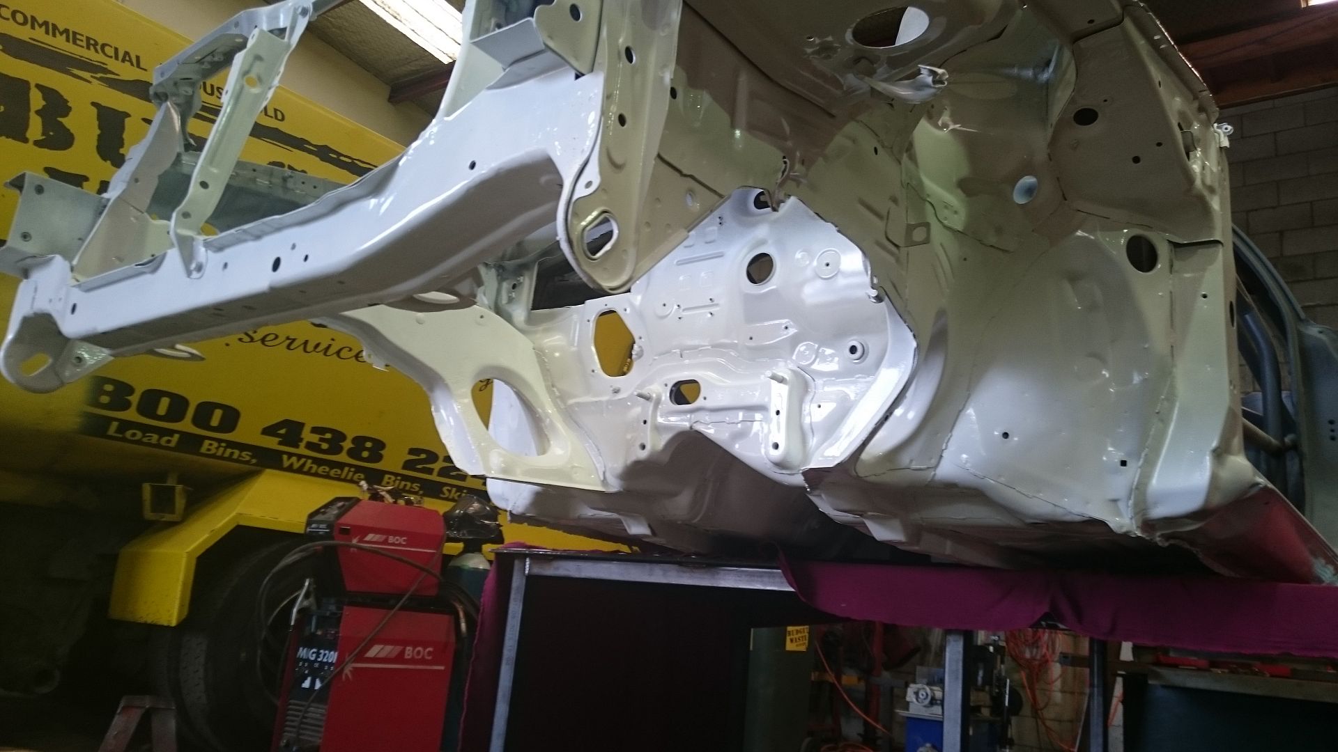

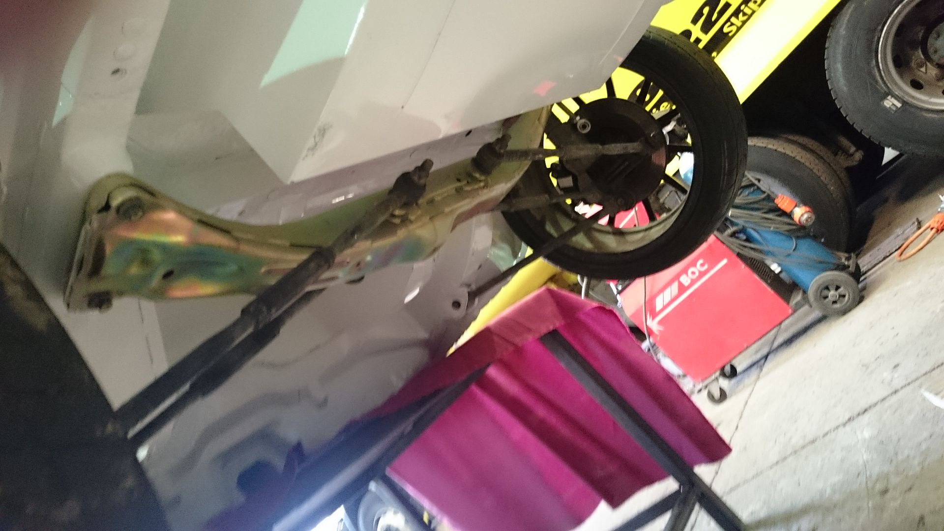

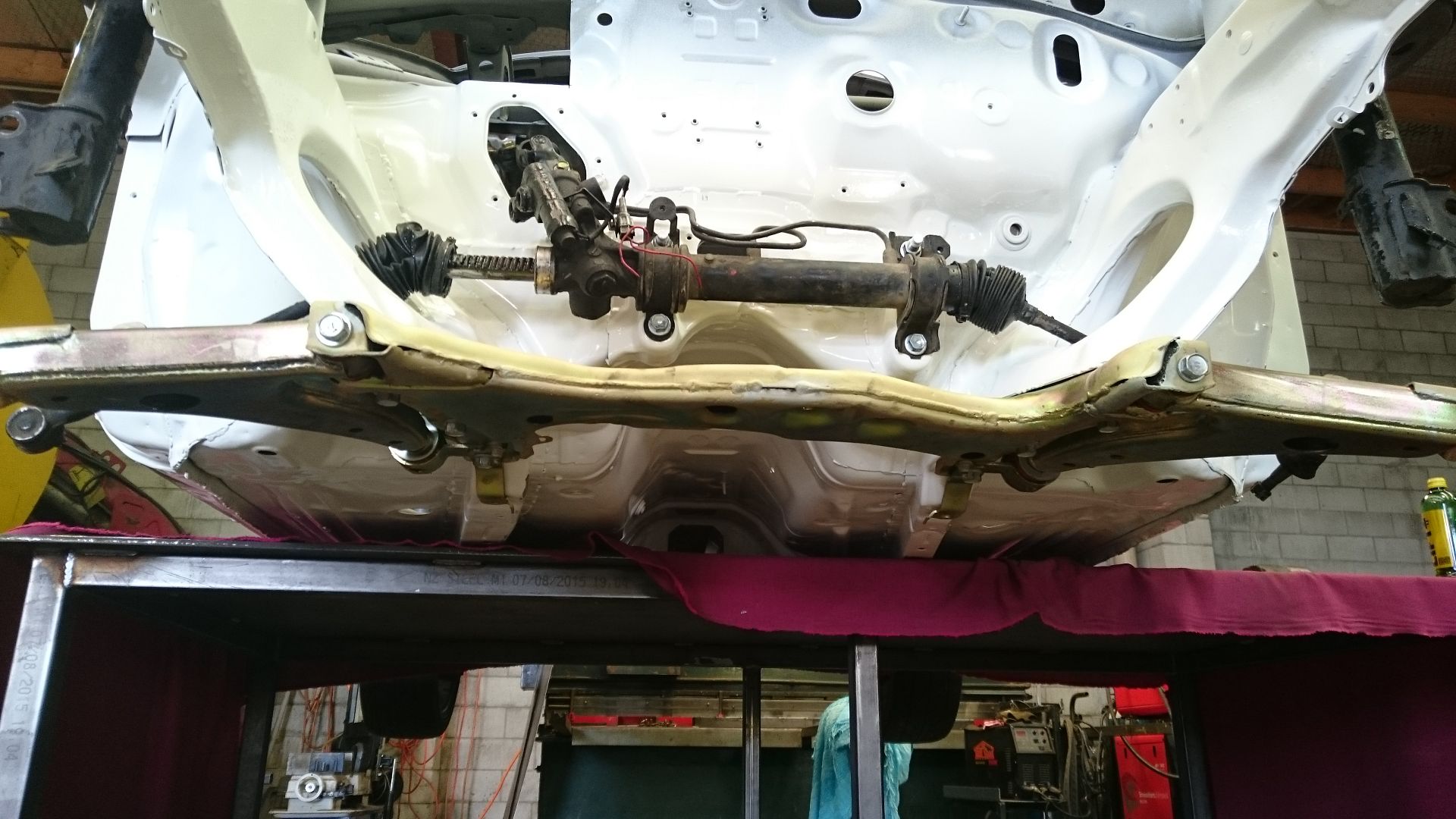

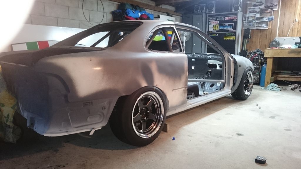

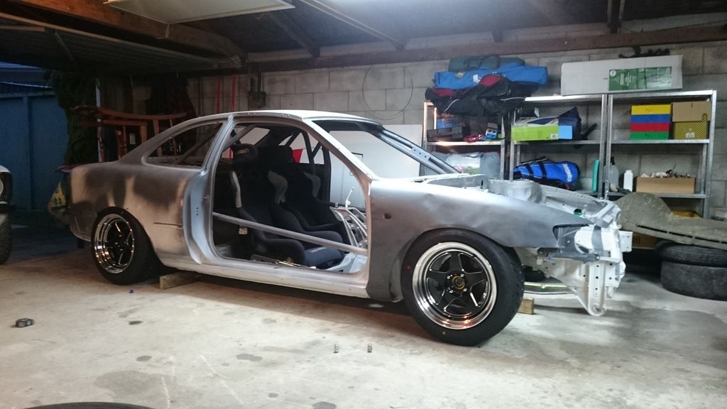

Subframes back in - still need to tidy up the arms and steering rack with a fresh lick of paint.
Forklifts come in handy..
Has now made the move with me to Hamilton. Good to have it in the shed again.

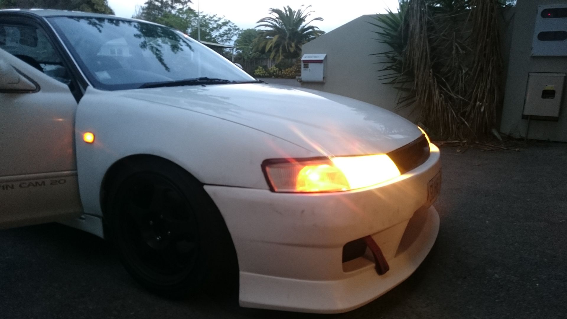

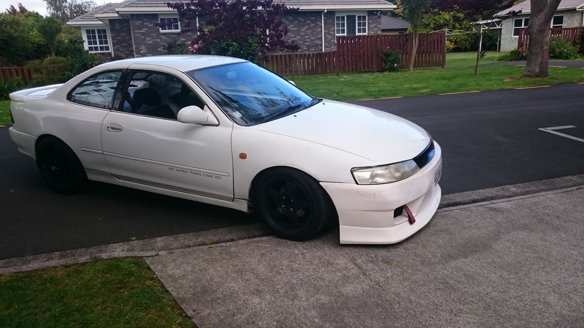

Test fitted the front bumper the other day on the daily. Wanted to see if it's going to be suitable for racecar and if looked OK.
Looks a bit drift kit ish but changes the look of the car quite a bit.
This is now the daily struggle. My driveway isnt even steep and it scrapes. Also 3 wheels going over the driveway.
Since kit has indicators blanked I did some Andrew-spec wiring alterations to the park lights to make them into indicators. Which means I don't have Park lights now but meh won't be an issue.. Looks pretty good i reckon.
Looking into options for painting bumper. Will keep it mint and change it to the stock one if I'm driving any backroads. Should be mint for smooth roads/track use

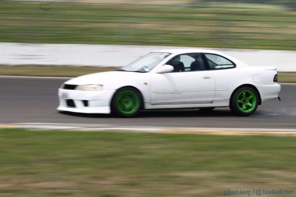

So in order to scientifically prove this I entered a trackday at taupo and booked myself in for an epic tarmac hillclimb. I had the same Tein coilovers in the car I ran in the racecar previous to rebuild so had a decent reference for how it drove. Used 400lb springs front and rear with Cusco swaybars front and rear along with the same old Semi slicks that have been sitting in the shed for the last 3 years..
Things went well. Lapped around the 1.46 mark on Track one in the afternoon.
In summary from trackday;
1. Front swaybar was awesome. No understeer at all and perfect front/rear balance with rear stepping out when I wanted it to. Spring rates were perfect albeit a lack of suspension travel probably helped me out
2. open diff was painful but wheelspin not as bad as expected. They are shit and effect handling SOO much in a fwd car.
3. People who drive Skylines and GTR's are a bunch of pansies. Come on people if my 100kw POS road car can beat your uber power car around the track you're doing something wrong!
All in all lots of fun and doorty noises were had

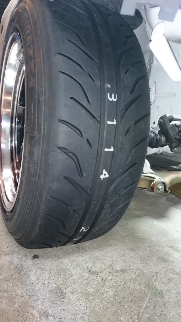

All my wheels went with the daily so time to buy some new wheels and tyres. These will be my road tyres. Went for a dunlop DZII which was unfortunately only available in a 195 but the tread pattern is pretty cool which looks like the footprint on the road will be more like a bigger tyre with a conventional tread pattern. Will see how they go.

Ride height sorted:
Pretty happy with finding a modern wheel in a 15x8 that looks pretty good on the car.

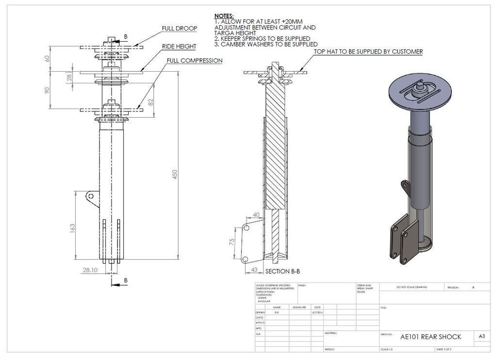

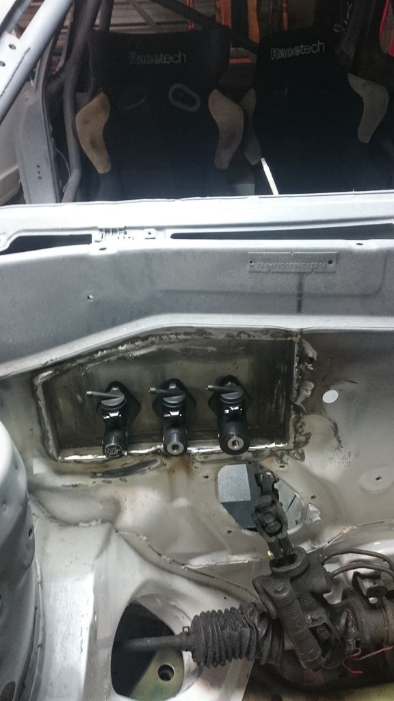

I drew up the heights for the shocks so it sits at the current ride height. Want to allow plenty of adjustment as I'll run it higher for road events. I'll have to invest in some pretty tough underbody protection also I think! Haven't got a delivery date for the shocks yet but I'm getting pretty excited.

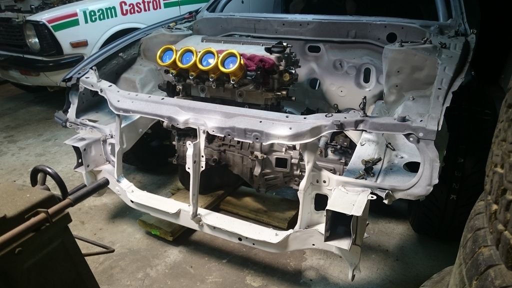

Engine is back in the hole also. After the rally I'll put some money towards urethane-ing engine mounts so I can bolt it up properly and start making exhaust manifolds etc.
This is currently my biggest issue now that I'm actually in a position where I need to confront the bonnet clearance issues. I know the rocker cover clears the bonnet so looks might be a bit deceiving.

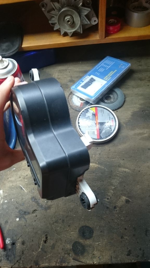

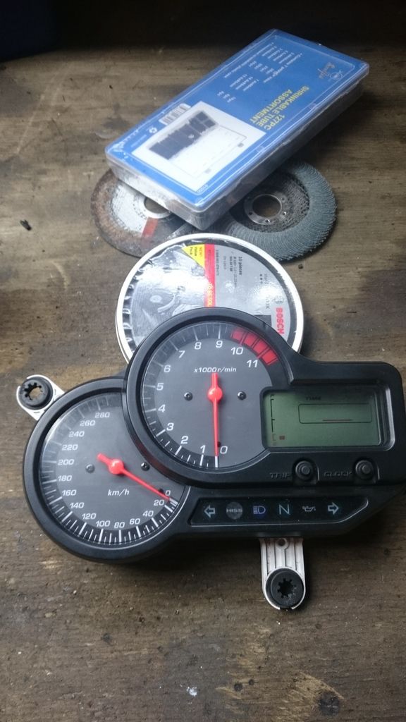

Going to go for a curved set of fibreglass trumpets from Glen I think. Either that or try 3D print some of these.. Pretty cool huh?
2009_Kawasaki_ZX6R_ZX600R_09_INTAKE_FUNN
  • Like 6
I kind of have to concede that I need them and I'll have to make everything else fit around them. Even if it means still doing a bonnet bulge it will be 30-40mm smaller than if I used straight trumpets so still worth doing.
I've got a few ideas to disguise the bulge so it doesn't look too hideous. Once this rally is gone I'll have some spare cash to start buying things for this again =)
Could you not offset and relocate the intake from one of the similar doo-dadery's
eg. one of these
..but cut and moved to the position you require, being only slightly offset from centre it might still appear stock to the untrained eye.
