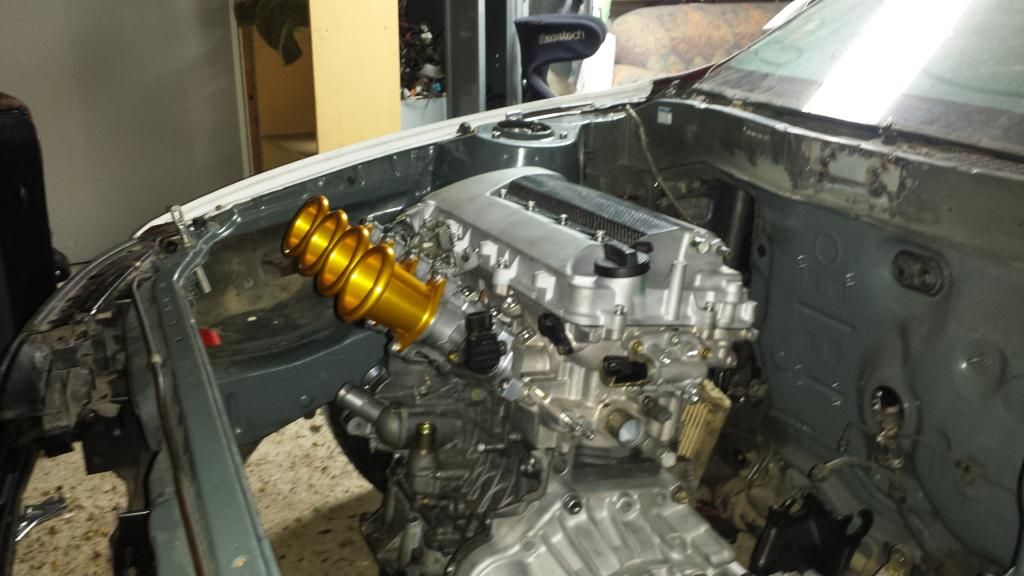

Gearbox all sorted and bolted up. Plenty to re do properly but at least I can see how it will sit.
The good;
- It fits (ish)
The bad;
- sits too low. Will smash sump to. Pieces at current height
- needs to be leant forward heaps to flatten out sump
- looks like I will need cutout/hump in bonnet which I really want to avoid if I can (outboard injectors will sit out even further)
Onwards and upwards. Plenty more to do after rallying is over for the season
  • Replies 556
Definitely looks very tight, especially if you have to lift it and stand it up a little more still. If you stand it up, will you be able to push it back in the engine bay a little to gain a bit more clearance?
I can push it back a little maybe 30-40mm but it is quite tight against the steering rack. Considering I've got to fit the extractors on the back of the engine and around the steering rack, I don't want to close the area up top much yet
Normally I'd like to say I agree with you Dave but the thing is btcc spec is reliant on the gearbox output shaft location being further up and also the option of having the output on the front would be super helpful. This is cause you either need to lean the engine back or forward to get trumpets to fit and axle location is always going to be the limiting factor.
I really would love to have $25k sitting round to buy an xtracc gearbox that's not really realistic.
^^ That's not such a silly idea. Would have to install a external sump/resevoir/pump to spray oil around inside but other than that and how to lubricate the diff I don't see why not..
Nah mit or needs to be intake facing forward it's pretty much the whole reason I did this rather than building a serious 4age. I've got to talk to a very clever man about the size of the intake and airbox as this may determine if I can use a scoop or if it'll need to fit under the bonnet
Yeah Joe's idea is best. The box would likely be splash lubrication so not too much worry there, just need to make sure the diff gets a good feed of oil being so much higher. I looked very seriously at this, but the biggest issue was relocating the starter, which is actually quite tricky. Moving it to the front is pretty much the only option but there is no meat there for it, so would have to make something meaty, and my BTCC-ness means I'm reluctant to move that much weight in front of the engine.. haha

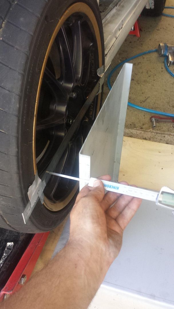

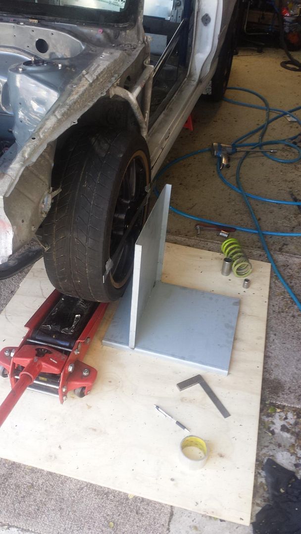

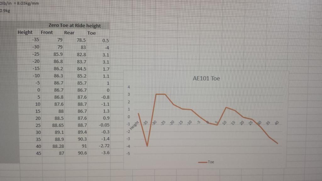

Looking at CNC'ing new hubs for this as I always suspected the geometry was bung. How wrong I was! It actually isn't that bad with only +/- 1mm in most of the stroke length. Still worth doing the hubs though to correct the roll centre and reduce unsprung weight a bit as I'm building bilstein shocks as well so can slam it heaps and have it work (full compression will see 50mm of ground clearance).
Made a jig to measure accurately.
Plan is to make it standard replacement fitment so brake mounts and lower ball joints can be re-used, making it more universal for people wanting to buy. Will be made out of chromoly so the design can be approved by LVVTA certifiers which will make it even more valuable! Once I have the geometry I can make a full race item too, possibly out of Alloy for the likes of dads and Grants cars.
This is the ride height I'll be aiming for - trying to decide on where exactly it will sit as I don't really want adjustment on my shocks, only by clevis. Still not sure about how that will go. Apprently 50mm travel in each direction is what I should be aiming for - a bit on the short side in the front but that won't be the end of the world.

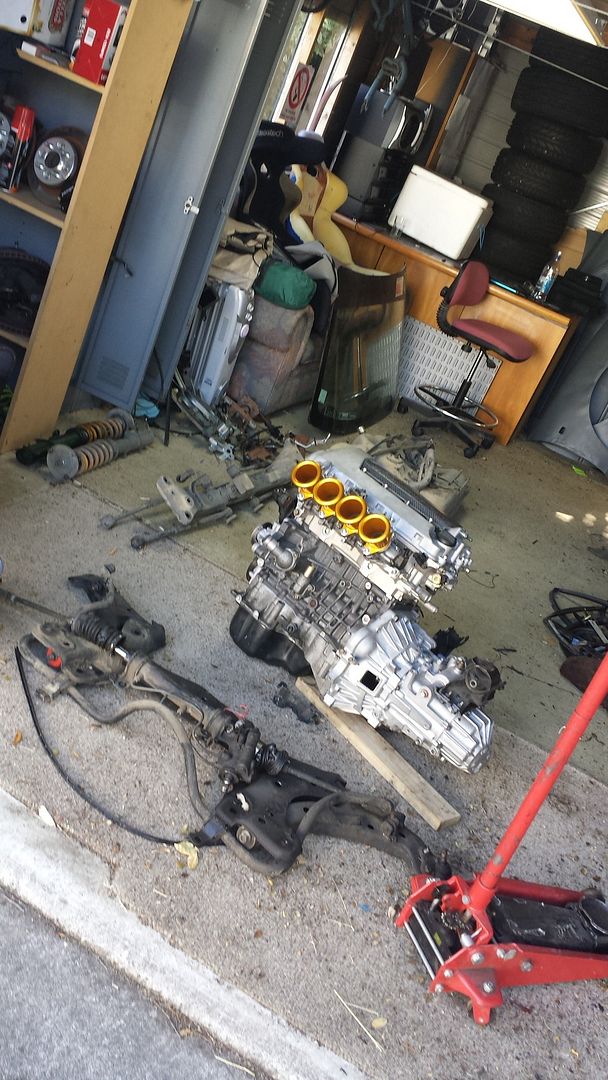

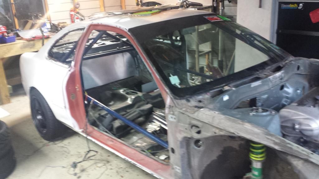

Progress has been made.. been stripping it back to a bare shell so it can be sandblasted. Reason for this is to tidy up the whole body and allow everything to be painted mint.
Rear windows out
Pretty much made a massive mess of my shed pulling everything apart. Need to spend a good day water blasting all the dirty crap that came out

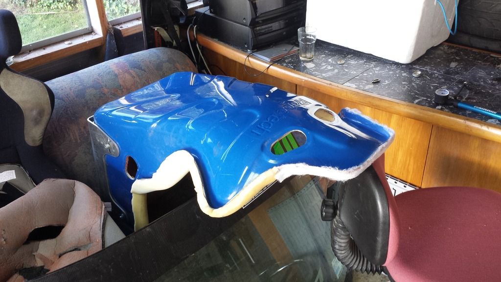

I bought this seat off dad for the passenger seat. It's a racetech 4000 so the ol d 4009.. has been re foamed and covered not long ago so is in brand new condition. Only issue being the blue gel coat.. have stripped the seat so I can paint this black after I get back from holiday.

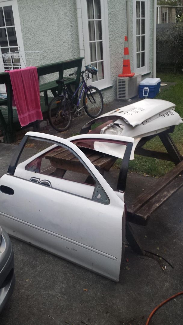

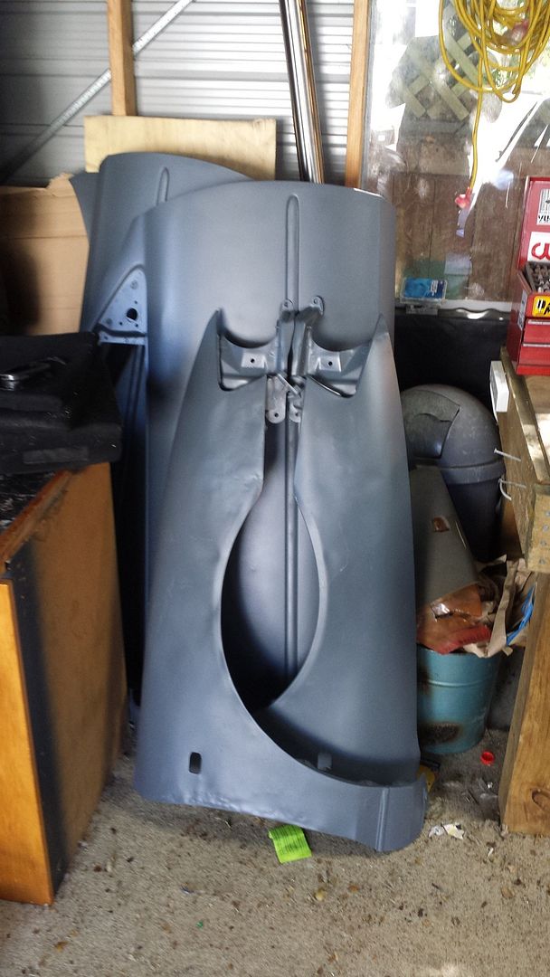

Got doors and panels sandblasted. Didn't realise how much bog was in the front panels. These ones are rooted so I've sent my spare set down to get blasted which look to be in a bit better condition.
Really happy with how the blasting came out did an awesome job and will def make the painting process easier.

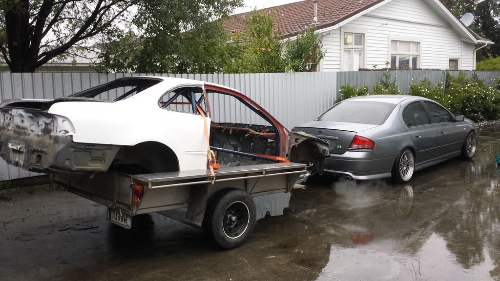

How it went to the sandblasters..
How it came back...

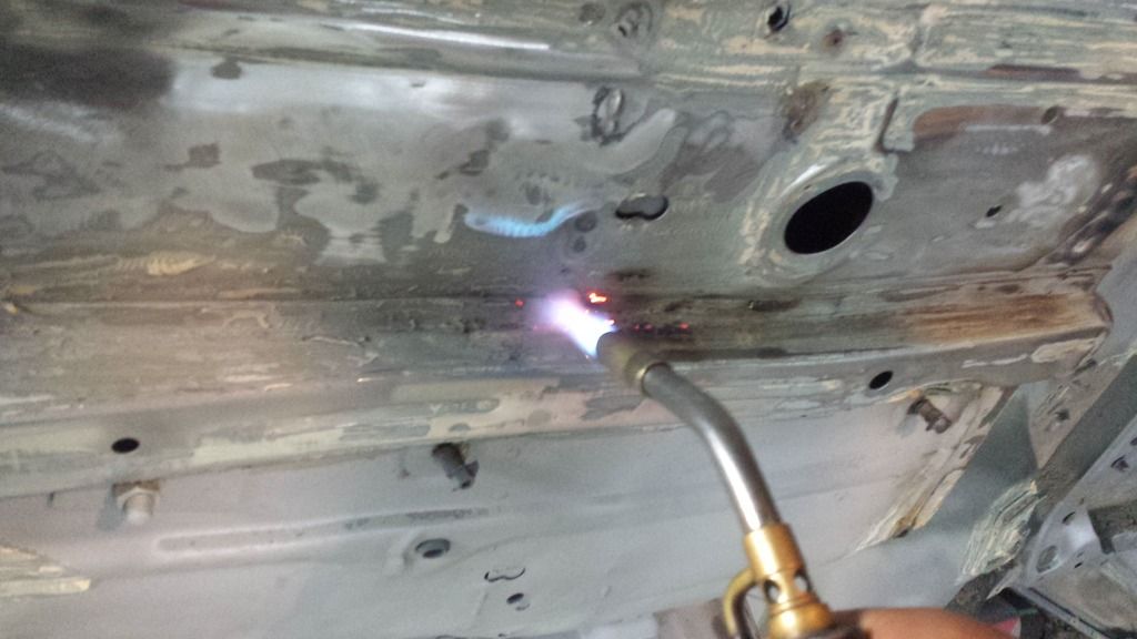

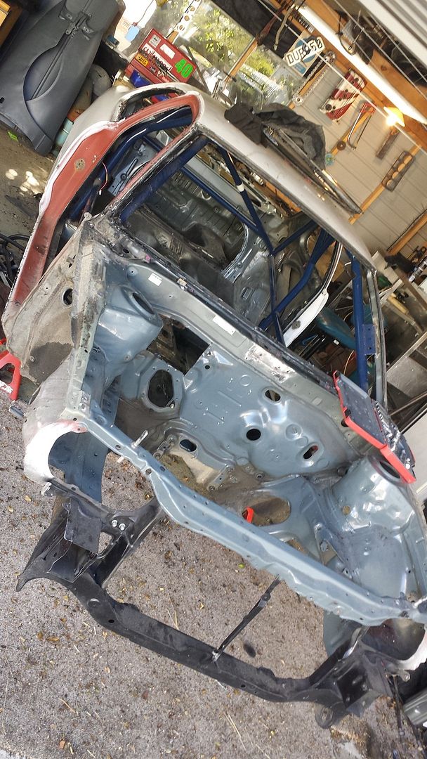

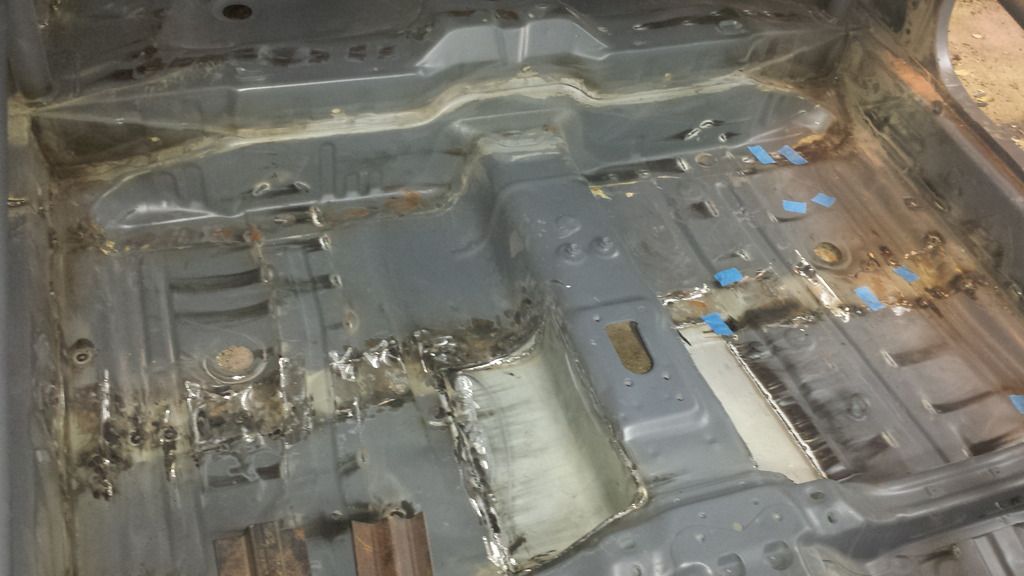

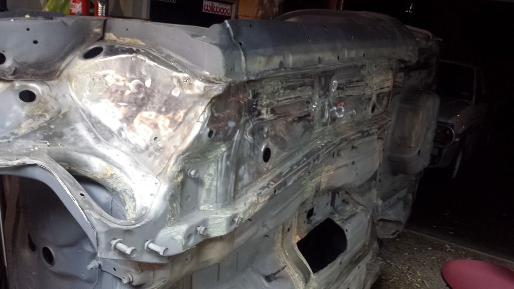

So now I've got a massive job of stripping all the underseal and sealant out of the car in preparation of seam welding the chassis. Main reason is cause I want to do it properly but also cause the chassis was fatiguing in a number of places. Really makes me understand where the strength in the chassis is and where I could cut weight out if it wasn't going to be road legal..
got a few mates around the other night and turned it on its side. The chassis is so light maybe no more than 200kg with nothing attached to it..
This is where I'm up to now - ready to flip back the other way for ultimate working height/comfort..
Heating all the seams to get the sealant out from between them.
Seam welding and cutting lots of holes in panels to come next!

More progress.

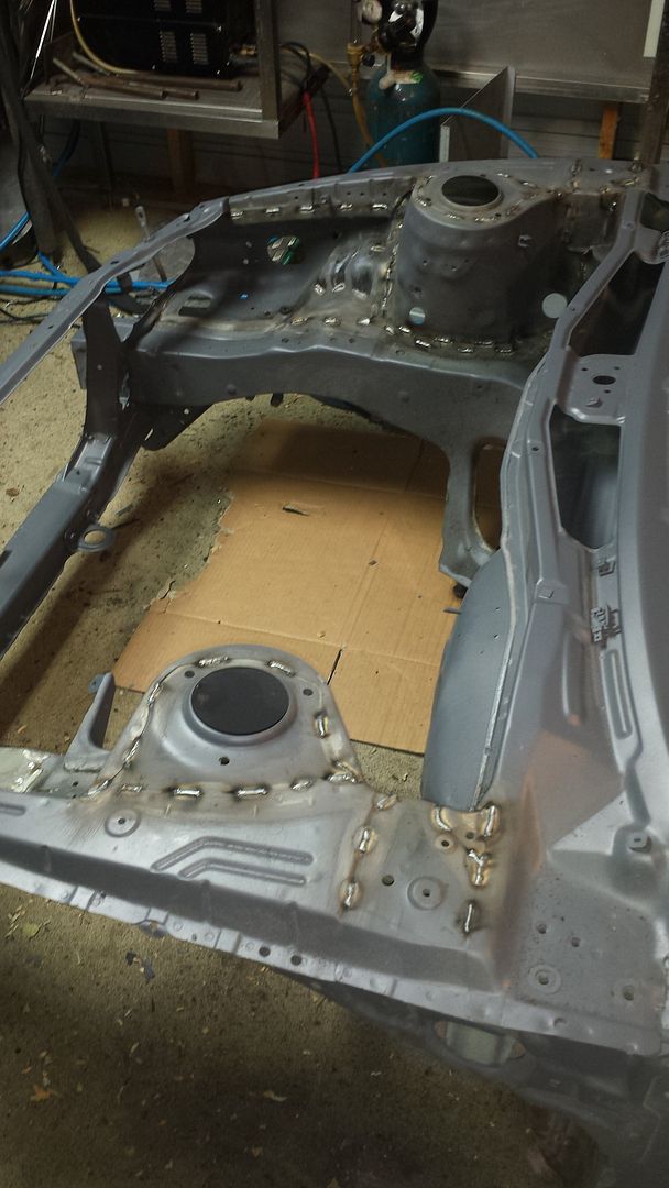

Finished cleaning up all the seams and seam welding the chassis. Once I got into the swing of it it wasn't too bad and Simons welder was ace for it.
Sneak shot of engine bay:

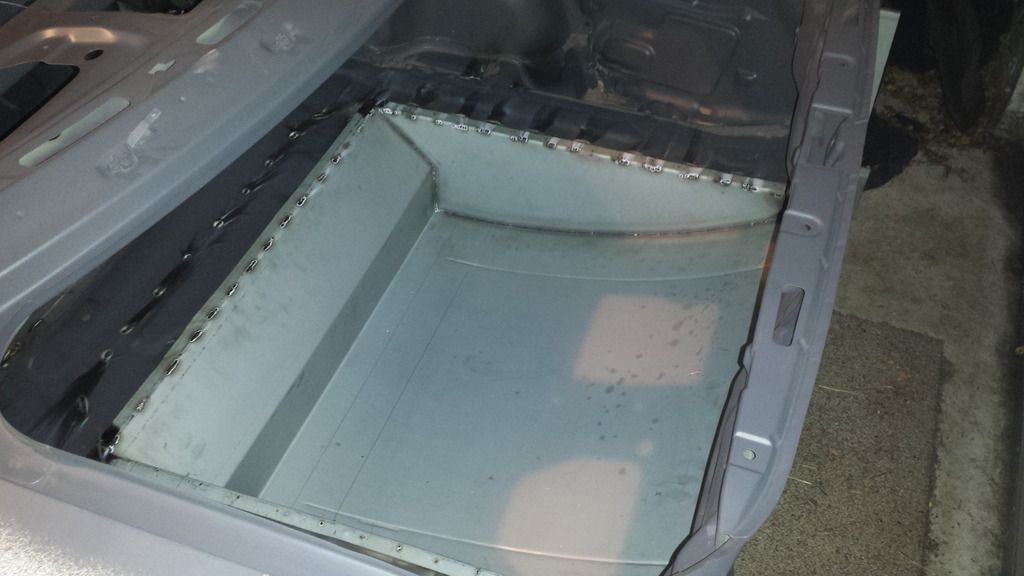

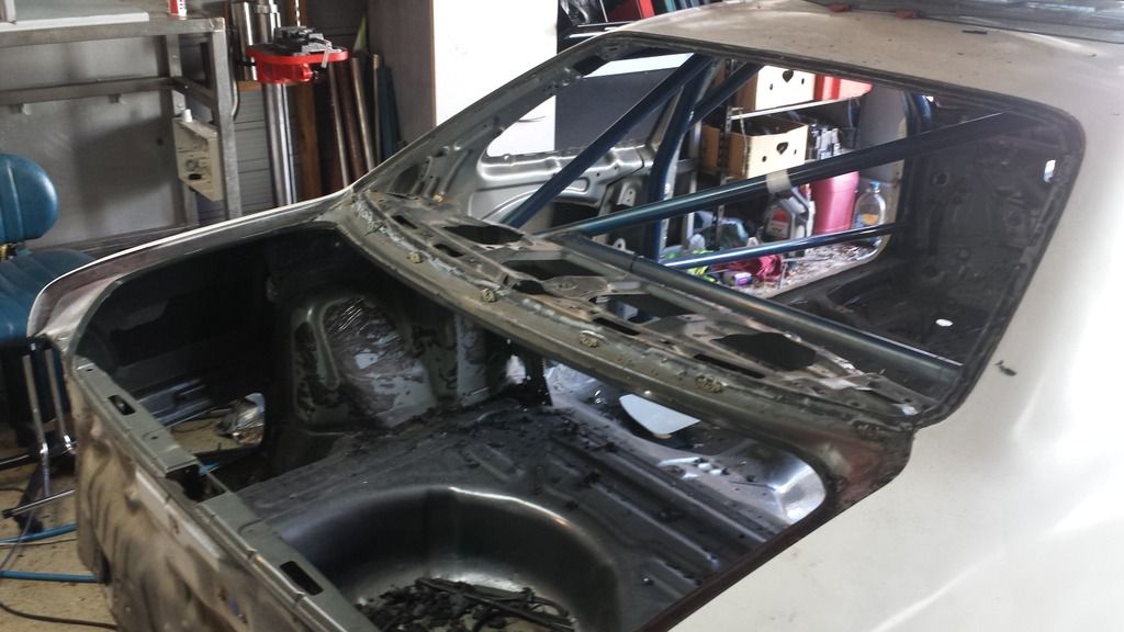

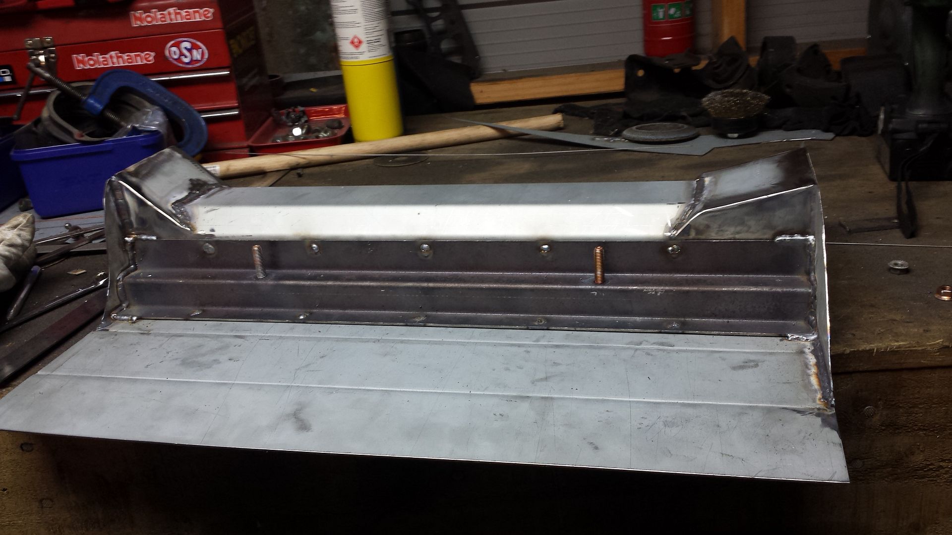

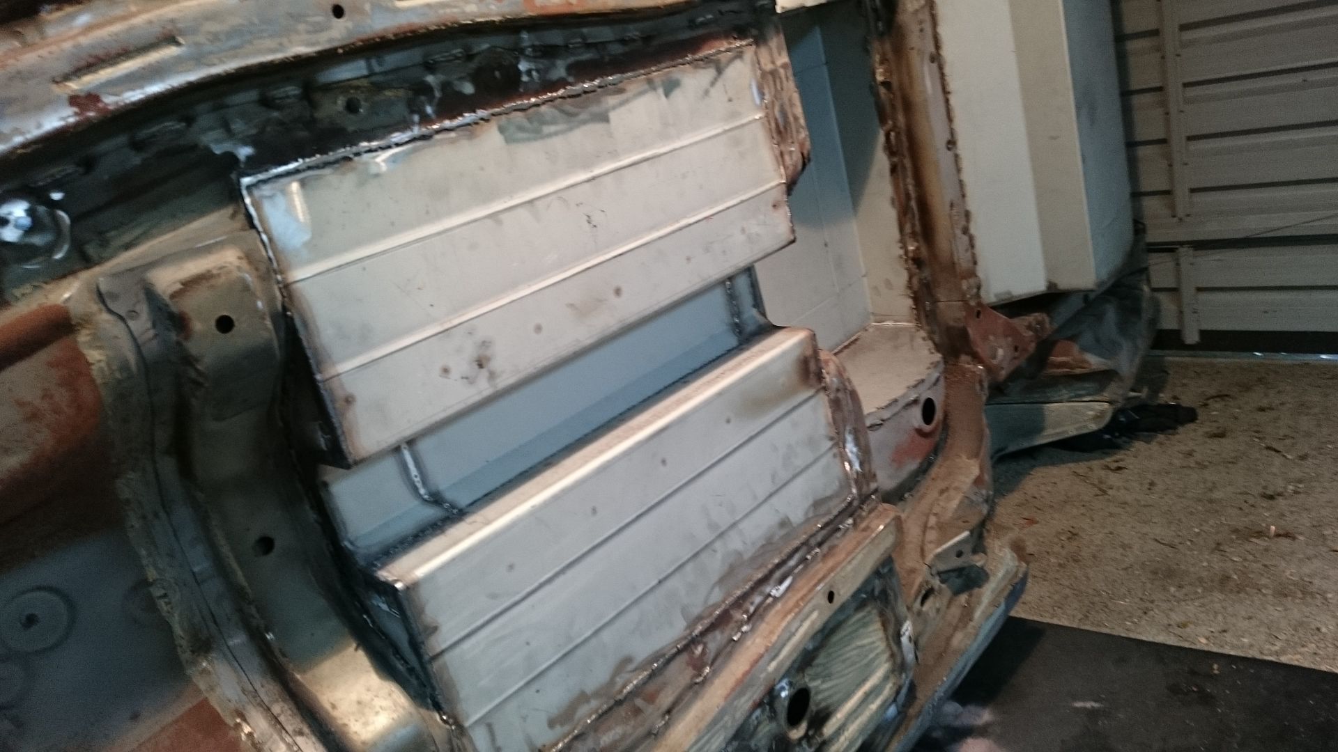

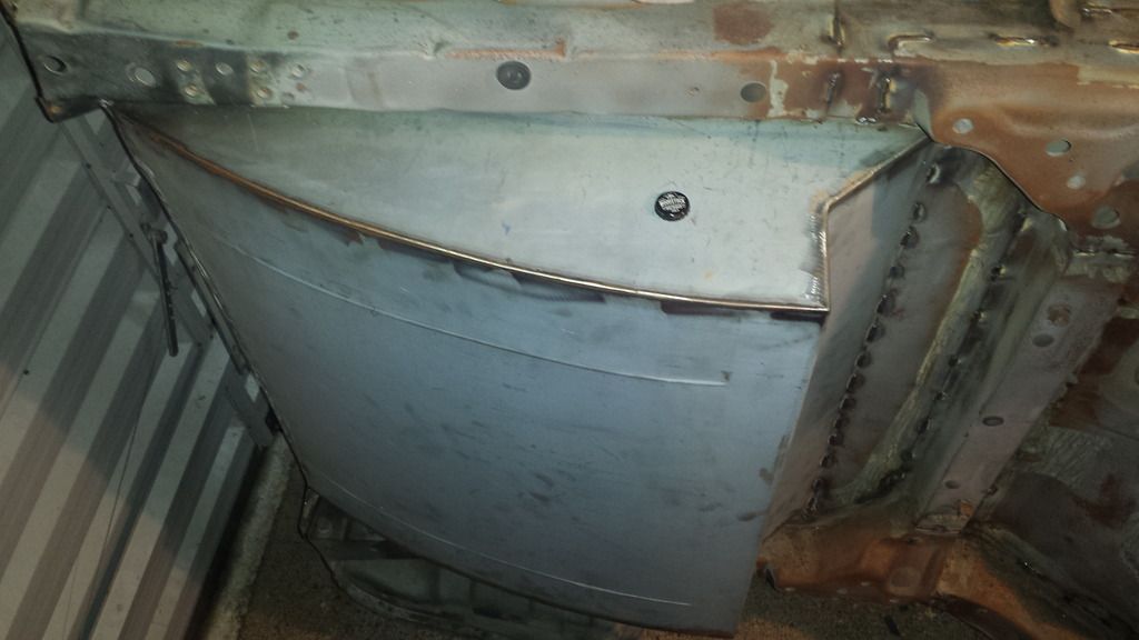

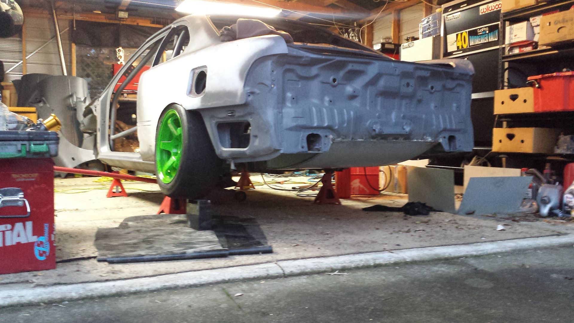

Decided to cut the spare tyre well out and make a diffuser from some Sheetmetal. Quite happy with how it turned out. Will add fins and underbody panels once all the bumper (what will be left of it) etc goes back on
Currently working on trying to figure out how to get the exhaust to exit above the diffuser.. best option so far is to weld up the rear section of the staonless exhaust then weld it into a 3" mild steel pipe and weld it into the car.. just means the rear section will never come out. Undecided at this stage - open to ideas!

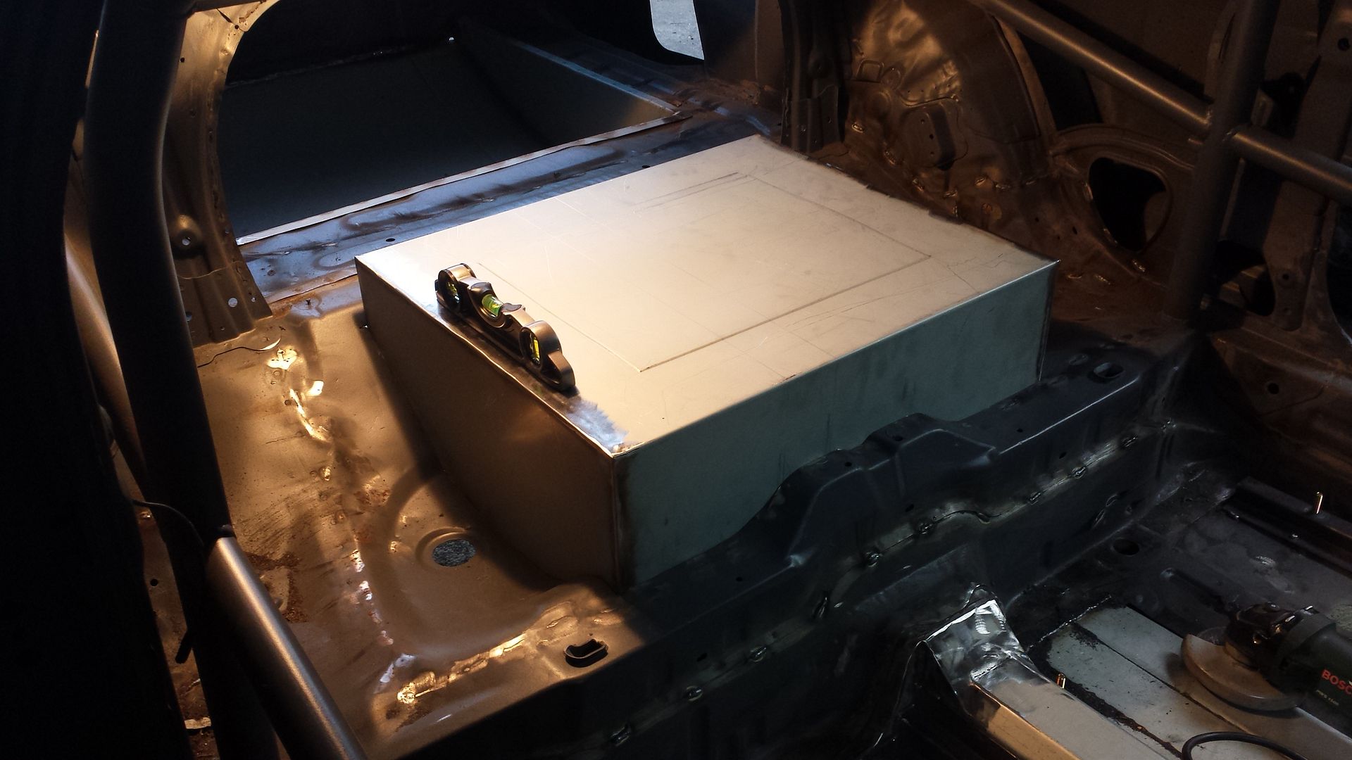

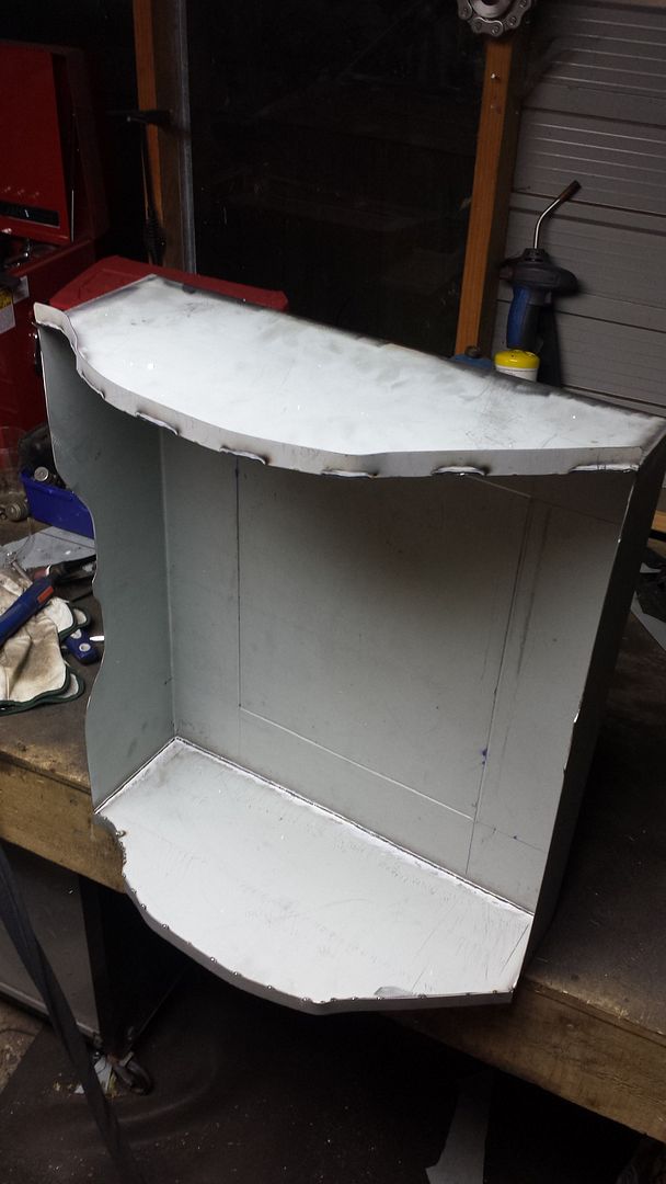

Also making a box for the 60l fuel cell to sit in the rear seat. I decided on 60l because the long term goal with this car is to do targa. The standard 45l tank would of never been enough and also gives me the option of endurance racing. The old man's ae82 uses approx 1l per km and this will be making about the same power so when being thrashed it's sure guna drink the gas..
Just trying to source a jaaz fuel cell with all the fuel senders etc for a decent price.

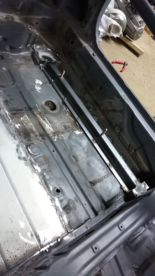

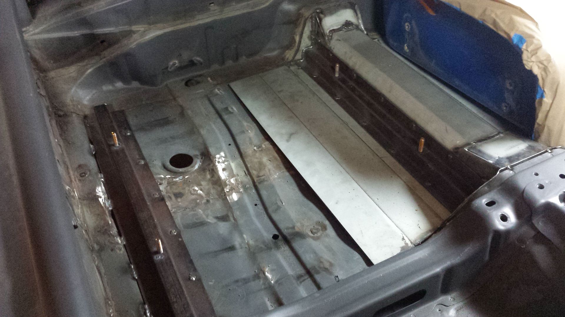

I know this doesn't look like much but for me this has been a huge step forward welding in this cut outs in the tunnel and finishing off the floor repairs. There were so many holes I'd drilled in the past for seat/battery mounting! I filled at least 15 on just one side of the car.
Next step is to mount the seat rails and mock up the dash.. then it will be off to the sandblasters again for the shell and the dash will be sent off to be flocked.

Tunnel being finished off. Spot welded inside mount on for max flushNess.

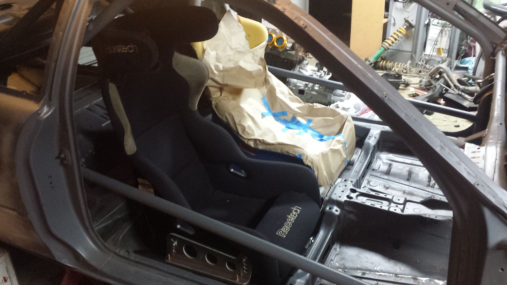

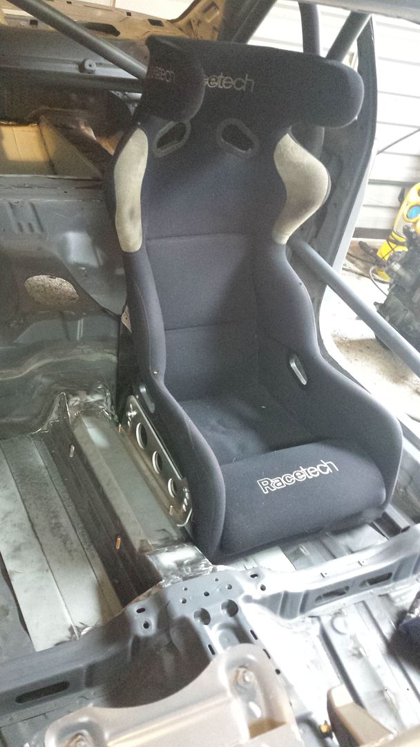

Pretty stoked with how the seat mounts turned out seat sits so low it's literally less than 5mm between the bottom of the seat and the floor..
Laser cut some seat mounts. I've got a spare set anybody want some to suit a racetech seat??

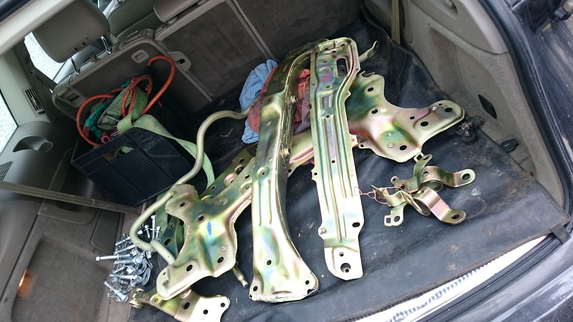

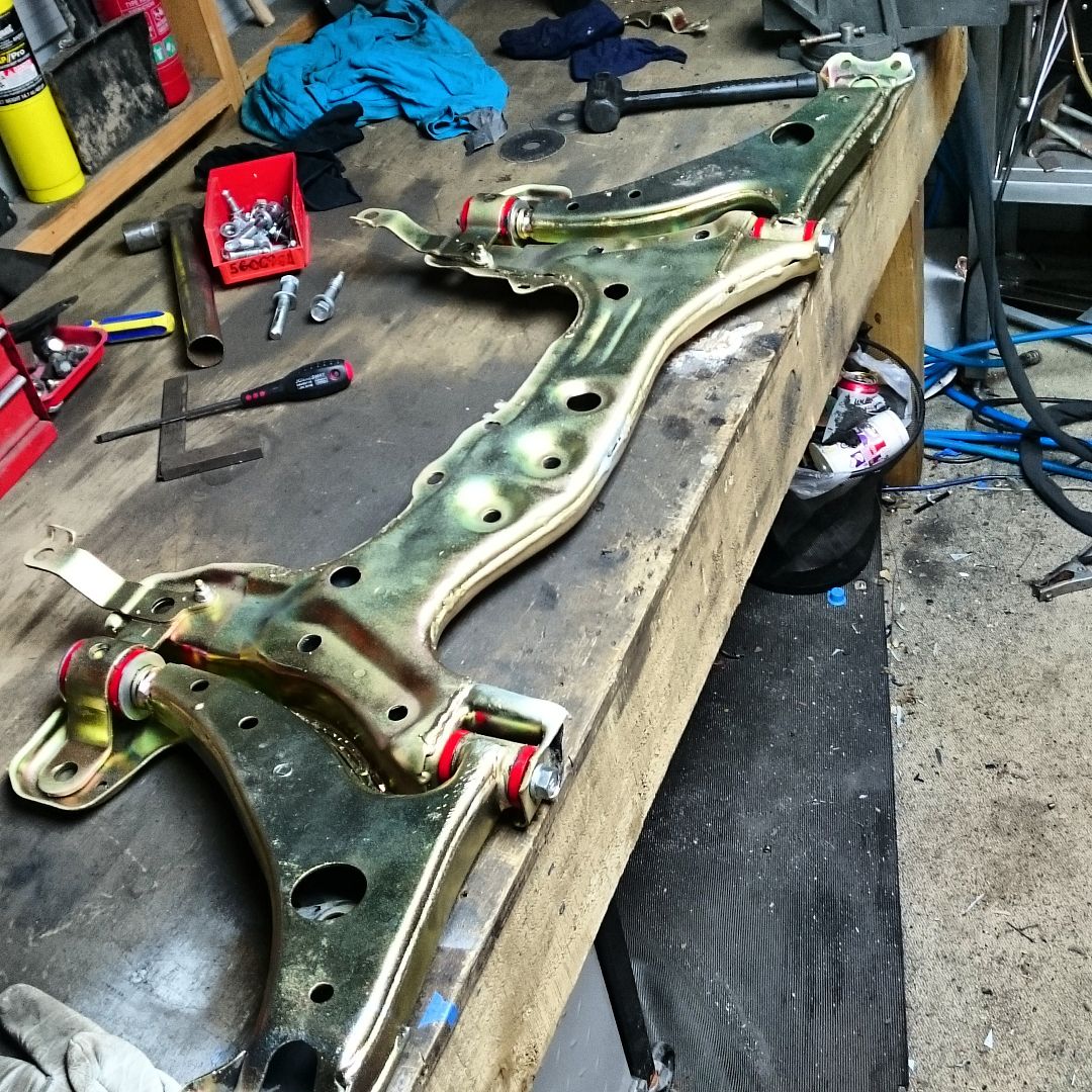

Getting some motivation for low. Subframe are currently being sandblasted and yellow zinc coated. Also just bought some white paint so we get to paint the underside before it goes back on its wheels..
