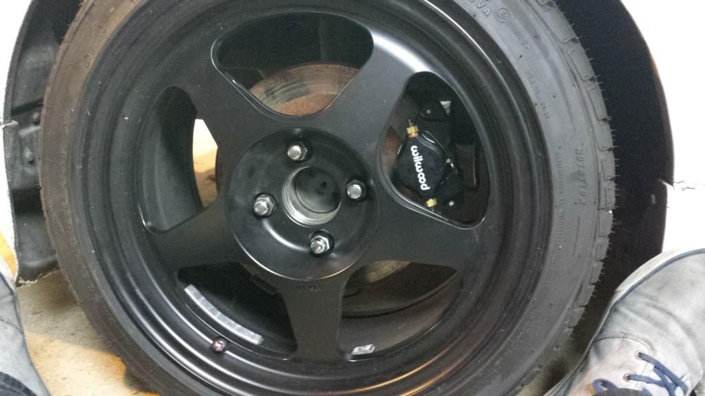

here are some pics of the wheels and fitment luckily my race wheels fit perfectly as well with 25mm spacers all round.. if only I could find some 0 offset wheels that look awesome on fwd cars.. maybe some sportmaxx's?? lewl. also took the crappy castor adjustors out.. fuck me I am lucky they held up were bent and thread as screwed and bolts only held in by a few threads... just yuck never again! so this is how it will sit now camber-wise. will pull some castor into it on the top hat when shocks are away getting shortened..

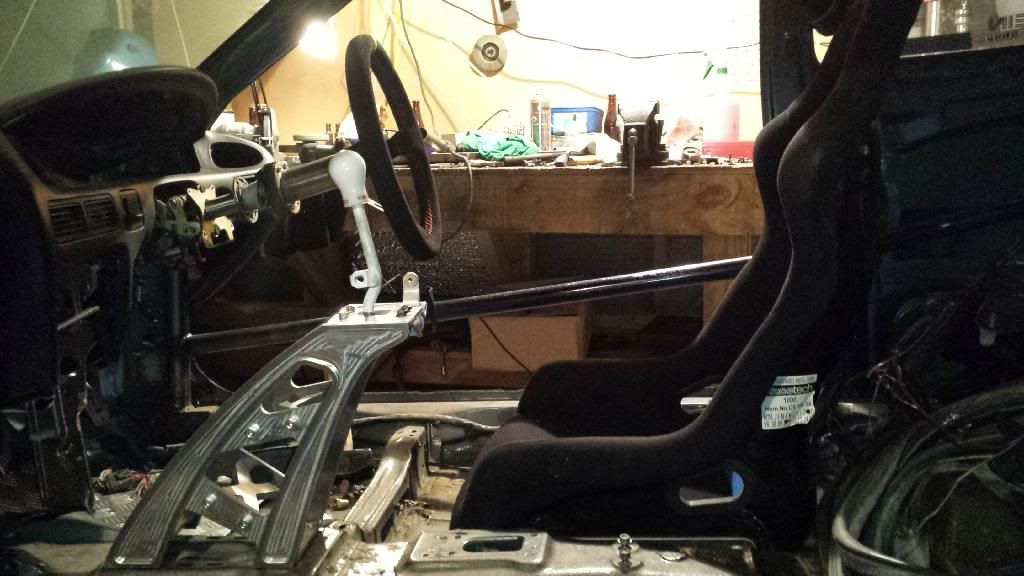

had a bit more of a think and measure for the gearstick.. needs to be raised 300mm from the top of the tunnel and back by about 200mm from standard position. should work really well with the reverse h pattern and being at the right height! been working on CAD during smoko/lunch but just trying to figure out the best + lightest way to manufacture it as there are a few weird angles for widths of bolts etc... might simplify it a bit by oversizing the base and having the sides straight. need to make sure I make enough allowances for switches etc.

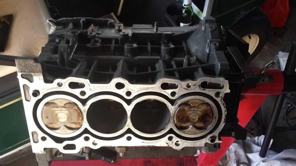

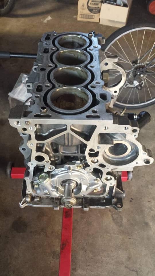

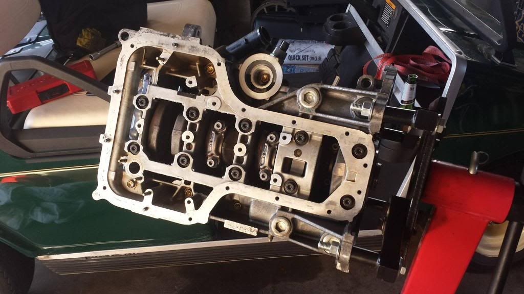

The bottom end was put together with copious amounts of bourbon and a fantastically dimensioned TE37 chillirim!
the 2zz is a really well designed bottom end with strong crank girdle and all nicely packaged. the head is even better designed with direct and short intake and exhaust ports.. looking forward to hearing this thing scream I think the 2zz design has plenty of potential in the future as more engines are parts become available!
Test fitted the flywheel and turns out I can't use the 4age flywheel bolts (5mm longer) and seeing this is a weak point of the engines I'll be ordering some ARP bolts to suit.

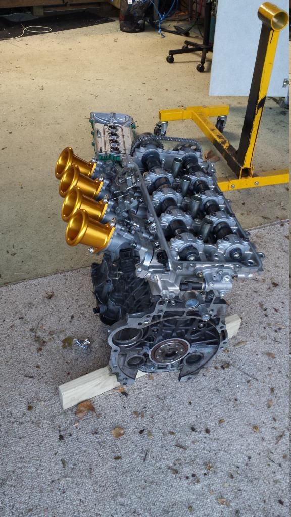

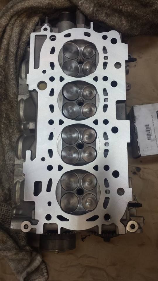

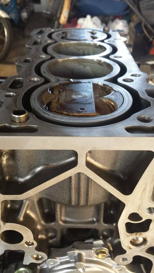

Engine is all finished. Ended up pretty much replacing everything in the head except the intake valves as it was in pretty average shape.

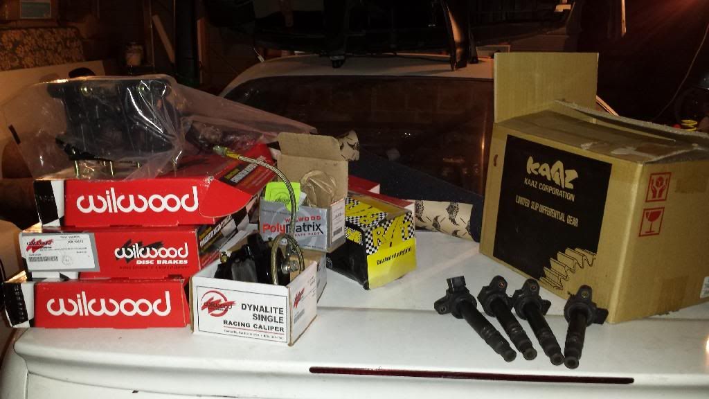

On top of that I ordered a whole bunch of goodies from Monkey wrench racing including; Kaaz plate diff, ARP rod bolts, Cosworth super-thin head gasket, Uprated valve springs

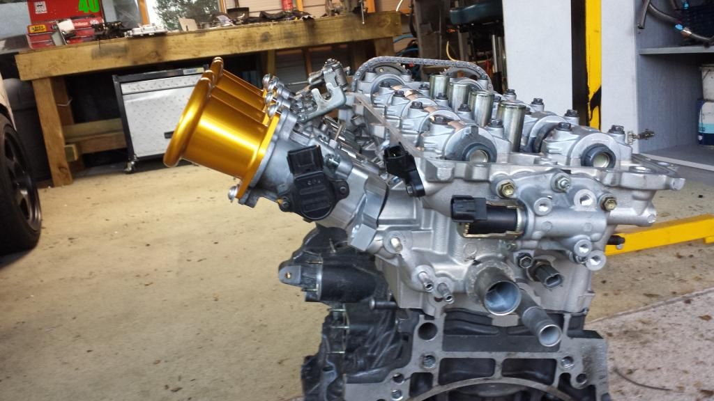

So engine-wise I've been planning the intake manifold which I'm still trying to find someone to CNC (haven't heard back from my contacts :( ) The easiest (and best) way to do an intake manifold was to make the blacktop throttle bodies round instead of the odd shape they are from factory.. machined them out and pressed in nice inserts with a 2mm (dia) taper. really nice finish I think this will work a treat.
manifold design to bolt blacktop ITB to 2zz head;
Got a bit more research to do on which injectors to use for the outboard injectors. I will def run a bosch motorsport injector but which spray pattern and angle I'm waiting to hear back from WRC developments who will be tuning the car as he has had a lot of experience tuning mid-90's BTCC cars. I'm in the process of drawing the throttles from which I'll be able to design the outboard injector cradles and start looking at the airbox design.

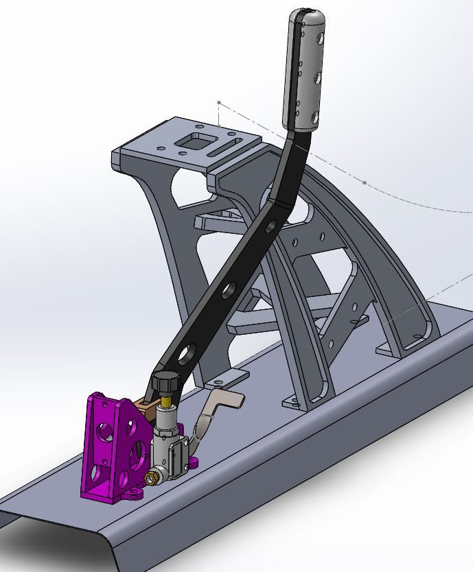

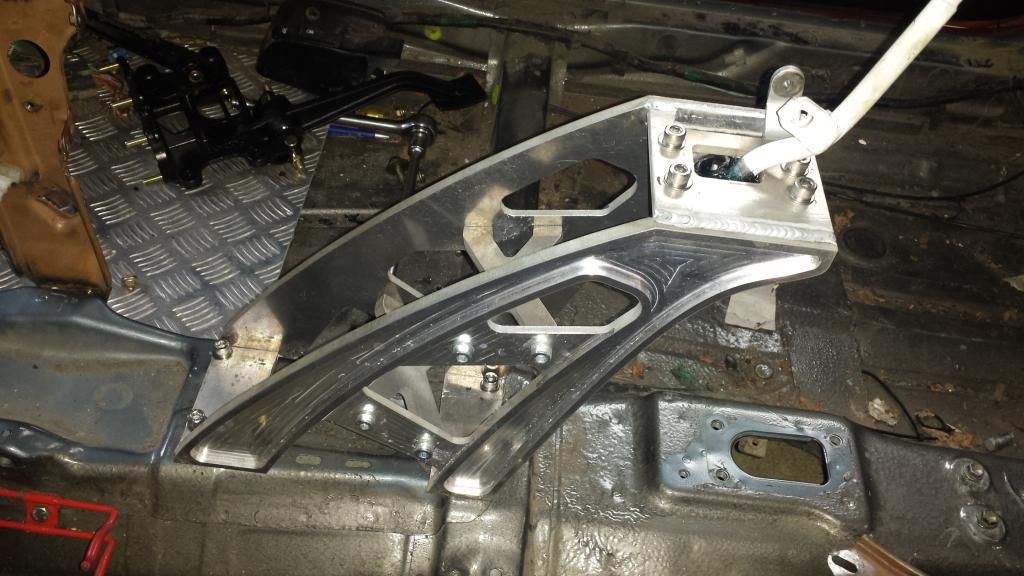

Ended up mocking up the ae101 tunnel so I could see how it will all fit (both the handbrake and gear raiser bolt up to standard bolt holes)
The top of the handle will sit just above the base of the shifter. I'm confident this will work with my seating position and the bio-mechanics of my arm..

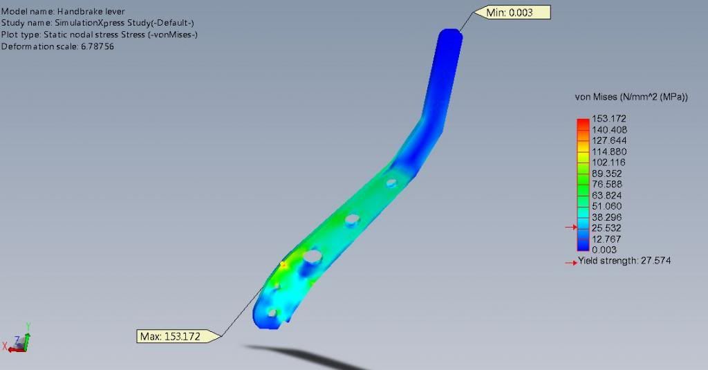

Another bonus is the entire assembly (excluding cylinder) only weighs 899grams..

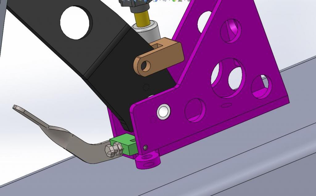

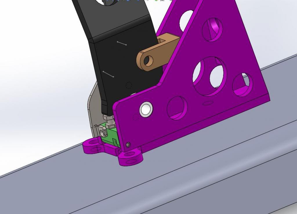

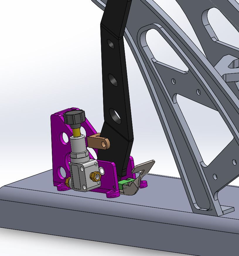

I wanted to intergrate the proportioning valve into the assembly so I didn't need extra brackets/complication.
Due to needing to be road legal I needed a lockout system for applying the handbrake in parking lots!.. most use a simple latch-over rachet type system which I didn't really like due to the possibility of it accidentally coming on while going over a rise/bump etc.
So I designed this little locking mechanism. has a small spring built into it as well so it will spring down (unlocked), to lock you simply pull up the lever until it clicks into place.. To release you simply take the weight of the handbrake and it will release itself!
Originally I was intending on having a shorter handle but how it worked with the gear raiser making it longer was better. I was a little worried about the handle bending under extreme force. So i ran a simulation of my hand pulling 500N on the top and a 5000N resistant force from the cylinder (about 1:10 pedal ratio). Passed with flying colours it is suprisingly strong!
May have to run quite a big cylinder to reduce the travel - that might be a bit of trial and error when I get the pedals and rear calipers set up..
I designed everything for ease of manufacture so in the next couple of days I'll get all the profiles ready for water cutting and get a guy and work to weld the few bits of ali together. There is a small amount of machining needed but shouldn't be too bad. I'm aiming for it to cost under $200 all up. Although I will prob go to the effort of getting most bits anodized or powdercoated before putting them together so everything looks flash..

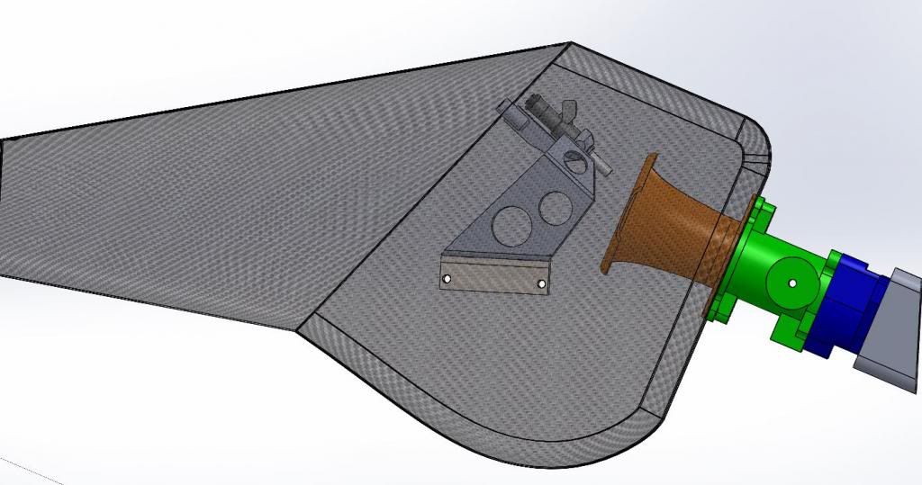

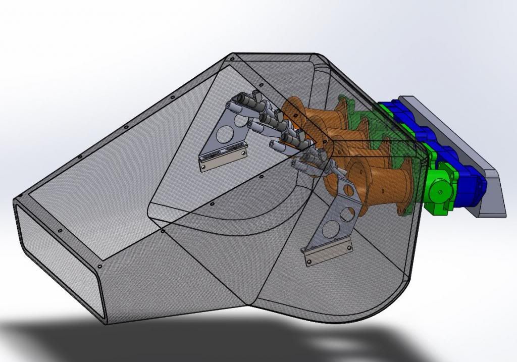

Oh yeah and this... starting to gather my thoughts from the last 12 months as to how this ITB/outboard injection is actually going to work. Looks promising/boss.

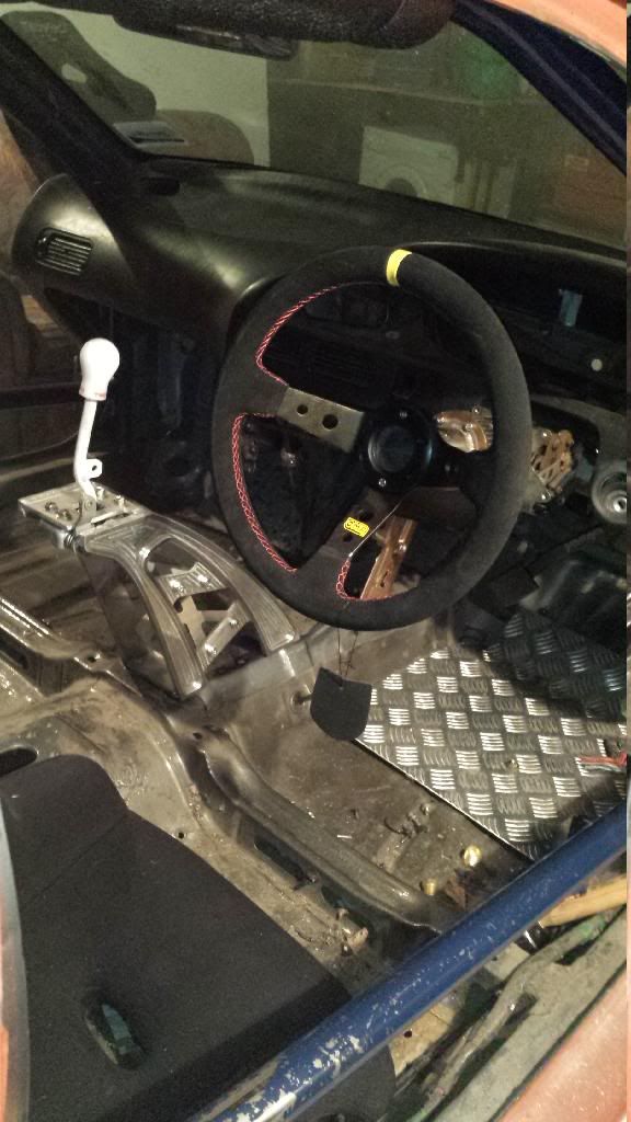

So got the shifter mounted tonight and tested out my seating position - It's mint!! need to bring pedals towards me about 70mm though but that is doable and actually makes clearances around the steering column better. Mounted the AW11 shifter as well for my reverse H-pattern. Couple of small things to tidy up but getting there.
Worked out what I'm going to do for the gearshift linkages as well. Will use a couple of levers on some bearings with adjustable pivot points so I can adjust how short I want the gear change to be. Will get onto some solidworks drawings and make sure it is going to work.

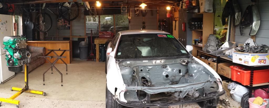

New shed is super lush as well

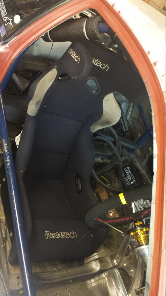

Bought a new racetech seat for this thing as my other seats are currently living in the rally car. Hopefully won't be forever but with the goal of going fast on backroads/doing targa eventually I thought it would be better to spend the money on safety..
Bit annoyed as it was advertised as good condition but I'd call it rough at best. Heaps of holes in fabric and is dirty as he'll. Think I'll be ringing up racetech and ordering a new cover to male this look brand new again.
It's a 4000WHR (wide head restraint) and is slightly challenging to fit in the hole. Need to cut out tunnel and replace with panel for seat mounting. Just need to find some time and motivation.

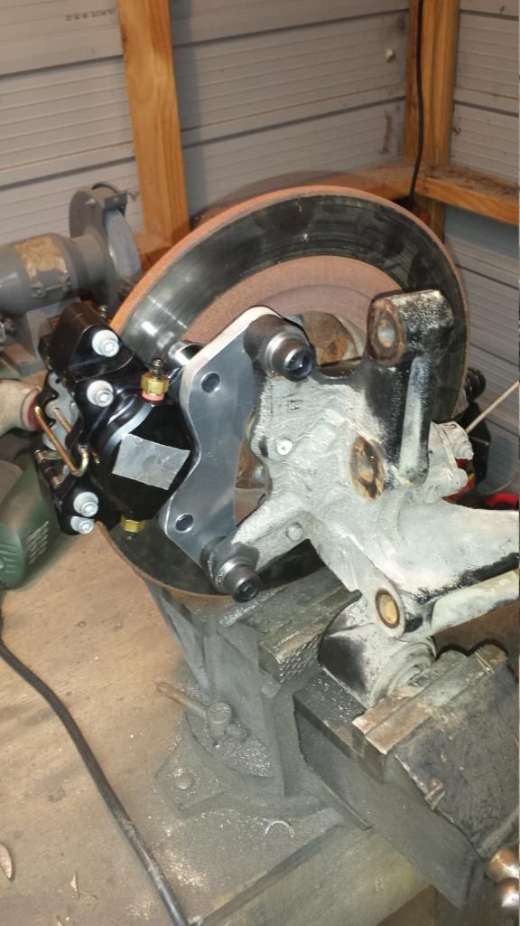

Sorted rear brake mounting finally to the standard I wanted.. loved using my drill press..

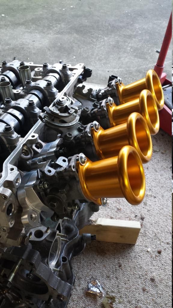

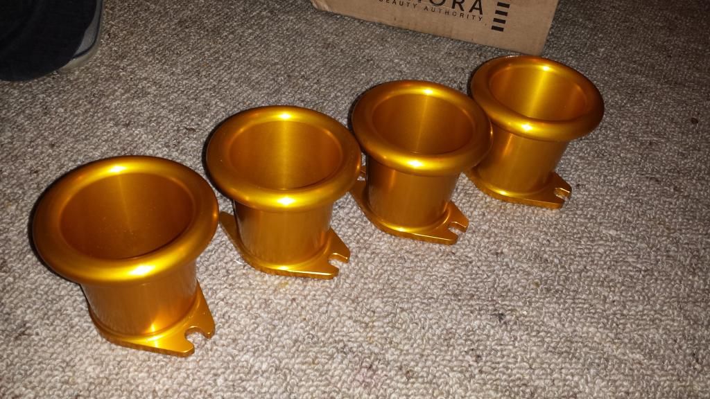

Also bought some new trumpets. Took frigging ages to arrive from T3 and had to chase them for 2 months but got them eventually

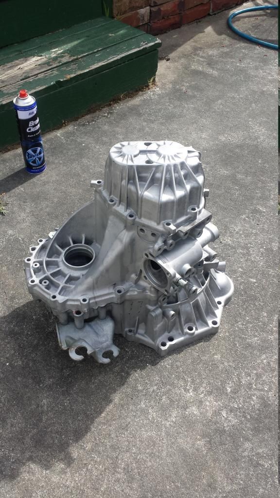

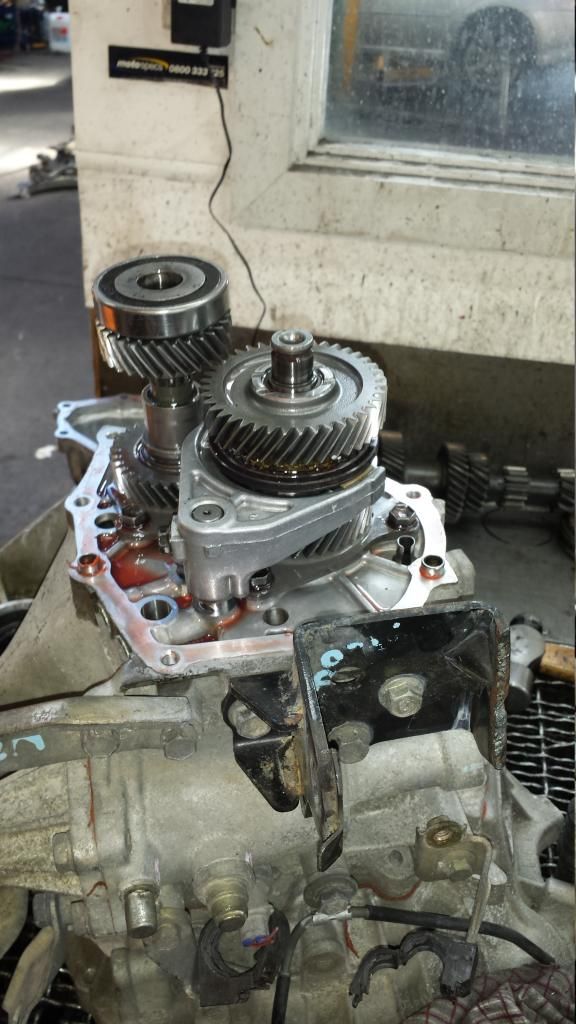

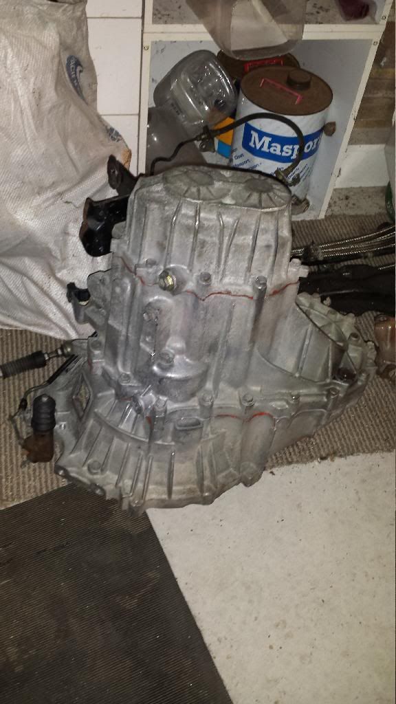

Found some goodies inside, the gearbox had been rebuilt previously and found a TRD LSD in there as well. Didn't have any wear on the synchros or the diff and looked to be TRD oil in there so that's always a good sign.
While the gearbox was apart I took some time at work to sandblast the casing before putting it back together with new diff bearings and a couple of new bearings inside the box and a seal kit :)

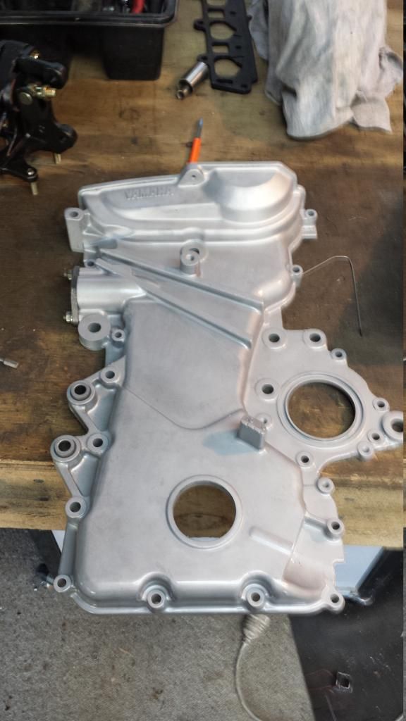

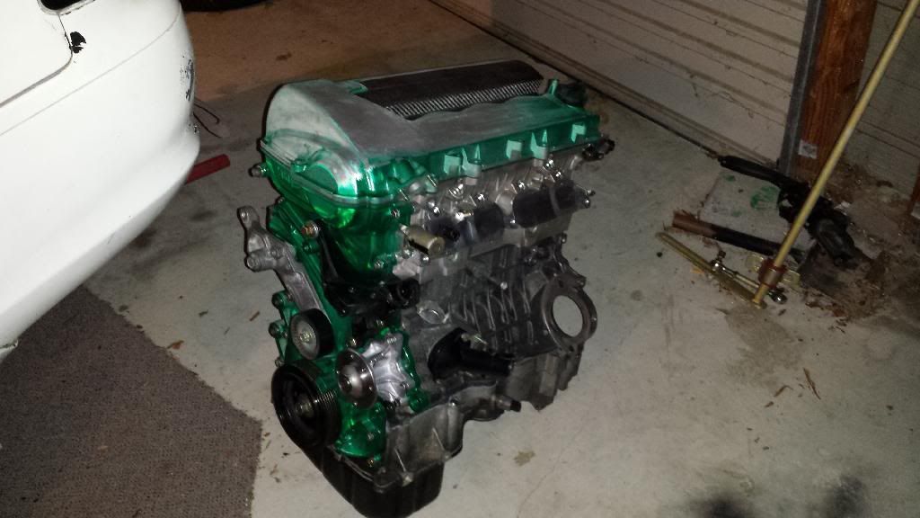

Also blasted the timing chain cover to get rid of the green. Have clear coated the bottom part and the top will go the same color as the rocker cover.

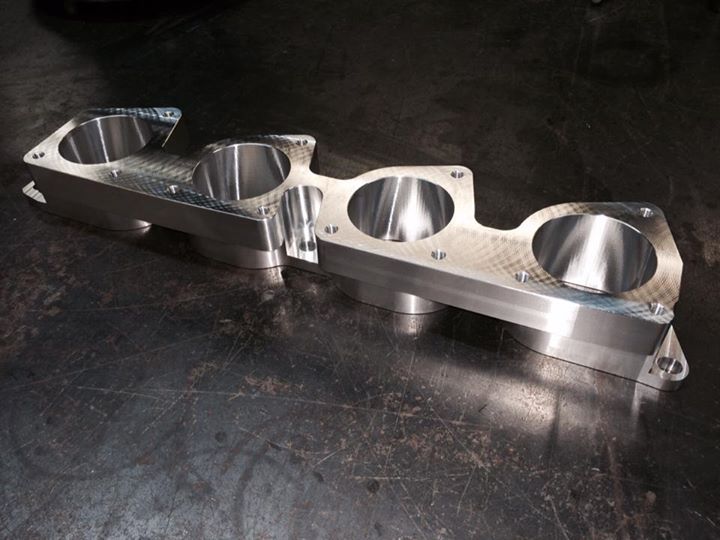

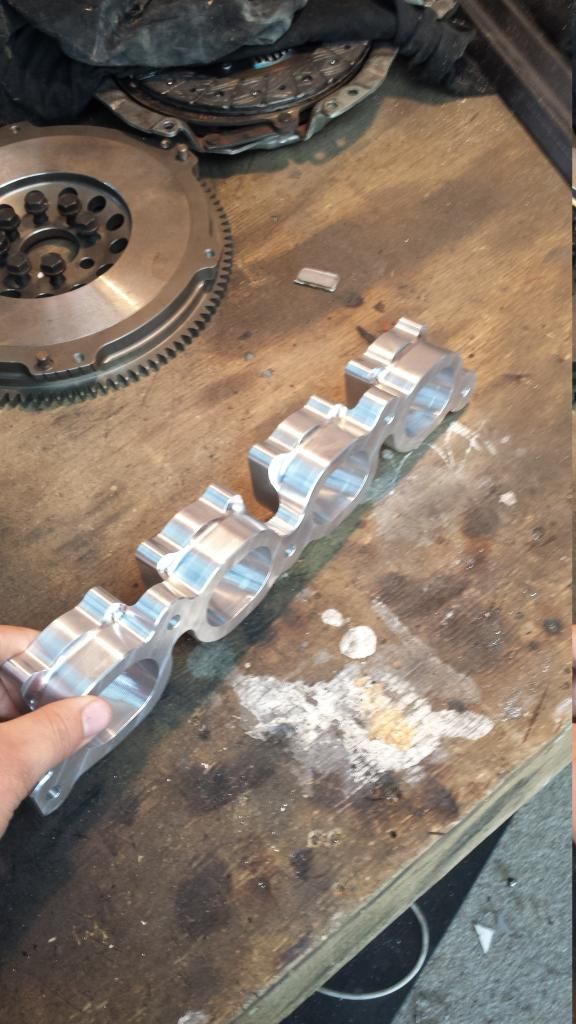

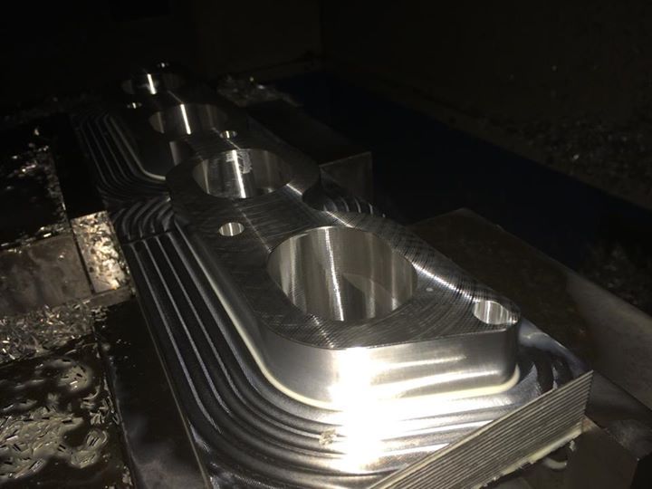

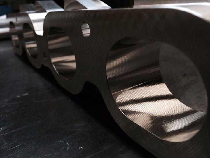

Intake manifold mk 2. Big thanks to jase for sorting this. Still some small adjustments to make for a perfect fit but almost there. Nothing that can't be sorted out with a file. Also struck a problem with the vvti solenoid plug being in the way. Need to work out how I can rotate the plug by 180deg but leave the solenoid in the same place.

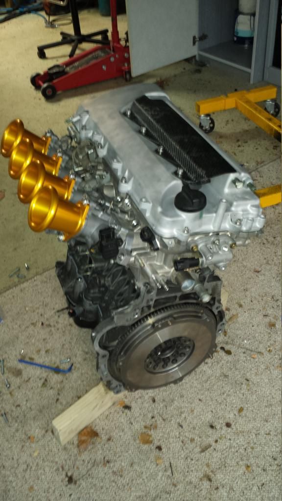

Rocker cover all todied up and back on, timing chain cover back on, 4age flywheel bolts shortened and flywheel fitted. Also replaced all visible bolts with stainless cap screws for prettyness
