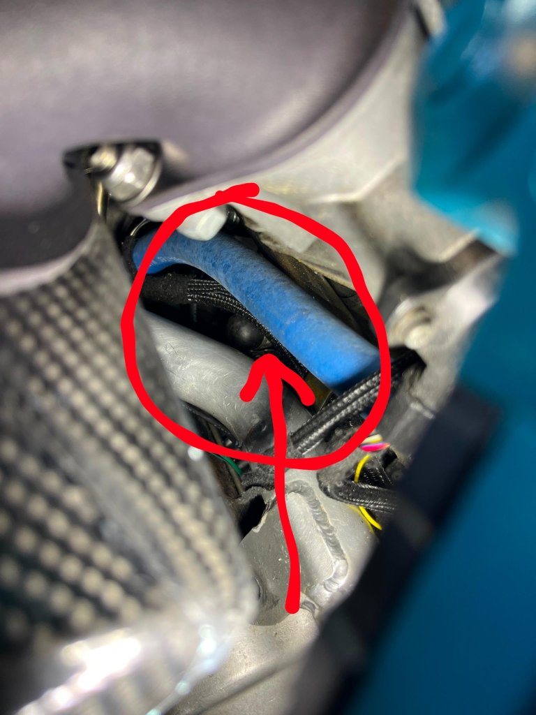

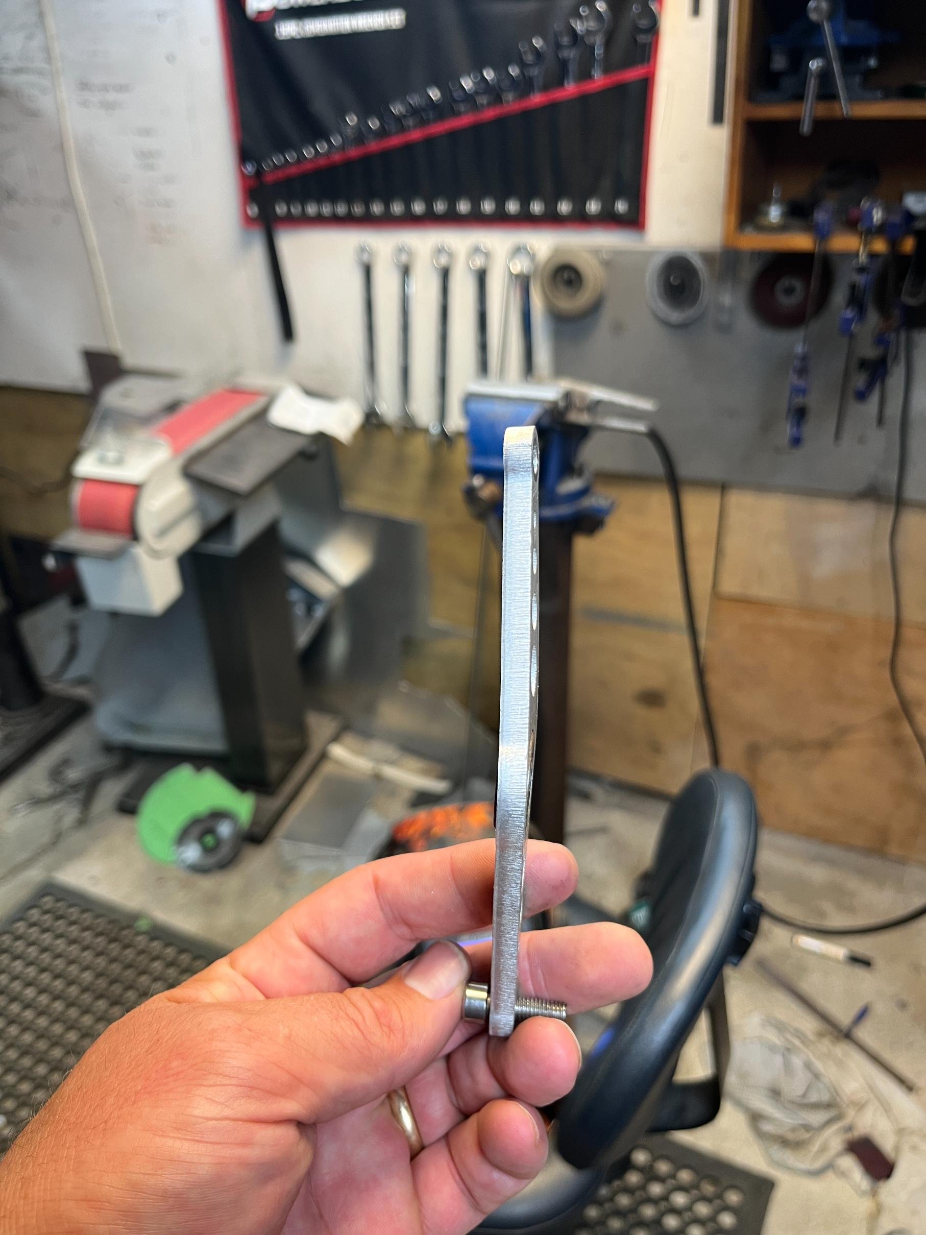

The linkage that popped off has the longest lever arm/gain, so I'm not suprised it happened. I think I'll redesign this one to use dual skateboard bearings and hold the rod end in a clevis instead, so there isn't the sideways force on the bearing housing. Whether I eventually do this for all the levers to reduce play or not I'm unsure, but I don't want to commit to reengineering it just yet.

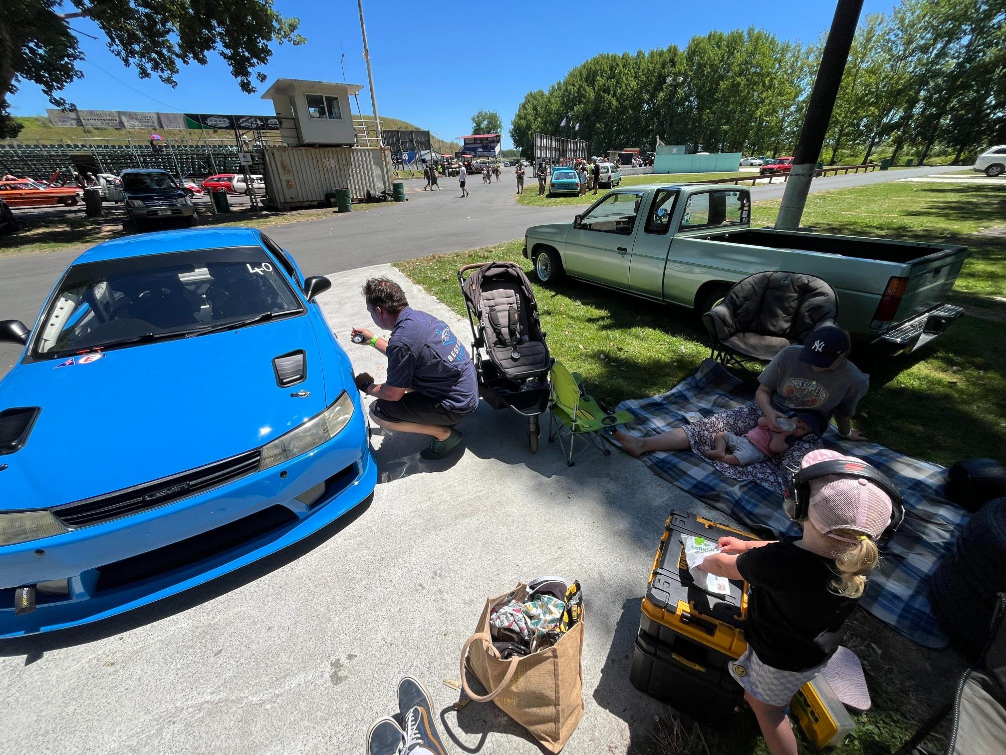

  • Race box - I'm in desperate need of a dedicated container to store all my raceday stuff in, so I have all the correct fluid, specialty tools etc on hand. I found it too much to remember everything each time, so I need to automate the process.

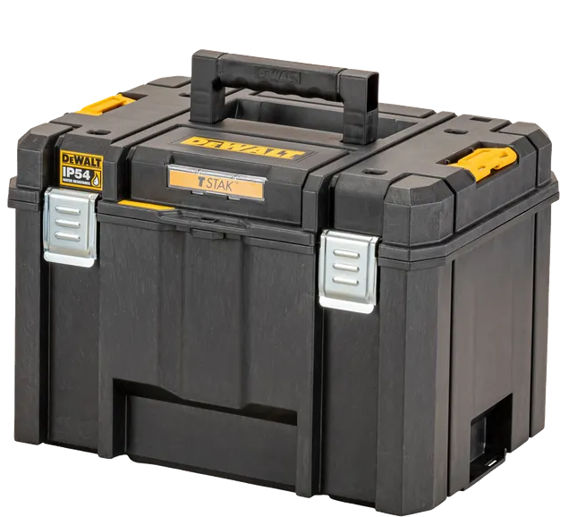

So awesome following this build, thanks for spending time on the updates!
Re race boxes, I run a Dewalt tstak (cheapest of these types of kits I could find, they also come up secondhand often) which I've found works really well.
Bottom
Then on top i run
Fluids and heavy stuff go in the bottom (tape, brake fluid containers, brake clean etc), tools in the top one.
Makes it easy getting it from the car to service area, and can come apart so fits in the car easier, and each is not over heavy to lift around.
Obviously lots of choices too for what you put on top to suit your setup.
I then run a simple checklist on the phone (Google Keep) which i verify against when packing to make sure I've got the important things.
At some point I should 3d print some internals so each tool has a place, but to much time/effort going on other more important things.
Thanks, and great suggestion for the toolbox. They look to be very reasonably priced too. I see they come in different configuration organisers for the top boxes which is awesome.
Does the carry handle detach? I don't drive a silly ute so everything needs to pack in boot of racecar/Lexus. It provides a Tetris-like challenge when wife and 2 kids are also packed..
I know the struggle, i have 2 car seats in the back of mine. Luckily I have an SUV so boot space is decent. But when you add a spare set of slicks rims and then wets things get challenging.
The handle doesn't detach but it slides down at press of button (so silver shaft goes inside black) height collapsed from ground to top of handle is 635mm.
A bit unconventional but I'm running a large chilly bin,mostly because I take a fuel container and the proper seal on the chilly bin means no fume smell. I have a cantilever toolbox which has most of the tools I might need.
  • Thanks 1
Thats actually genius. That's one downside of having a car is fuel smells get through from the boot easily. Ute not so much of a problem.
Bonus feature is you can chuck some ice and beers in at lunchtime when you fill your car up and chill your beers for after racing is done.

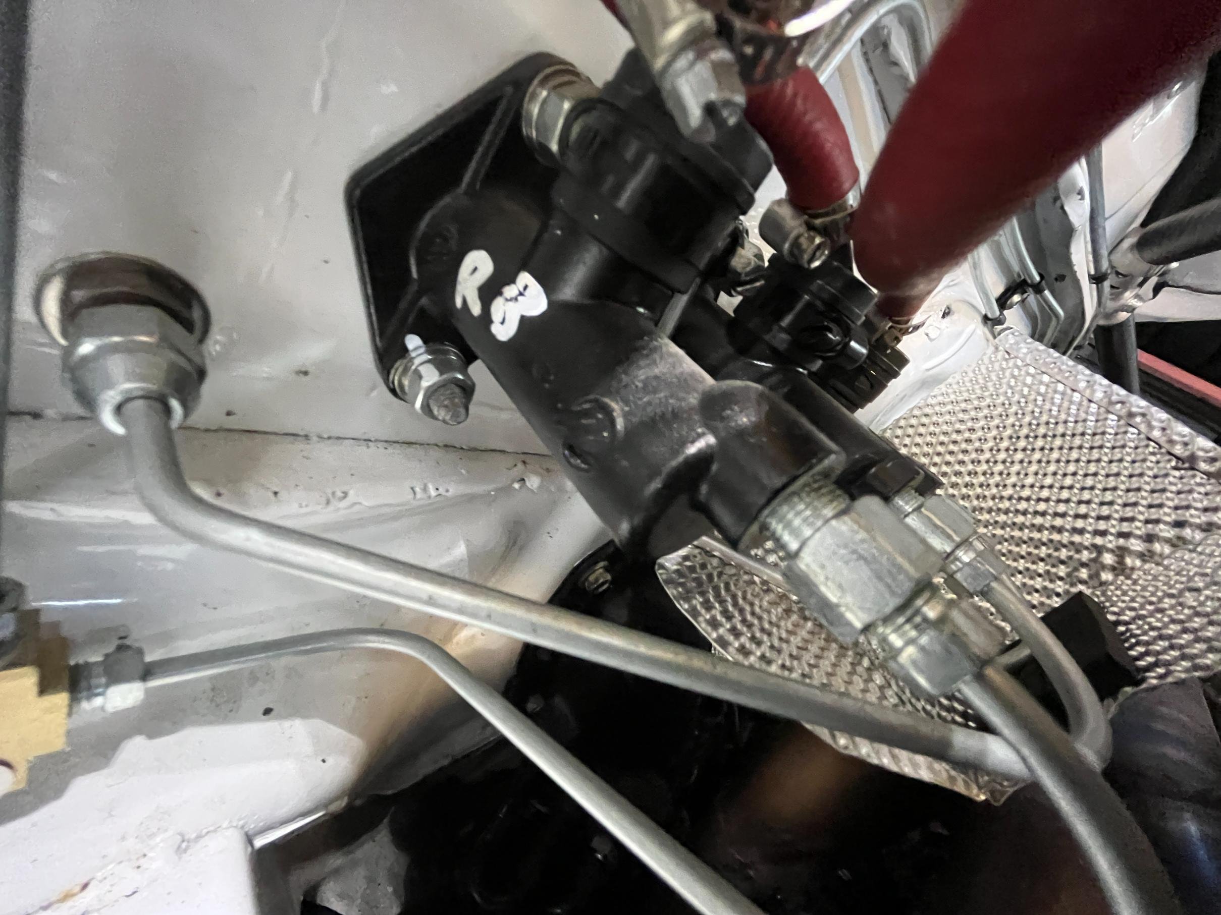

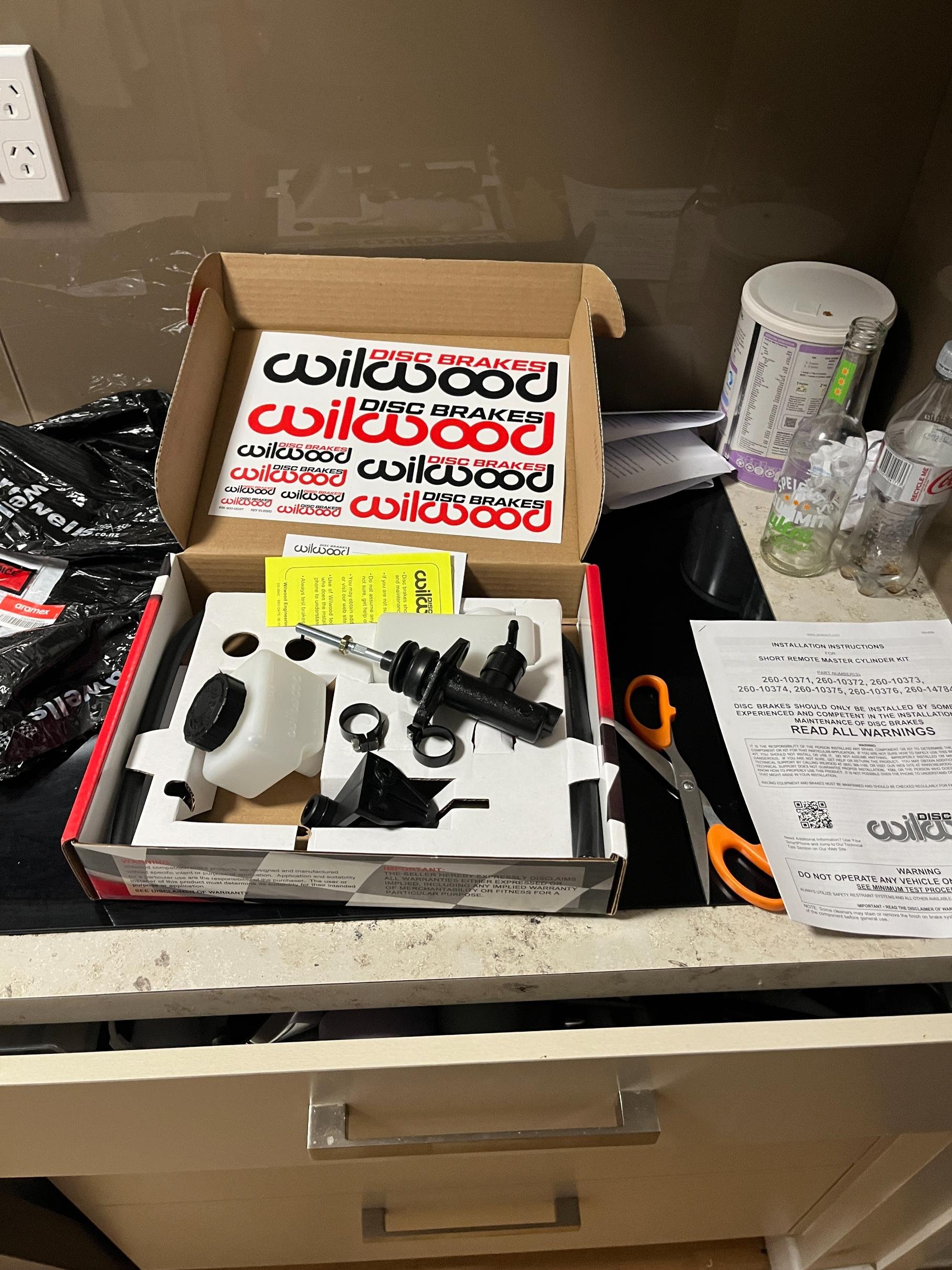

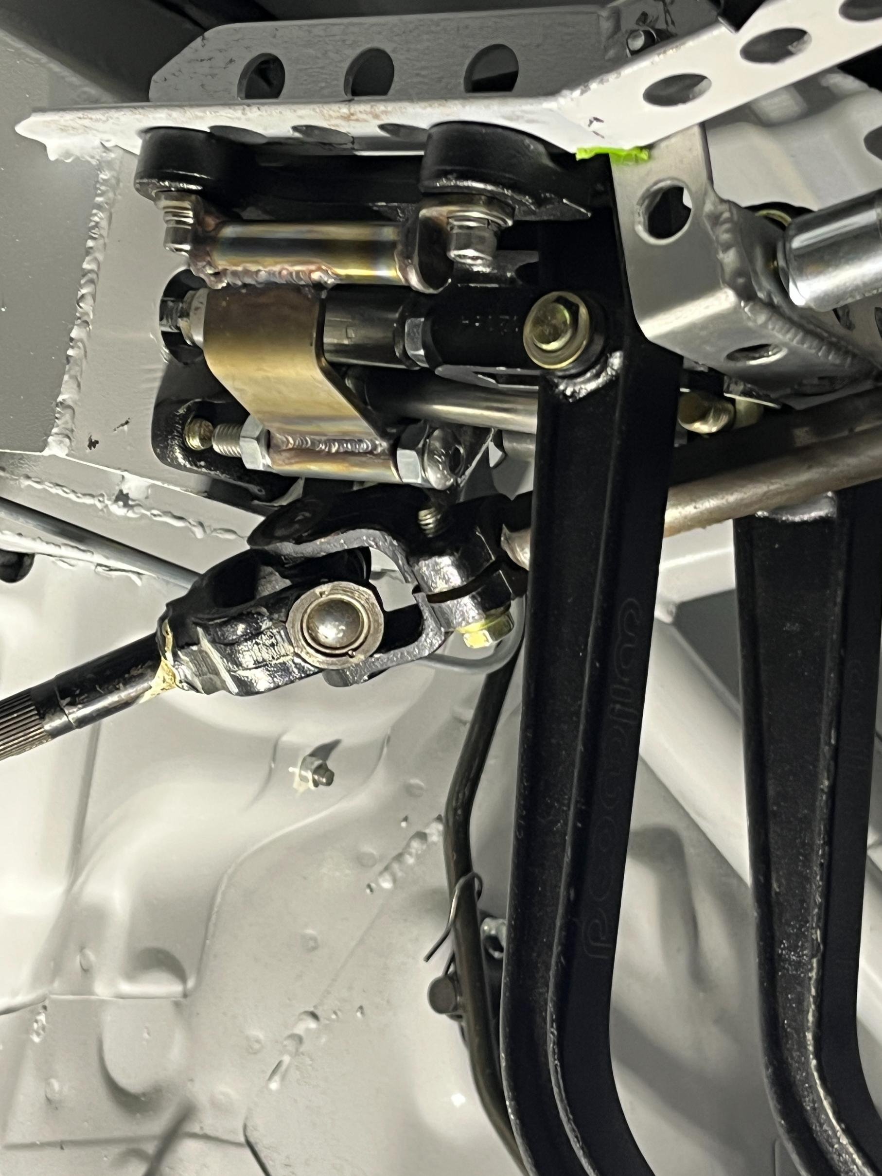

I had issues with the wilwood master cylinders in the starlet.  had been in there awhile, but really not that much use compared to what a oem deals with. they had scuffing damage in the cylinder bore.  be interesting to see if yours was the same or just old seals?     mine weren't fluid  leaking.  but kept letting air into the system.
I have swapped to tilton masters which, drop into the wilwood pedal box. see how they go
This is great to know! Yeah, we were having this discussion at the pub afterwards about how important brakes are and how large the quality difference is between cheaper brands like wilwood and the likes of Tilton and AP etc.
The more I think about it, the less I want to skimp on brake stuff just to save a few bucks. I'm thinking I'll probably chuck my new Wilwood 0.75" onto the clutch and replace the two brake cylinders with Tilton
I was advised to avoid Wilwood master cylinders (calipers were fine just mc shit) when I did my pedal box from someone who end up replacing their new Wilwoods and had a good relationship with the importer.
I run ap racing ones now as that was recommended by the same person. But they aren't cheap (understatement...). But I haven't had a single issue with them and pedal feels great (but so many factors goes into that).

I don't have any experience with the Tiltons (other then I'm running their pedal box, which is a well built unit) but from the anecdotal evidence I've seen through the web over the years, they look to be decent units, I'm pretty sure they would be better quality then then the Wilwood. They would be my second pick to try personally.

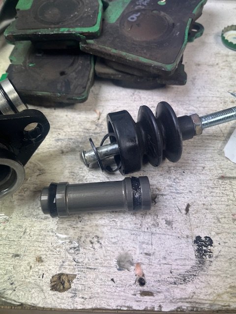

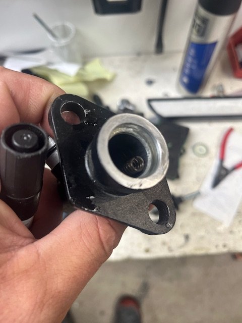

For interests sake, I pulled the old master apart tonight. Yup leaking from front seal with a buildup of gunk/alloy shavings. Scuffing on the bore doesn’t seem too bad, but there is some.

I probably cant help any more than the others above but I had some wilwood masters that I used in my kp they bleed up nicely when new but car sat for a few years, I can only assume the brake fluid ate away at the rubbers as I was never able to bleed them up again.  That is probably obvious but assume OEM masters would last longer than a few years before losing seal highlighting the fact maybe wilwood masters aren't as good as we think? Or because the are cheap maybe designed to be a throw away part?
